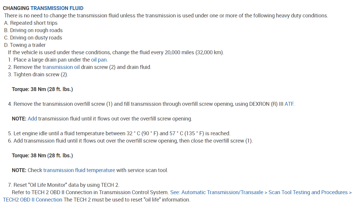

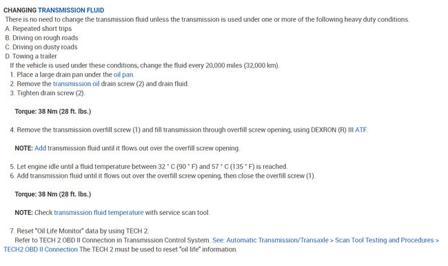

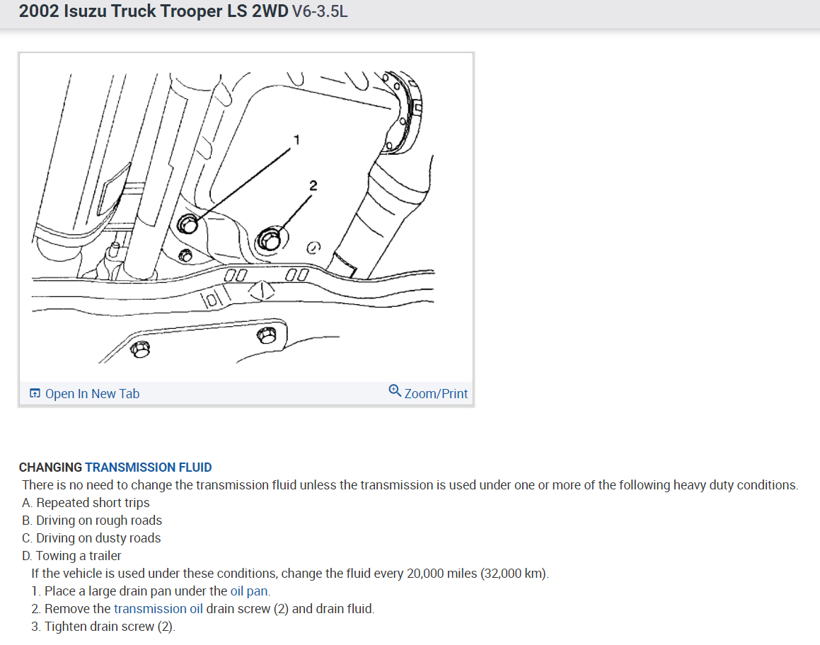

They a tighten 15-30 inch pounds which is equal to pressure to turn a door knob.I think they overtightened and swaged to pan bolt holes. These guide and the diagrams below will show you how to service the transmission.
