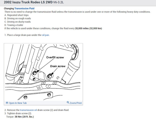

I just put a new transmission, how much trans fluid do I put in it and where do I check it at?
Apr 9, 2009 at 2:42 AM
  • 75,992 POSTS
Here is a guide to help you service the unit and the fluid type and how you check the fluid in the diagrams below.
Fluid Types
Oil type .................... ATF Dexron (R)-III
Capacities
Oil capacity .................... 8.6 liter (9.1 qt)

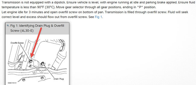

No, there is no reservoir for you to top up. Did you check the level and it indicates it is low?
Transmission

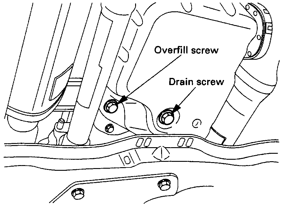

1. Transmission is not equipped with a dipstick. Ensure vehicle is level, with engine running at idle and parking brake applied. Ensure fluid temperature is less than 90°F (30°C). Move gear selector through all gear positions, ending in "P" position.
2. Let engine idle for 3 minutes and open overfill screw on bottom of pan. Transmission is filled through overfill screw. Fluid will seek correct level and excess should flow out from overfill screw. See Fig. 2.

  • 55,433 POSTS

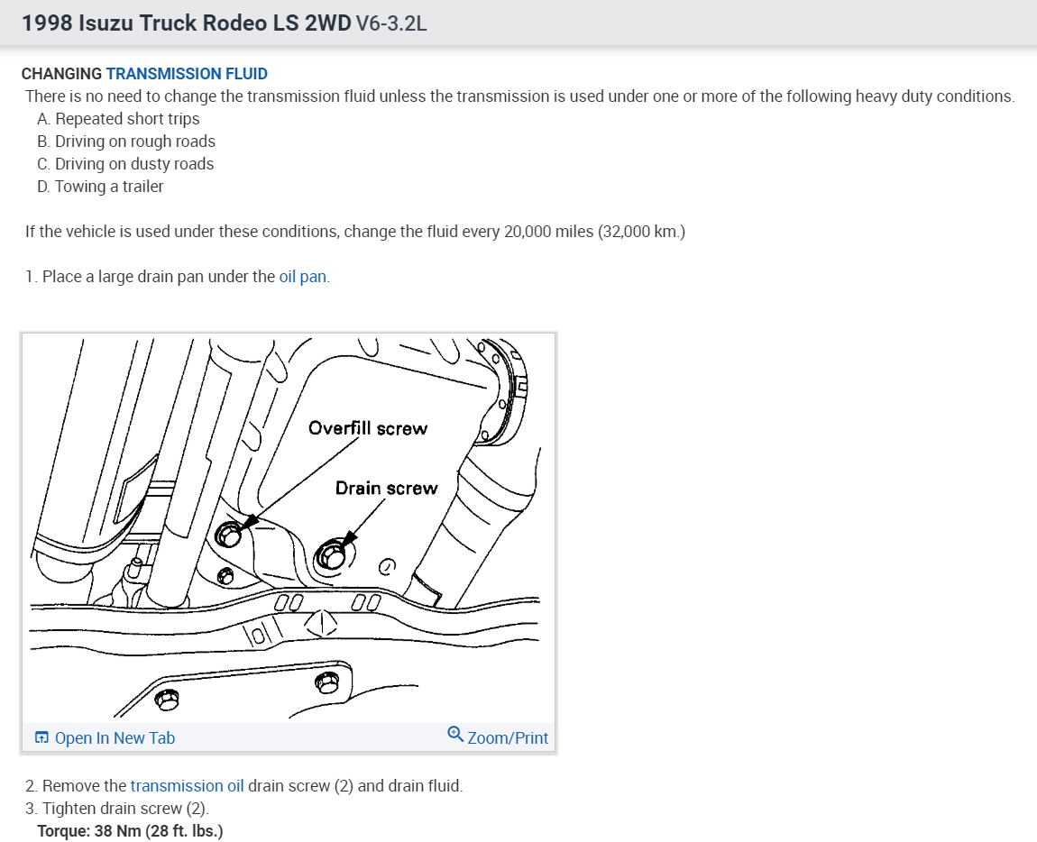

The fluid is installed from the bottom and pumped in until it overflows from the plug. Checking the automatic trans fluid can only be done under the vehicle, bottom of trans drain pan(over fill screw).
You must raise the vehicle up safely to begin
Here are some diagram (below) to help you see what needs to be done.

This vehicle doesn't have a dipstick. The fluid is checked by removing a plug on the bottom of the trans (#1 in the picture) and filling through that hold until it runs out. https://www.2carpros.com/images/external/91097106.gif

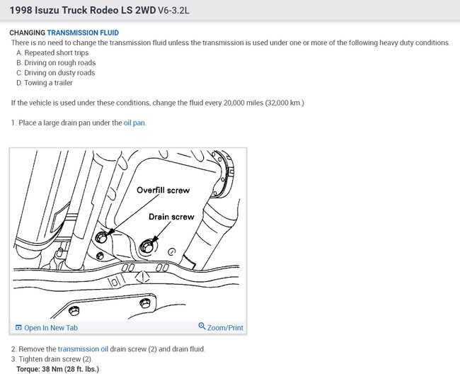

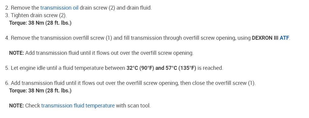

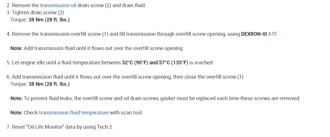

To fill the transmission, the engine must be running and at operating temperature. Here are the directions specific to your vehicle. The attached pics correlate with the directions.
____________________________
Note: The first portion has been removed because it was related to replacing the filter.
See Pic 1
4. Remove the transmission overfill screw and fill transmission through overfill screw opening, using DEXRON III ATF.
NOTE: Add transmission fluid until it flows out over the overfill screw opening.
5. Let engine idle until a fluid temperature between 32°C (90°F) and 57°C (135°F) is reached.
6. Add transmission fluid until it flows out over the overfill screw opening, then close the overfill screw.
Torque: 38 Nm (28 ft.lbs.)
NOTE: Check transmission fluid temperature with scan tool.
Let me know if this is what you needed.

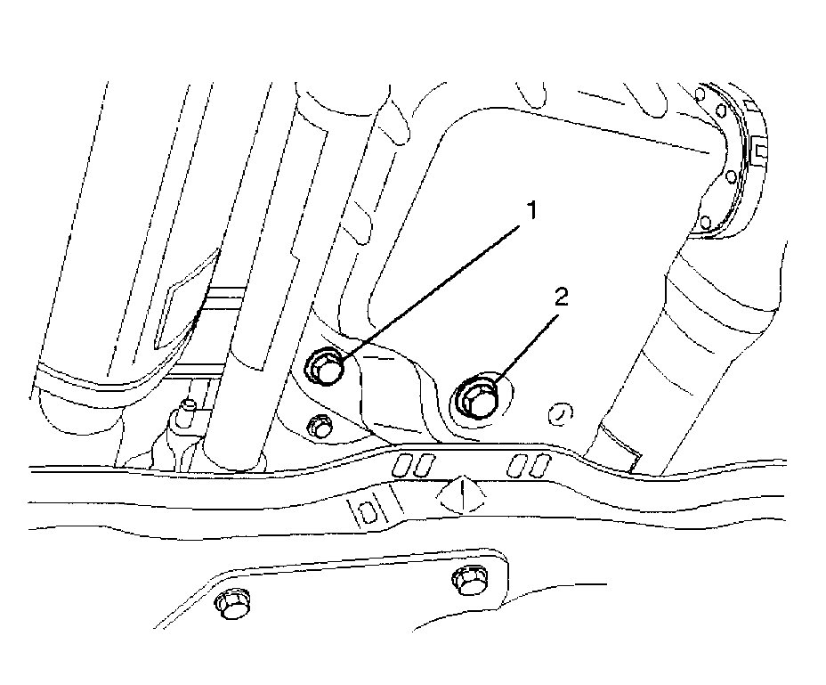

  • 110,244 POSTS
This vehicle doesn't have a traditional transmission dip stick for checking fluid level and condition. Instead, with the engine warm, running, and in park, there is a fill plug that is removed. Once removed the fluid should trickle out. If it doesn't, then you add until it does.
Here are the directions from my manual. The attached pics correlate with the directions.

pic 1
1. Park the vehicle on level ground and apply the parking brake firmly.
2. Check fluid level with engine running at idle.
NOTE: Be sure that transmission fluid temperature is below 30°C (86°F).
3. Move the selector lever through all gear ranges.
4. Move the selector lever to "Park".
5. Let engine idle for 3 minutes and open the overfill screw (1).
6. Add released transmission fluid until it flows out over the overfill screw opening.
7. Let engine idle until a fluid temperature between 32°C (90°F) and 57°C (135°F) is reached, then close the overfill screw (1).
Torque: 38 Nm (28 ft. lbs.)
Minimum fluid level 57°C (135°F)
Maximum fluid level 32°C (90°F)
CAUTION: Do not open overfill screw with engine stopped.

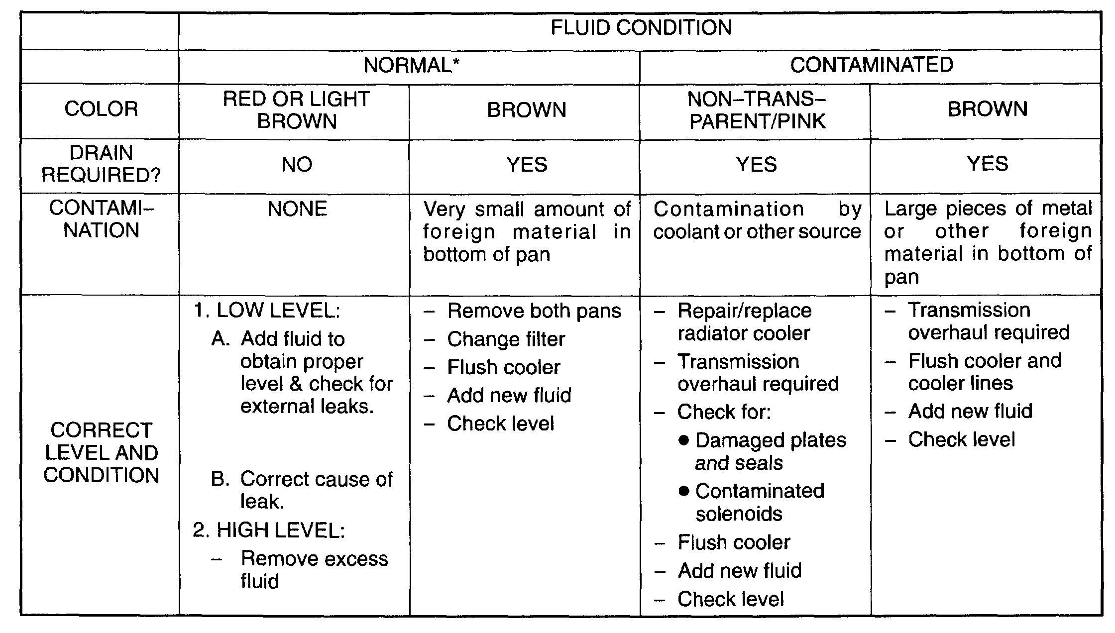

FLUID CONDITION
pic 2
- Fluid should be changed according to the maintenance schedule.

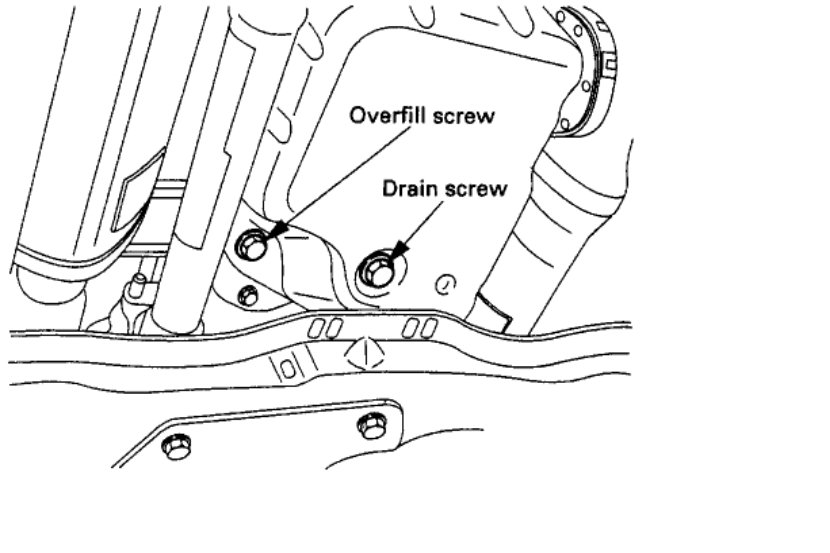

Your vehicle is not equipped with an ATF dipstick. You will have two plugs facing downward on the larger transmission pan. The plug higher up on the pan is the fill/level check (stamped/recessed into the rear right corner of pan). ATF should just dribble from this plug on a hot, idling truck, in neutral on a level surface. The lower one is the drain. The one at the back of the pan in a recess is the filler. You need a hand pump or something similar to fill it to overflowing then top it off with the engine running. Make sure you shift through the gears a couple of times when topping off.

There are 2 drain holes in the pan, one is higher than the other.Remove the higher one, with the vehicle idling in park the fluid level should be to the top of the higher drain plug. If you suspecr fluid is low, pump a small amount into the higher hole, with a drain pan under it.Let flow out whatever amount wants to so that it is at the top of the drain

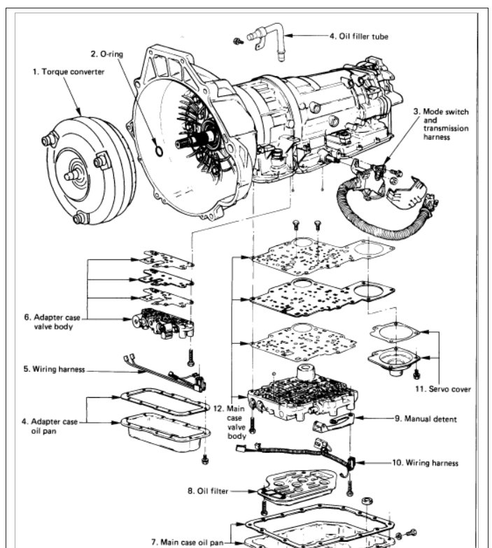

  • 16,542 POSTS
The dip stick is under the car (#4) but you check it the same way this guide will help you see how to check the fluid with a diagram of the dipstick location below.

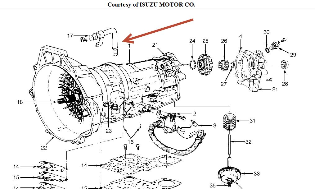

CPAPAWILLY
where should transmission dipstick attach to transmission. What brand would be the best to install or easiest. Looking found a hole on passenger side of transmission towards the front of transmission is this the location? Or is it somewhere else?
Apr 5, 2021 at 7:04 AM (Merged)
HMAC300
  • 48,601 POSTS
The transmission dip stick is on the passengers side its a little short guy so you will need to be under the car to get to it. Click the image below to see.
