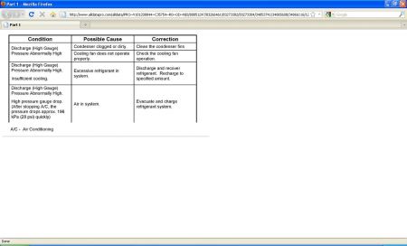

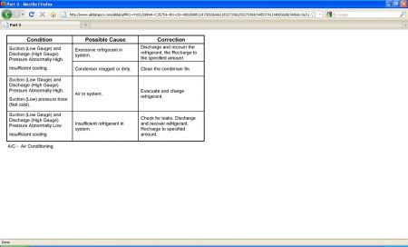

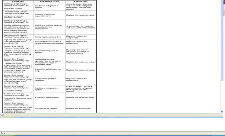

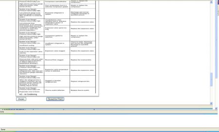

Sep 21, 2010 at 7:52 AM
SATURNTECH9
  • 30,869 POSTS
https://images.2carpros.com/forum/automotive_pictures/416332_2001_Isuzu_Rodeo_ac_chart_part1_1.jpg
https://images.2carpros.com/forum/automotive_pictures/416332_2001_Isuzu_Rodeo_ac_chart_part2_1.jpg
https://images.2carpros.com/forum/automotive_pictures/416332_2001_Isuzu_Rodeo_ac_chart_part3_1.jpg
https://images.2carpros.com/forum/automotive_pictures/416332_2001_Isuzu_Rodeo_ac_chart_part4_1.jpg
There is all the pressure chart's for diagnoses of bad pressure's.Your a/c system is about half full it hold's 1.5lb's.I also emailed you the chart's.
