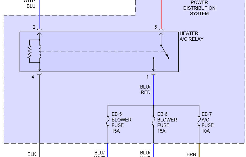

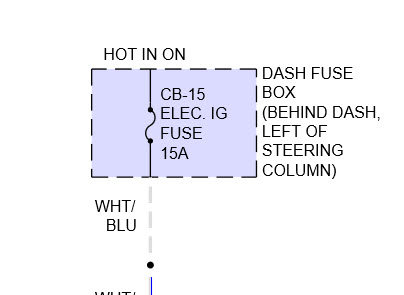

when I push the button the A/C on it does not come on. the light does not light up when you push it to indicate it is working. it was working fine yesterday.
Jul 4, 2017 at 3:53 AM
HMAC300
  • 48,601 POSTS
check fuses and relay first. See pictures. relay and three fuses are under hood other is in car. otherwise it must be scanned for codes by a mechanic.
