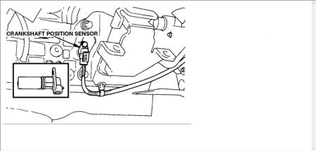

I have been told that lots of time when the belt breaks on this rodeo that sometime it will knock or break the crank sensor. Could anyone tell me where this sensor is???
May 6, 2008 at 8:24 PM
MHPAUTOS
  • 31,937 POSTS
Hi there , CPI as per pic. Mark (mhpautos)
https://images.2carpros.com/forum/automotive_pictures/61395_iszuzu_1.jpg
May 7, 2008 at 5:52 AM

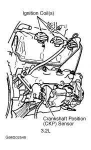

what side is the crankshaft sensor on an where at.
Dec 3, 2020 at 9:27 AM (Merged)
  • 75,992 POSTS
A 3.2L engine the CPS at lower right side of engine

RAFNSONL
I appriciate your rapid resposne to my question, however the picture you sent me don't seem to be of much help, as I don't recognize any point of origan
Looking at the Engine from the front, Radiator end
should I be looking on the right, left , top, bottom, front, back. ? relitive to some device that I can recognize, such as the Fuel Rail, the Spark Plugs,the oil fill cap, the dip stickis etc I have looked at everything except the bottom of the thing and only because it is setting in a low spot that is holding water, and I can't identify anything that lookis like the photo you sent.
once again thank you very much for your help

BLUELIGHTNIN6
  • 16,542 POSTS
it's on the lower right side of the engine..

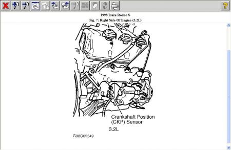

ROB KANDUTH
  • 10 POSTS
take pasenger side wheel off its write thru the rubber flap in the wheel well side of block to left side of motor mount it has one ten mil. socet good luck to two wire plug make sure you look to see if there is oil in the wires clean good with electrical cleaner or new one will short out

RAFNSONL
ROB:
Thank you very much I just happend to have the truck up on Jack stands right now while I am changing all the tires so it should be easy for me to find it, I do appriciate your help
Larry

RAFNSONL
Where are the Cam position and Crank Position Sensors to be found on the 94 3.2 Rodio engine
  • 75,992 POSTS
It doesn't have a camshaft sensor -the CPS see below
