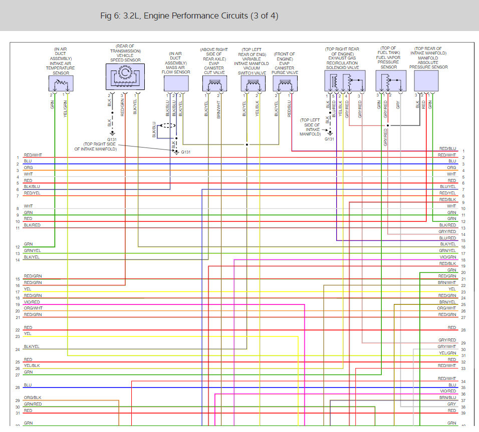

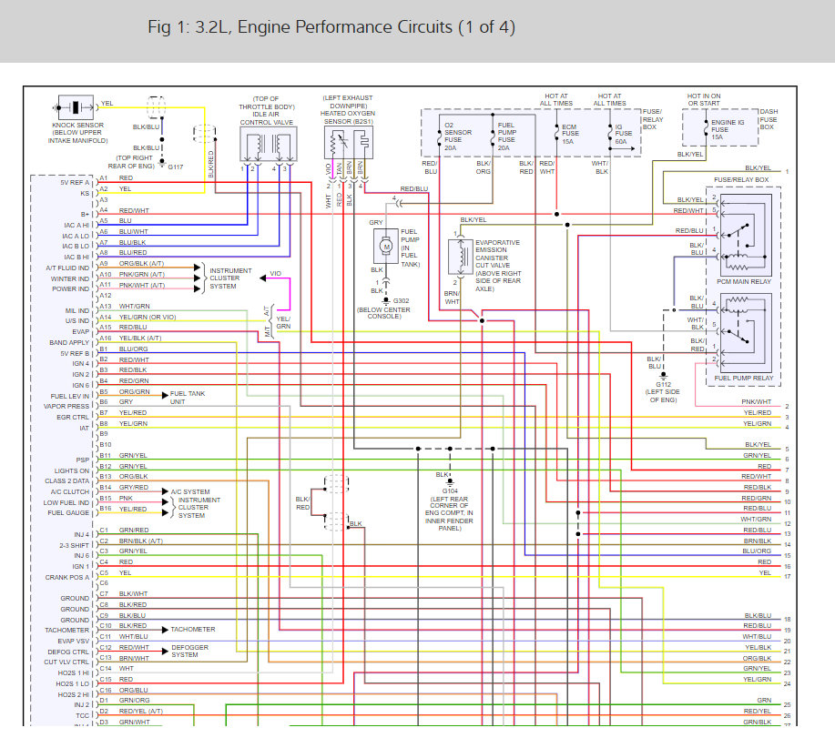

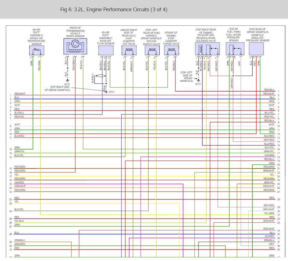

I get a check engine-reduced power lights after engine start. It seems to only happen when temperatures are 40 degrees or lower. The engine surges when idling. It will not go over 20 mph if I try to drive it. I have seen quite a few posts like tbi one but no real solutions. I need to check the engine wiring can you please give me the wiring diagrams? Here are the codes I get:
P1515 TP Sensor to MAF Sensor correlation
P1125 Electronic Throttle Control Limit performance mode.
P1295 Electronic Throttle Control -Power management mode.
I am assuming these codes lead me to several things: Mass Air flow sensor, Throttle position sensor and possibly the EGR Valve. I am not sure what to do or where to go from there.

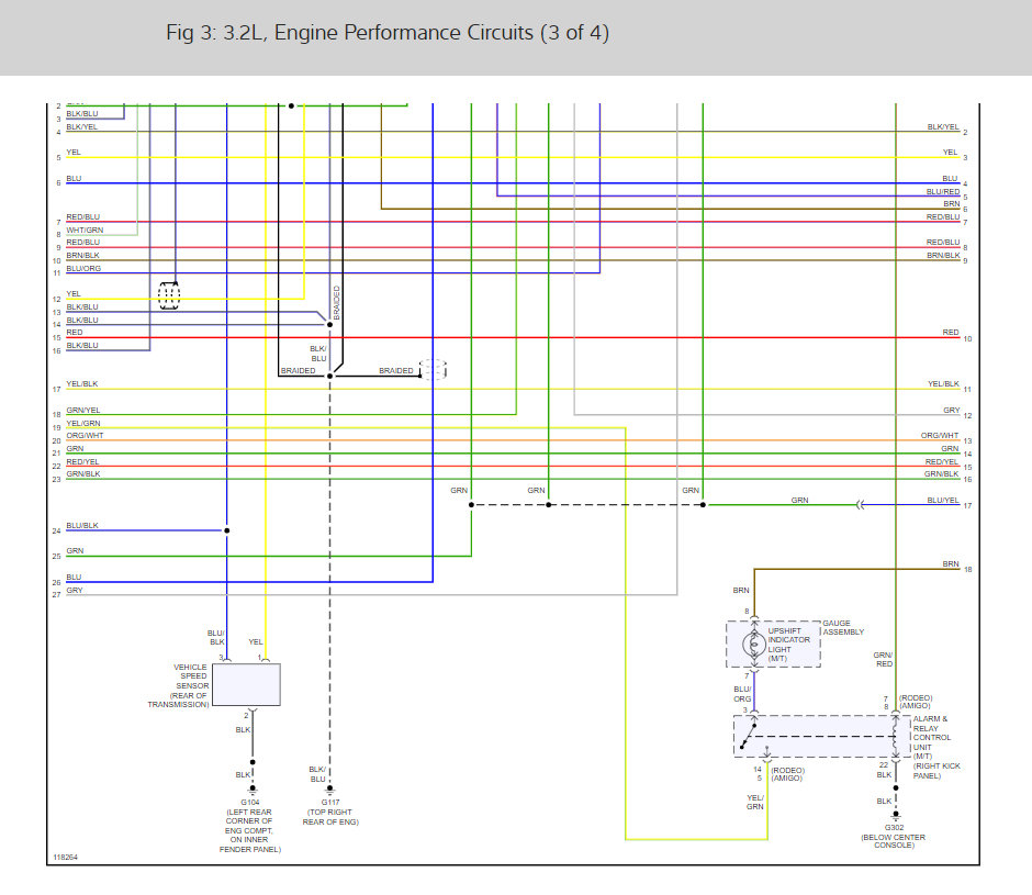

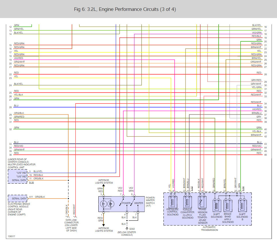

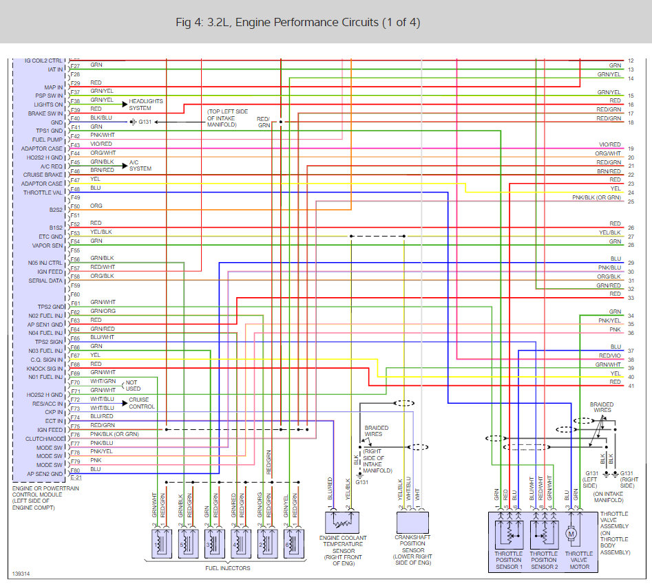

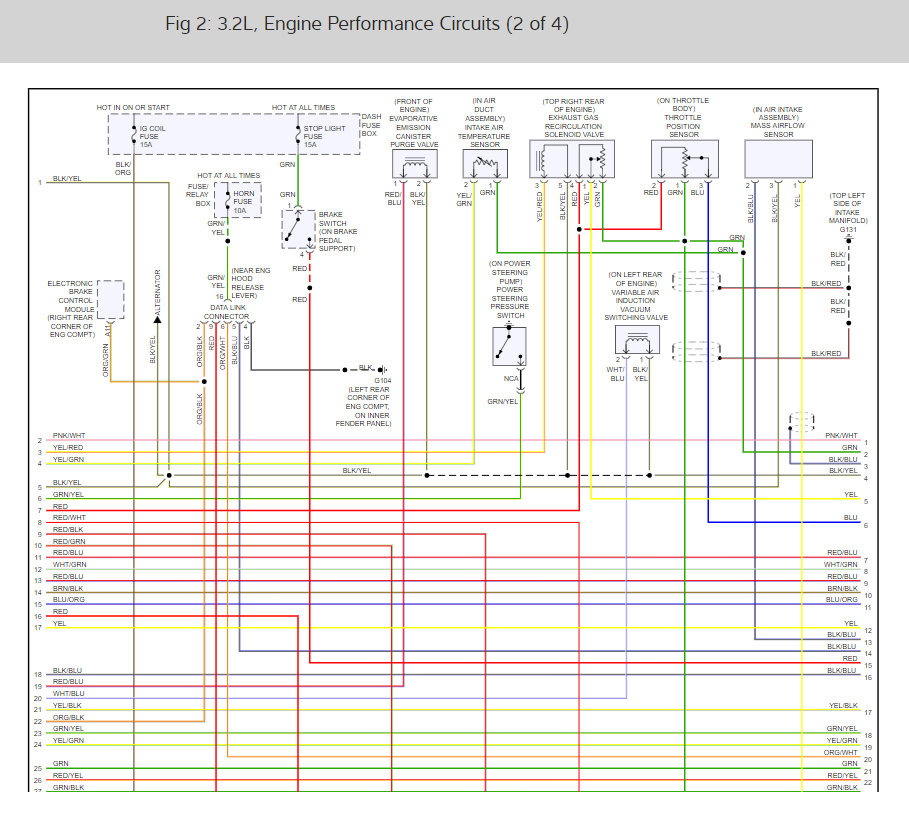

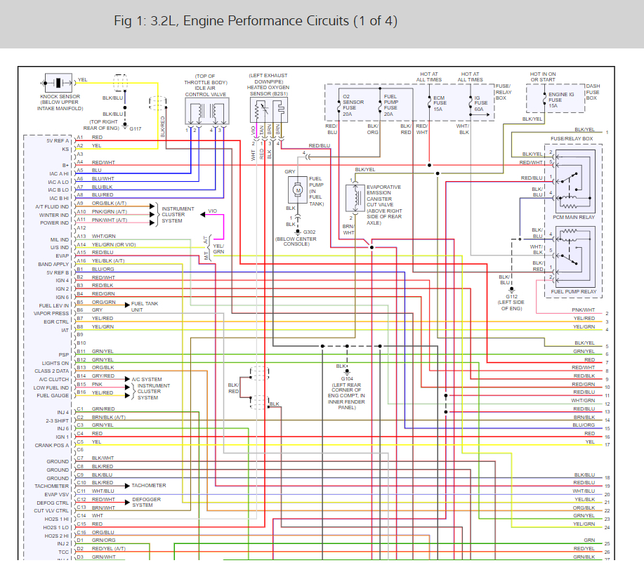

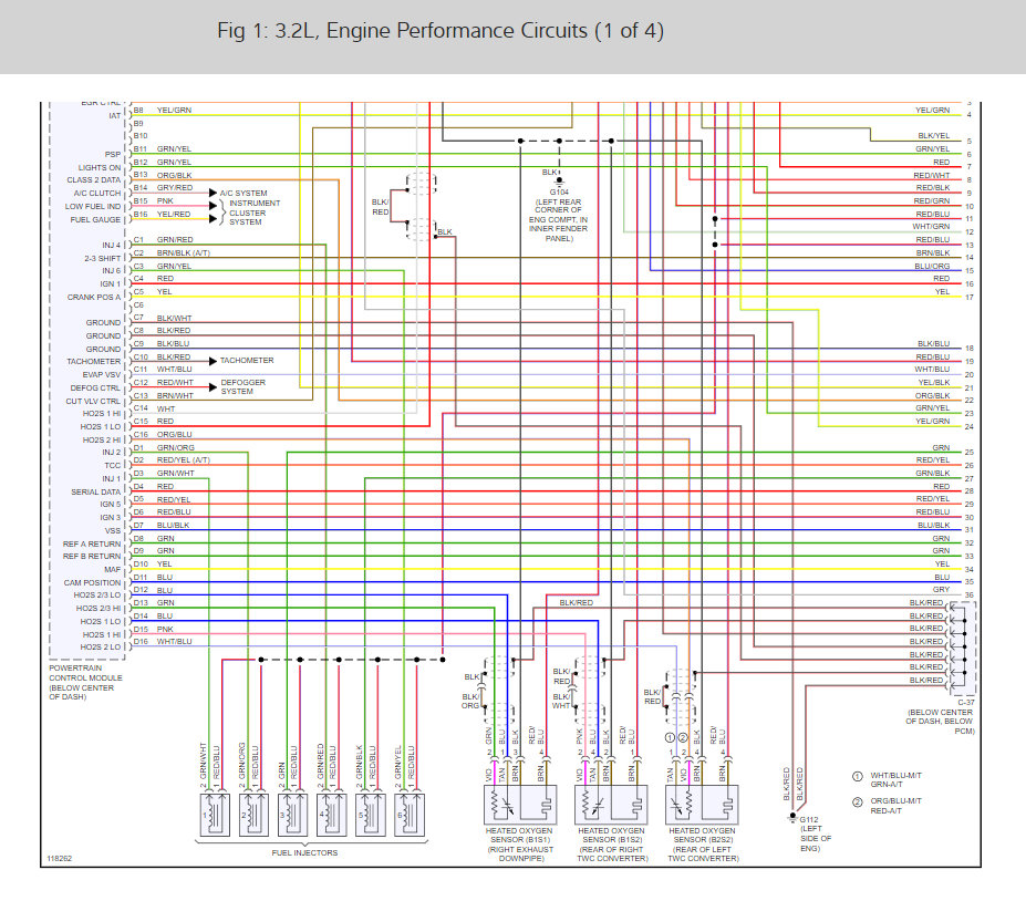

SATURNTECH9
  • 30,869 POSTS

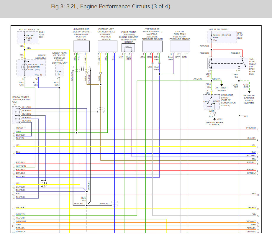

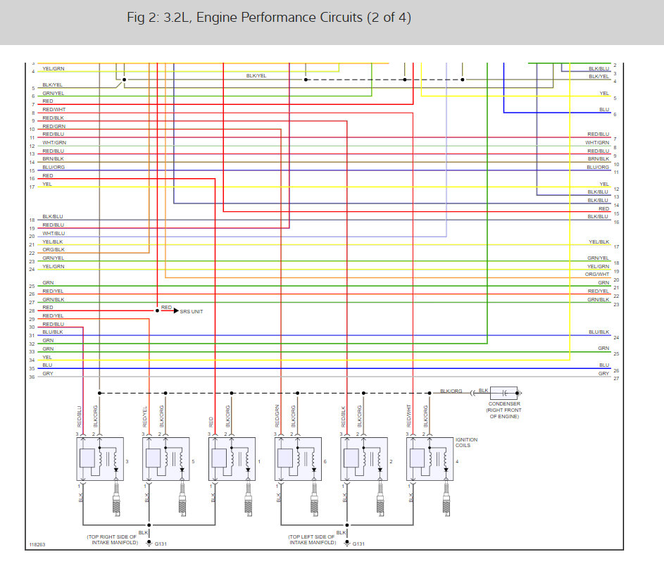

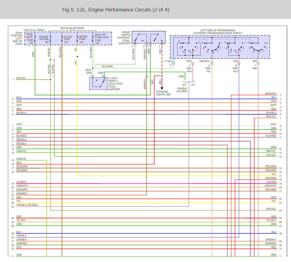

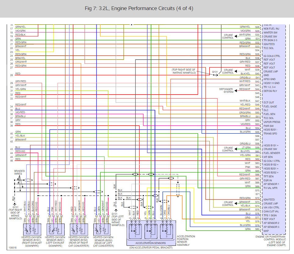

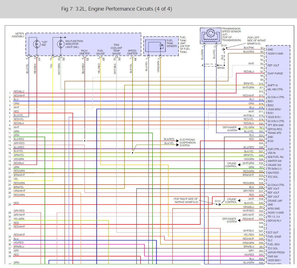

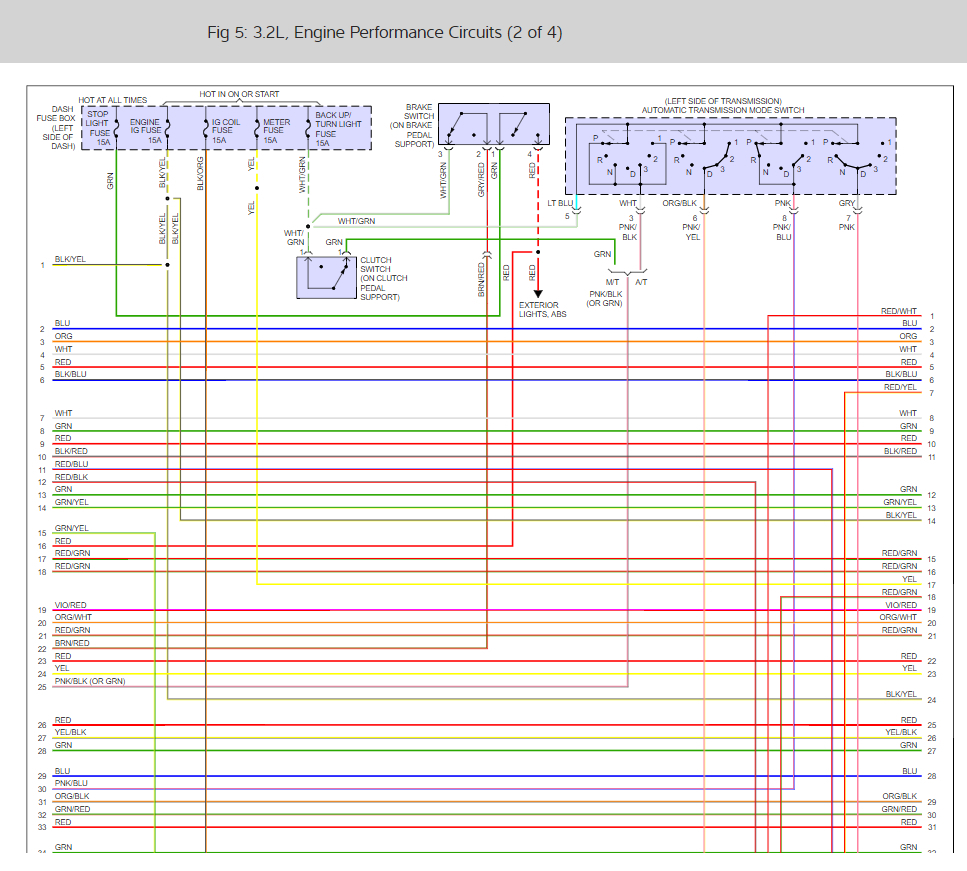

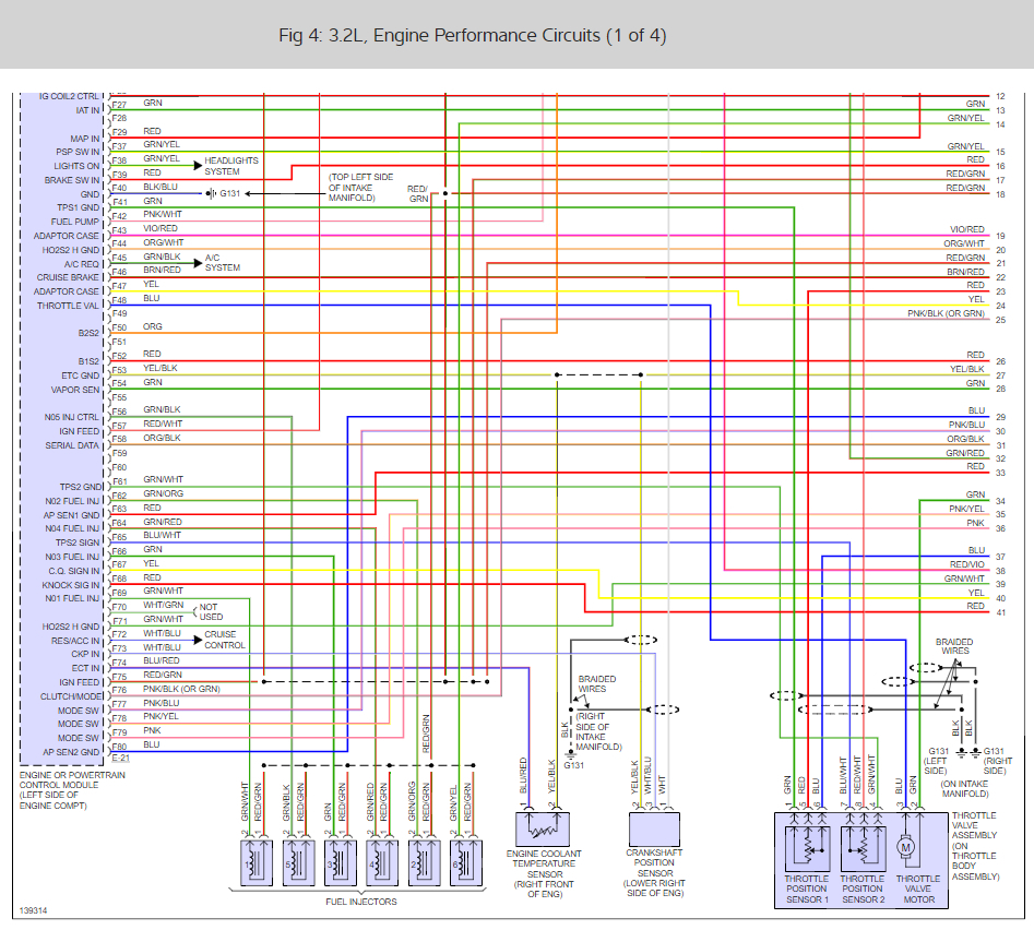

Here is a guide to help you with the wiring testing with the engine wiring diagrams below.
Check out the diagrams (Below). Please let us know what you find. We are interested to see what it is.
+9
Wednesday, November 10th, 2010 AT 12:39 PM
MTNBIKER
Thank you for the info! I am working the diagrams right now. I will let you know how it comes out. The engine is a 3.2L.

MTNBIKER
I followed the diagrams. It pointed me to the TPS. I replaced it for about 80 bucks. That did the trick! I'm back up and running. Thank you for the help!

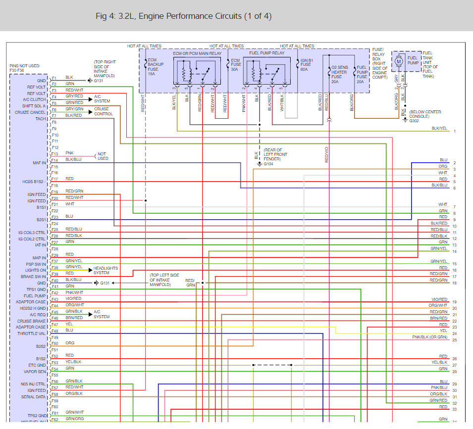

I have a 1995 isuzu rodeo Ls 4wheel drive 3.2 V6. My fuel pump is having issues. I replaced it, but turns out there is some kind of short or something in the wiring. The wires read 12V when cranking, but not when in the on position. Even then, the pump doesnt turn on. I have tested the pump by hooking directly to the pump and it does work. I have also tested all relays and fuses which work. I am guessing the wires are broken somewhere, but idk. If I could get the wiring diagram for the fuel pump, it would be great. Thank you for the help.

Hello and thanks for donating
Below is the wiring diagram for the fuel pump that you asked for. Let me know if you need further assistance..

Sure, there are 2 wires at the fuel pump itself. A ground wire, black, and a power wire, red, running to the relay. At the fuel pump relay there are 4 wires, a ground (black), a black/blue (turns to red near fuel pump for power), a pink/white that runs to the PCM and a black/yellow that goes to the fuse (#2, 15 amp).
As for the fuel pump, it should prime up when the key is turned to ON but will only stay on for around 4 seconds then kick back off. This is just the priming up for it, it knows it doesn't need to stay on with the key ON engine not running.

Hmm, is definitely a wire issue somewhere then. You will need to take a test light and poke around the wiring I showed you. Make sure the pins that are labeled ground are actually groundingand not getting power somehow.
