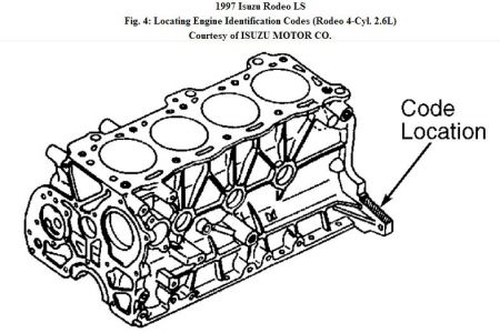

Can you please tell me where to locate the engine number on my vehicle listed above it is the LS SUV model.

Hi koolmtchll, Thank you for the donation. The code is at rear of engine block near to transmission bell house.

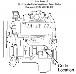

Mine is a V6 Engine. 3.2L.

Here is the diagram.

Thank you again for your prompt response. I need some more assistance please. I am not very good at reading drawings. Could you please give a detailed explanation in text. Thank you.

The identification numbers are below the exhaust manifold on the engine block near to the transmission.
Sorry if we had inconvenienced you and hope the above explanation of the location is clear enough.
