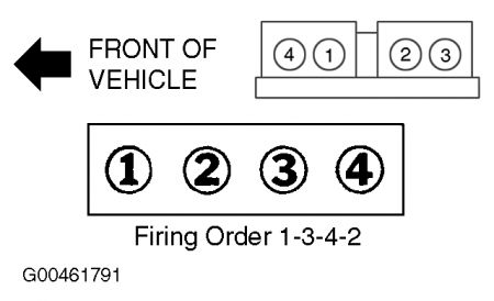

My son deciced to put new plug wires on his rodeo,he took all them off and we dont know the order that they go back on.The coil pack is on the back of the engine--from left to right,what cylinder wire goes where? I just donated money through paypal and didnt get to fill in my question. PLEASE HELP US!!THIS IS NOT A GOOD TIME FOR US TO SPEND MONEY AFTER THE HOLIDAYS,MONEY IS VERY TIGHT--I HAVE 6 KIDS.

Hi there, Thank you for the donation. Firing order and coil sequence. Mark (mhpautos)
https://images.2carpros.com/forum/automotive_pictures/61395_Graphic_87.jpg
