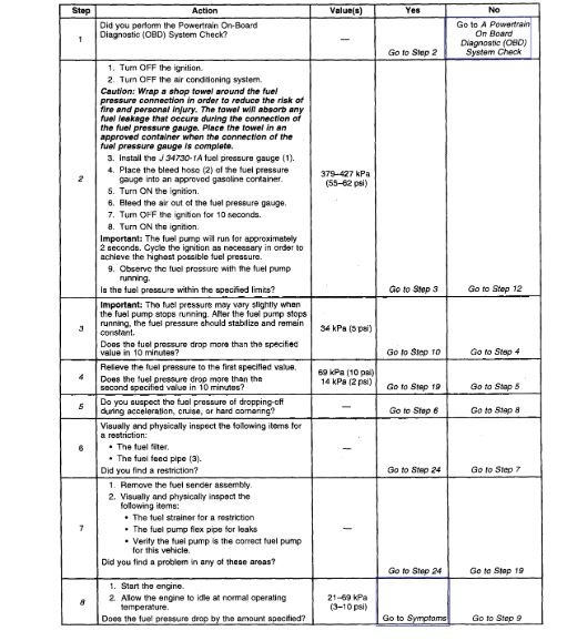

Truck has trouble starting when it’s cold. It will turn over just fine but won’t start immediately. It usually takes 2 or more tries, but once it catches the right amount of fuel, it gets going and stays running good. I’ve done a regular tune up (plugs, plug wires, fuel filter, ect.) replaces the MAF Sensor, the fuel pump, the coolant temperature sensor, and I took off the steering column cover and tightly secured the little wiring harness that goes into the ignition cylinder. I’m not sure what else to try, any suggestions?
Jan 13, 2020 at 2:09 PM
Good morning,

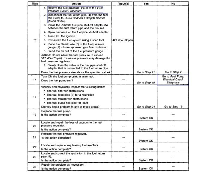

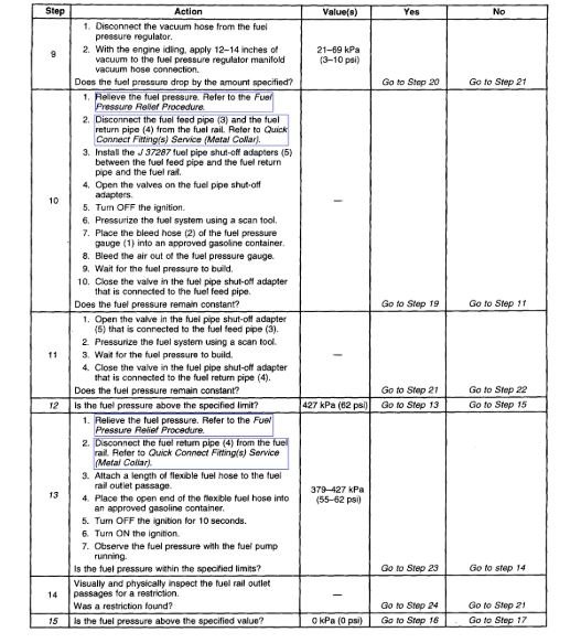

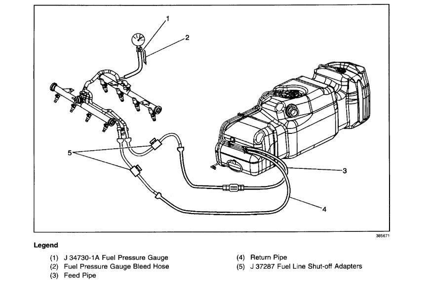

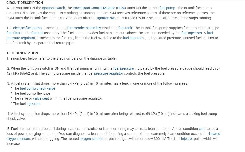

When it is cold, I would check the fuel pressure to b sure you have the proper fuel to the injectors. My concern is that an injector may be leaking down overnight resulting in no pressure in the morning.
https://www.2carpros.com/articles/engine-cranks-excessively-before-starting
When it does not start, does the tachometer move up a little while cranking?
Is the check engine light on? If it is, do you know the code?
