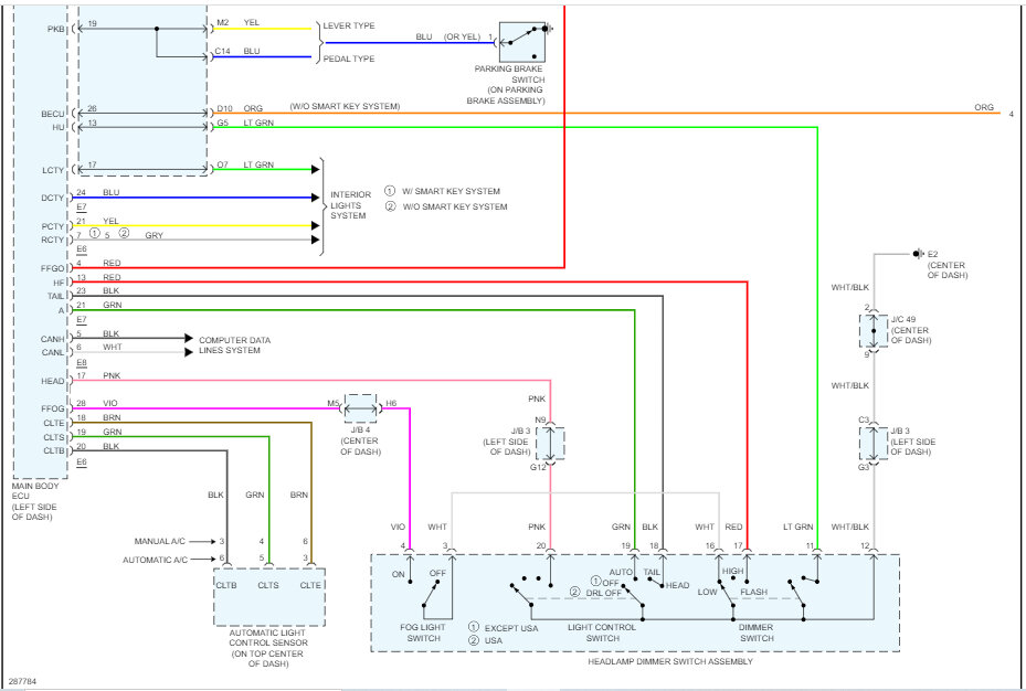

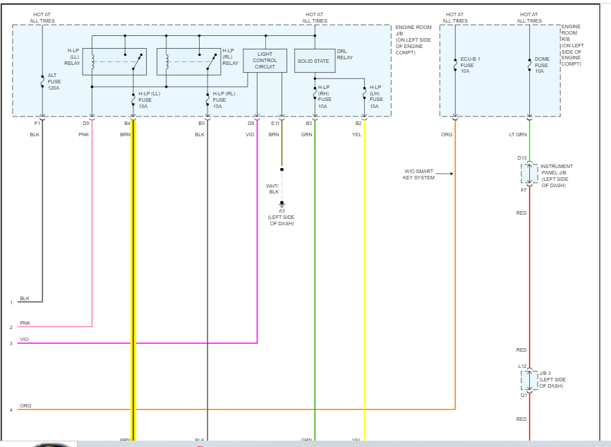

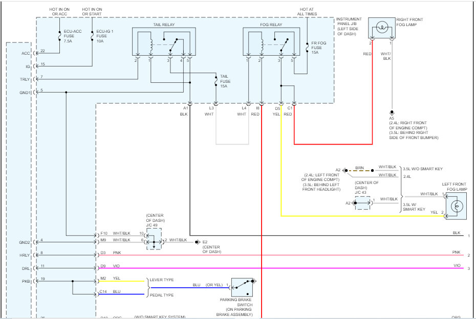

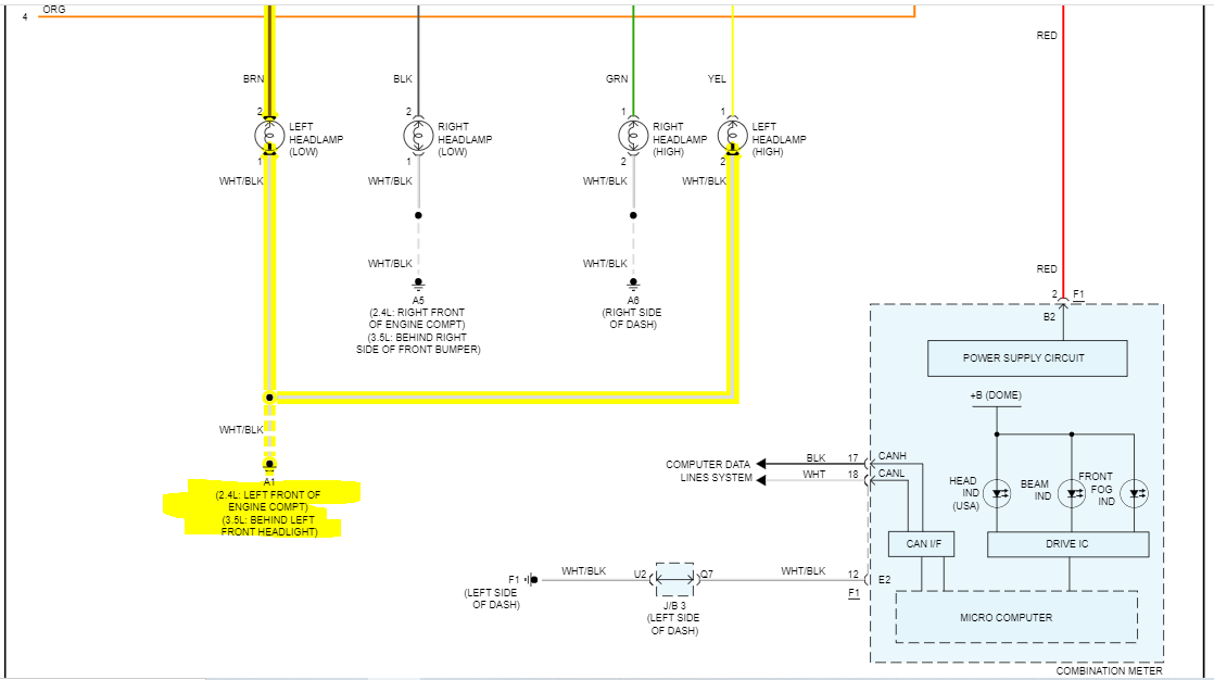

What you describe sounds like we may have a weak ground for the left headlamp. Interestingly, both the high and low beams (left side) share a ground with the left front signal. If that ground is weak, power can back feed through components (in this case the lights you mentioned) to seek a good ground. When this happens with a light, the light can turn on because power is running through it.

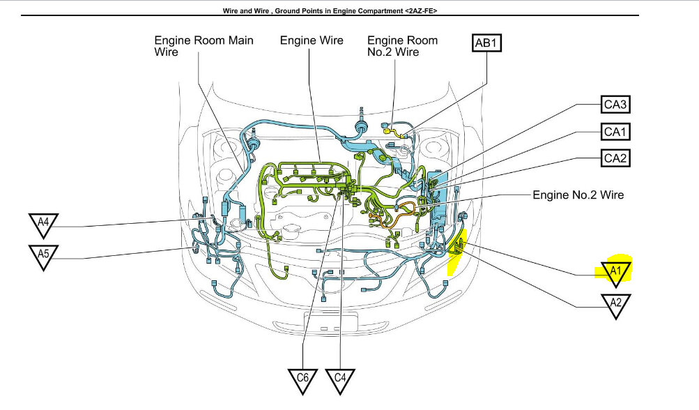

So, I attached the wiring schematic for the headlamps. We are looking for ground A1. It is under the hood on the driver's side.
Additionally, I attached the wiring schematic for the headlamp circuit. It is for a non-hybrid vehicle, so if you have a hybrid, let me know.
Also, the last pic shows the location of the ground. Check the ground for damage, corrosion, or a loose connection, and let me know what you find.
