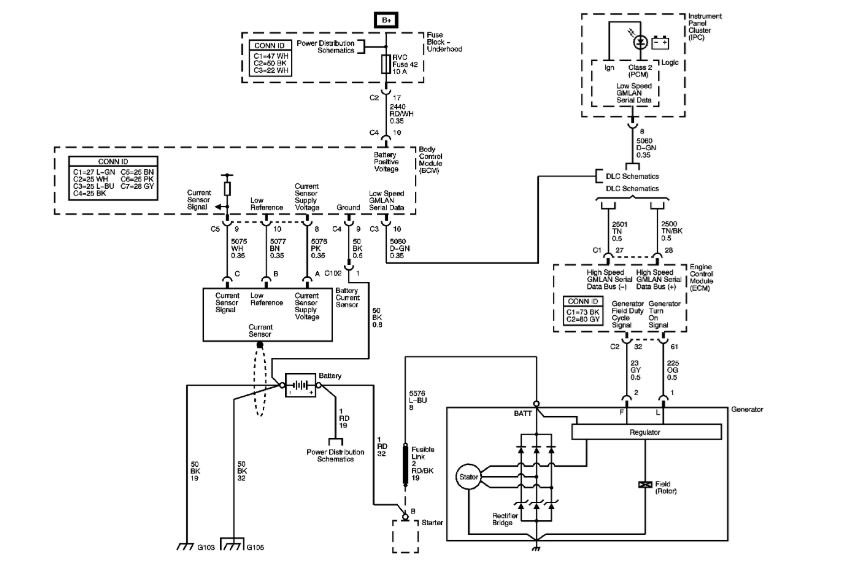

The first thing I would do is to check the voltage at the battery again. This time check for any AC voltage on your meter. If you have any AC voltage, the alternator is no good. The modules do not like AC voltage and do not know what to do with it when they see it and will set many codes and the system will act very strange.
The PCM does turn the field control on and off on the alternator and that needs to be checked as well. See if your scan tool can see the command on the alternator.

Does that include even trace amounts of AC power? I get, at most, .030v of AC at the battery. I have read that trace amounts are okay. Maybe that is wrong. I do not know. Could that loose wire account for these issues? I do not have problems replacing parts. I just do not want to keep taking shots in the dark.

Any AC volts is no good. Whoever said a little is okay is wrong.
Loose connection would stop it from charging, not allow it to overcharge.
