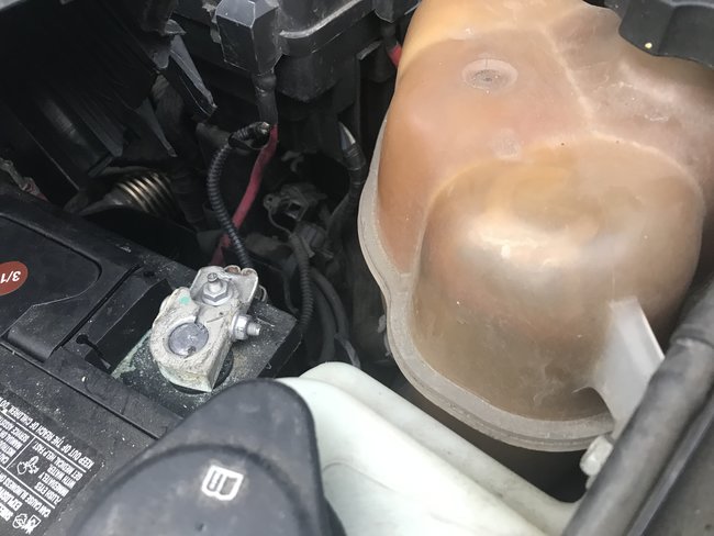

This has been a problem since I got the car almost a year ago. Every now and then, the transmission would slip. This would generally happen in traffic. Around 3,000 miles ago, I had a charging issue so I replaced the alternator. Instantly, the problem was gone 99% of the time. Now it is back. When I run my Bluetooth odbii app, I see the power range from the ECM is around 14.5 volts to 16.1 volts. No changing issues yet, but I am perplexed that the problem has recurred. I also noticed that there is a loose wire that goes to the negative battery post. I am not sure where it is supposed to go or if it is impacting this problem. I have attached a photo to illustrate.
Be grateful for any advice or insight.

16.1 tells me you have a bad alternator. The regulator is no good. The voltage should be 14 to 14.5 volts only. Anything beyond that is no good for any of the modules.
As far as the wire, it does look like a ground but since you have no other issues, it may be nothing. you could run it to the body and see what happens but I doubt it will make any difference.

Roy,

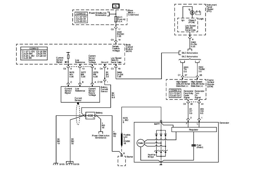

Since this is a new alternator, is it possible that the ECM is telling the alternator to put out that much power?
Also, the wrapping around the wire and the length suggests that it goes into a wire bundle of some sort. Any idea which one?
Sep 24, 2018 at 2:59 PM
The regulator is inside the alternator itself. The ECM just turns it on and off.
That is a bad alternator.
Is there any harness around there at all? I cannot see from the picture.

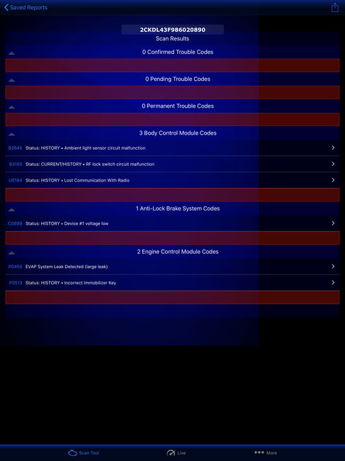

Attached a screen shot of my code scan.
Sep 24, 2018 at 3:03 PM
None of them are related to the transmission.
I cannot see the Body Control codes, too small.
Can you post the Body Control codes?

B2625, P0455, C0899. I do not think there is anything wrong with the transmission. Since the problem stopped when I replaced the transmission 2,500 or so miles ago, the problem must be electrical or with a computer.
Sep 24, 2018 at 3:31 PM
Okay, if the transmission is slipping then there is an issue.
The C2625 does not show as a valid code. Can you verify?
C0899
C0899

It is B2645. Does not this collection of codes - especially given the high voltage output, suggest an electrical issue?
Sep 24, 2018 at 4:14 PM
No, it suggests you have issues with these systems.
B2645 is a possible BCM failure. That may be related to the issue you have since it controls all body functions.

I will check. Is it possible for the ECM to command the alternator to output too much voltage? I am just trying to figure out why my new alternator is no longer working properly.
Sep 24, 2018 at 4:50 PM
Yes, it is. You would need a scan tool that can read the PCM and see if it is commanding on the alternator.
Either way, the voltage regulator is inside the alternator and that is no good since the voltage is way high.

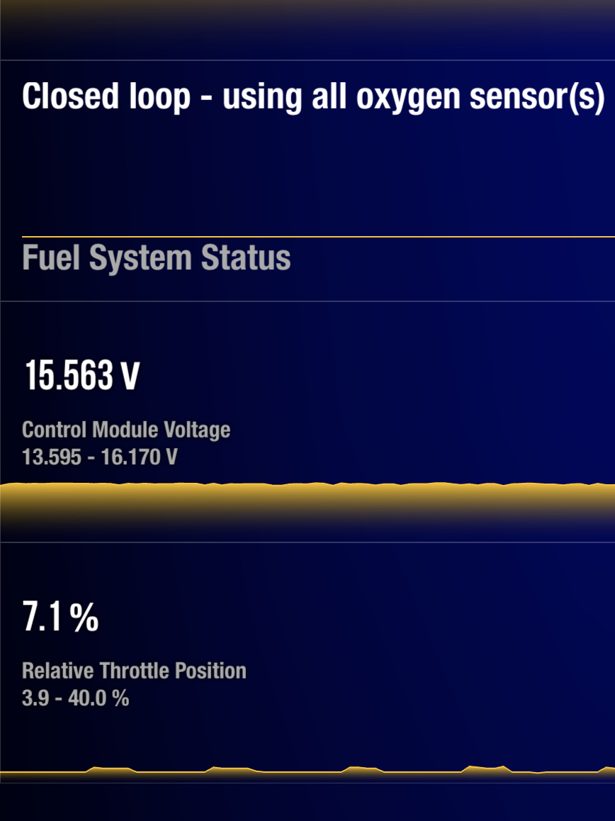

Attached is a live readout of power output. As you can see, the range is 13.595 volts to 16.1 volts on a five mile drive around the neighborhood. Lights, radio and A/C were on. This reading is in sync with my meter readings at the alternator itself. AC output was present, but very low. It fluctuated between 1/4 and 1/2 a volt.
Does this mean that a new alternator with less than 3,000 miles on it has a bad regulator or could it be that the ECM is commanding that much output? Until the voltage output issue is diagnosed, I think every other code is suspect.
Given this new data, what do you think?
Sep 24, 2018 at 5:46 PM
You need a new alternator. There should be 0 AC volts. You have a bad alternator.

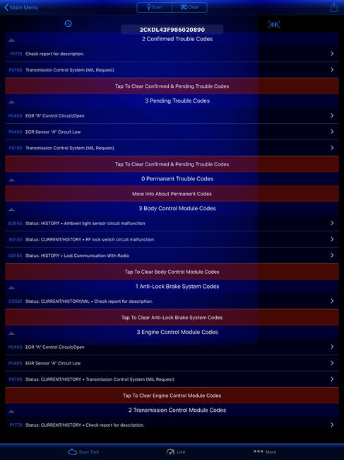

This is the never ending story of a car "ghost" that refuses to go away.
Bought the car in November 2017. A couple of weeks after I got it, the car start intermittently slipping gears. No real pattern of when. It just happened. One time it went into limp mode.
Fast forward to the summer of 2018. I get a charging system error and the car shows all signs of a bad alternator.
I install a new alternator - magic. The problem stops for a considerable number of miles - probably 3,000 and then it starts up again. Test the alternator and it is throwing out over 16 volts, so bad voltage regulator, right? Replaced the alternator again. Now all heck is really breaking loose. I am getting the following codes:
P1719
P0700
P0403
P0405
B2645
B3155
C0561
P1779
In addition to the transmission slips, it seems like the engine is revving too high. When I am at a light, it feels like my foot is lightly on the gas pedal. If I shift into neutral, RPM's briefly increase by 600 RPM's and then they go back to normal. When I shift into reverse, I can feel it wanting to bolt backwards and the car rumbles a bit.
I suspect that this is all electrical and related to one or two specific things. I am just stumped as to which ones.

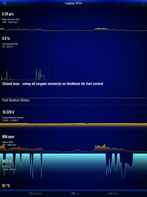

I am getting about 15.5vdc on my Fluke at the battery. I am also attaching snapshots of the report and the live computer feed.

The first thing I would do is to check the voltage at the battery again. This time check for any AC voltage on your meter. If you have any AC voltage, the alternator is no good. The modules do not like AC voltage and do not know what to do with it when they see it and will set many codes and the system will act very strange.
The PCM does turn the field control on and off on the alternator and that needs to be checked as well. See if your scan tool can see the command on the alternator.
