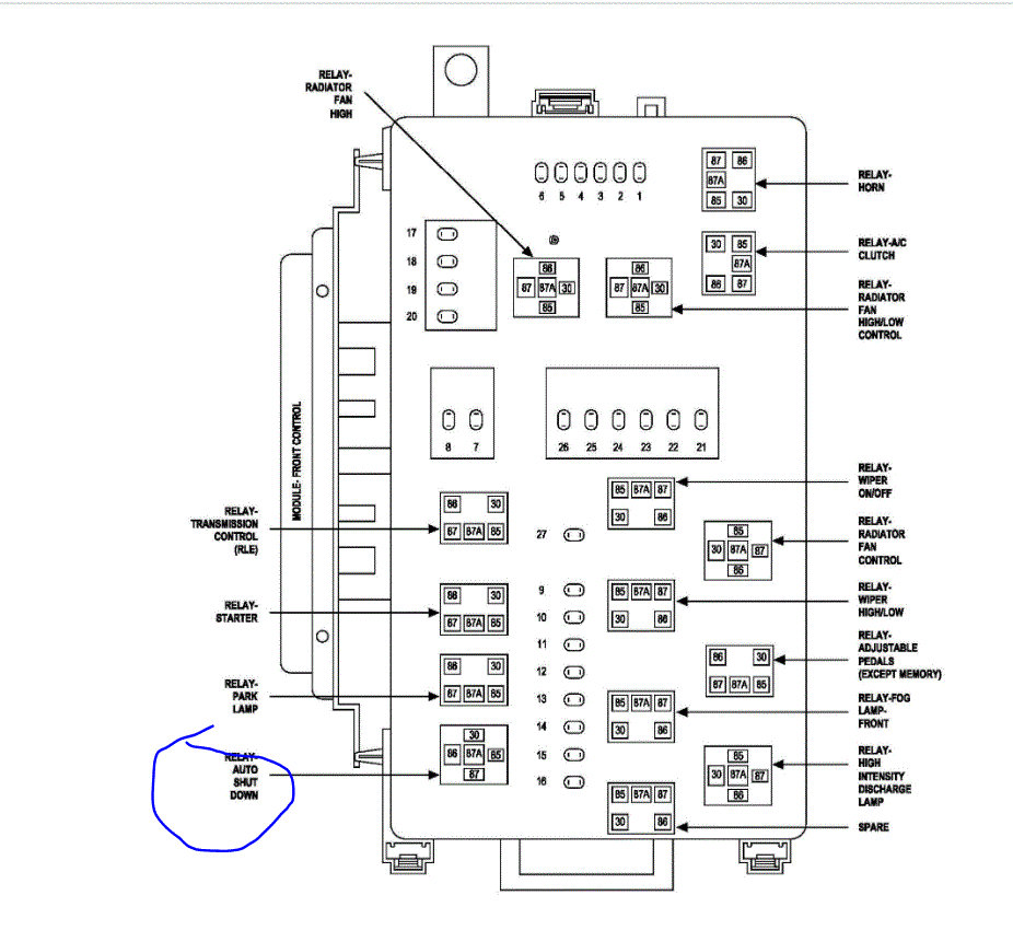

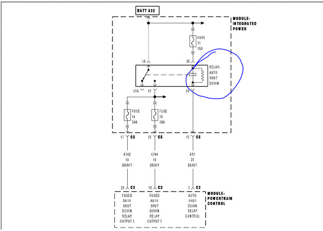

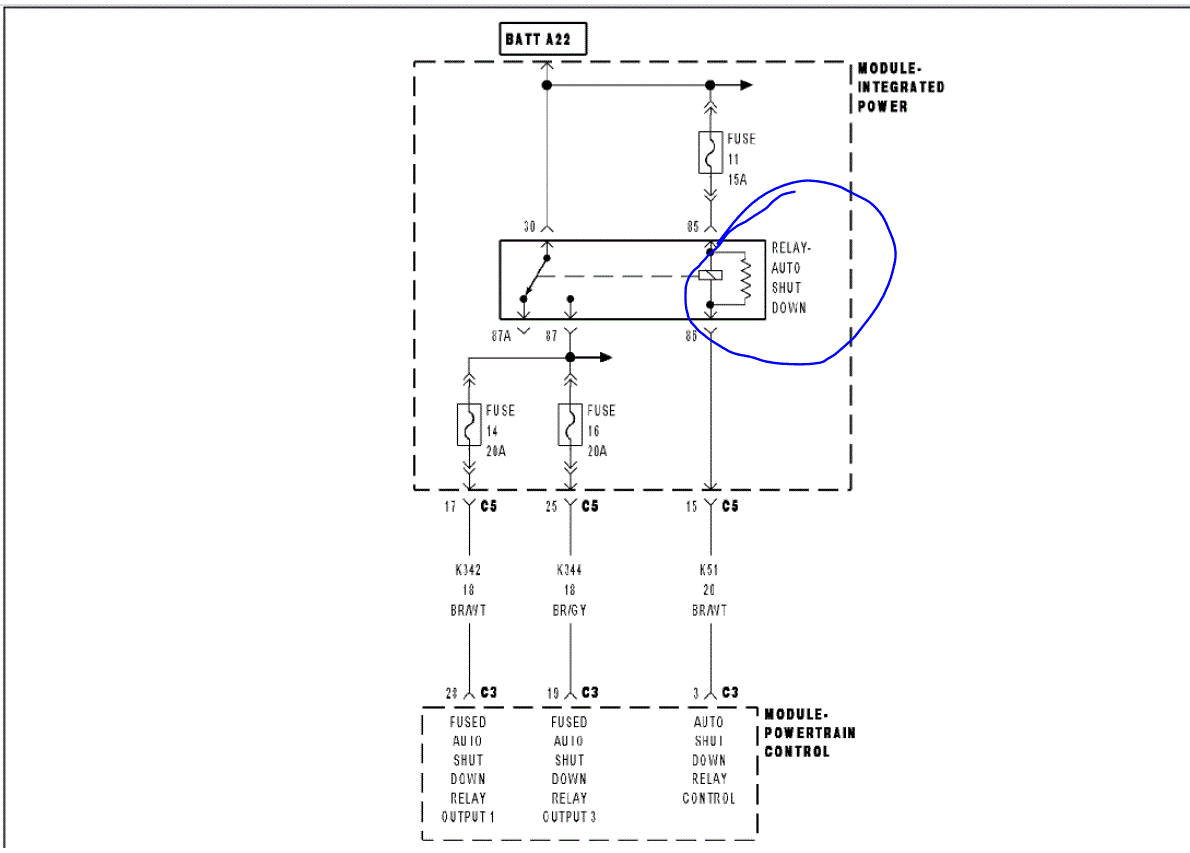

Here we go again same issue as last year hot day; many stops and get in turn the key and nothing, the dash lights came on as normal and I knew it wouldn’t start as before due to I did not hear the fuel pump pre load. After reading a lot off post at magnumfourmz, I found someone describing the same symptoms and 1- reply he got was vague but they mentioned something in the ignition didn’t make a good connect not sure if good info or not. As usual 5 minutes later car started with no problem, this is getting fun! Any thoughts?
Thank you!
Saturday, August 29th, 2020 AT 4:42 PM
  • 109,874 POSTS
Is the starter engaging? Let me know the engine size as well.
As far as what you described, it could the auto shut down relay or again the crankshaft position sensor. I'm not sure what helped the last time.
I attached a couple pics below. If the starter engages and you don't hear the pump, switch the ASD relay with a different one in the relay box and see if it makes a difference. Also, make sure there isn't any corrosion or a loose connection.
Saturday, August 29th, 2020 AT 9:11 PM
DODGETREE
Okay, thank you for diagrams. Last time you recommended changing the crankshaft position sensor and I did that already, so that shouldn’t be the problem. I will check relays as you recommend, the engine is 5.7 and the starter does not engage at moment of turning key. Again thank you for your ideas. I drive the magnum approximately 2 or 3 times a month. I am in St Louis Missouri, very humid. The car is in a garage that is not climate controlled.
