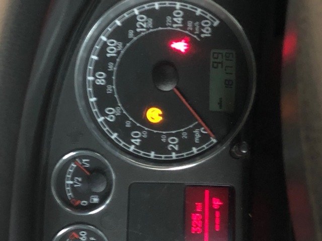

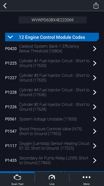

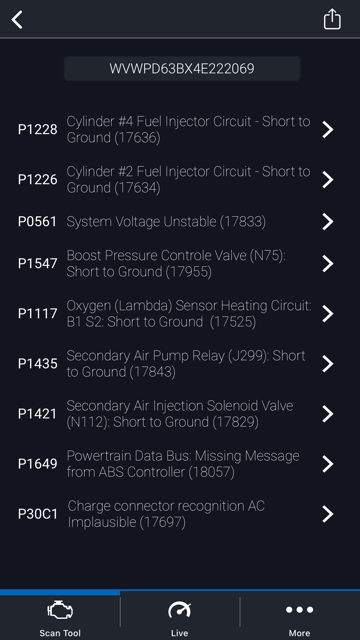

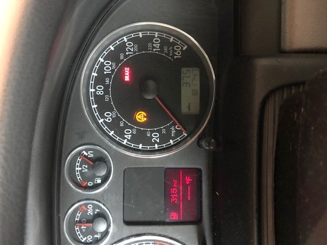

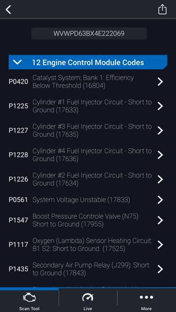

I have been having a problem with my car. It randomly will not start usually after it has run for awhile and then shut off. Sometimes will not start right away. Also if it starts and you just put it in revise without letting out the clutch it shuts off. I have attached a screen shot from my phone of all the codes. There are 12 codes. many of them short to ground? Also included a picture of a check engine light that I can not find the meaning to? please help.
Aug 22, 2020 at 3:44 AM

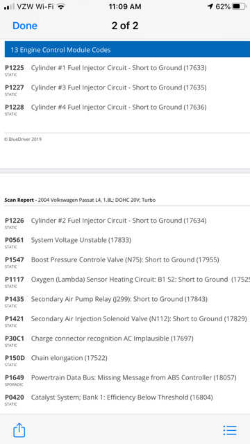

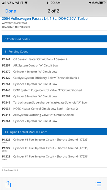

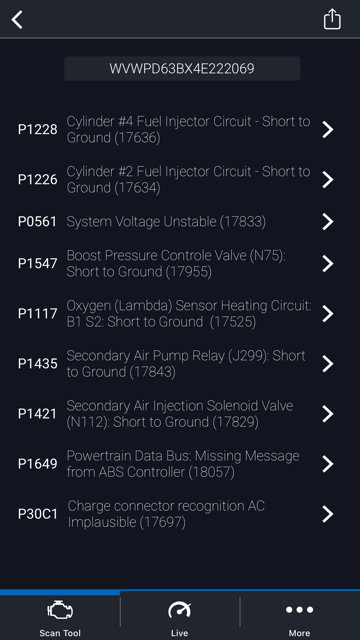

That is a lot of codes but let's start with the simplest solution that could cause something like this and that is the battery.
Let's load test the battery and see if it passes. If does let us know. If not, clearly we need to replace it.
There are quite a few different issues with those codes but the voltage unstable is where I am looking. Again, let's start there and see make sure it is okay.

Great to know but that will do for now. If we need to circle back because we don't turn anything else up then we can. However, how often does this happen? Is it something you can get to act up frequently?
If so, since we have the codes documented above, let's clear all the codes and then get it to act up again and check the codes again. The reason is, some of these codes may be from removing the battery and hooking it back up. There are a lot of short to ground codes and that could be due to a wiring issue but I don't want to chase something that is not "real" so if all these same code or most of them come back then we know they are actually pointing to the issue. My bet is that the short to ground codes do not come back but some of the others do.
Let me know this info and we can go from there. Thanks

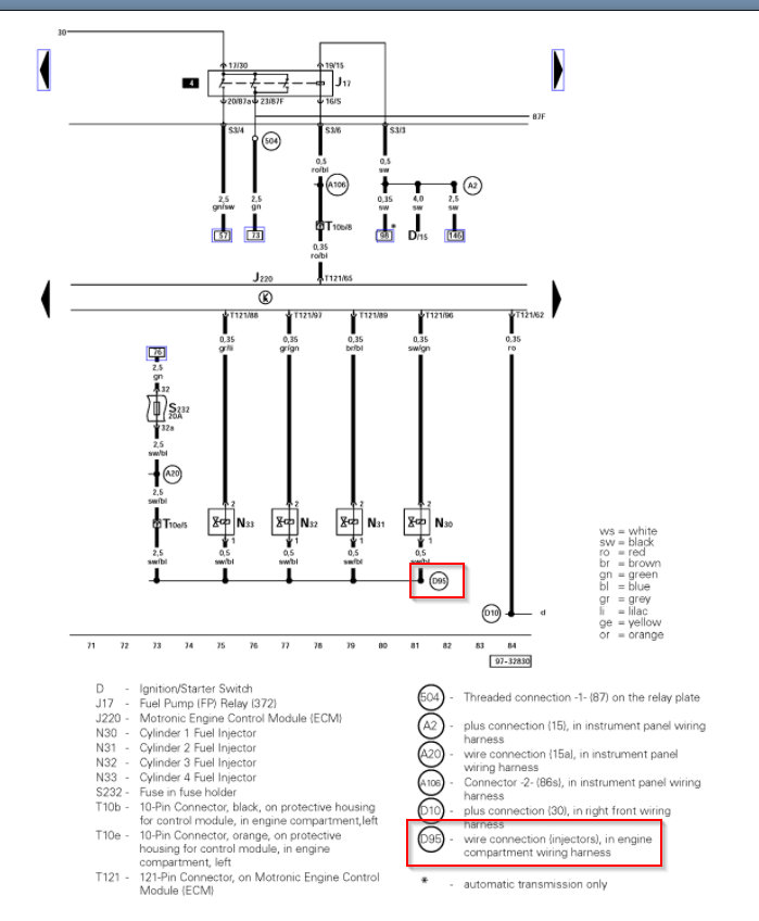

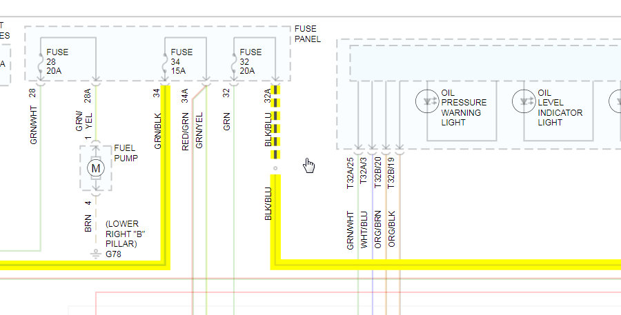

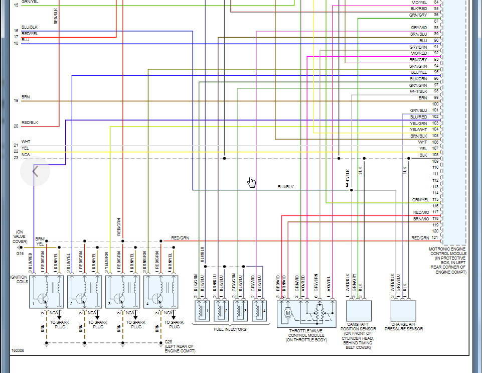

Interesting. At the end of this I suspect we have a wiring issue in the engine harness. Take a look at this wiring diagram. I would suggest locating the wiring harness for the injectors and tracing it back to the PCM looking for a place that it is rubbed through. The fact that you have all the injectors and multiple other components showing that there is a short to grounds just points to this. Due to the injectors all having this same code is the best place to start. I fully expect you are going to find the harness has a rub through where it is touching metal. Let me know if you are able to find it and we can go from there on how to repair it. If you do can you get a picture?

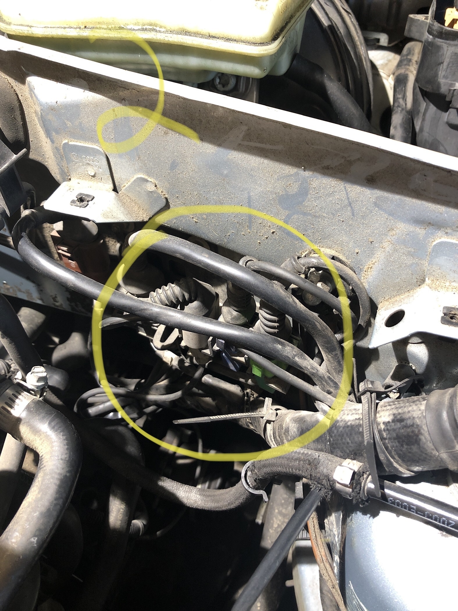

I'm sorry I thought this message was already sent. Should I pull wires out of the harness to inspect or leave them in the harness and look for a place were they have shorted out against each other or on metal? Or just disconnect harness inspect that way? Yeah, the harness starts on top then disappears between engine and fire wall and goes down. It must come back up because the computer sits top right of engine compartment. I will be working on it this afternoon.
Aug 30, 2020 at 3:25 AM
I would recommend leaving them in the harness and looking for where it may have rubbed through. More then likely you will see damage to the protection shield and then you will see the wiring itself. However, the idea is to find the place that it is laying against something. so it is not like you want to remove the harness to inspect it as you want to see it as it lays.
The fact that it goes down between the engine and firewall you may have to pull it out from there. But other then that you will want to inspect it as it sits. Just twist it and move as needed to see all angles.
Thanks for the update. Let us know what you find.

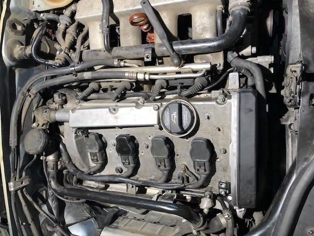

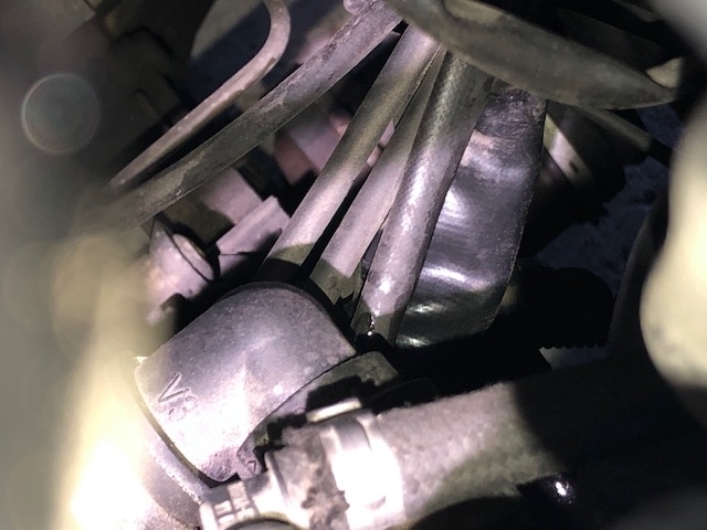

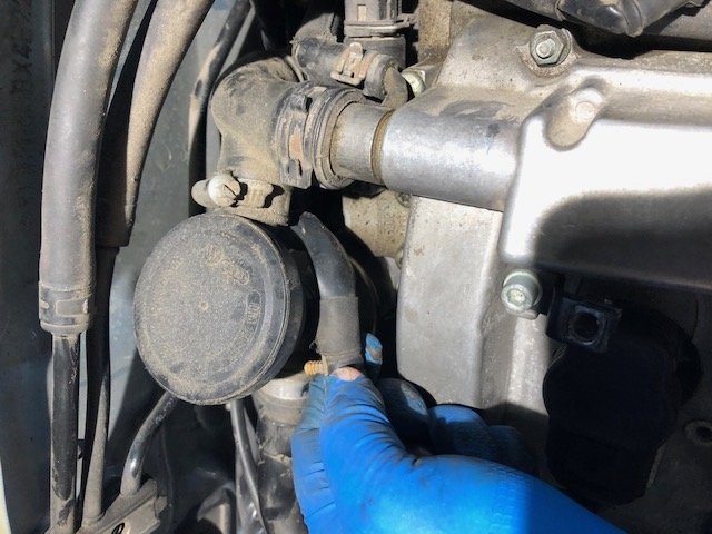

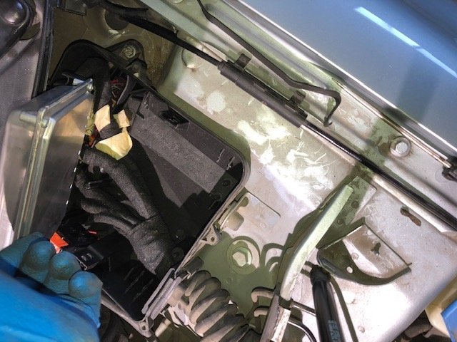

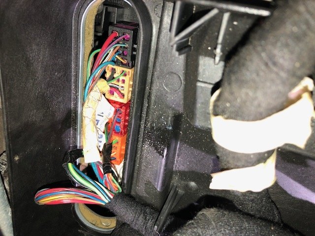

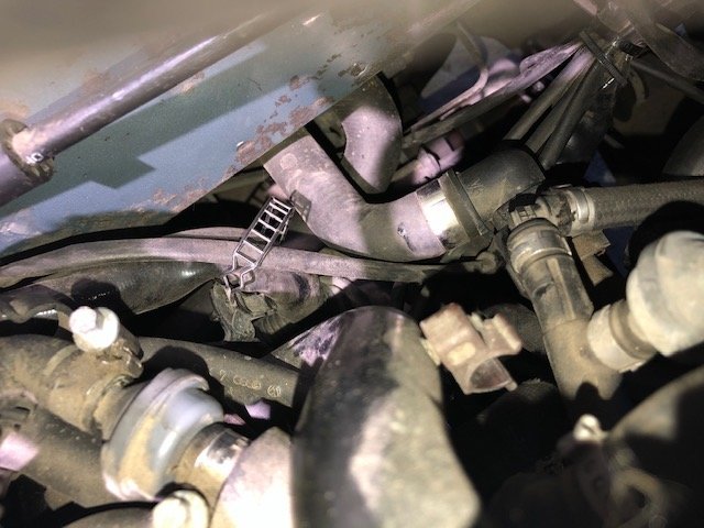

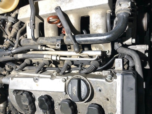

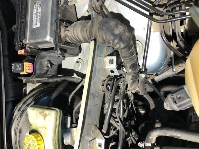

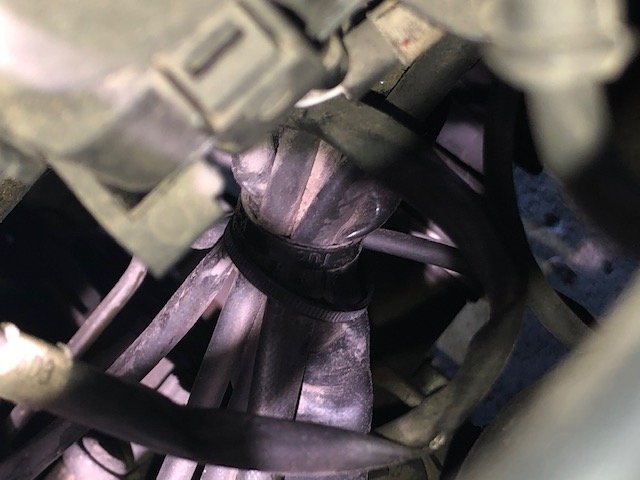

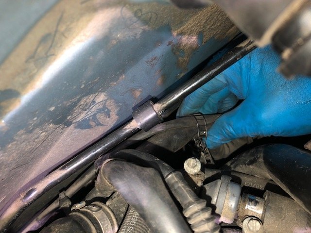

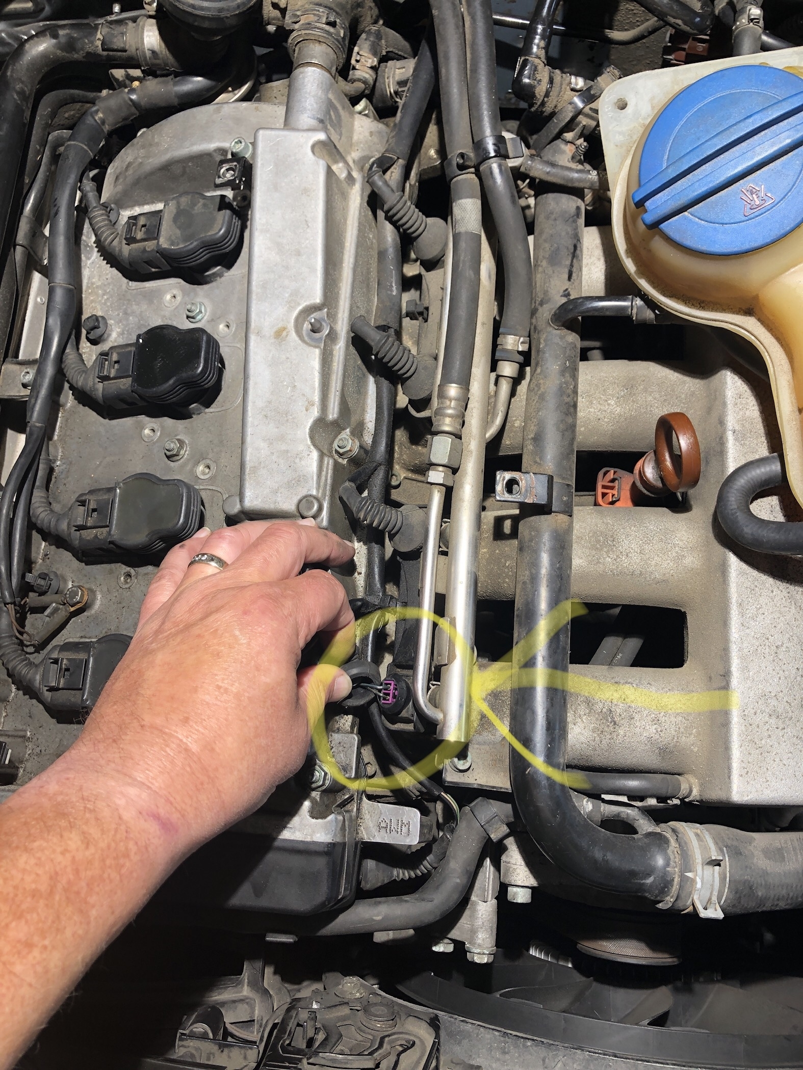

Hi Kenny, I have included these pictures of the harness and dang it! It actually seems to be in good shape. I thoroughly inspected the harness and followed back to the computer. There were several places that were potential pinch point and or rub points, but upon closer inspection they there were not frayed wiring or damaged sheathing. Dang it! There was one place where the harness was attached to a bracket and couldn't see to well but i was able to take off my gloves off and slip my finger between the bracket and harness and the once again the sheathing was undamaged. So I wouldn't bet my life on it with out taking the harness out and taking the wires out of the harness but at this point I did not see any damaged wiring. So what should I do now?
Sep 5, 2020 at 7:40 AM
This is a tough call. So all I can do is tell you what I would do with all these codes. I would pull one of them like one of the injector codes and run a new wire from the ECM to the injector so that I can get that code to not return. Then move onto one other like the turbo charger. If running new wires just over the engine or in a direct (safely routed) route just to confirm this is a wiring issue, I would then replace the harness.
With all these circuit low and short to ground codes, I am sure you have an issue in the harness touching some metal but I want to prove it out and the way to do that on intermittent issues is to just run a temporary wire (cutting the original wire at both ends to eliminate it) so that you can drive the vehicle to confirm this code did not return.

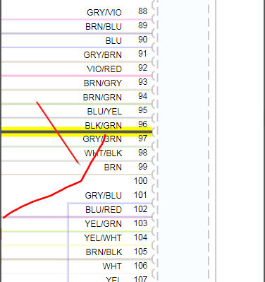

With the included pictures you probably has figured that I am Elizabeth. I am David, Beth’s husband, she set up the account on an issue a while back and you helped us. So we just use her account.

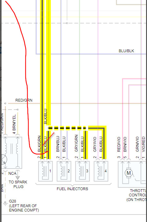

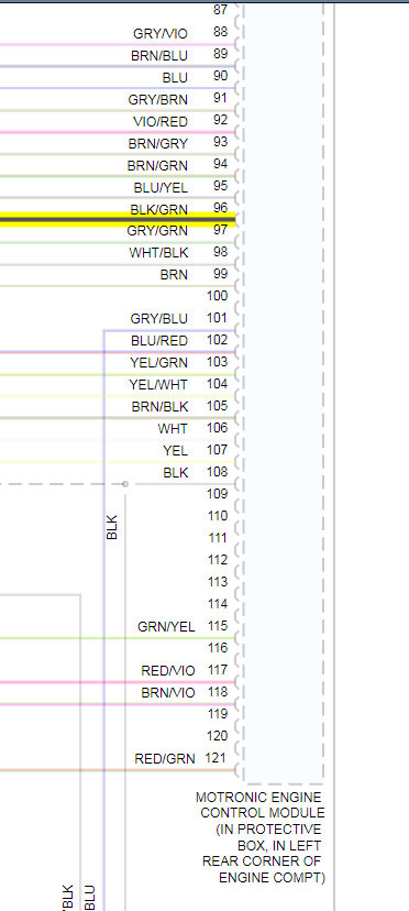

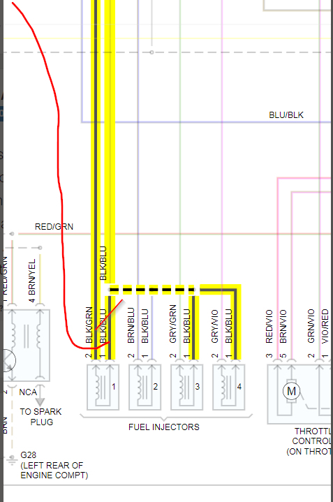

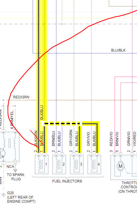

Attached pictures and questions. I see on the diagram color coding. Can you tell me or point out on the diagram which cylinder is number one and which is four. Is it front to back or back to front.? Also there are a series of connectors that are close to the computer box. Did the injector wires run to these connectors and then to the box or to the end of the actor wires run directly to the computer? I’ve been clued it included a picture of the connectors in the computer module box I am assuming that all the wires from the harness run to these connectors and then connect to the computer module.? Also, I see the injectors, where is the turbo chargers or charger?

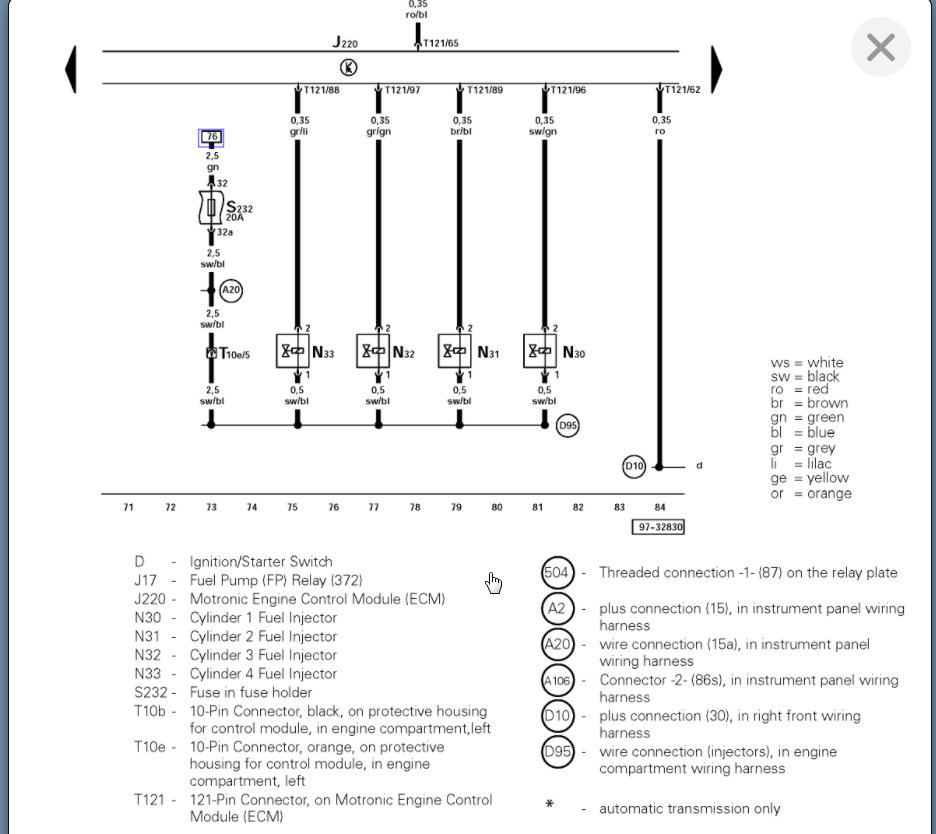

You are correct. You just run new wires for a couple of the components and if those specific codes do not return then you know these are all almost sure to be related by the same issue.

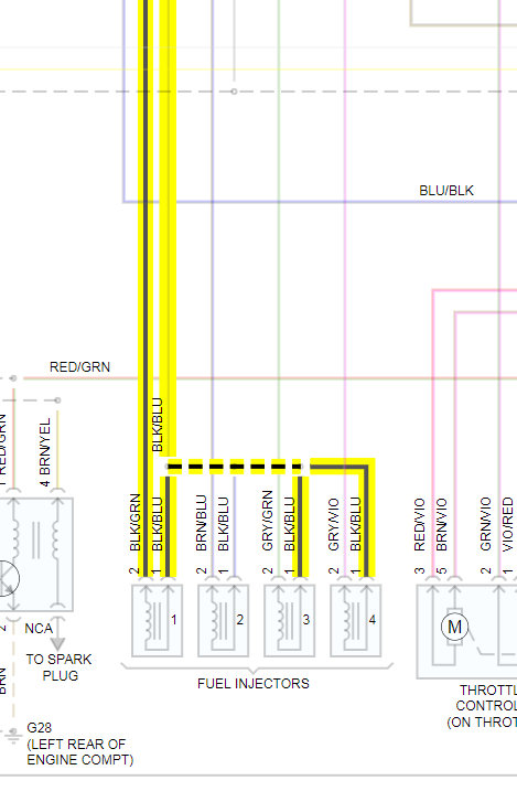

So your injector should have 2 wires (the picture is a little small). So the black/blue wire is the 12 volt feed and will be the same for each injector. The other wire goes direct to the ECM. You need to do both wires but if you want to do one at a time that is fine as well.
I would cut the wire about three inches behind the injector and ECM and then run the new wire. I included the wiring diagrams. The ECM is a little tricky to find the wire but clearly it is going to be the same color and it is in terminal 96.
I am trying to find a connector view of the ECM to help but have not found one yet.

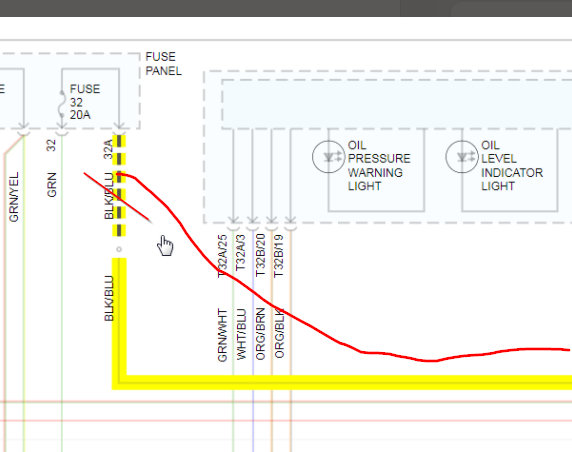

Questions I will just cut to the main thing here. I have many questions I’m curious about having studied the diagrams you have sent but at this point I just want to get Beth’s car back on the road. So the black and blue goes to the ECM. Where does the other wire go? And do I need to replace wire back to the fuse panel or just to the ECM box ?
Sep 7, 2020 at 3:07 AM
Correct. You cut the wire and then run a new one. The first two screen shots are the first wire from the fuse box to the injector. The second two screen shots are from the injector to the PCM.
I would replace both.

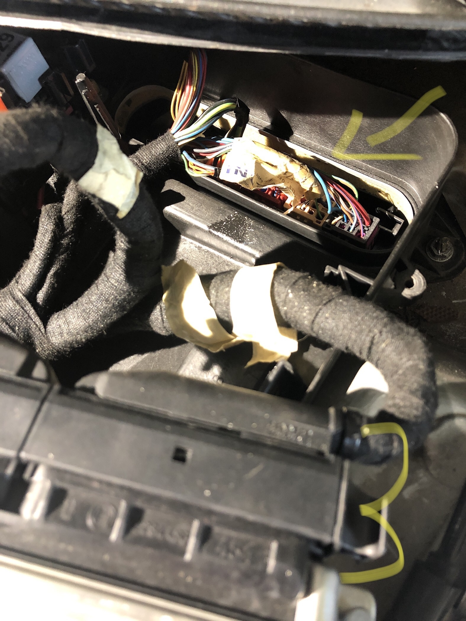

Hi Kenny, I know its been awhile but here is an update: From our last conversation I was going to test cylinder one by routing two new wires back to the computer to test out our theory, however the wires were covered in tape by the computer, the wire was faded by the injector and I could not find the correct pin by looking at the diagram. So I decided to get radical and pull the wiring harness off. I did not find the expected short to ground quite the opposite the wiring harness in the engine compartment seemed to be in excellent shape. After having the harness off I traced all the wires from the all 4 ignition coils and injectors back to the computer. I checked all rub points and opened up the harness in different positions that looked suspicious only to find wires in perfect condition. the wires move freely in the harness and no visible damage to the wires. I could see 90% of the harness by manipulating the covering. Also I used my multi meter to test all wires from injector and ignition coils to computer. All wires check with 0 resistance. I also followed the wires from the computer which is in the engine compartment back to the fuse box. Now I did not remove any of the dash but was able to see a good portion from the fuse box under the dash and then trough the fire wall. not sure percentage wise what i could see but things looked in god shape from what I could see. There is one place were it looks like a plastic side panel is kind of awkwardly sitting against the wires coming from the computer I will pull that panel today and look for shorts. If that looks good then what should I check next? What should I do next?

Oh yeah, forgot this part. So got the harness back on and looking pretty, geez that was a job. Started right up, drove it for 30 minutes no problems. pull into the garage shut it it off immediately try to restarts and wouldn't start. To be clear it will turn over just will not start. Just went to garage just now and started. Although it seems to take more turns of the engine to start then it use to, but it did start and was running well.

Well that is good news and not so good news. So if the wiring is all good then that convinces me that the issue is a spread terminal in one of the connectors. Forgive me if I am getting this wrong as it has been a little while but in reviewing this, if you disconnected them and found no issue with the wiring but hooked it back up and it worked, then it didn't but then it did again, that tells us that we have a loose connection. This would make sense as we seem to have a circuit issue but the wire is fine. That only leaves the terminals.
Do you have the same codes? Any specific circuit codes?

I will rerun my blue driver and post the codes. but in short there was short to ground on all 4 ignition coils and all 4 injectors. So is there a connector or component in common with them all? I will post codes shortly.
Nov 25, 2020 at 2:11 AM
Well, that is good info but it depends on how you tested it. What wire on the coils and injectors were shorted to ground and did you have everything still hooked up? Meaning were the coils plugged in? The only thing they have in common is the ECM but if they were still plugged in, I suspect you were just picking up the ground through the component. It is interesting because the injectors are grounded by the ECM so until they are grounded by the ECM they should not have any ground.
