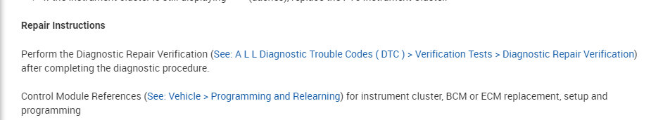

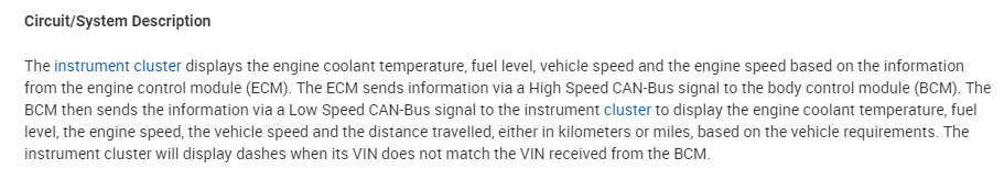

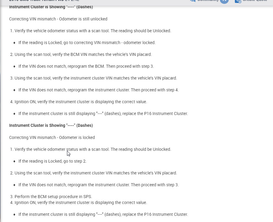

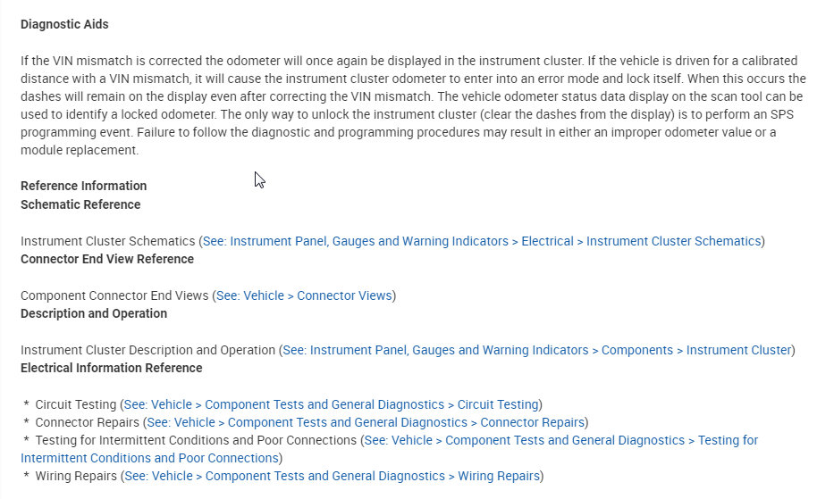

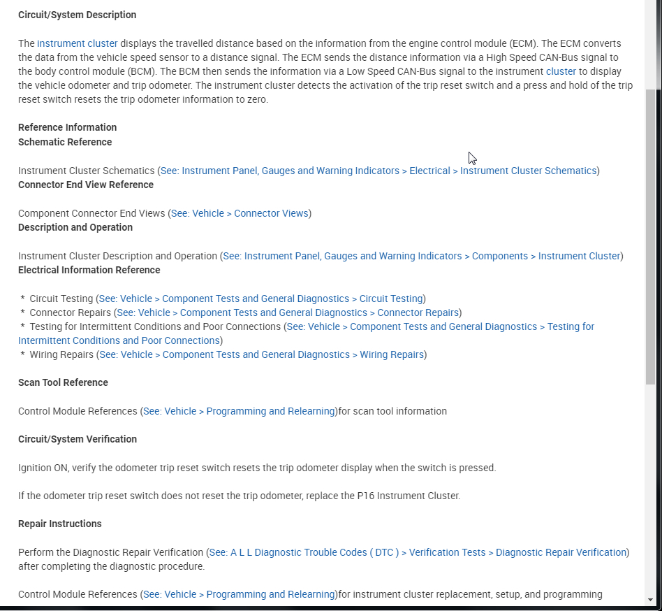

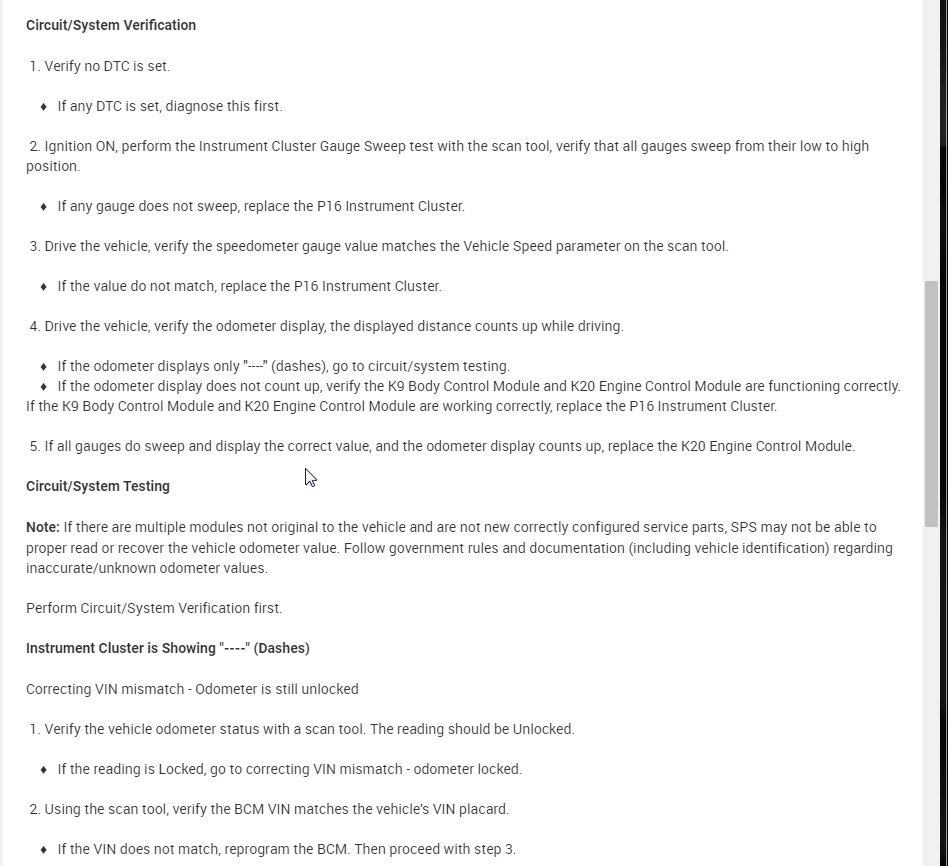

Both could be correct but I am going to side with the dealer and the cluster being the issue since they inspected it. I imagine they went through the testing that is included below. I attached quite a bit of info but the last couple of pages is what you need specifically the last part of the last page.
The dashes mean then VIN in the cluster does not match the VIN in the BCM. There is a process that is laid out with the scan tool that you can verify that the cluster is the issue.
As for the BCM's involvement in this, the ECM tracks the mileage. It then sends the info to the BCM which sends the info to the cluster to display it.

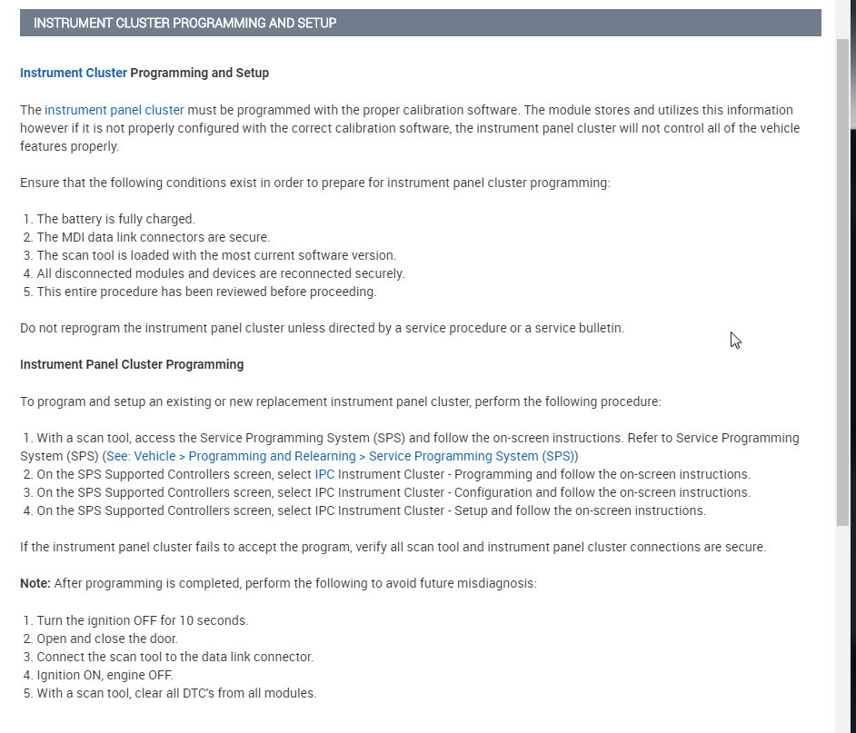

Let's run through this info and let me know if you have questions. I included the process of programming the cluster but again, you need a scan tool. I would suggest asking the dealer if they did the testing on the last page and if so, then they are correct that the cluster is the issue.
Let me know if you have questions. Thanks

Yes. They should have detailed notes about what they found. They normally provide some of this info but not always. I would just call and ask to either speak with the tech and see if he went through the test that I provided or ask to read the notes that they made while they were figuring out what the issue was.
However, based on what I am hearing and the test info that I provided, I think the dealer was correct with what they recommended as the issue.
Most handheld scanners that you would buy for a reasonable cost would not perform what you need. This is a dealer tool and the aftermarket scan tools that give this level of detail are very expensive.

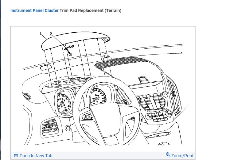

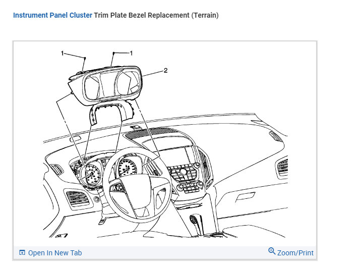

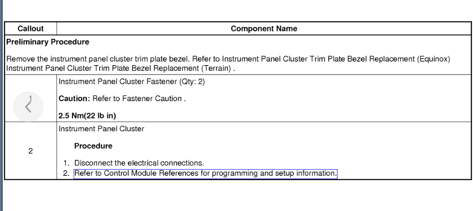

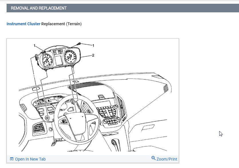

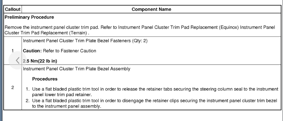

Do you have a diagram on how to take the cluster out? If I purchase another cluster and put it in myself, would it work? Does it need to be programmed or cloned or would it just pick up where the last 1 left off?
Thanks again,
Angel
Jan 31, 2020 at 11:29 AM

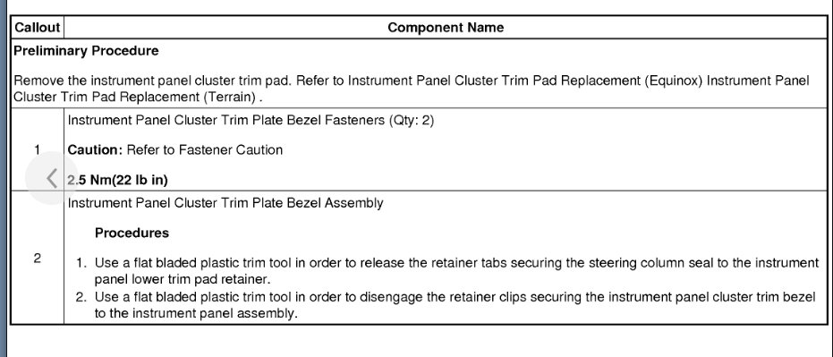

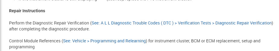

I attached the process to replace it and the process to program it. You do need a scan tool to do this and if you get a used one, it will more than likely cause a similar issue to what you have now with the dashes. The dashes indicate a VIN mismatch which means the VIN that is in the cluster does not match that in the ECM. Unfortunately I would say you need to purchase a new unit and then have it programmed.
Jan 31, 2020 at 11:41 AM

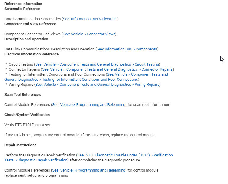

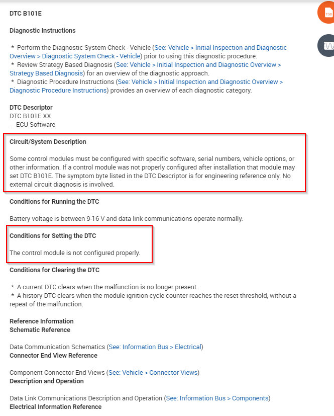

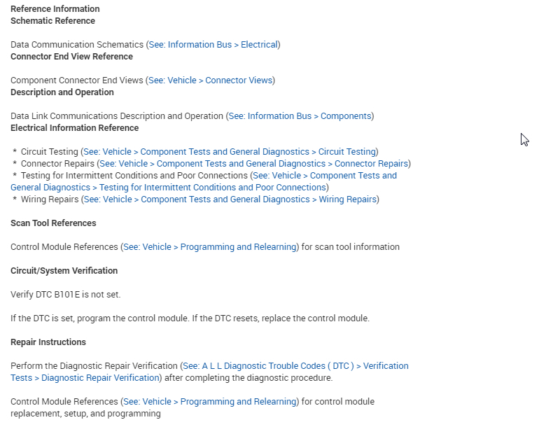

So I found out what code, it’s B101E Stored Internal Malif. of Cluster. Any info on that would be greatly appreciated.
Feb 8, 2020 at 12:46 AM
I attached the info on this code but this makes it more clear why there are dashes and why they are saying it needs to be replaced. Basically this code is telling you there is an internal failure and the control board is no longer programmed so it is a mismatch of info. That is why the dashes are there. That indicates the same thing.
Looks like I would agree with the shop that the cluster needs to be replaced and programmed.

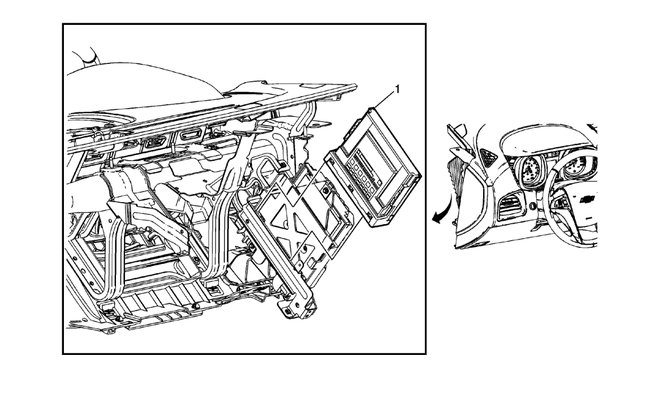

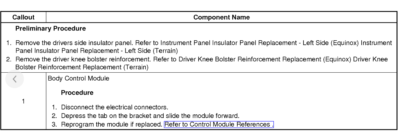

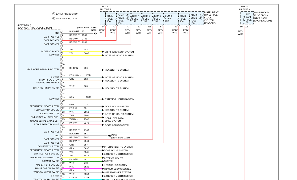

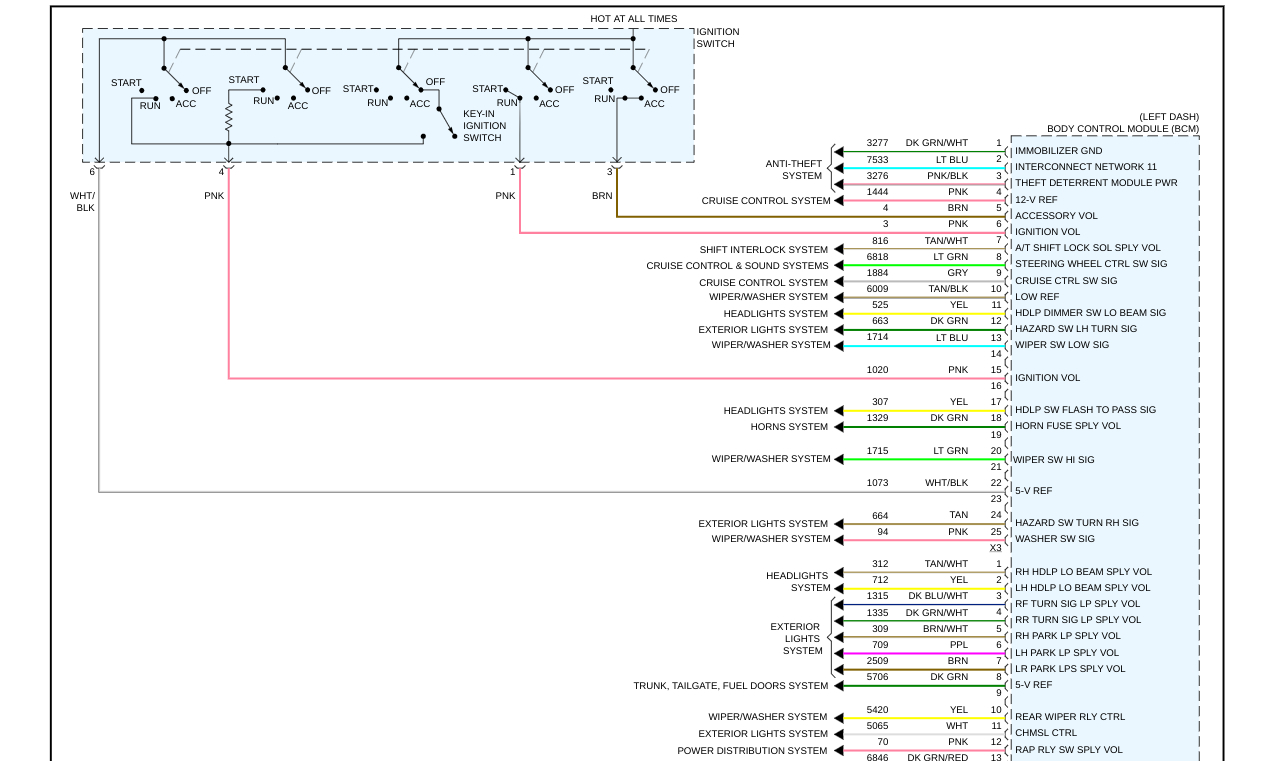

I haven't heard back so I'm just checking to make sure you got my question. I could have the BCM checked. Do you have a diagram of location and removal?

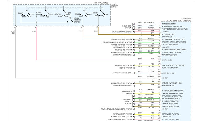

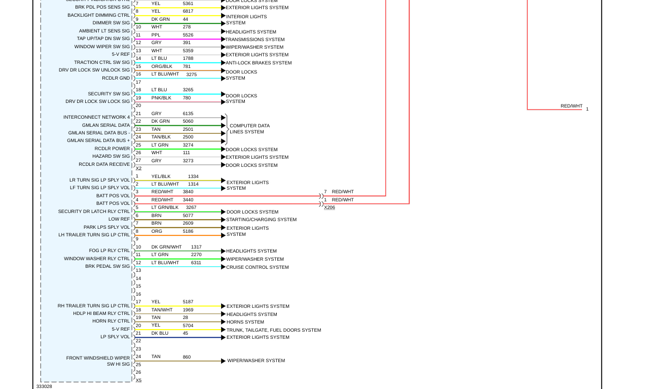

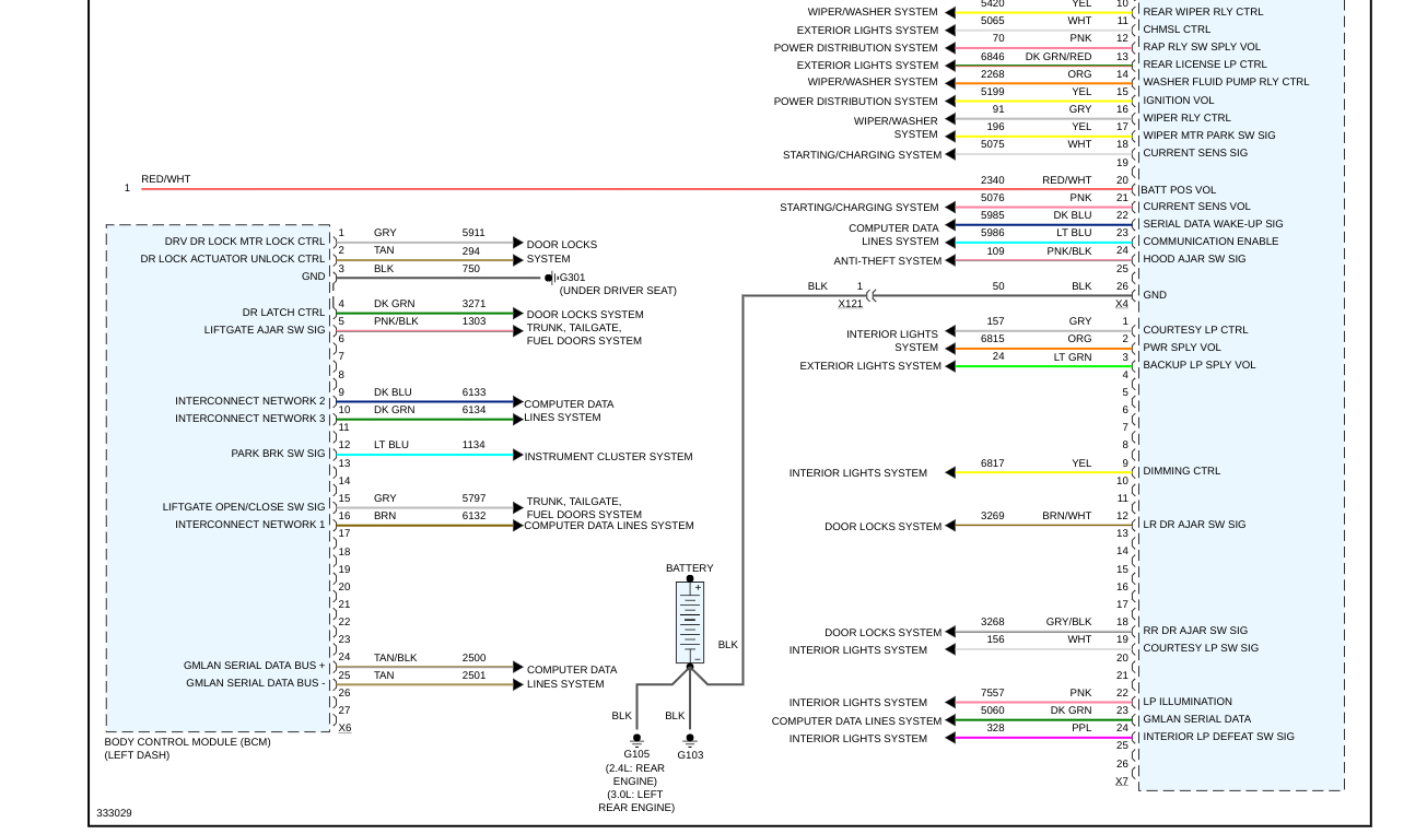

TOUGHDIVER
  • 226 POSTS

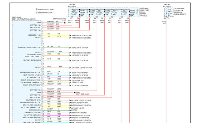

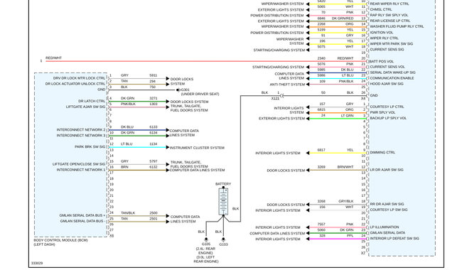

Sorry about the delay. I'm attaching location and removal for the BCM and wiring diagrams below. The wiring diagrams are in cut in 1/2 for easier viewing. Let us know if you need more information.
Thanks
Joe T.

Can you tell me what code B101E means?
Thanks,
Angel
Feb 23, 2020 at 11:14 PM
  • 55,395 POSTS
Code: B101E 48; Definition: Electronic Control Unit Software Security Code Not Programmed; So it sounds like the BCM is not working correctly. This is where the security is held.
