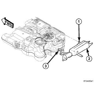

Pic 1
WARNING: The fuel system is under constant pressure even with engine off. Before servicing any part of the fuel system, the pressure must be released.
1. Remove fuel cap.
2. Release pressure in fuel system, See: Fuel Pressure Release > Procedures > Fuel System Pressure Release Procedure.

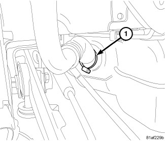

3. Remove hose clamp (1) and remove fuel fill hose from fuel tank.

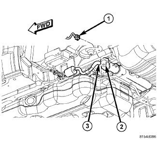

Pic 2

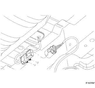

4. Disconnect fuel pump electrical connector from body harness connector.

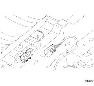

Pic 3

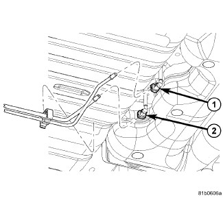

5. Disconnect fuel line quick connect fittings (1) and evaporator hose (2).

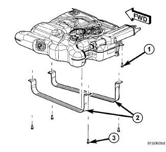

Pic 4
6. Disconnect electrical connector (1) from evaporative system integrity monitor (ESIM) switch (2).
7. Disconnect fuel fill vapor hose (4) from fuel tank control valve hose.
8. Disconnect fuel fill vapor hose (3) from ESIM switch (2).

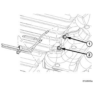

Pic 5
WARNING: Support fuel tank with a transmission jack or equivalent. Use straps to secure the fuel tank to the jack. Failure to properly support and secure the fuel tank during removal may cause fuel to spill or fuel tank to fall from jack assembly.
9. Remove fuel tank strap bolts (3) and straps (2).
10. Remove vapor canister bracket bolt (1).
11. Lower the fuel tank.

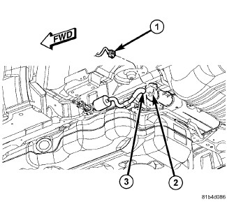

Pic 6
12. Disconnect evaporator quick connector (1) from vapor line.
13. Disconnect evaporator quick connector (3) from fuel tank control valve.
14. Remove vapor canister filter (2).
15. Remove fuel pump module, See: Fuel Tank > Removal and Replacement > Fuel Tank - Removal.
16. Remove all fuel and vapor lines from fuel tank.
