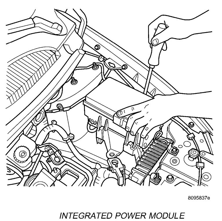

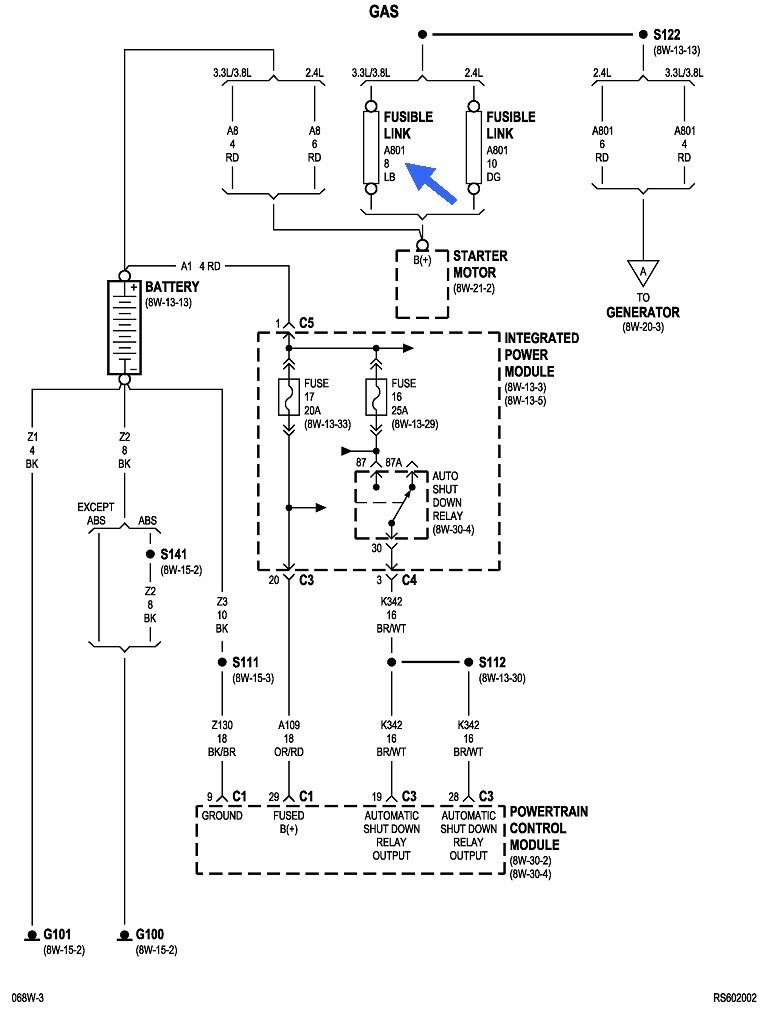

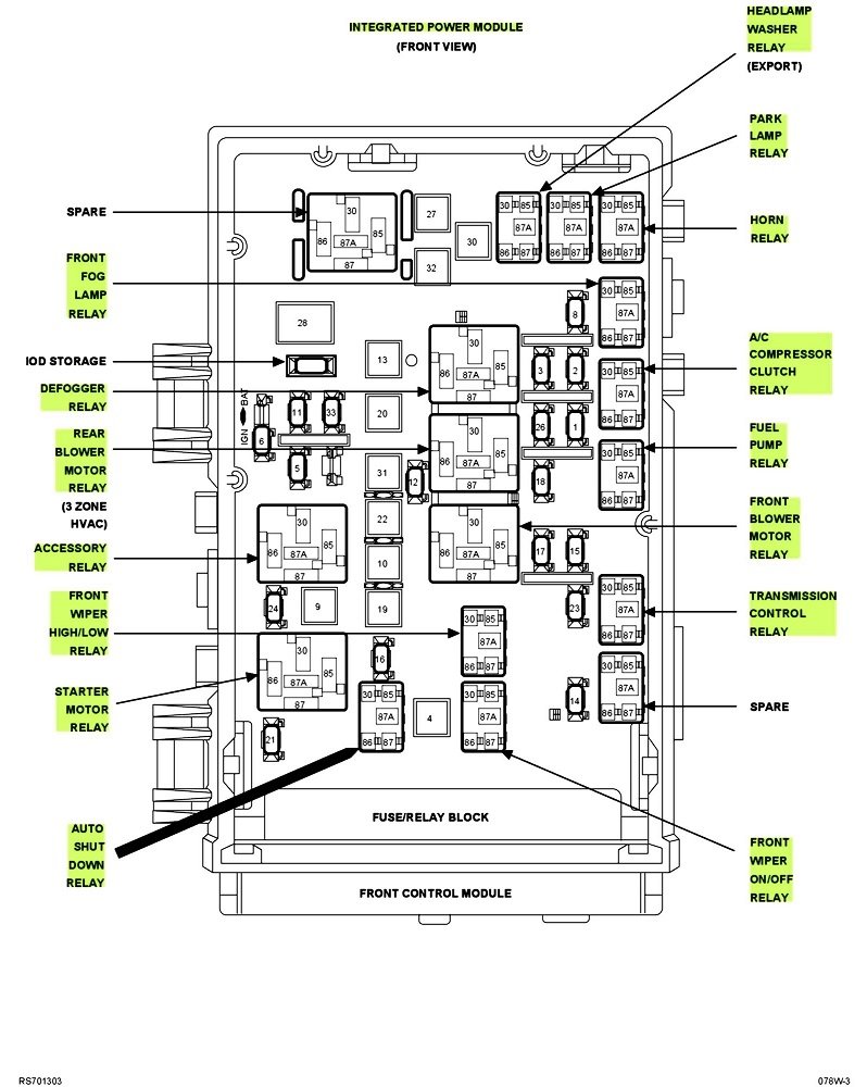

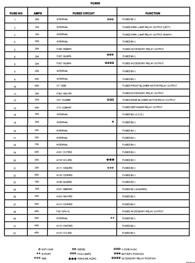

When installing the battery, I decided to replace terminals and put them on the opposite cables. Installed battery backwards as a result. Lasted less than 2 seconds as I realized. Afterwards no power to anything, Thanks in advance for any help regarding this!

Start by checking all the fuses. There's going to be many that are blown.
The first drawing shows the location of the Integrated Power Module, (under-hood fuse box). Use an inexpensive test light to start checking the smaller fuses. Each one will have two tiny test points on top. This article shows how to use a test light, if you need it:

Don't get excited if you have a charging problem once the engine is running. That would likely involve a fuse link wire, but those typically take more than two seconds to burn open. We'll address that later if it becomes necessary.
The smaller cartridge fuses can only be checked visually.
