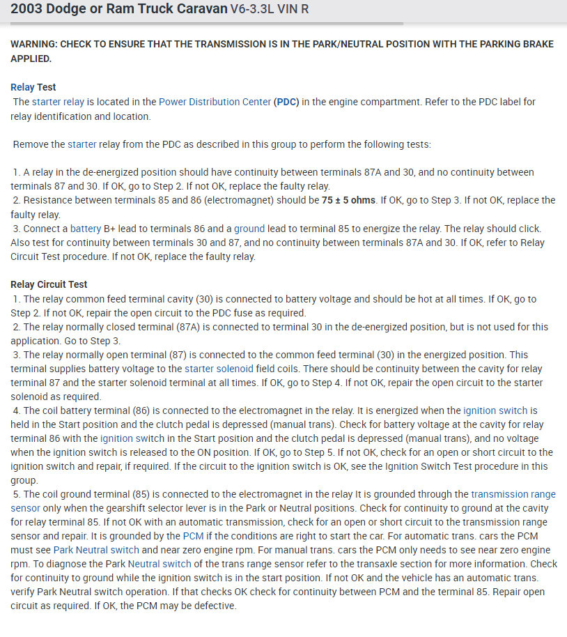

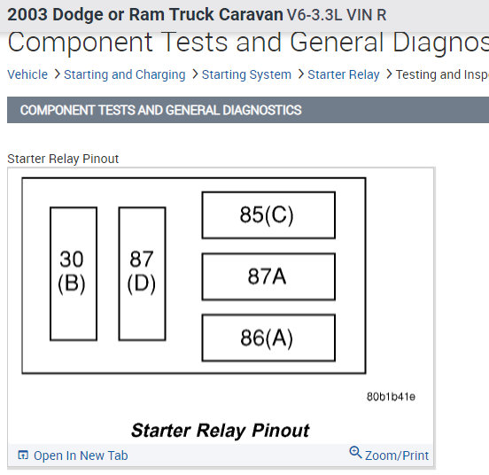

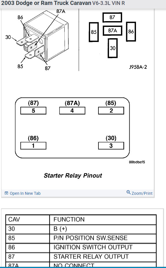

The van shut off at an intersection. now when i try to start it it will turn over run for a few seconds andf then cut off. After several tries when i turn the key absoutly nothing happens. Batteryis fine, starter was checked out as good. It appears i am not getting fuel, but why does the whole starter system sut down, and what is the needed fix?

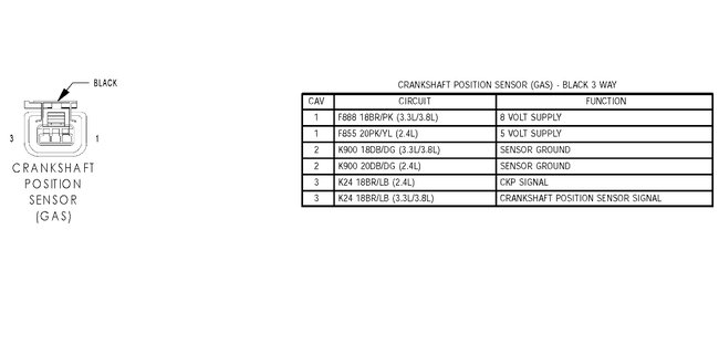

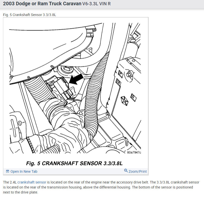

Just so that we cover all the possibilities, have you tried to jump start the vehicle?
First make sure you are getting spark to the plugs.

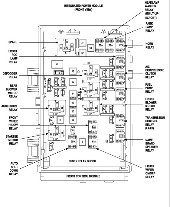

Then check fuel pump.
This vehicle has a fuel pump control module which sometimes goes bad and makes the fuel pump inspirational. It is located on the floorboard rear passenger side (see diagram below)
If you can't hear the pump come on check the relay then test the pressure to verify.
Here is a helpful guide on how to test fuel pressure:
https://www.2carpros.com/articles/how-a-fuel-pump-works

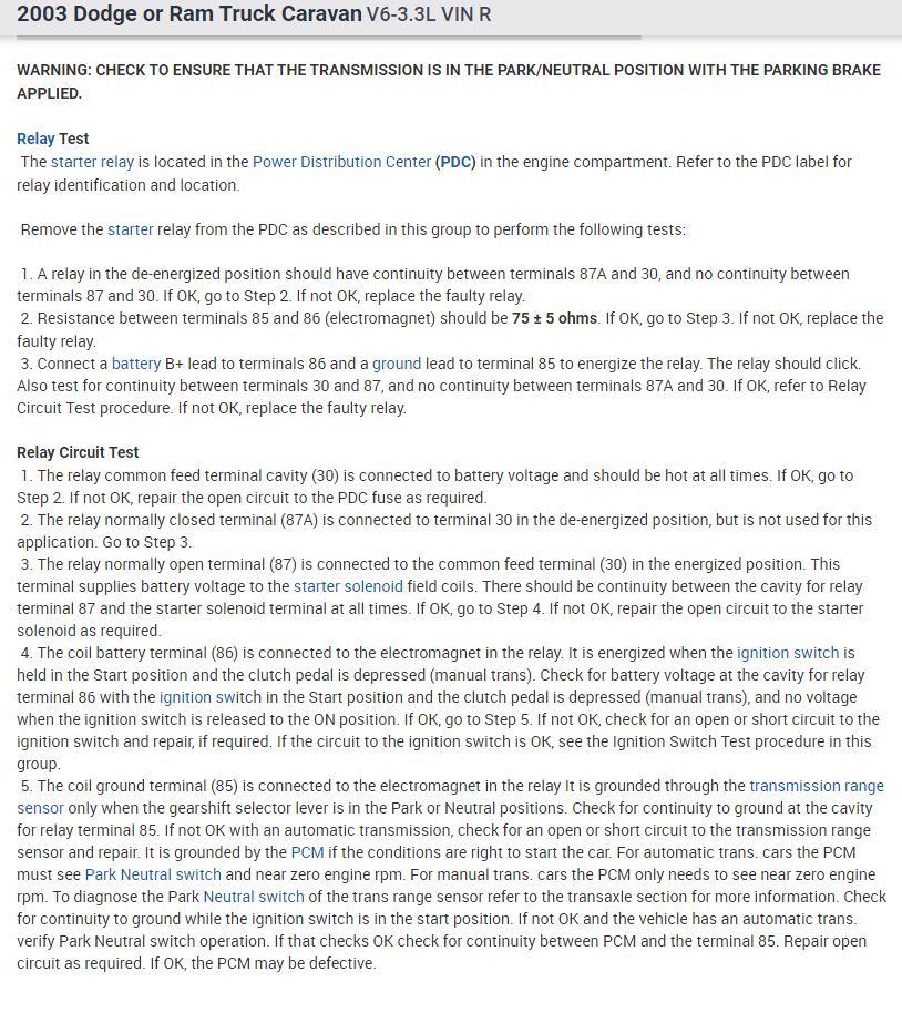

You can also test the relay. The relay is located under the hood in the fuse block.

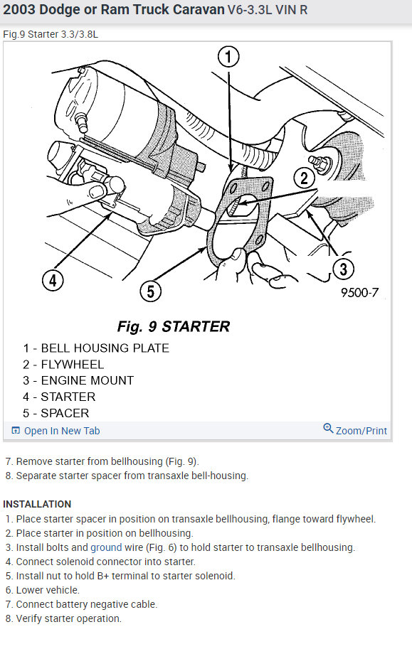

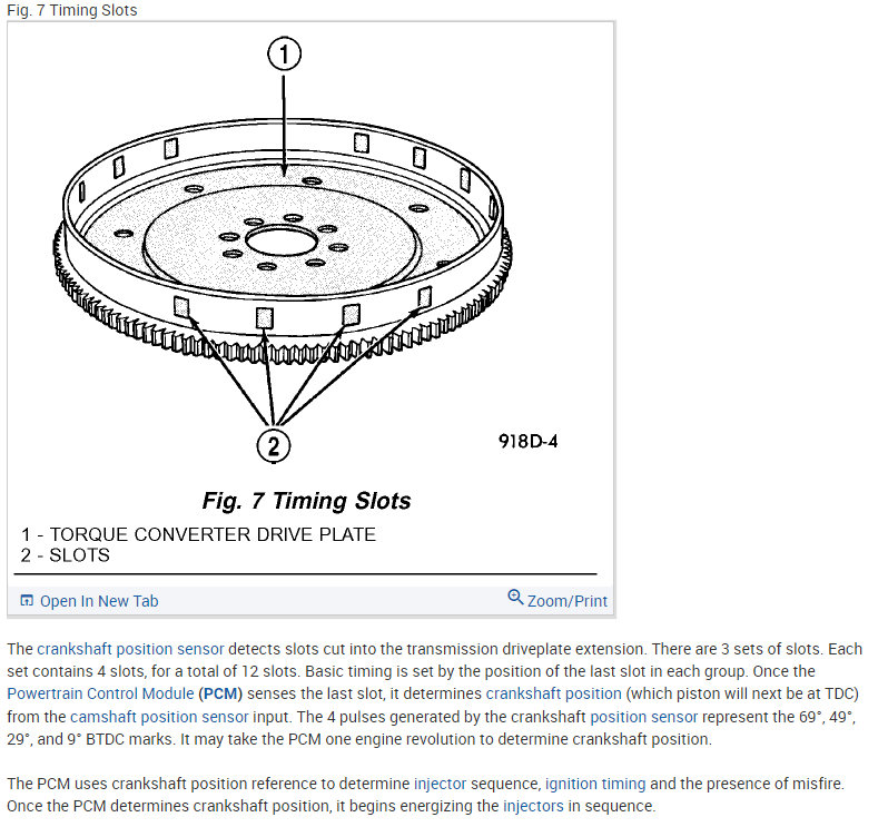

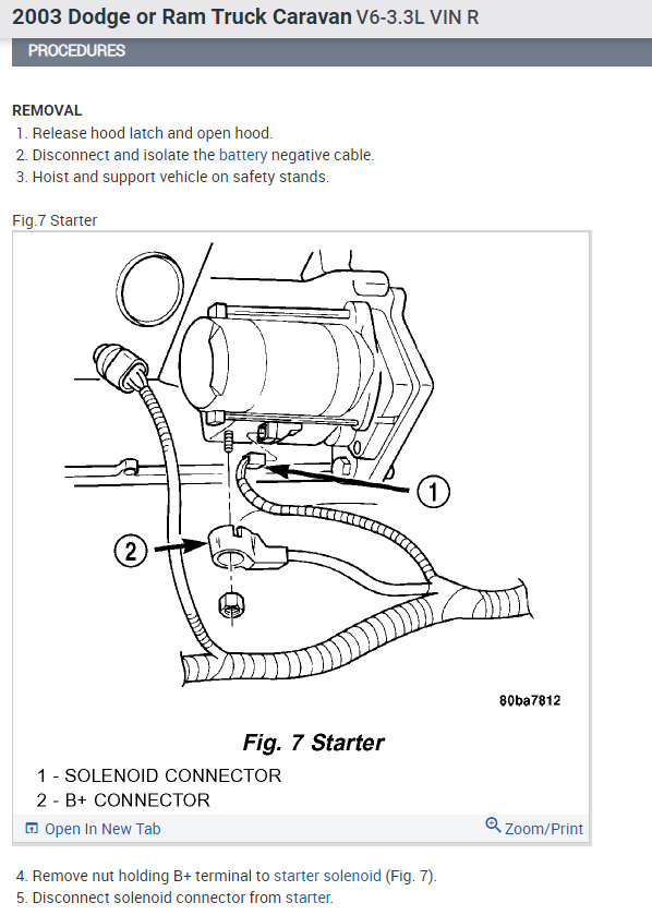

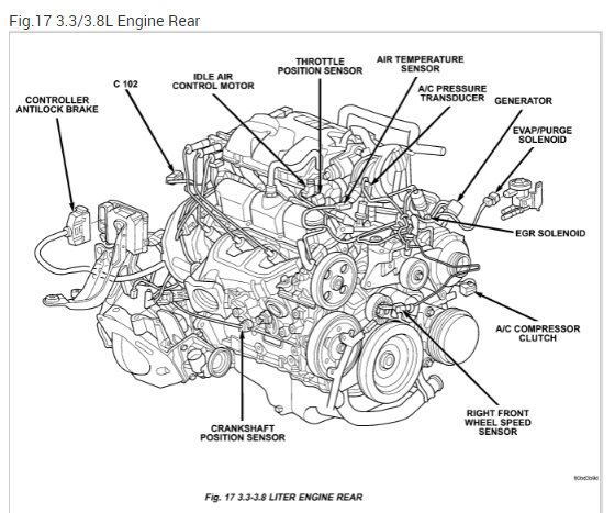

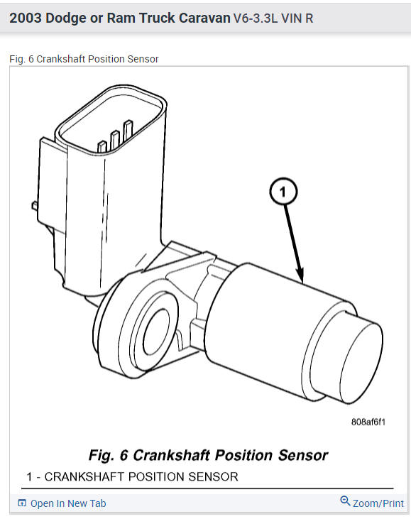

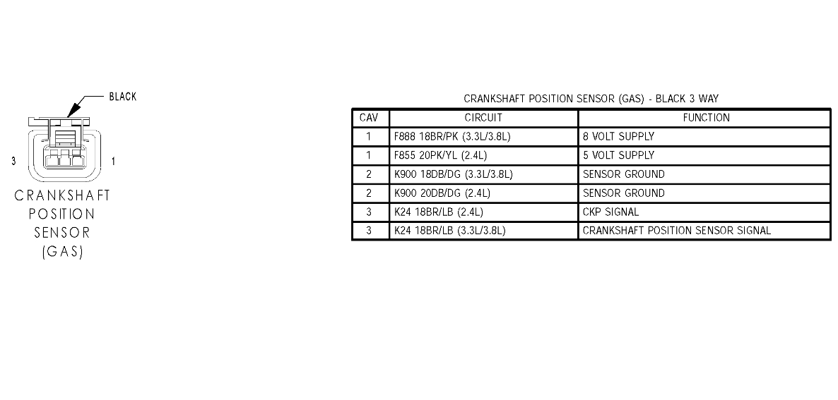

I have attached the diagrams for your reference.
