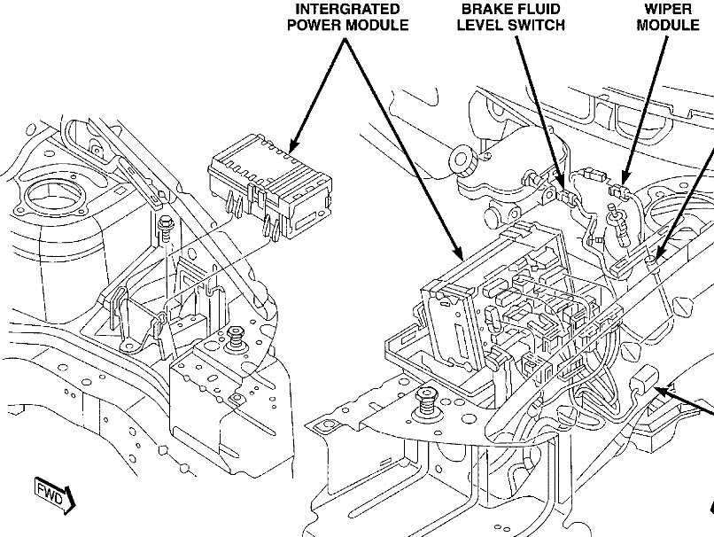

While driving vehicle, it completely shut down at intersection. No power to anything, almost as if there is no battery in vehicle. Nothing prior to incident suggests any problems.
Dec 29, 2015 at 9:07 AM
HMAC300
  • 48,601 POSTS
check battery for condition including load test most places do for free. check items in pic then have tpim module checked as It supplies ignition switch. it's a yellow wire going to ignition swtich
Dec 29, 2015 at 9:26 AM
JMERRIN
pic?
Dec 29, 2015 at 9:32 AM
HMAC300
  • 48,601 POSTS
see pic
Dec 29, 2015 at 9:42 AM
JMERRIN
Is there a way to check TIPM myself?
Dec 29, 2015 at 9:43 AM
HMAC300
  • 48,601 POSTS
no it has to be scanned by a mechanic
