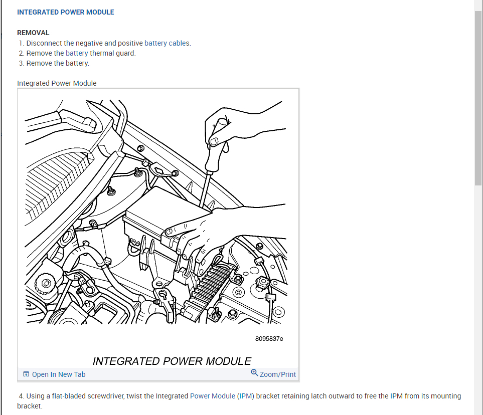

hI! Our gauges the speedometer and the milage and the d r and radio keep blinking the needles go up real fast and the radio turns off. We put a new alternator in last week and its still happening . Can you help me and tell me how to replace the TIPM thank you.
Sep 10, 2009 at 5:56 AM

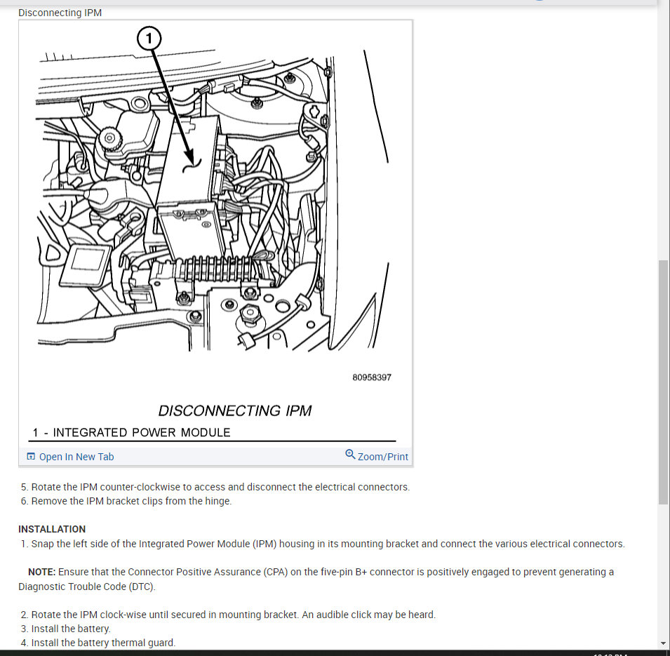

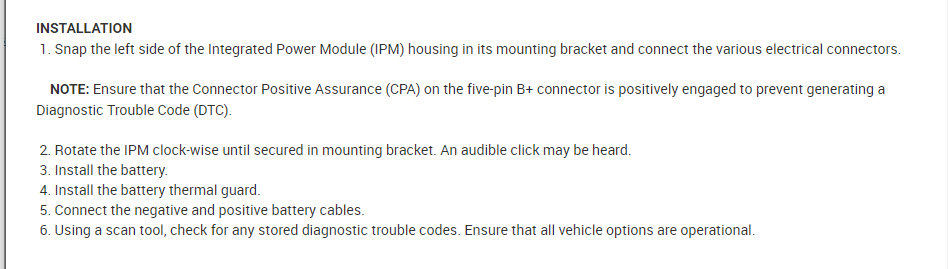

You vehicle actually has what is called an IPM and not a TIPM. It is not much different but worth noting.
I am attaching the process below on how to do this. Please run through this material and let me know if you have questions.
