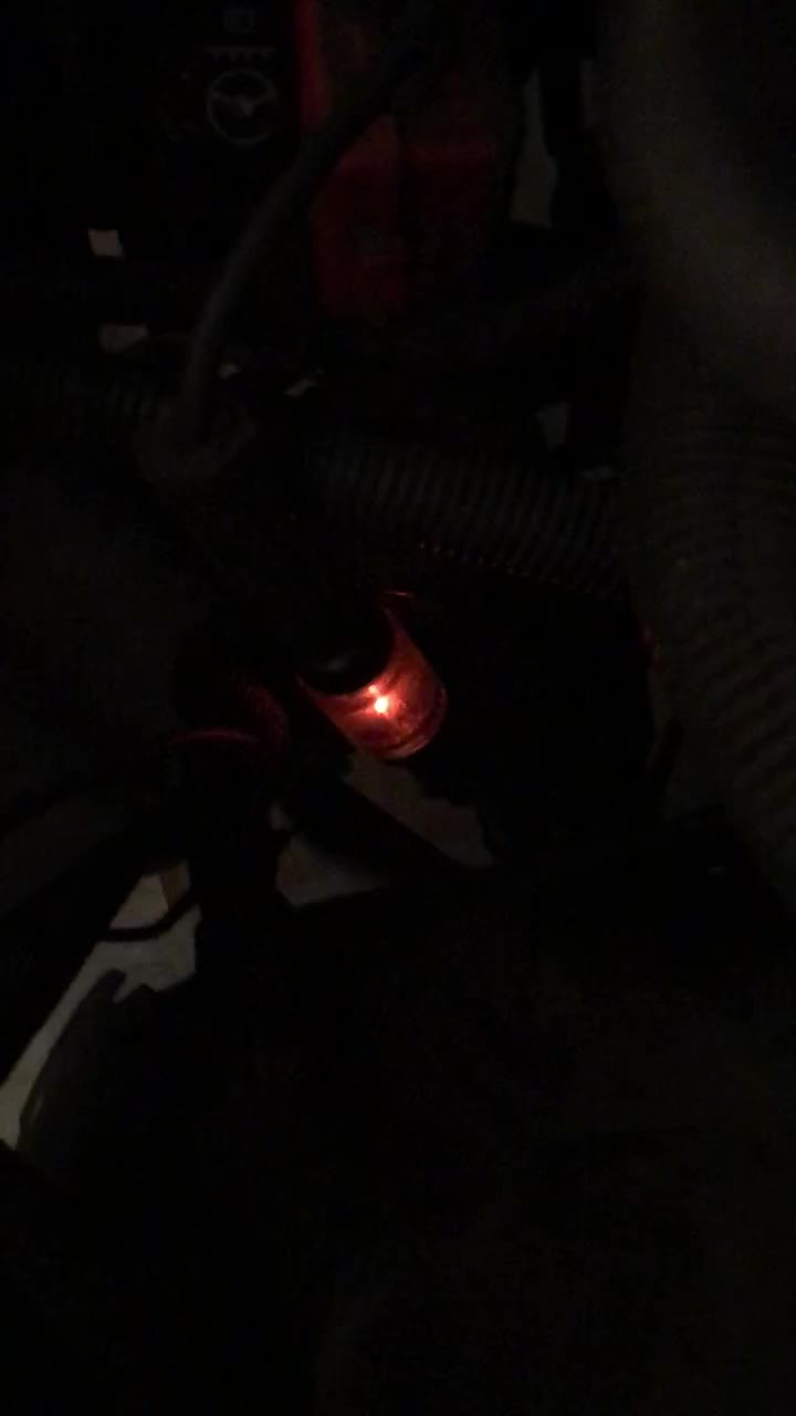

How to read a spark test? Should the spark be consistent related to frequency. My understanding is the ECU sends an igniter signal to coil telling it to fire. I would think this means the spark should be very consistent based on timing sequence.
I notice the spark mostly consistent but blanks (no light) are mixed in sporadically when monitoring the tester. Should this occur?
Noting that the cylinder in question is known to have misfires. Plugs, plug wires, and coil has been replaced so does it point to possible bad wiring or connection?

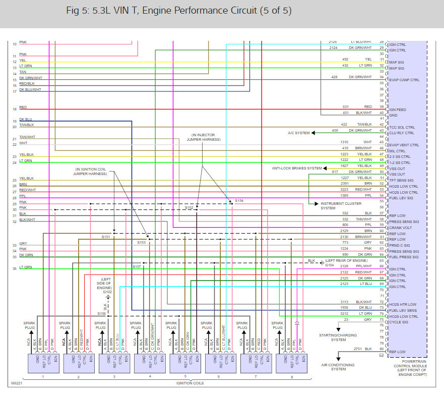

The spark should be consistent and not interrupted. If you have spark consistent and then it stops and comes back, that is not normal.

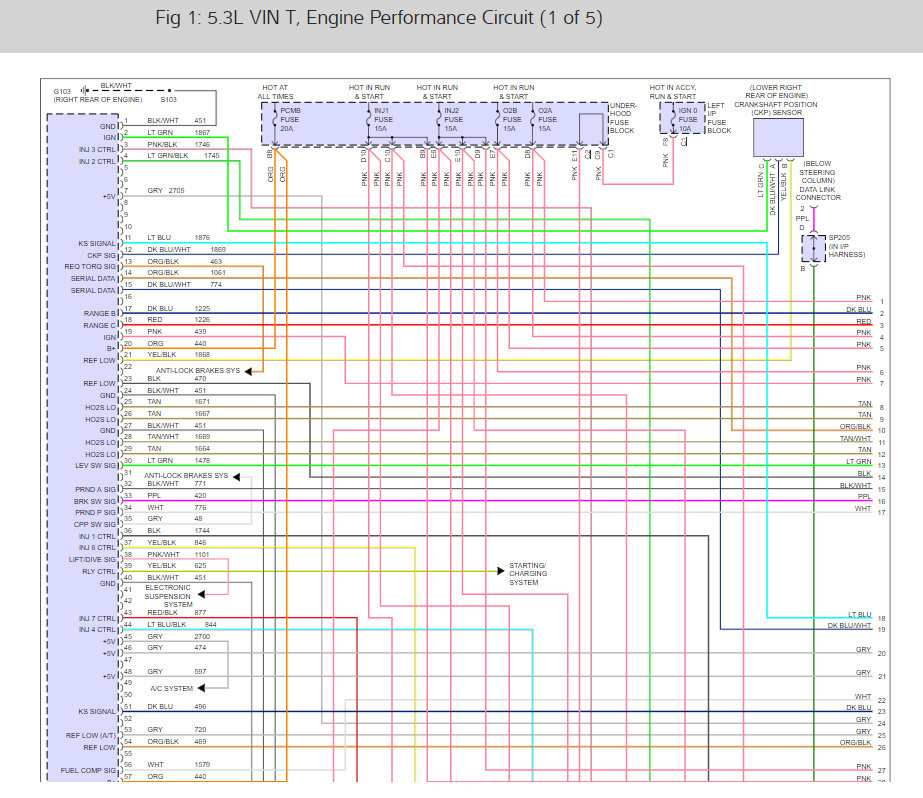

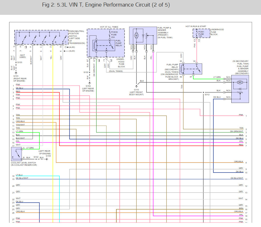

Take a look through this description of the system:
ELECTRONIC IGNITION (EI) SYSTEM DESCRIPTION
The electronic ignition (EI) system is responsible for producing and controlling a high energy secondary spark. This spark is used to ignite the compressed air/fuel mixture at precisely the correct time. This provides optimal performance, fuel economy, and control of exhaust emissions. This ignition system consists of a separate ignition coil connected to each spark plug by a short secondary wire. The driver modules within each coil assembly are commanded ON/OFF by the power-train control module (PCM). The PCM primarily uses engine speed and position information from the crankshaft and camshaft position (CMP) sensors to control the sequence, dwell, and timing of the spark. The EI system consists of the following components:

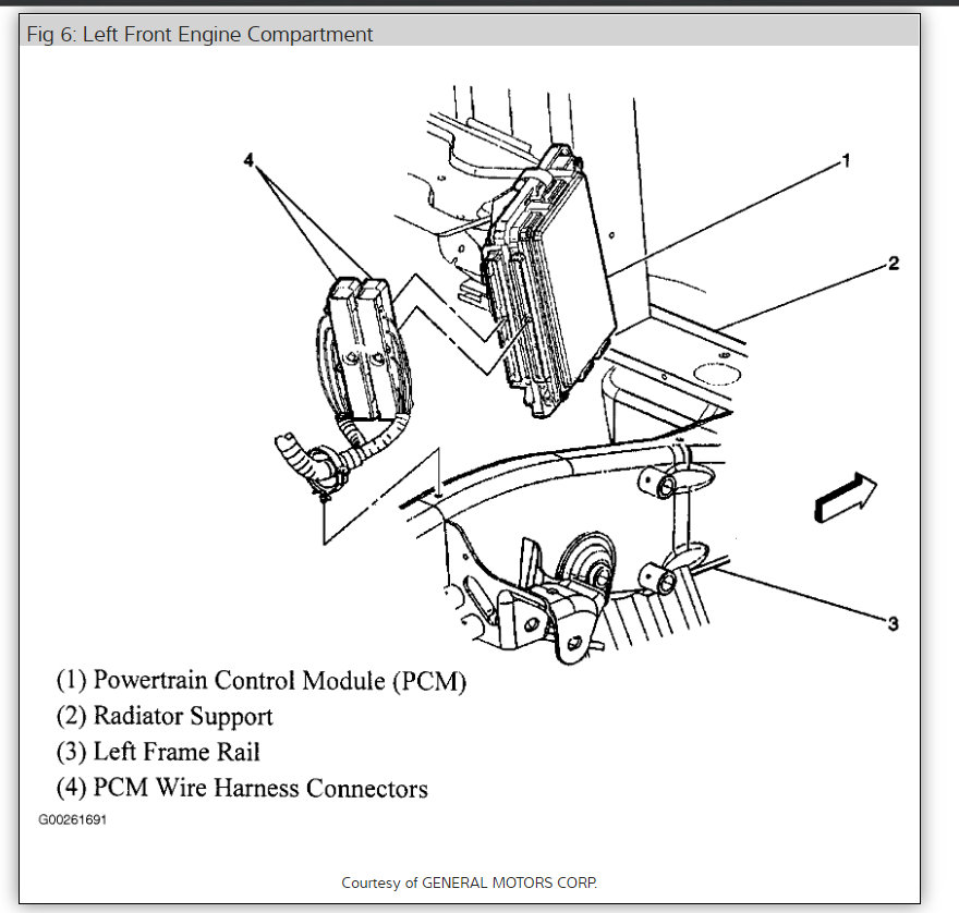

Now, based on your description, I need to know how you are checking spark. I ask this because all eight coils have a common ground that is known to corrode, break, fail. It is located on the side of the engine (driver's side) toward the front of the engine close to the bottom of the block. There will be black wires going to it.
That is the first thing I would like for you to check. Make sure the connector is in good condition, the ground is tight, and there are no corrosion issues. Do not depend on a continuity test. It can, and often does, provide a false positive.
Start with this and let me know what you find.

I am checking apart using a lisle inline spark tester. Plugs in between plug and coil wire. It has red light light that flashes. I will try to attach video of cylinder one. May need to blow it up or zoom in to see light.

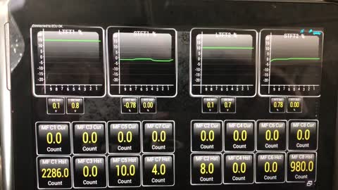

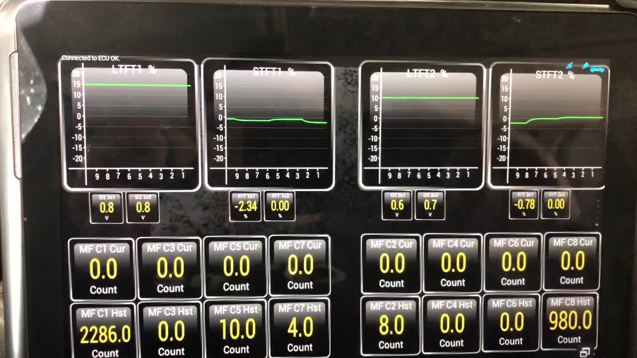

I am only getting P0300 code and none of the 301-308 codes. My cheap Ancel AD310 plug in is limited. However, today I purchased Torque Pro application and it does more. It shows me the cylinder current and history misfire data. I am not a mechanic and not sure what is normal but I am now aware 1 and 8 seem to be the culprits.
I am attaching my dashboard I built. It is a video of me accelerating hard, then slowing down. Left side is all bank 1, right side bank 2. Graphs are LTFT and STFT, small icons are O2 and Trim sensors, and bottom are cylinders left to right as 1,3,5,7 then 2,4,6,8 showing the current misfires on top row and history on bottom row.
Plugs are new, plug cables are new, coils original but have been swapped around with no change. Intake gaskets replaced with Fel-Pro metal frame type and torqued to spec (89 in pounds). Injectors are new ($120.00 set off Amazon), CAM sensor new, MAP new, Purge Solenoid new, Throttle body new, Fuel Regulator new, fuel filter new (Fuel pressure 42 psi per spec for 2004 Tahoe 5. Z Flex), all hoses and lines on intake new except the fuel purge tube is original. Original MAF but I did clean it.

Wow, you have done a lot. I do see one problem. The fuel pressure is low and that can cause a misfire. Here are the manufacturer's specs.
Fuel Pressure (Key ON, Engine OFF) .................... 385-425 kPa (55-62 psi)
Fuel Pressure (vin Z) .................... 335-375 kPa (48-54 psi)
With a Z vin code, you are still 6 psi below minimum.
Have you done anything with the regulator? Check to make sure you aren't drawing fuel into the regulator vacuum hose. Although it's new, it could be bad.

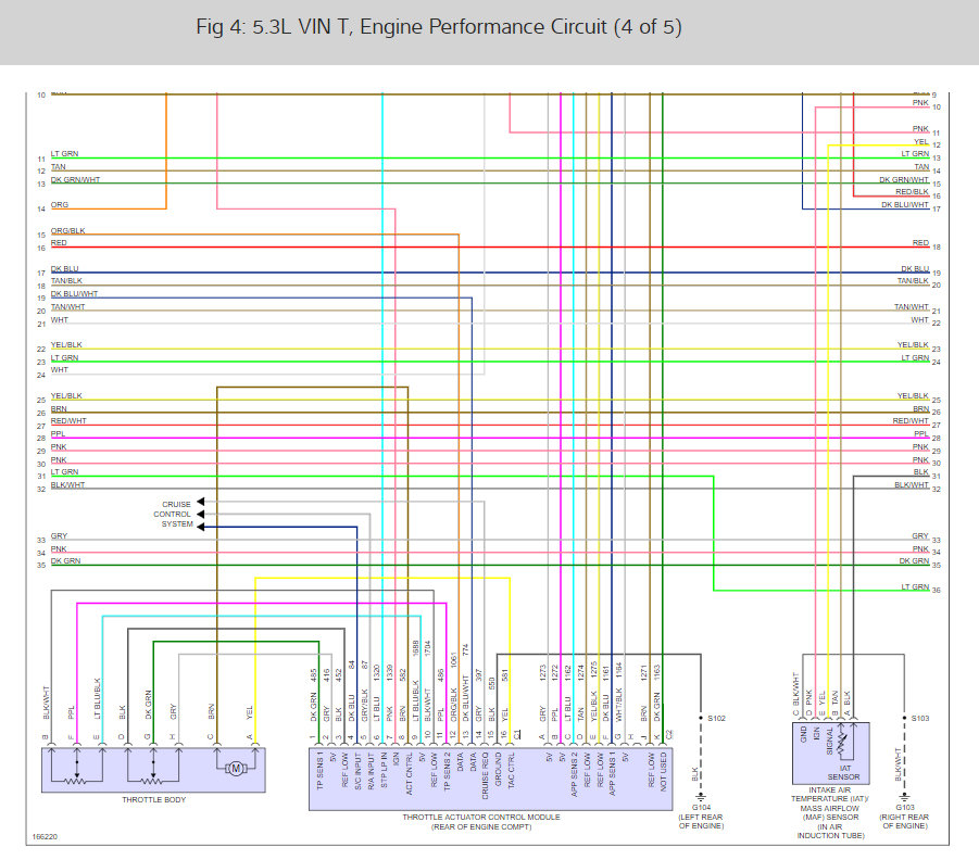

The variation in spark would not come from the MAF. If anything, I would think the crankshaft position sensor or reluctor wheel. That could have something to do with why it is 1 and 8. Have you removed the sensor?

Maybe this information helps but I noticed 2 main things when driving today. As I monitored my Torque Pro dashboard the misfires only occurs below 20 mph. I set cruise at 70 mph for five miles with no misfire counts. So either the sensors cannot detect them at high rpm or they stopped occurring at higher rpm? I can only feel them and see them at less than 20 mph.
Second is that FTs seemed to work normally in that LT would stabilize at a certain speed and not move, and ST would bounce +|- 5%. However, LT1 and LT2 seemed to act differently. At low speeds 0-20 LT1 would be low (ex 8.0) while LT2 would be high (ex 18), but when I accelerated and set cruise on 70 mph they came towards each other. LT1 rose up to around 12, and LT2 dropped to around 12 and stabilized. As I lowered speed the went separate ways again. I would think they both would do the same thing, not opposite?

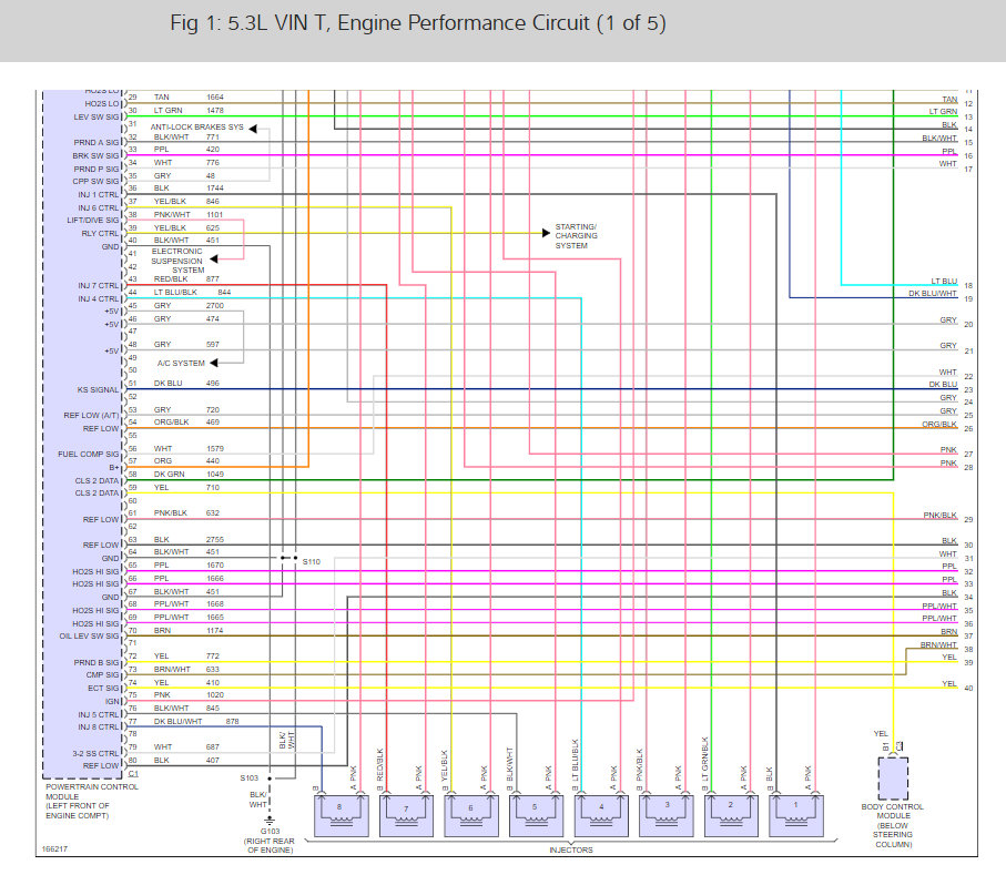

I just swapped the injectors around. They were new but not OEM.
I swapped injectors as follows:
Before swapping cylinders 2-7 running good with no misfires. 1 & 8 misfiring.
1&3 swapped
2&4 swapped
5&7 swapped
6&8 swapped
After swapping injectors no change. Cylinders 1&8 still the problem. The others also look good. So I am convinced the problem is not fuel pressure or injector related. Also per prior email it’s not coil, plug, or plug cable related. I had swapped quad coil mount bracket from bank 1 to bank 2 which moveed position 1 to 8. I guess it’s possible both 1-8 have bad wiring from coil to primary mount connector but odds of that are very low?
MAP is new, CAM sensor new, gaskets new, hoses new, vacuum is steady needle @ 19 inhg, MAF cleaned but original.
My next item I will check leak down on cylinder 8. It measured 182 psi on a prior compression test, so I never did a leak down.

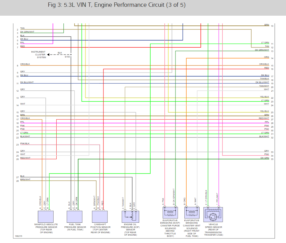

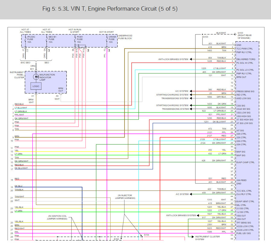

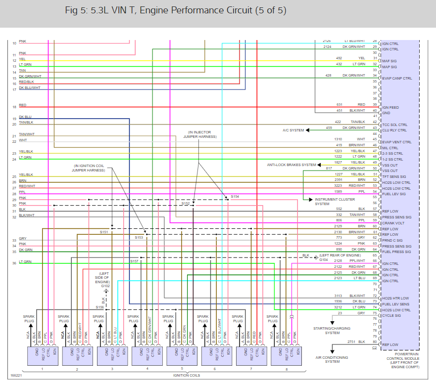

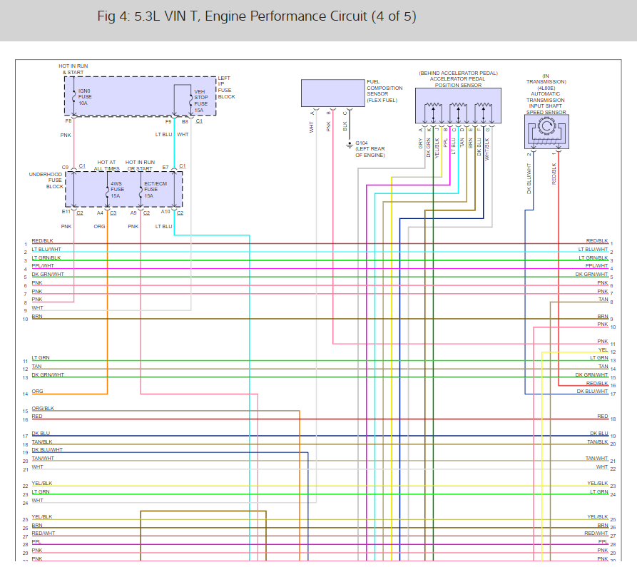

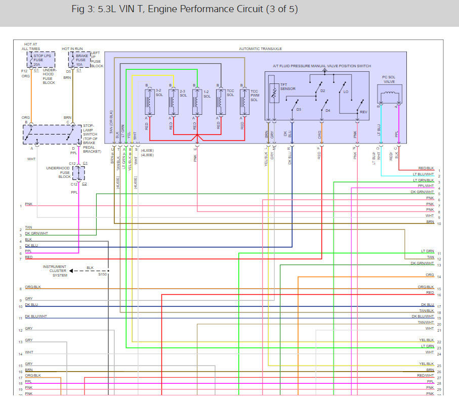

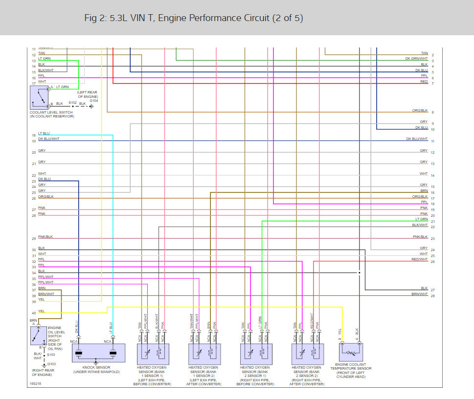

I couple things come to mind. These engines had a problem with the camshafts going flat. Can we remove the valve covers and do an Inspection on the lobes, use a flashlight? If they seem okay I would do a pin to pin the make sure there is no high resistance to any injector/ignition coil. Here are the engine wiring diagrams and guide to help:
If all okay swap the PCM out for a used/rebuilt unit to see what happens.
Check out the diagrams (below). Please let us know what you find.

I have checked the injector outputs with a NOID tester. But have not measure pin to pin on connector. On the coil connector I did measure pin to pin and all of the signal or igniter violates on bank 1 are the same. I think they all were around 3 volts. I will find my information and share.

I have read the thread again and I caught something Joe asked me. He asked me about crankshaft position sensor. I did replace the cam position sensor, but not the crankshaft sensor. Also I do not know what a reluctor wheel is so have not looked at it either.
Nov 26, 2018 at 6:01 PM
  • 55,399 POSTS
I would do the crankshaft sensor. Here is a guide to help walk you through the steps:
