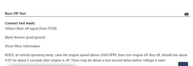

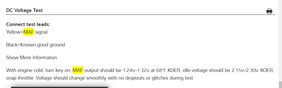

Checked cap and rotor, they are fine. I'm kinda thinking maf because when. I unplug it while car is idling real rough, it smooths out as soon as I unplug it. But will die if I attempt to push the accelerator.

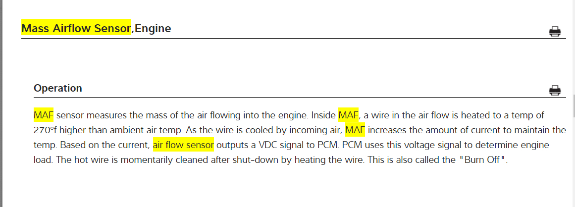

Okay. Mass Airflow Sensor(MAF) is probably the most important sensor on your vehicle. Your vehicle's Powertrain Control Module(PCM) uses the signal from the MAF to determine the amount of air entering the engine for it's baseline fuel map so it know how much fuel to add to maintain the proper Air:Fuel ratio. The MAF circuit is a complicated circuit but basically breaks down to a thin platinum wire that the circuit passes electricity through it. The resistance of the wire heats the wire to around 500 degrees. As the air entering your engine cools the wire, more electricity will have to added to maintain the 500 degree temperature. Your vehicle's PCM can now measure by the amount of electricity added to the wire the amount of air entering your engine and go it's proprogramed map to add the correct amount of fuel. Sometimes the wire gets dirty and skews the MAF sensor. Here's how to clean it.
https://www.2carpros.com/articles/mass-air-flow-service
Please go through this guide and get back to us with what you find out.

I've already used maf sensor cleaner and didn't work for me
May 3, 2019 at 7:36 PM

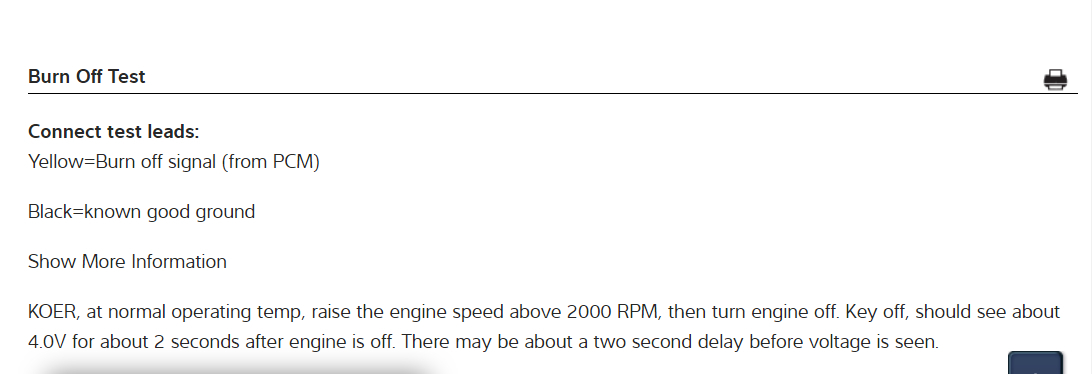

SCGRANTURISMO
  • 4,897 POSTS
Hello again,

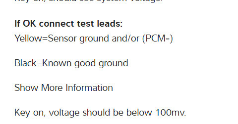

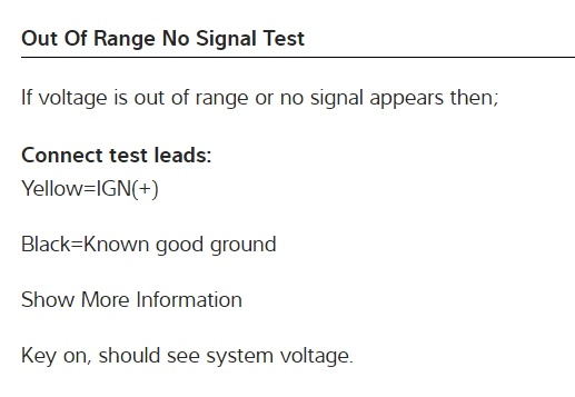

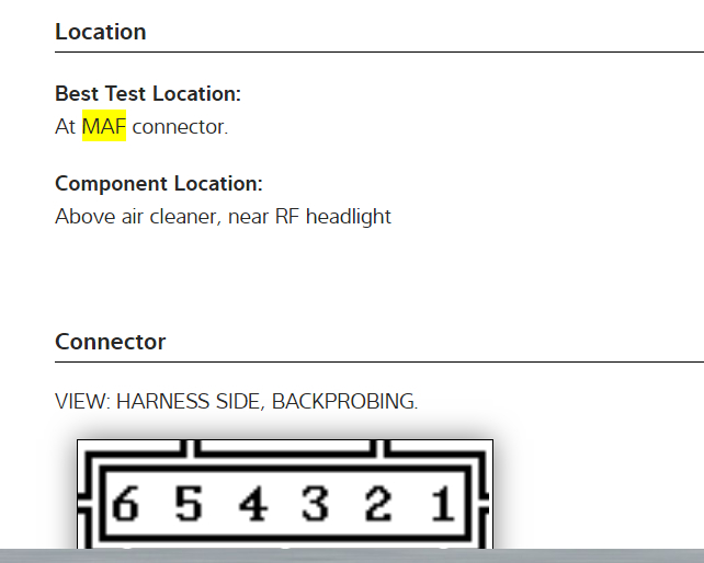

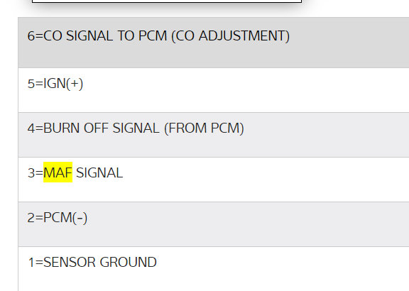

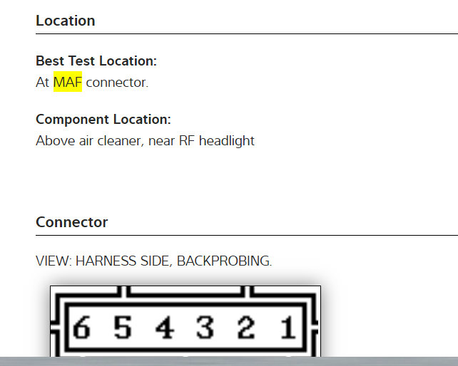

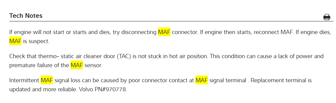

Here's how to test the MAF sensor on your vehicle. I have included the diagnostic test procedure in the diagrams down below. Please go through this guide and get back to us with what you are able to find out.
Thanks,
Alex
2CarPros
May 4, 2019 at 5:56 PM
DENVBRONCOS
  • 20 POSTS
Would it be possible to and me link to where you got the diagnostic information from?
May 6, 2019 at 3:03 PM

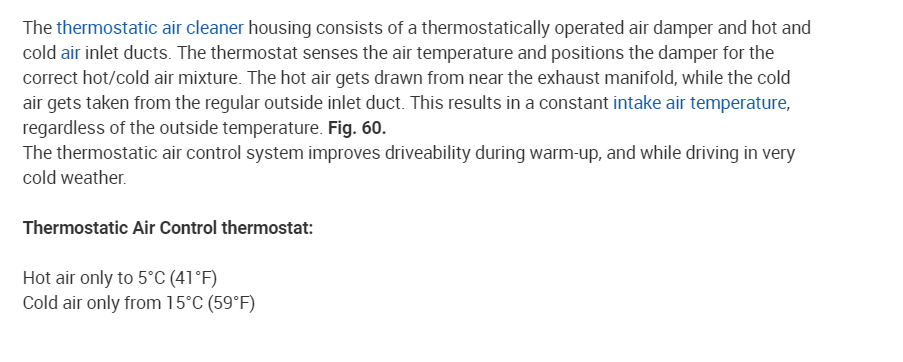

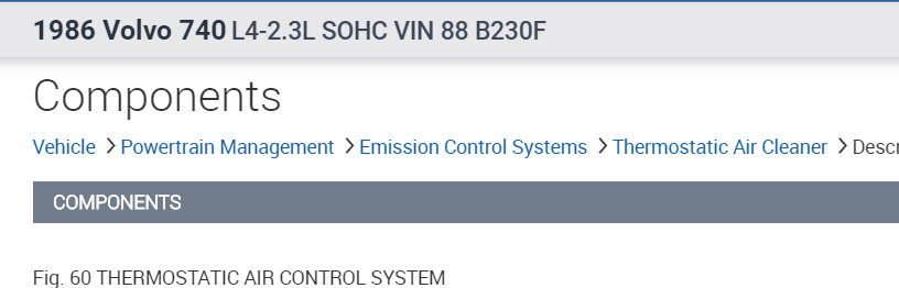

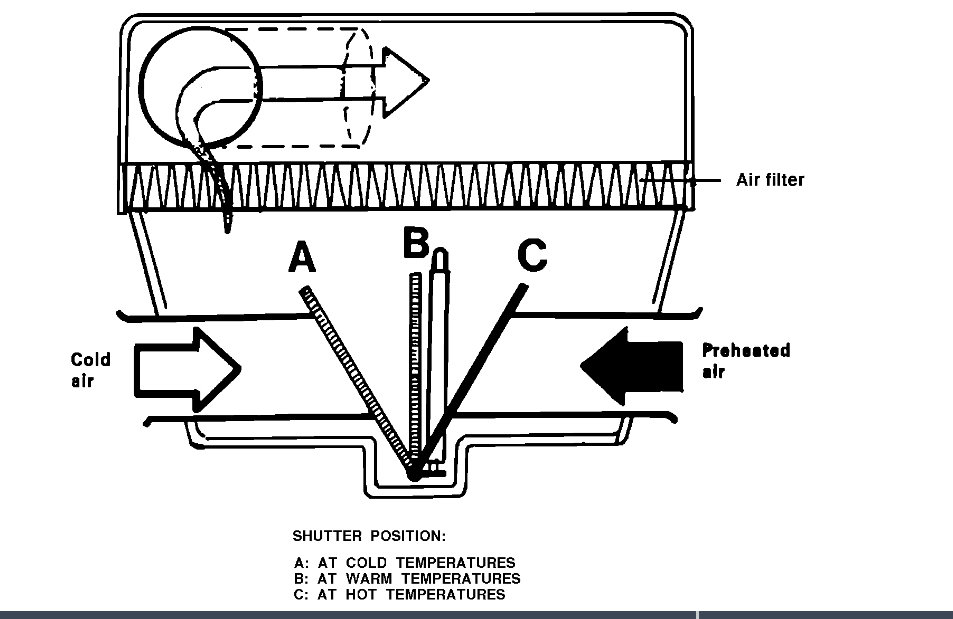

Also, thank you for the information on diagnostics page. Another question, where is the thermostatic air cleaner door located on my 1986 Volvo 740? Is it before the air filter box?
May 6, 2019 at 3:44 PM
SCGRANTURISMO
  • 4,897 POSTS
Hello again,
I have included the information that you requested in the diagrams down below. Please go through it and get back to us with what you are able to find out, or if you have any other questions, please feel free to ask. It's why we are here.
