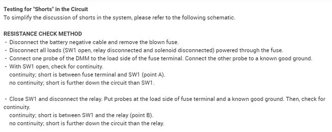

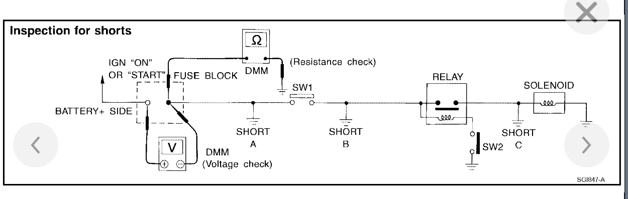

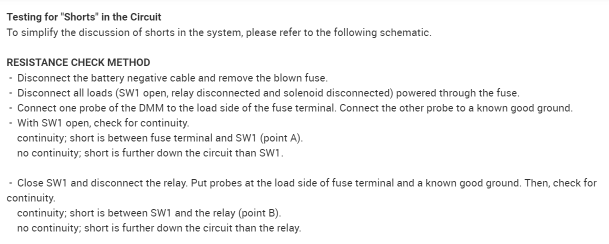

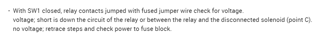

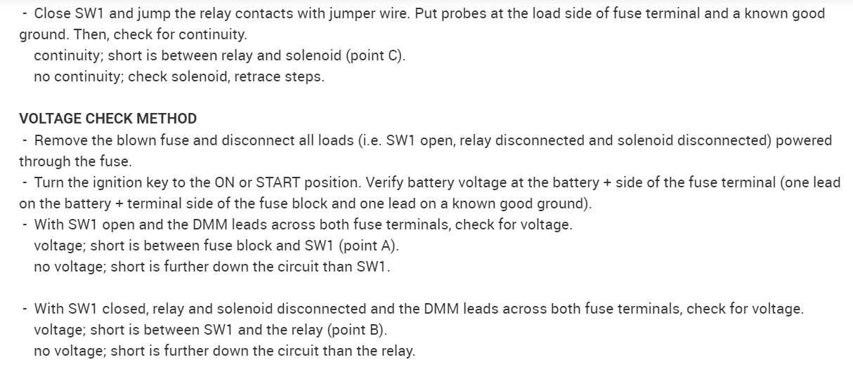

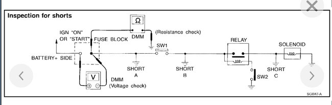

Your vehicle keeps blowing the fuse because there is a short to ground in the circuit[s] that that fuse is protecting. This happens because of Ohm's Law, the laws that govern electricity in a vehicle. Ohm's law states that if one of the three properties of electricity stays constant, and one always is in an automotive circuit [Voltage-there is constant battery voltage] and one of the remaining two goes down[Resistance-resistance goes to zero as the electricity has a direct path back to the negative battery terminal] than the last property must go up proportionally [Amperage-Amperage will go to the Amperage rating of the battery]. The Amperage/Current or the flow of electricity will overtake the fuses amperage rating and "pop" the fuse blows, protecting the circuit, just like it was designed to do. In the diagrams down below I have included a wiring diagram of your vehicle's Coil On Plug circuits and a guide on how to find short to grounds in an automotive electrical circuit. You will need to use a Digital Multi-meter [DMM] to do go through this guide. Here is a link below explaining how to use one, if needed:
Please go through these guides and get back to with what you are able to find out.

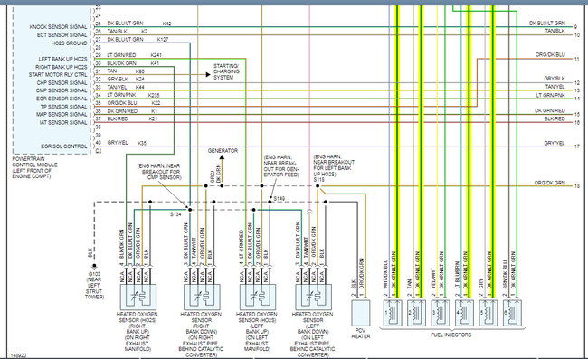

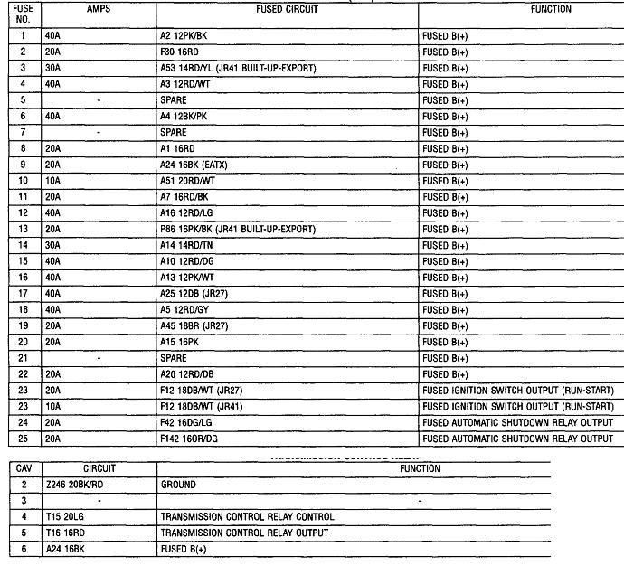

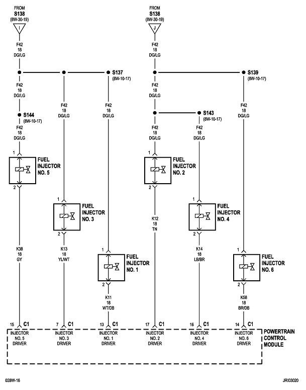

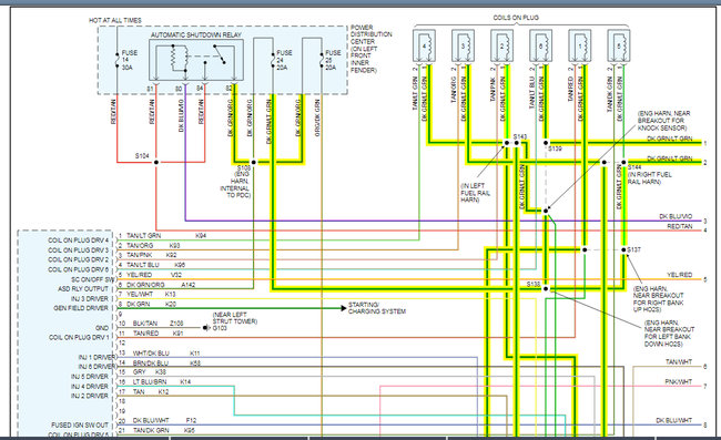

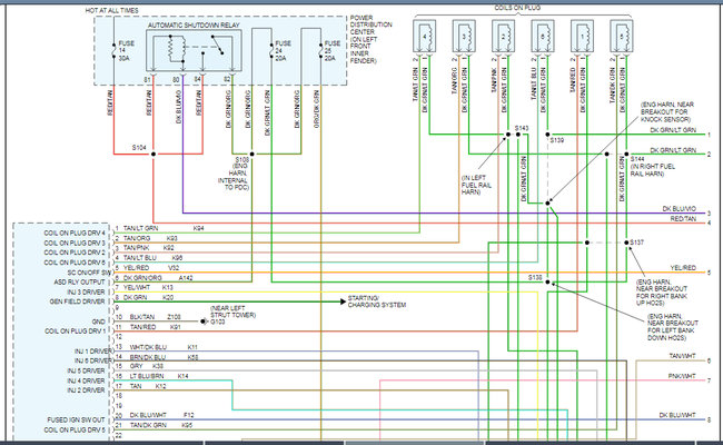

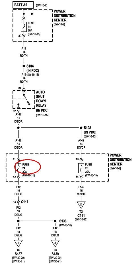

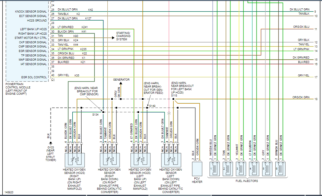

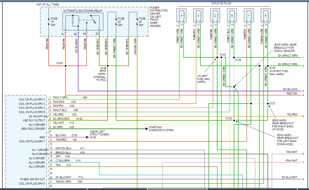

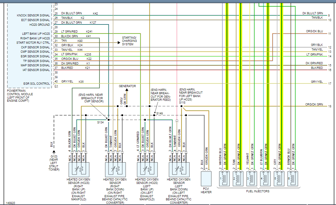

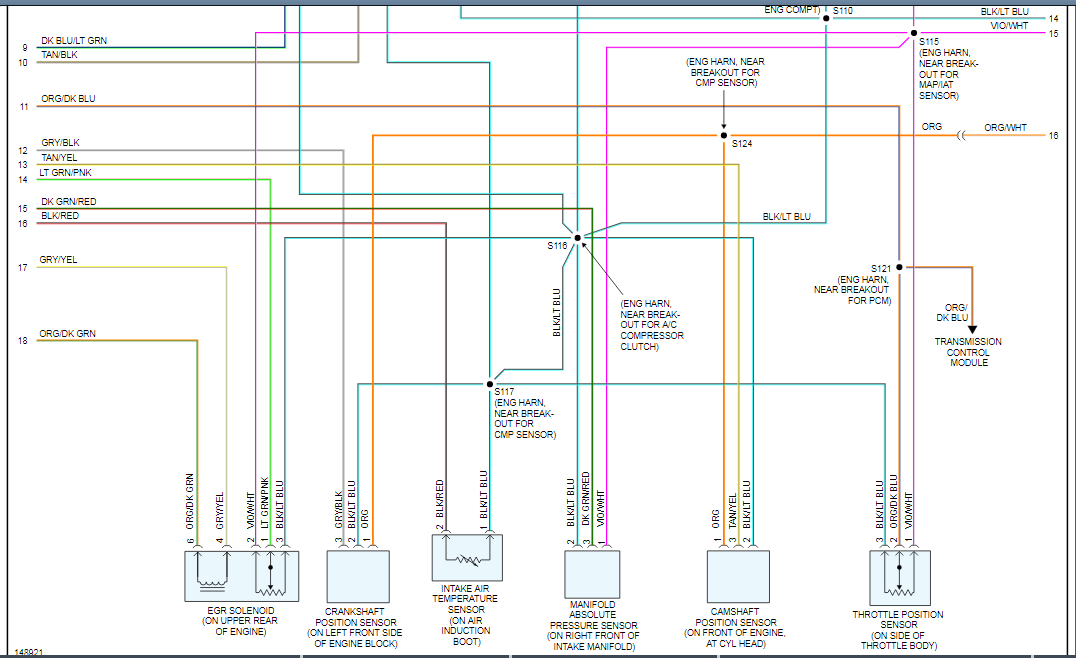

There's no ground wires in the injector or ignition coil circuits, so if you grounded something, that would be what is shorted. Both circuits are grounded by the Engine Computer. It switches the grounds on for the injectors to pulse them for a few milliseconds, and it switches the grounds off for the ignition coils, individually, when they need to create the spark.

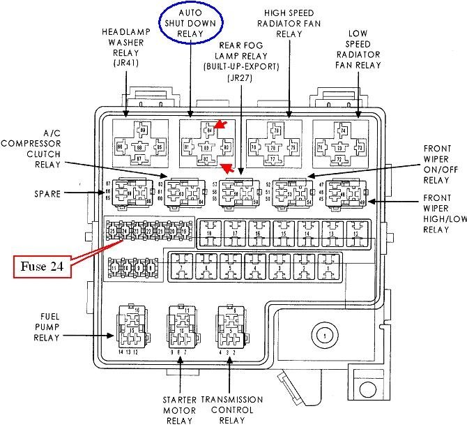

The first diagram has fuse # 24 circled. That feeds circuit F42 dark green / light green for the six injectors. The two circuits are continued on the second diagram at call outs "I" and "J". This is the circuit that has to be shorted for that fuse to blow.
If you aren't sure if the short is something you caused, another way to find this is to replace the blowing fuse with a light bulb. That will limit current flow in the circuit to safe value, and give you a visual indication of when the short is present or removed. Normally I stick a 3057 brake light bulb in place of the fuse, but for anything related to the automatic shutdown, (ASD) relay, which this is, it's better to bypass the relay instead because that relay only gets turned on for one second when you turn on the ignition switch. Obviously that is not enough time to do any testing. The relay gets turned on again during engine rotation, (cranking or running), but since the engine doesn't run, any testing would have to be done while a helper is cranking the engine. Again, not practical.
The way to do this is to install a good fuse into socket #24. Don't turn the ignition switch on or that fuse will blow again. Now, remove the ASD relay, then stick in two universal crimp-type spade terminals into the socket's terminals 30 and 87. That's if you have the common 1" cube relays. If you have the skinnier relay like the one shown on the right of the drawing, use the two terminals the arrows are pointing to.
Use a pair of small jumper wires to connect those two terminals to the light bulb. A 3057 brake light bulb has easily accessible terminals and will limit current to one amp. It can get pretty hot when it's at full brightness, so be careful where you lay the bulb.
By connecting the bulb across the relay socket, the circuit will be energized all the time. No need to turn the ignition switch on, and there won't be nearly enough current to blow the new fuse. If the short is present, the bulb will be full brightness. Now you can move wire harnesses around, unplug things, and disconnect connectors to see what removes the short from the circuit. When you find something that removes the short, the bulb will get dim or go out completely.
I just noticed they changed the relay terminal numbering, but the physical locations are the same. Use terminals 82 and 84. Two small red arrows are pointing to them in the fourth diagram.

No. The f42 wire is a hot wire coming from the ASD Relay pin 30, or possibly pin 87 and is the wire supplying power to the component to be power[Coil[s]]. It should not be grounded. This is your short to ground.

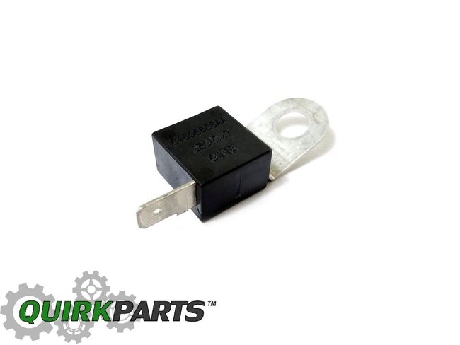

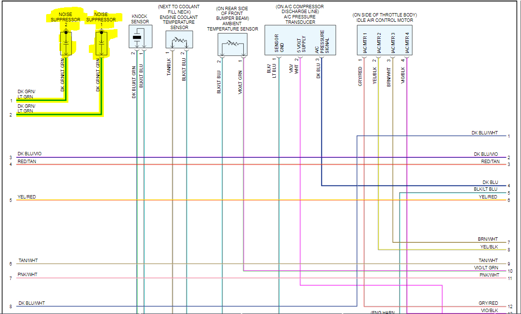

parts number 4606866aa this one is 4 an 04, but it is the same thing/picture the capacitor was on both valve covers. if not where does this wire go green light green wire? as soon as i cut that wire the fuse stopped blowing and i could smell a little gas.
Nov 14, 2019 at 10:15 AM
DSTONEN
  • 85 POSTS
this is at the end of that wire an it screws down on valve cover screw first valve cover screw is tightened down then the capacitor is placed on top of that same screw its about 1 inch then screwed down with another screw smaller size. Then the green with light green strip has a prong the plus right into the capacitor.which again is broken some peaces missing from old capacitor there is one onm each valve cover.
Nov 14, 2019 at 1:02 PM
SCGRANTURISMO
  • 4,897 POSTS

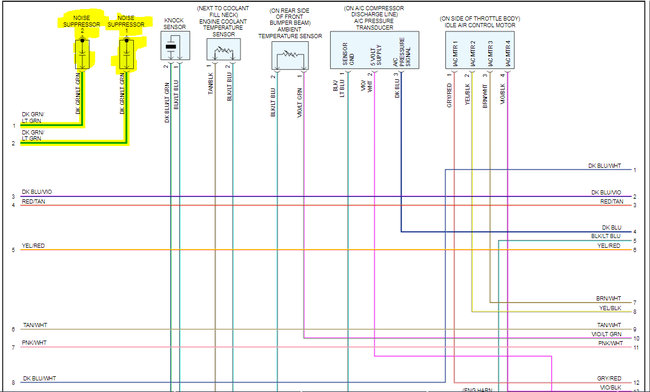

Okay, this looks like an Radio/Ignition Capacitor for collecting the Electro-Magnetic Frequency[EMF] from the ignition coils and storing it then releasing it to ground of the vehicle battery. When your coils release the electricity that is built up in the winding's of the coil to produce the electricity to make the spark plugs spark, it creates a collapsing magnet pulse that gives of EMF and will be picked up by any unshielded wiring. So it is the job of these capacitors to collect and disseminate the EMF to the vehicle's ground. A good example of what happens when these capacitors aren't working is if you have ever accelerated in a vehicle and the more you accelerated the louder a whining hum would come over the vehicle's speakers, that hum is the EMF from the ignition coils being collected by the speaker wires instead of the capacitor.
Thanks,
Alex
2CarPros
Nov 14, 2019 at 5:17 PM

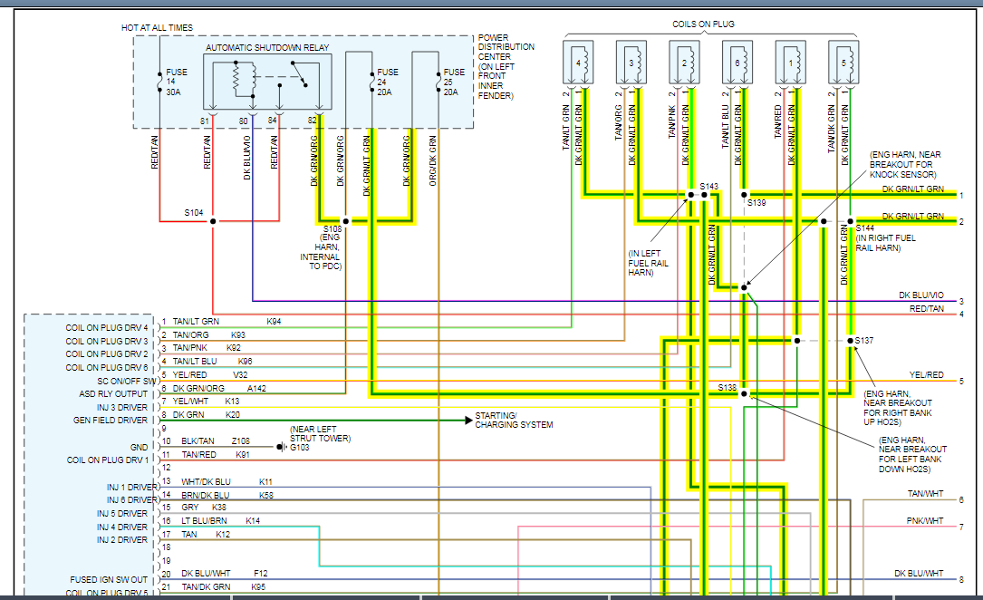

SCGRANTURISMO
  • 4,897 POSTS
Hello again,
Here are the wiring diagrams with the positive wires to the Coil On Plugs[COP][s] and fuel injectors and the capacitors highlighted for you in the diagrams down below. I hope this helps.
Thanks,
Alex
2CarPros
Nov 14, 2019 at 5:32 PM

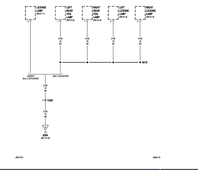

Can i bug you one more time? could you show me the grounds there is a green with black stripe and i have it grounded to the valve cover. just want to make sure it is right. thank you
Nov 15, 2019 at 2:52 AM
SCGRANTURISMO
  • 4,897 POSTS
Hello again,
Where is the wire originating from? If you know.
Thanks,
Alex
2CarPros

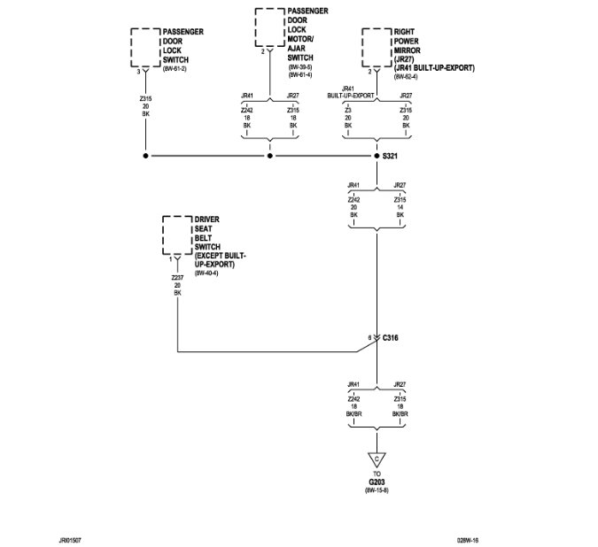

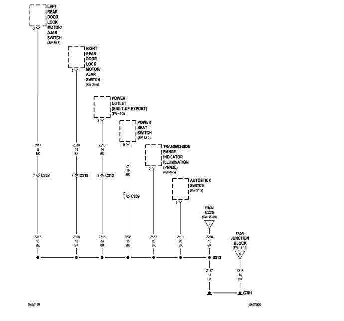

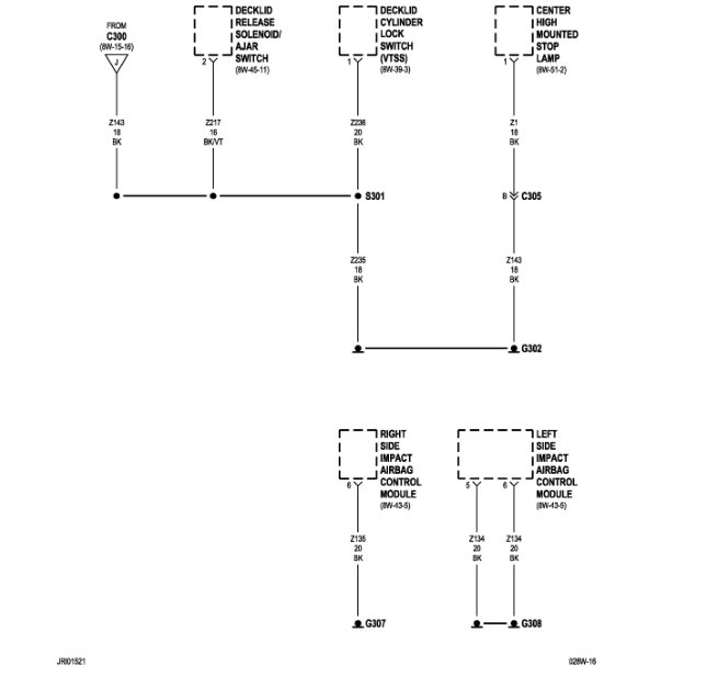

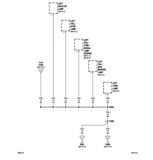

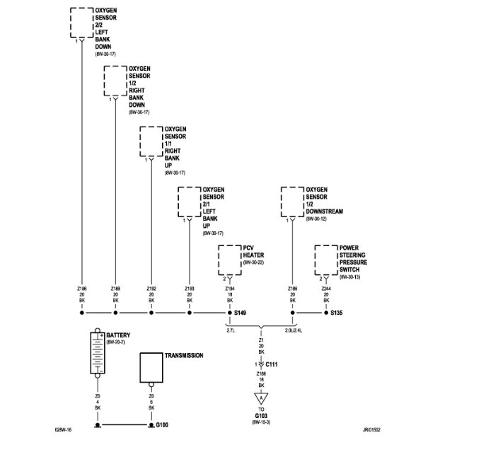

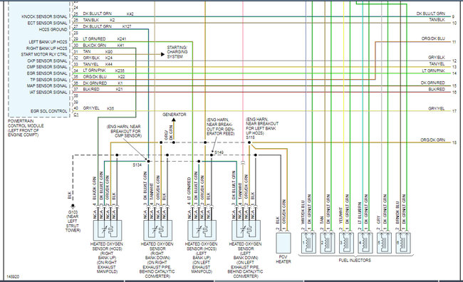

i don't. it is rapped up with a bunch of other wires. i am trying to find the ground that go onto the valve covers for this car. i am thinking it is a ground. i don't see it on the hot wire diagram you showed me. is there a ground diagram?
Nov 16, 2019 at 4:38 AM
DSTONEN
  • 85 POSTS
it seems like from your diagram that the black with dark green strip is coming from the power train control module to the oxygen sensor. i grounded it thinking it was a ground wire then I cut it just to see a difference. still wont start.

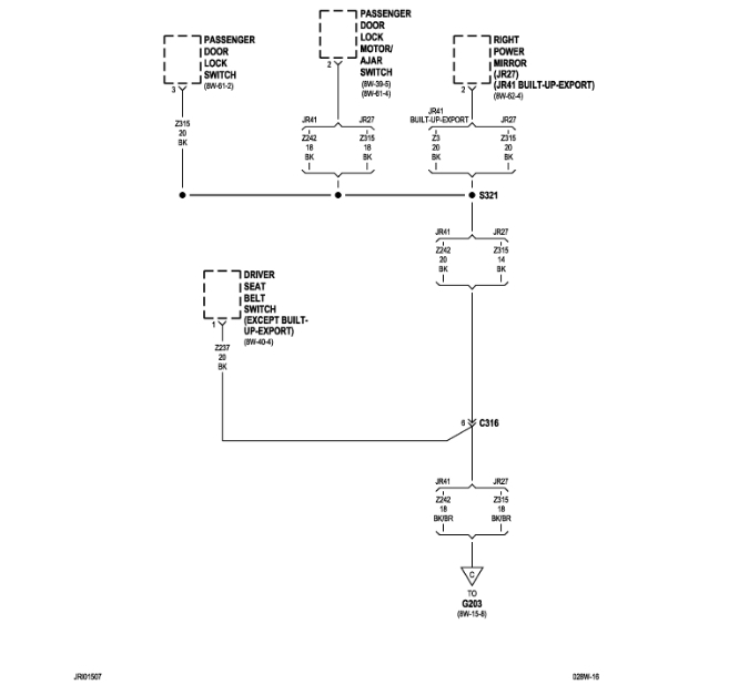

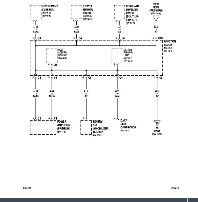

Nov 16, 2019 at 7:43 AM

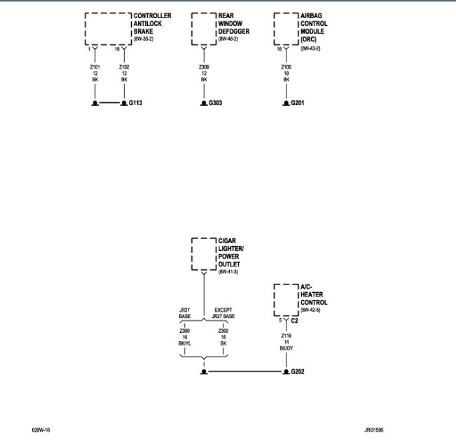

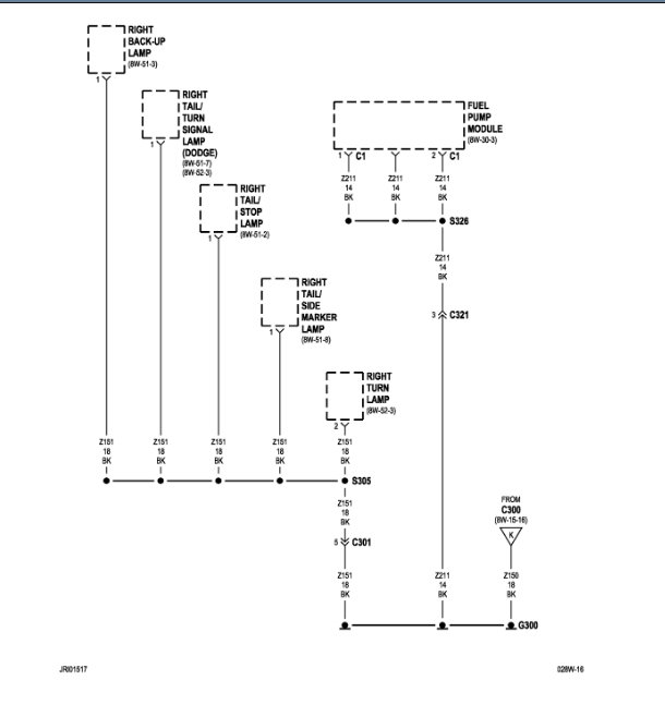

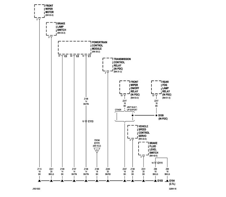

SCGRANTURISMO
  • 4,897 POSTS

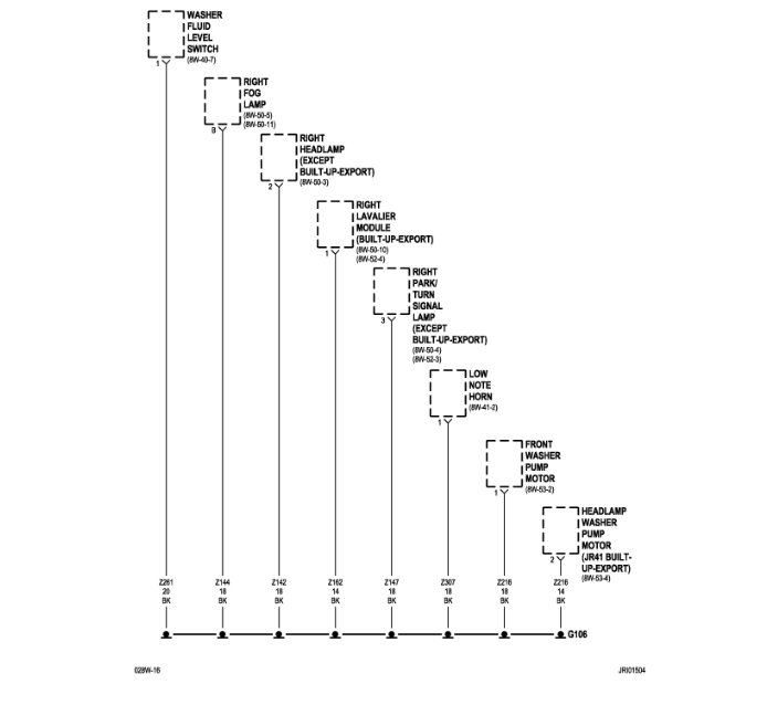

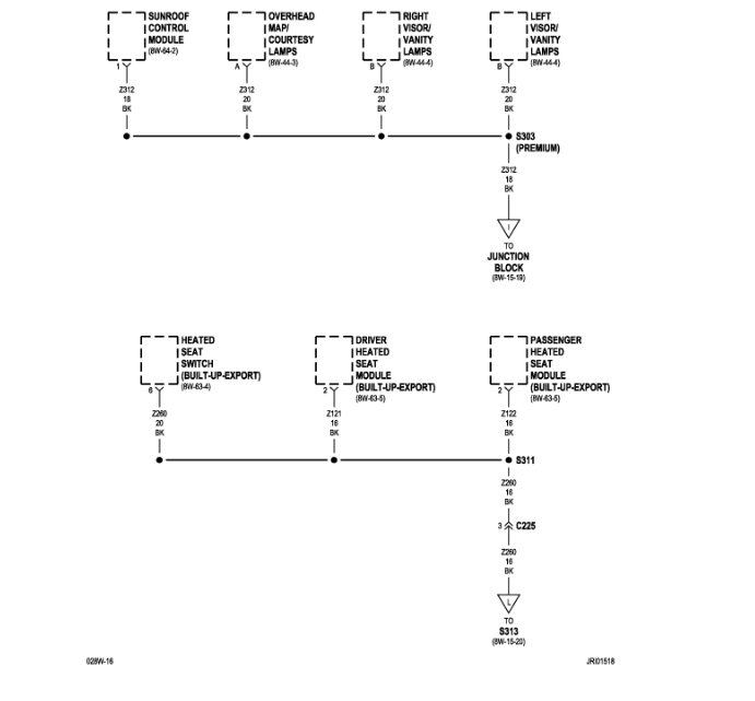

Hello again,

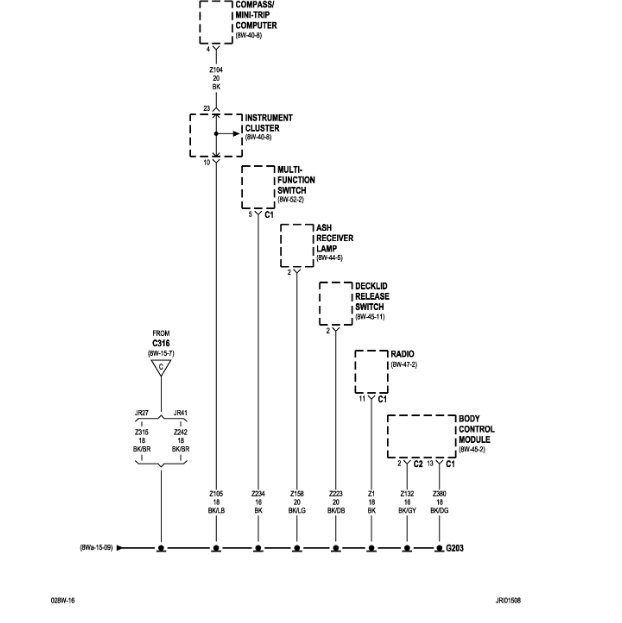

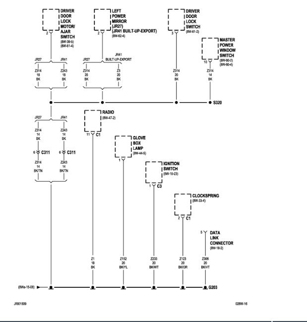

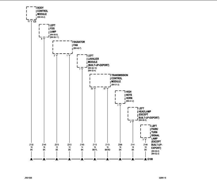

Okay, in the diagrams down below I have sent the entire set of ground distribution wiring diagrams from the vehicle manufacturer. I hope that this helps.
Thanks,
Alex
2CarPros
Nov 16, 2019 at 11:10 AM

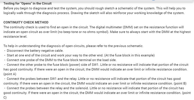

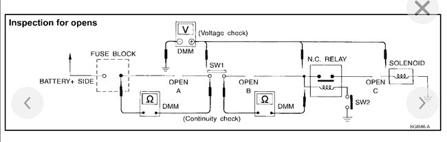

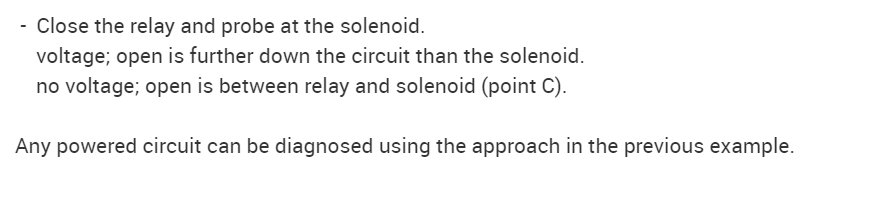

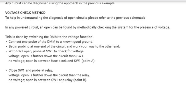

I'm sorry. I forgot to put the the guide in the previous reply. Here is the guide for how to find an open in an automotive electrical circuit that I promised earlier. The capacitors collect the Electro Magnetic Frequency [EMF] that results from the collapsing magnetic field of the coils used to fire the spark plugs and then routs it to a ground. This frequency can interfere with crankshaft/camshaft sensor signals, and is famous for causing a hum in the speakers of your car stereo. But first let's check the wire for an open that we talked about earlier, please. Please go through it and get back to us with what you find out.

Alex, i am not real good with the multi meter, but the connection seems fine per instructions. i didn't find any opens on the green/orange wire but when i change the relay inside the car same type of relay the fuses 24/25 both lit up the probe. when i turned key forward in cranking mode test light light up. i used the fan wire an got a new radio frequency capacitor, but car still no crank.

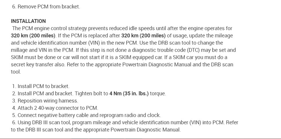

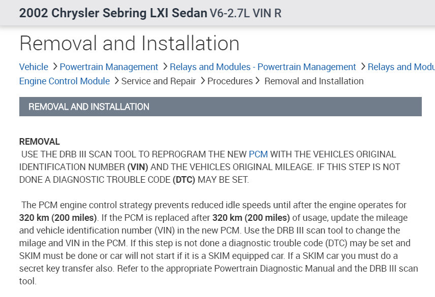

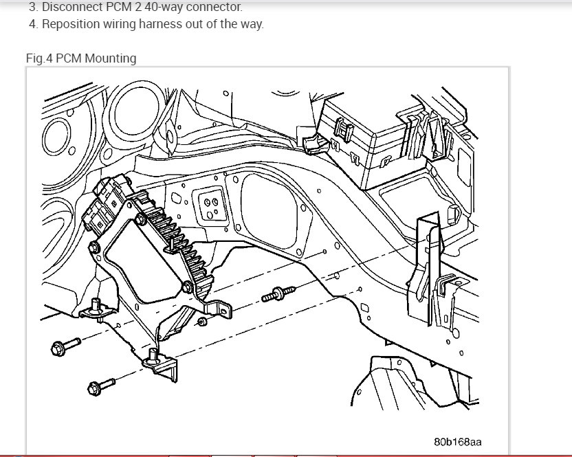

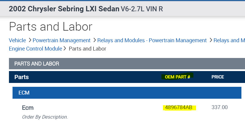

  • 85 POSTS

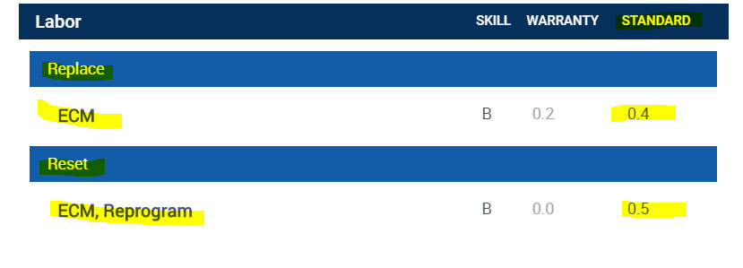

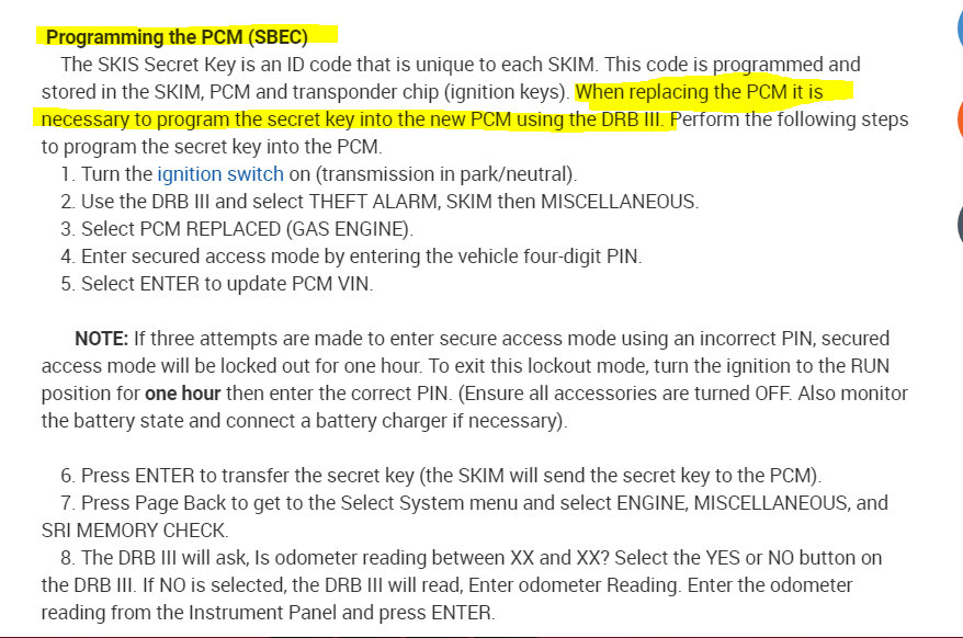

also if i change PCM would it have to b reset at a dealer or just as long as i get same year an all it plug an play.2nd i did do the water pump but i am pretty sure i did a good job putting timing back i lined up all sprockets an marks an set the primary tenssioner then rotated motor by hand two times an marks lined right back up done i dint move came as it was not a rest timing it was a water pump but could it b the time off i don't get any codes for cam or crank when i turn motor.
Nov 21, 2019 at 5:59 AM
SCGRANTURISMO
  • 4,897 POSTS
Hello again,
Okay, so if you cut the wire there then we might be looking at a bad PCM. As far as getting the timing chain/belt lined up with the timing marks, if you are able to turn your engine over a couple of times through the four stroke process with no resistance when turning it by hand, other than the resistance of turning an engine over by hand, then you are in the clear for being off on the timing, it's right. That wouldn't cause a no start from no spark either. Having said this, I have included in the diagrams down below the instructions for the removal and installation of your vehicle's ECM/PCM, along with the requirements when replacing said ECM/PCM. It will have to be reprogrammed to the Sentry Key Immobilizer Module[SKIM] at the dealership. I have also included the price for parts and labor for your vehicle's ECM/PCM should you decide to go that way. It looks like the cost for your ECM/PCM, removal and installation, and reprogramming will cost less than I paid for my PCM, used. To get the labor rate take the installation and reprogramming time add them together and then multiply that sum by the hourly shop rate in your area to come up with the labor cost. Also, please pay special attention to the highlighted areas of the guides, and whenever replacing anything electrical on your vehicle, disconnect the negative battery cable BEFORE you start. This will negate any power spikes from damaging sensitive electrical components. Please go through these guides and get back to us with how everything is progressing.
Thanks,
Alex
2CarPros
Nov 21, 2019 at 2:10 PM
DSTONEN
  • 85 POSTS

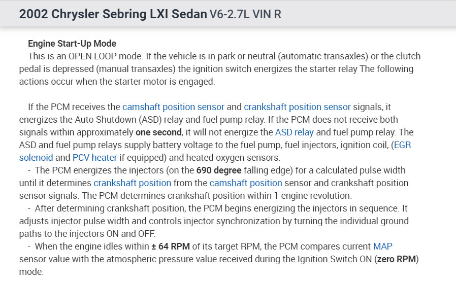

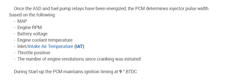

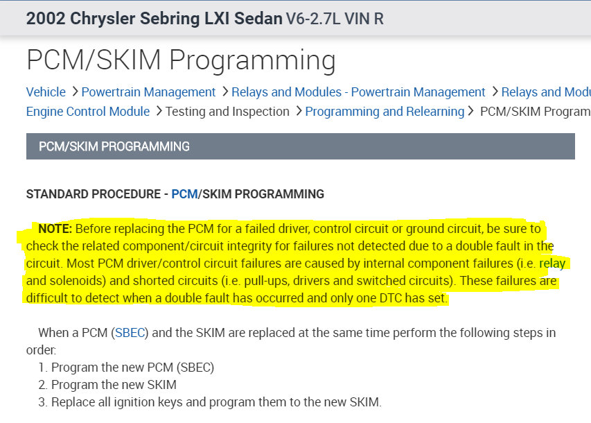

question, so i unplugged the cam sensor car crank right up the cam wheel was put on back wards buy mistake and i was tapping on it with a hammer and screw driver to force it to seat looks like after realizing it was backward. i can see some small dents on the very outside rim. could this be an issue an since car did crank? could it still be a PCM?
Nov 22, 2019 at 7:05 AM
SCGRANTURISMO
  • 4,897 POSTS
Hello again,
Yes it would. In the diagrams down below I have included exactly what happens with your vehicle in "Start Up" mode. Please go through this guide and get back to us when done. We can go from there with CMP wheel replacement instructions.
Thanks,
Alex
2CarPros
Nov 22, 2019 at 5:12 PM
DSTONEN
  • 85 POSTS
Wow too vague. i am asking do you still think i new PCM? and why even though car cranked up without cam plugged in.also can i take computer to dealer and have programmed or do i need to take car and all?Thanks
Nov 23, 2019 at 4:26 AM
DSTONEN
  • 85 POSTS
also, this motor was changed it is not the original. i don't remember programming the PCM for the used motor and i drove it for 2 years. I do not know.
Nov 23, 2019 at 4:41 AM
SCGRANTURISMO
  • 4,897 POSTS
Hello again,
Yes, I still think that your vehicle's ECM/PCM has bad drivers in it. If you read what I sent last time, it says that when the ignition switch is turned to "start" and the ECM/PCM receives both CKP and CMP signals it will energize the ASD Relay, which your vehicle does, but the fuel injectors or ignition coils are not getting power, which only leaves the drivers from the ECM/PCM. You can have your vehicle's keys programmed to the new ECM/PCM either at the dealership or by a locksmith. There are no other options here.
Thanks,
Alex
2CarPros
