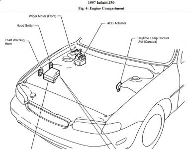

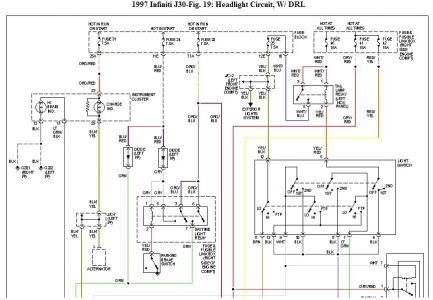

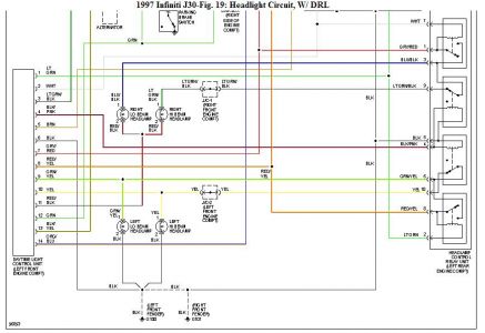

Here is a diagram of the healight circuits for your understanding. Since jump starting the vehicle had the headlight working briefly, the most likely cause would be the DRL control unit. Check the control unit wire harness connector and note if there are any contaminations.

Is the DRl the same as the headloight relay? Also I ca not read the wiring diagram not. Thank you
-1
Tuesday, July 28th, 2009 AT 9:02 AM
KHLOW2008
  • 41,814 POSTS
No, the DRL Unit is not the same as headlight relays. It is a small control box with 14 terminals.
Sorry the diagrams did not show up well. I am only able to print the diagrams to mdi files and can send it to you via email if you have the program to open it.
