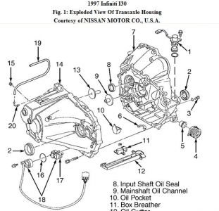

How do I drain and refill the final drive oil?
Where do I ADD?

Hi C109RT, Thank you for the donation. The trans and differential gear oil are in the same assy and the drain plug is Item # 3. Filler plug is on side of trans, Item # 15 in the diagram. You need a pump or tube to fill up to lower mark of filler plg, ie fill till it flows out of filler plug.
