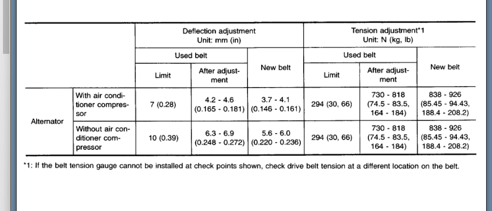

When installing a serpentine belt alt belt how much tension should be on the belt?
Nov 12, 2008 at 3:35 PM

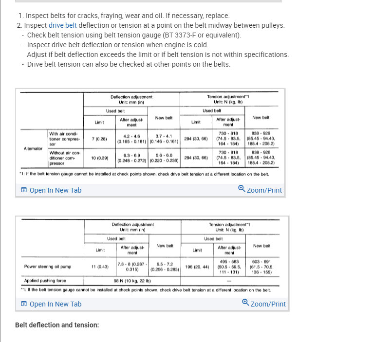

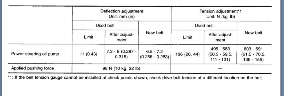

I will attach the info below on the torque specs and process to check the belt.

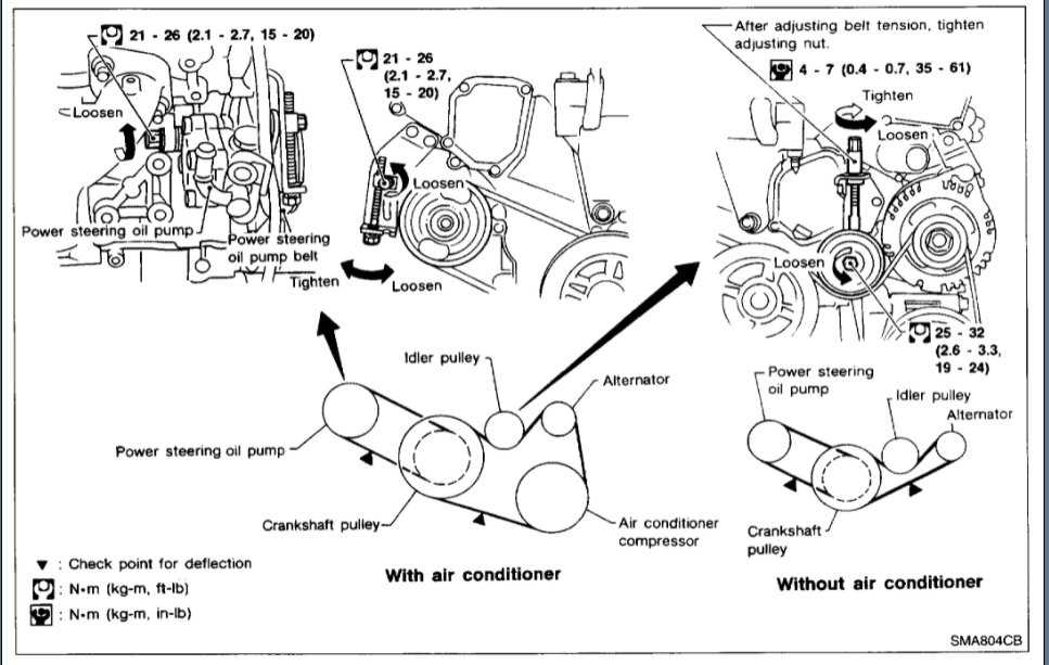

Here is a guide that will help with replacement:
The specs are in the first illustration next to the small image of a wrench on a bolt.
Then the legend of what the measurements are in the lower left corner.
Please take a look at this info and let me know what questions you have.
Thanks
