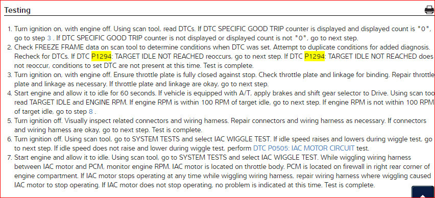

I have owned this vehicle for about eighteen months and no mechanic has been able to figure out this idle problem. It usually runs high, about 1,000 rpm's in gear and up to 1,400 in park. Sometimes it idles beautifully at 750-800 in gear and occasionally gets as low as 400 but does not shut off. So far I have had the vacuum lines smoked twice (two leaks found first time); replaced the spark plugs, TPS, IAC (twice), PCV, throttle body gasket and computer; and cleaned throttle body. Nothing has worked! The only code I get when the CEL is on is P1294, which is not exactly specific. Any other ideas me or my mechanic can follow up on?
Nov 22, 2018 at 12:31 AM
DANNY L
  • 5,648 POSTS

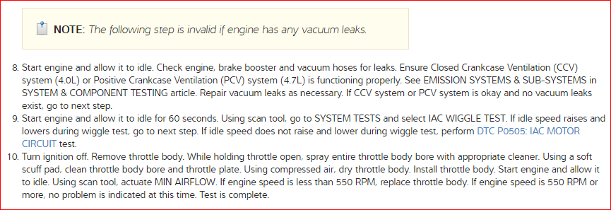

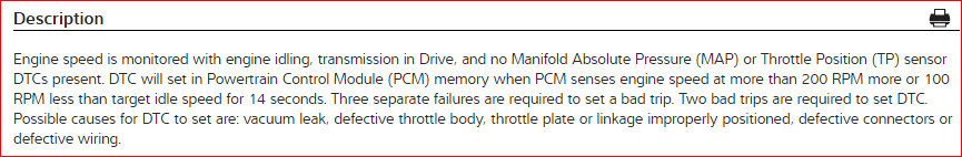

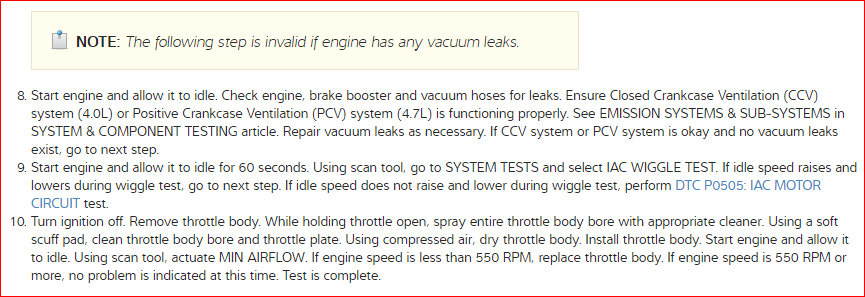

Hello, I am Danny,
I have attached a series of pictures for testing your Idle issues. I would have your mechanic check for MAP (Manifold Absolute Pressure) or TPS (Throttle Position Sensor) problems. Hope this helps and thanks for using 2CarPros.

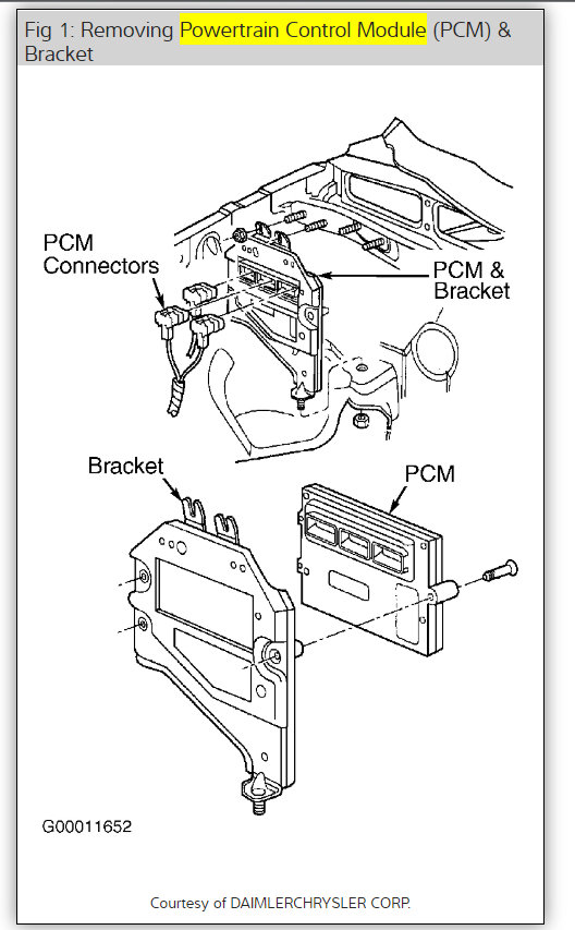

It sounds like you have a bad PCM. I would try a used/rebuilt unit to see what happens here is the location below.
Here is a guide that can help as well:
https://www.2carpros.com/articles/engine-idles-too-high
Nov 26, 2018 at 3:06 AM
CHIROKAT74
  • 19 POSTS
So the PCM and computer are they not the same thing? The computer (says ECM on the receipt) was one of the first things replaced because that mechanic said all the sensors tested fine. My regular mechanic shop had it all day last week and could not find anything that fixed the problem. He said when they hooked everything back up and tried to do the relearn process that he had to “tap a sensor on the side of the throttle body” to get it to work. They called it an idle sensor, not sure what he is talking about. I gave them the same list of replaced parts that I posted here. Spent a lot of time and money chasing the problem and nothing has worked so far.

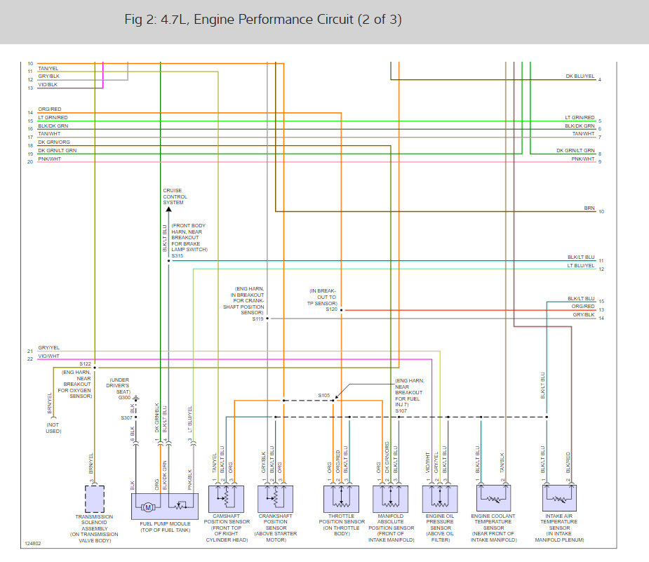

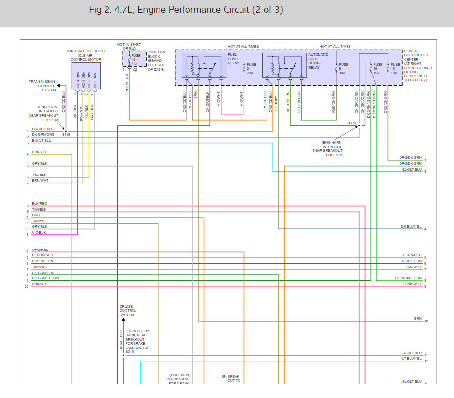

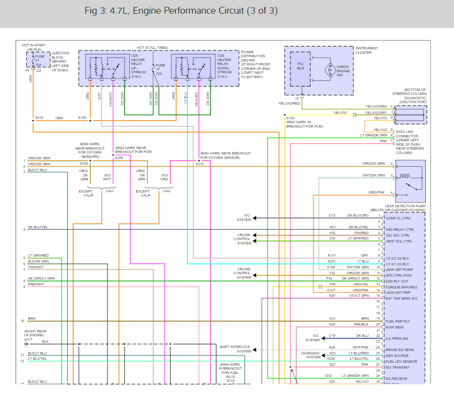

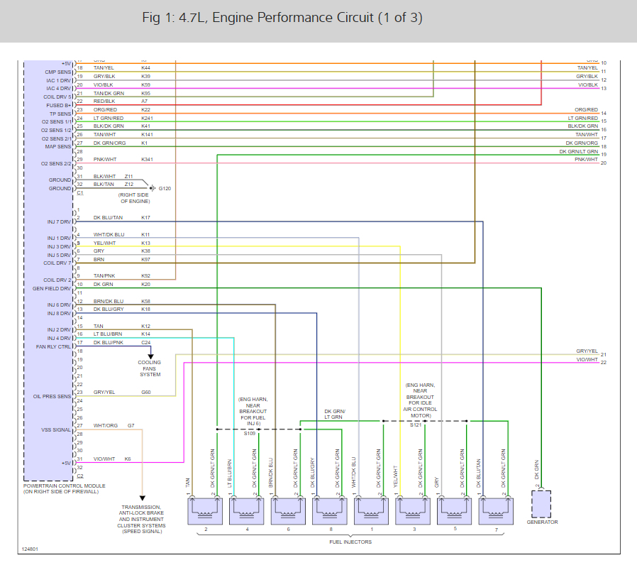

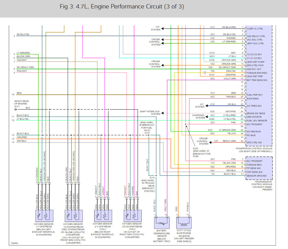

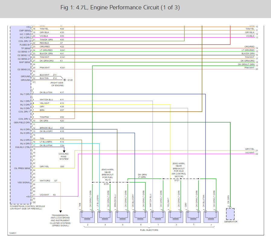

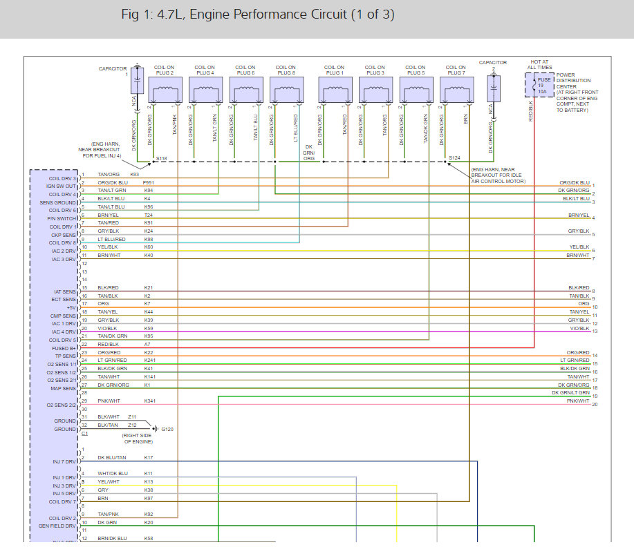

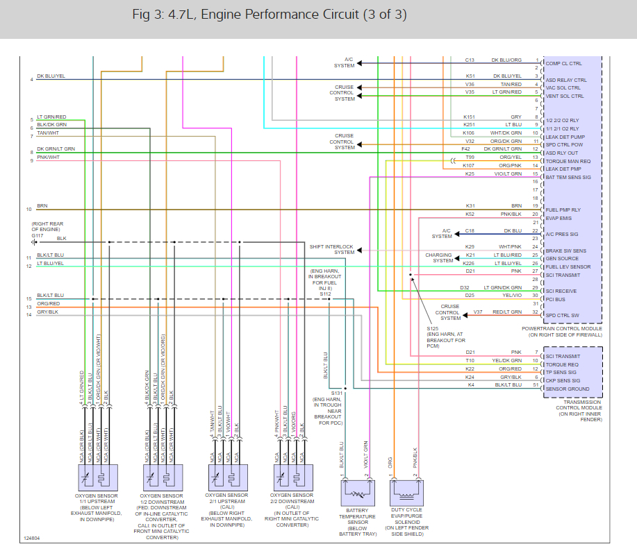

Sorry, missed that in the first post. Can you remove the vacuum line to the power brake booster and plug it to see if that makes a difference please? If that does not work lets do a pin to pin test to check for high resistance wires in the throttle control circuits. Here is a guide and the engine wiring diagrams so you can get started:
Check out the diagrams (below). Please run some tests and get back to us.

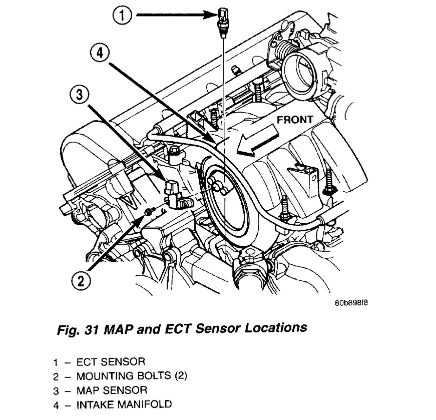

That is a good bit over my head, I am afraid, but I actually just asked today about the possibility of an electrical issue since the problem is not constant. I have not been able to leave it with them as it is my only transportation; however, they are going to give me a loaner next week so they can start checking the more in-depth possibilities. I do have a new symptom that may or may not be related; the gas pedal is now sticking in the starting/resting position. This just started when I got it back from the shop last week; they thought maybe they had a clamp sitting in the way from reassembly but all was fine. When it is idling high and I take my foot off the brake, the car will accelerate itself to upwards of 10 mph. Also, the sensor they tapped was apparently the MAP sensor; that is one I actually have not replaced!

A MAP sensor could definitely cause the issue. Here is its location so you can replace it.
