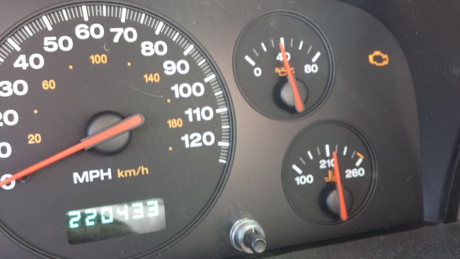

I can crank up on a cool morning and it will run perfect and has fooled many shops and mechanic's ! I can leave the shop after getting it warmed up and having to sit in road construction at a idle. I can feel my car miss , then the rough idle starts. I opened my car door and it smells like un-burned gas and is smoking. I am sure because the gas is not being burned. I have actually had to pull over because when trying to proceed in traffic, it would not even pull off because of the flooded situation. Code came up, pulled into a shop and he said it was showing 0-2 sensor, but that was because it was running so rich. He did not think that is it. We have new plugs, coil pack, crank sensor, fuel filter, and the last shop yesterday put in a cam sensor. on the way home I broke down because it was missing so bad. have not re-placed map sensor or 0/2 sensor. I Love my car, but I have an eight year old child and I might die in traffic, but I do not want my child to even ride with me. This is my family car and has been kept up well. Please help me. I cannot keep buying parts and paying shops and not even make it home!
