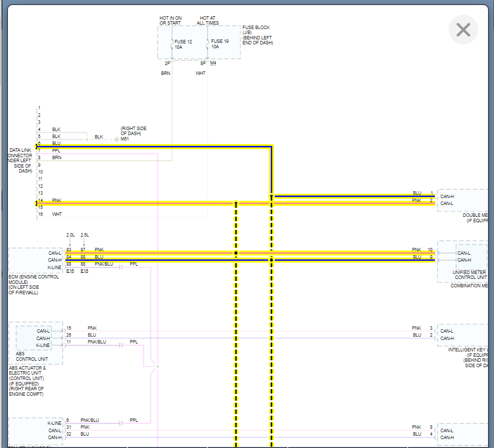

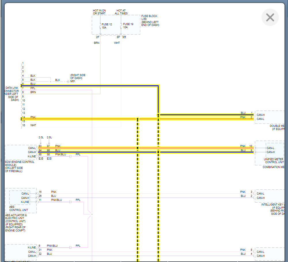

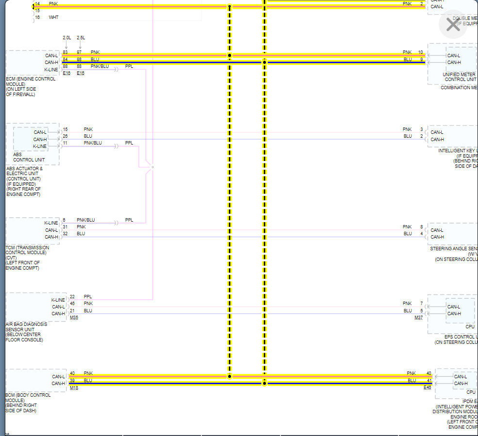

First,
OBD II scanner not reading or connecting to data port under dash to pull codes. All fuses are okay under the driver's dash and under the hood. Battery is reading 11.74 volts, starter cranks but engine not engaging after finding out a burnt wire to the starter shunt was bad (it has been replaced and power is flowing to that wire).
