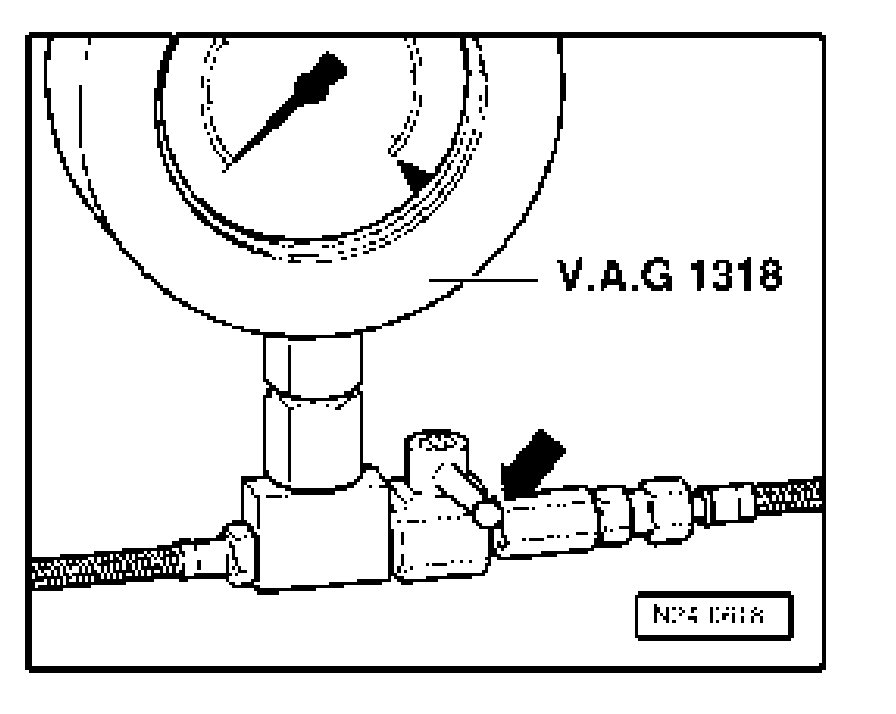

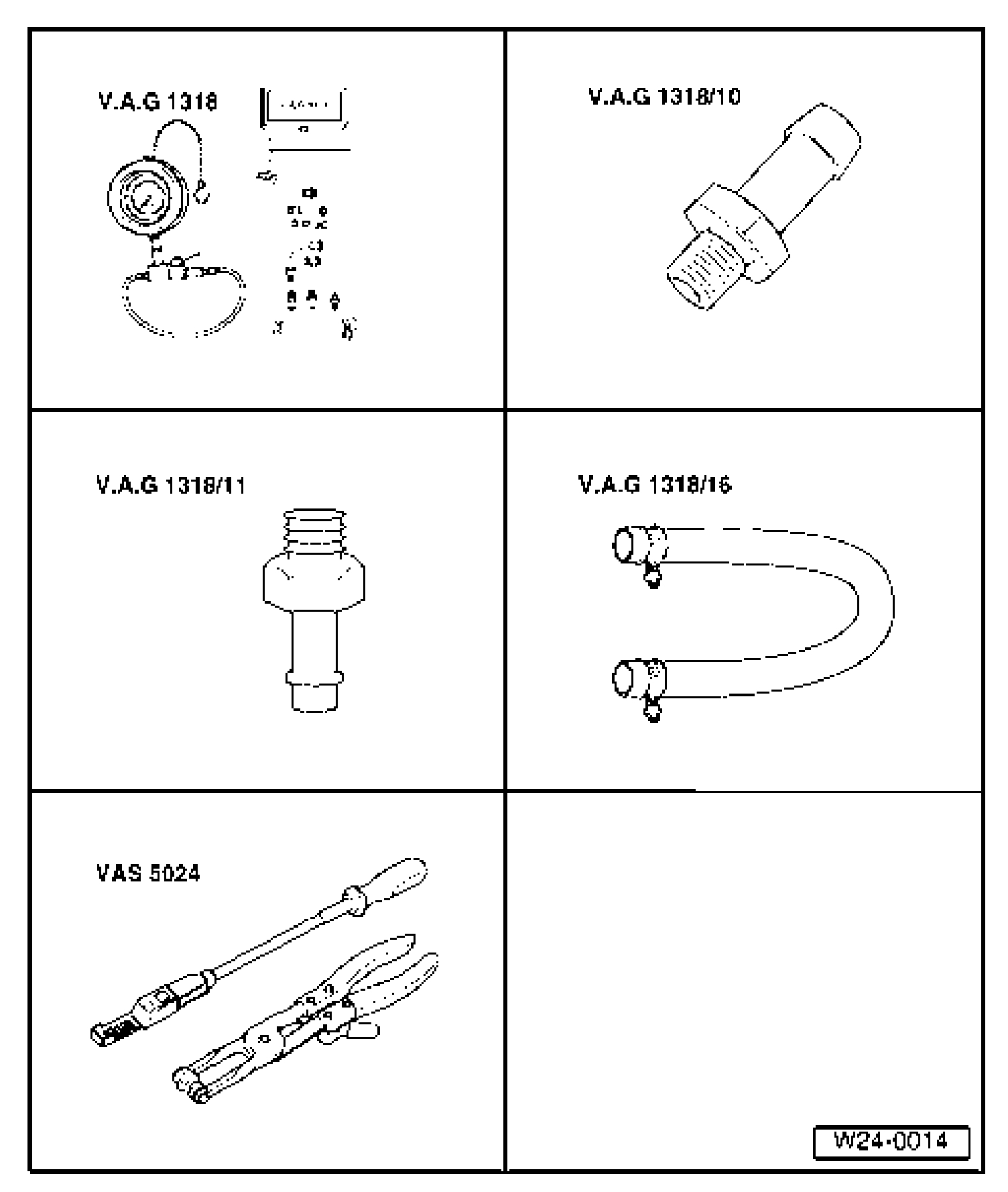

Got back in car after quick stop, motor turned over, no start. Changed fuel filter, I didn't notice before, but battery was bad after only year. Took it to AutoZone, wouldn't even hold a charge. Five year battery. replaced battery, still just starts and stops with immobilizer light flashing. I had a new key cut for it last year by locksmith, while he synced it with the car. Mechanic friend says replace fuel pump, I hear it buzzing though, sounds like it is getting gas, can it forget the key already? I had sensors and all kinds of stuff replaced last year by VW certified mechanic before getting new key. Was running fine until last month. Thank you! I also have original valet key, which did nothing either.

First, I would recommend checking to see if fuel pressure is within the manufacturer's specs. If you hear it running, then you need to confirm it's working correctly. If it does and still doesn't start, then I suspect the immobilizer is the problem.
Here is a link that shows in general how to check fuel pump pressure:
Here are the directions specific to your vehicle for testing. You will need a scanner to complete these directions. The attached pictures correlate with these directions.
With Generic Scan Tool
Vehicle Power-train Management Fuel Delivery and Air Induction Fuel Pressure Regulator Testing and Inspection Component Tests and General Diagnostics Fuel Pressure Regulator and Residual Pressure, Checking With Generic Scan Tool
WITH GENERIC SCAN TOOL
Fuel Pressure Regulator And Residual Pressure, Checking
Function
The fuel pressure regulator controls the fuel pressure as a function of the Manifold Absolute Pressure (MAP).
The specified value for this test is dependent on the working pressure of the Fuel Pump (FP). This is approx.. 3.0 bar positive pressure

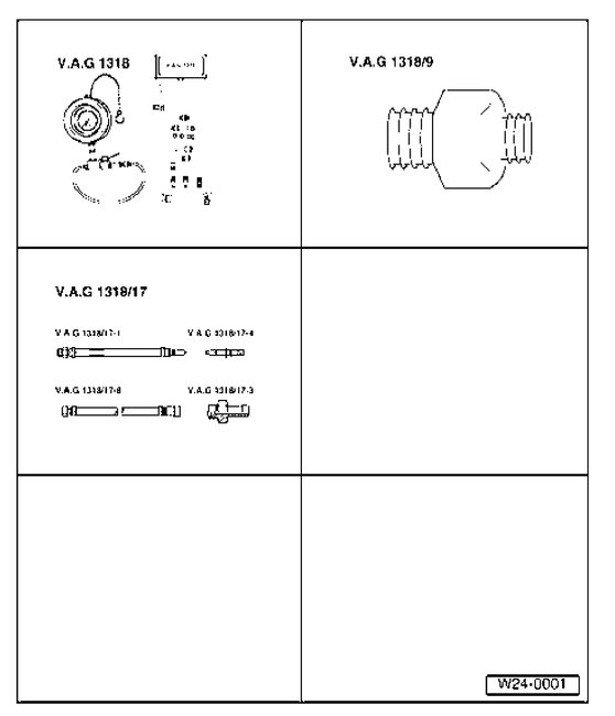

Recommended special tools and equipment
Vehicles with engine code AEG, AVH, AZG
- V.A.G 1318 pressure gauge
- VAG 1318/10 adapter
- VAG 1318/11 adapter
- VAG 1318/16 hose adapter
- VAS 5024 assembly tool for spring-type clamps

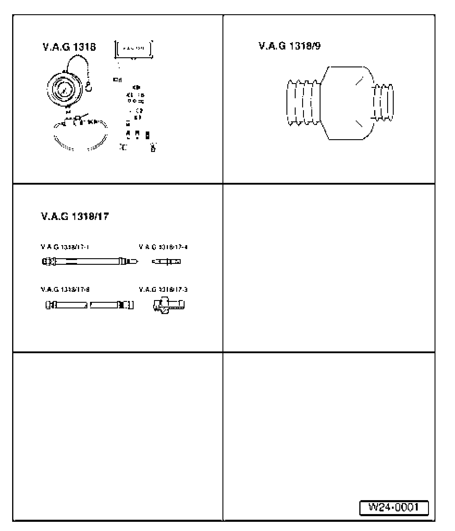

Vehicles with engine code BDC
- VAG 1318/9 adapter
- VAG 1318/17 adapter
Test requirements
- Parking brake must be engaged or else daylight driving lights will be switched on.
- For vehicles with automatic transmission, selector lever must be in position -P- or -N-.
- Delivery quantity of Fuel Pump (FP) OK. See: Fuel Pump > Testing and Inspection

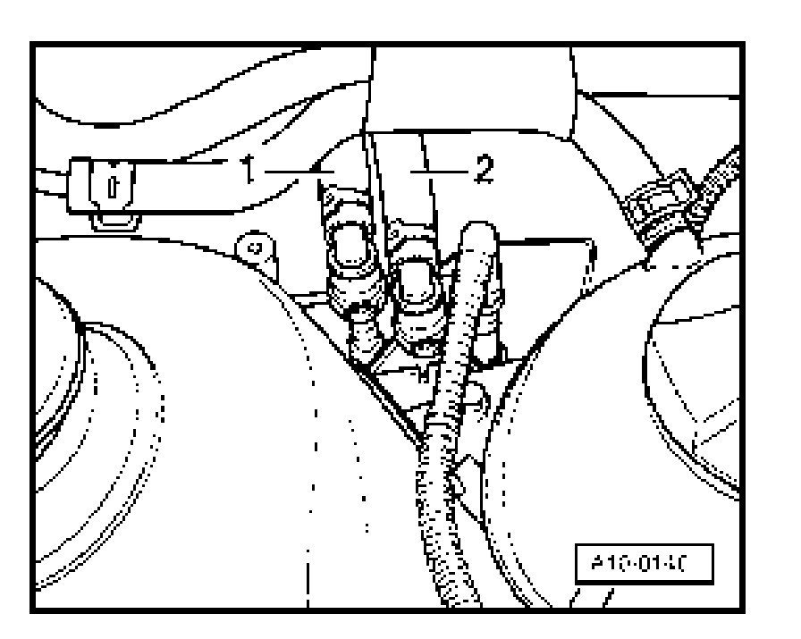

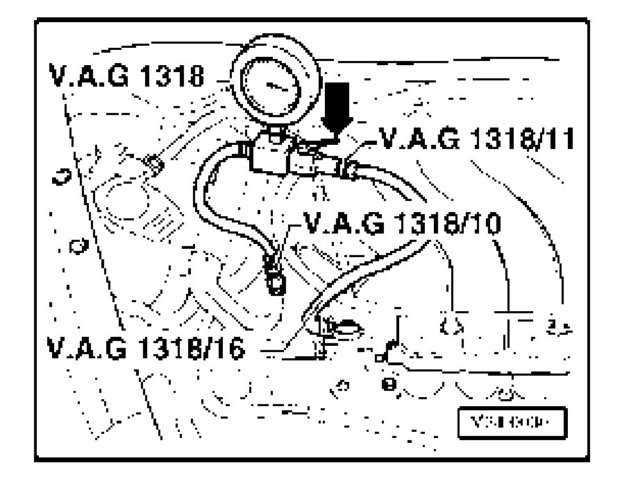

Test sequence (Vehicles with engine code AEG, AVH, AZG)

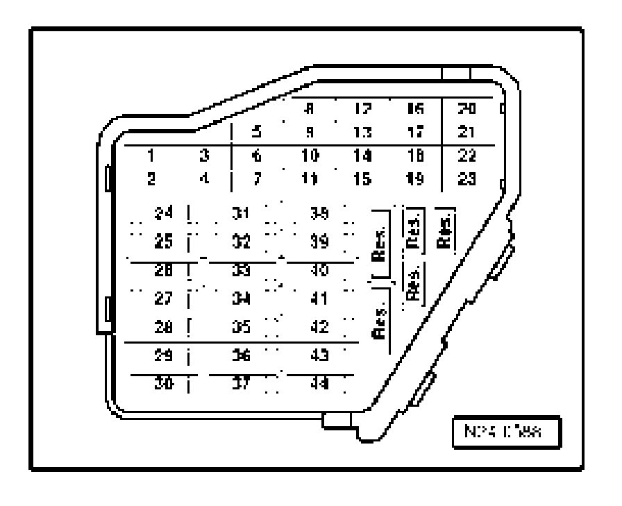

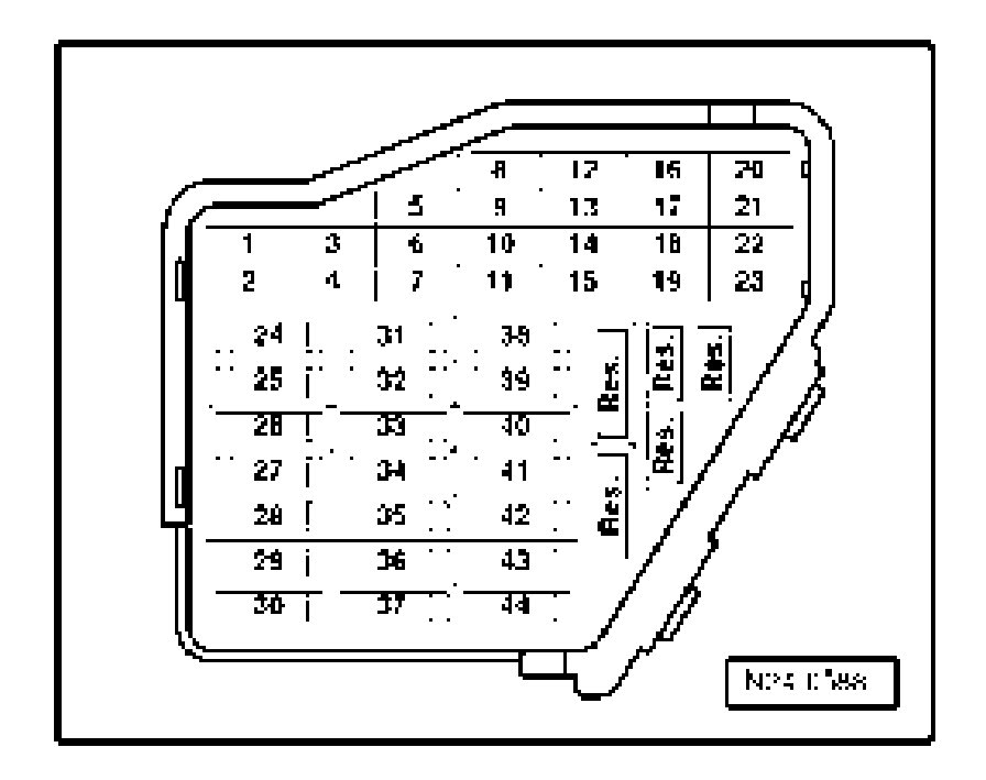

- Remove fuse 28 from fuse holder.
NOTE: By removing fuse 28, the voltage supply for the Fuel Pump (FP) is interrupted for safety reasons, otherwise the Fuel Pump (FP) would start up when the driver's door is opened.
WARNING: Fuel system is under pressure. Before opening system, place rags around the connection point. Then release pressure by carefully loosening connection.

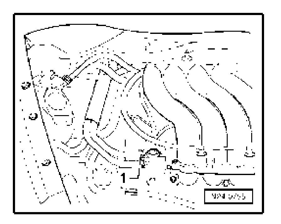

- Disconnect fuel supply line -1- (black) from fuel distributor and catch escaping fuel using a rag.

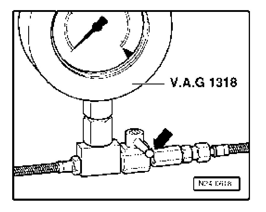

- Connect pressure gauge to adapter (VAG 1318/10) at supply hose and to adapter (VAG 1318/11) and hose adapter (VAG 1318/16) at supply line.
- Open shut-off valve of pressure gauge. The lever points in the direction of flow (arrow).
- Re-insert fuse 28 (fuel pump) in fuse holder.
- Start engine and let run at idle.
- Measure fuel pressure. Specified value: approx.. 2.5 bar positive pressure
- Disconnect vacuum hose -1- from connecting piece -2-. Fuel pressure should rise to approx.. 3.0 bar positive pressure rise.
NOTE: If fuel should escape at the vacuum connection of the pressure regulator, replace fuel pressure regulator, item 1.

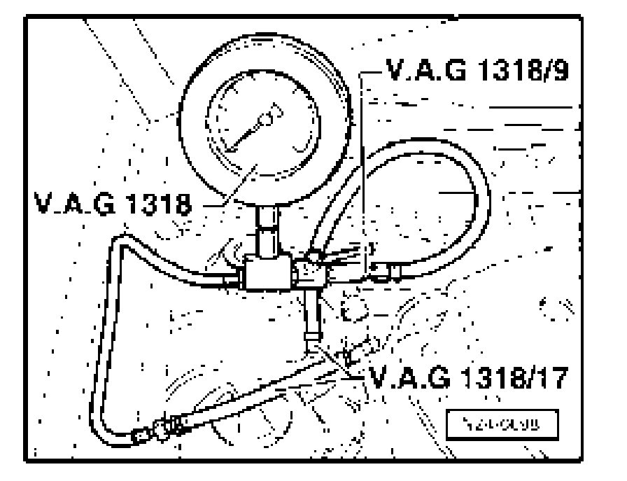

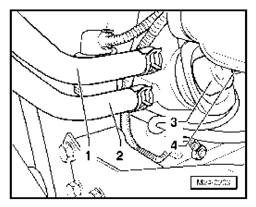

Test sequence (Vehicles with engine code BDC)
- Disconnect coupling of fuel supply line -1- (black or black markings) and catch escaping fuel using a rag.
NOTE: For this, press together buttons at hose connection.
- Connect pressure gauge (V.A.G 1318) using adapters ((V.A.G 1318/9 and 1318/17) to supply line and to hose to fuel distributor.
- Open shut-off valve of pressure gauge. The lever points in the direction of flow.

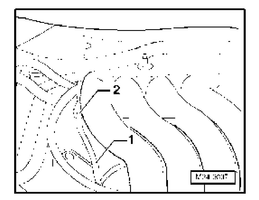

- Disconnect vacuum hose -4- from fuel pressure regulator -3-. Fuel pressure should rise to approx.. 3.0 bar positive pressure rise.
NOTE: If fuel should escape at the vacuum connection of the pressure regulator, replace fuel pressure regulator, item 14.
