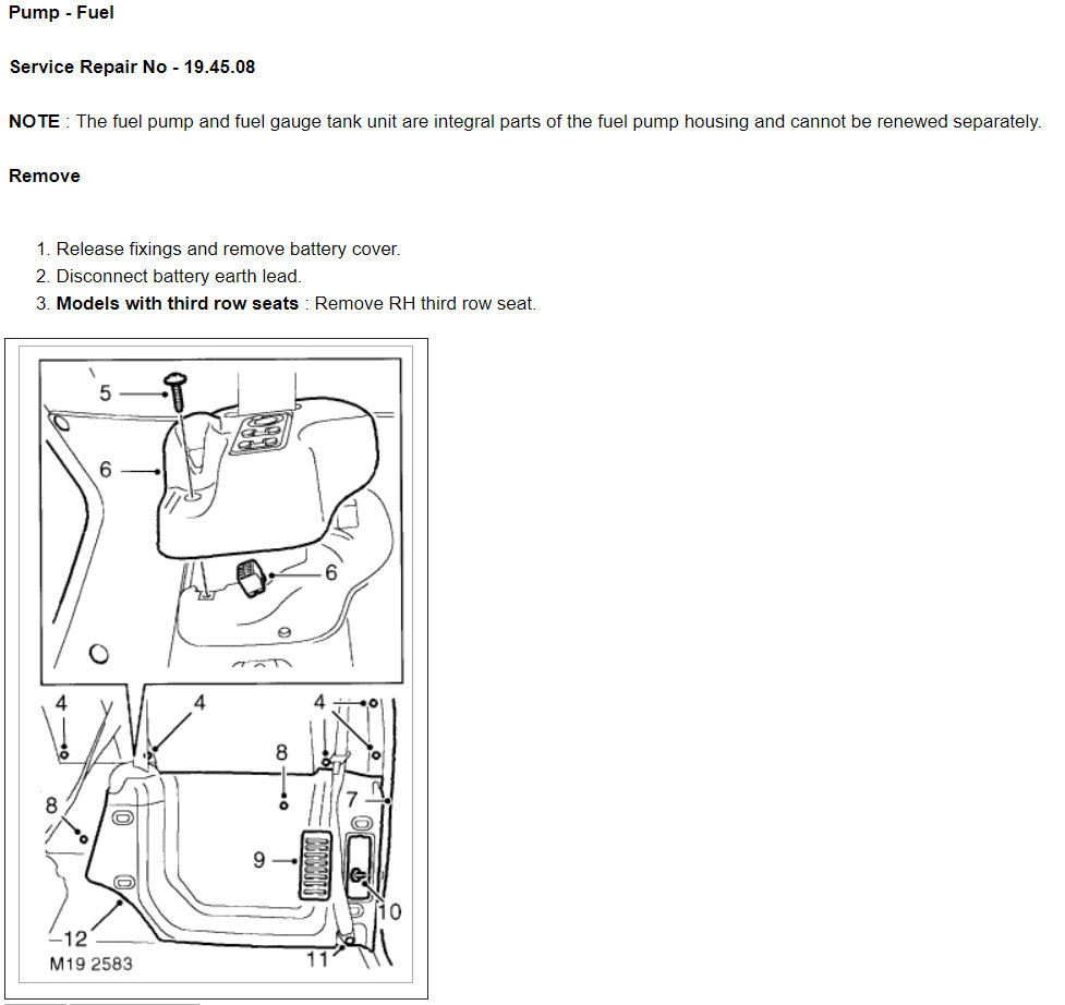

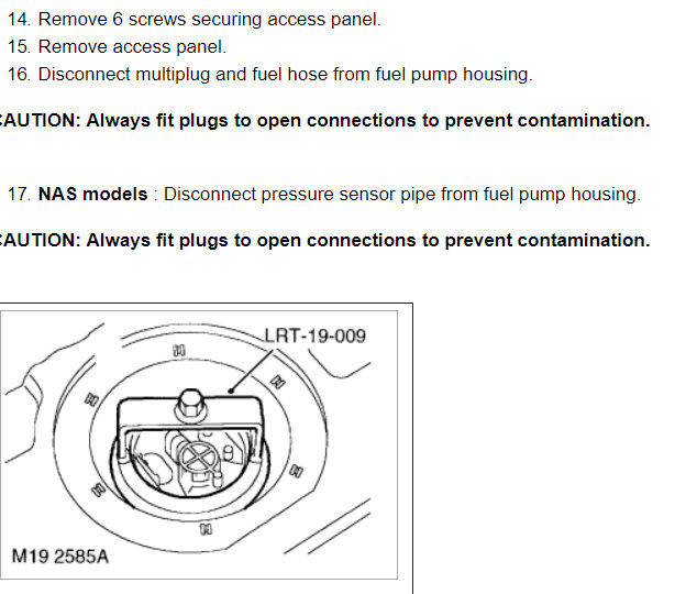

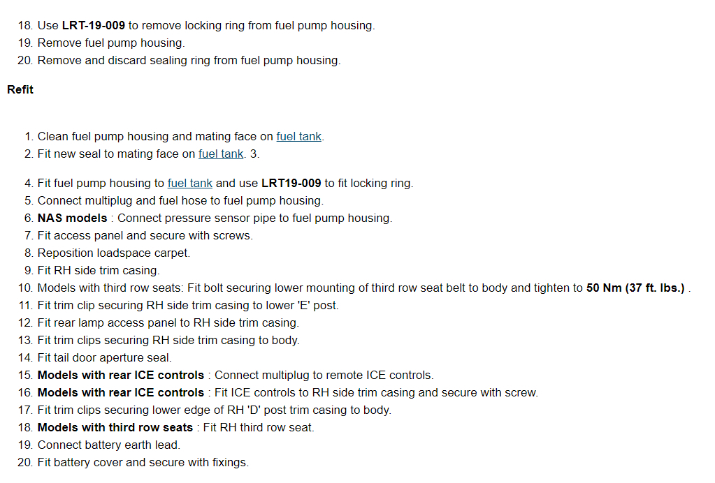

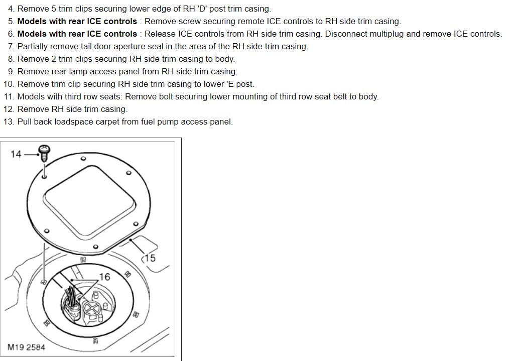

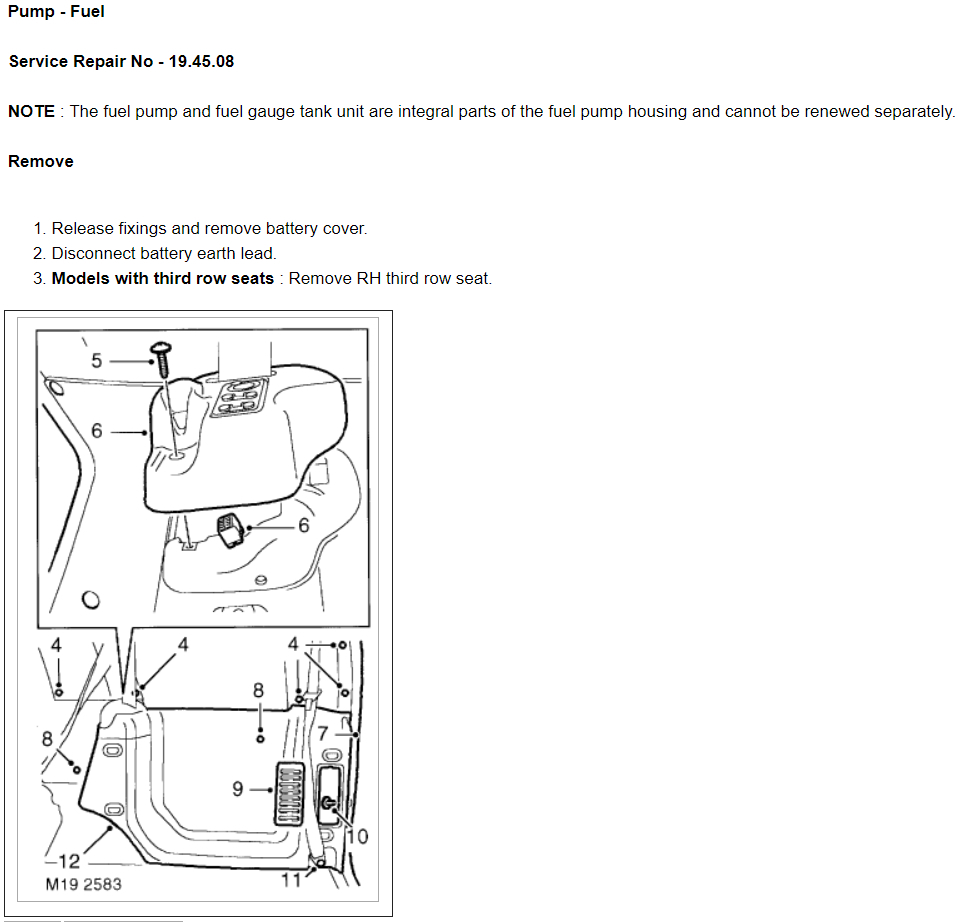

  • 54,832 POSTS
If you do need a fuel pump its not too bad in your car becasue you have a trap door. Here is a guide to show you what you are in for when changing the pump out.
https://www.2carpros.com/articles/how-to-replace-an-electric-fuel-pump
Here is how it will be for your car
