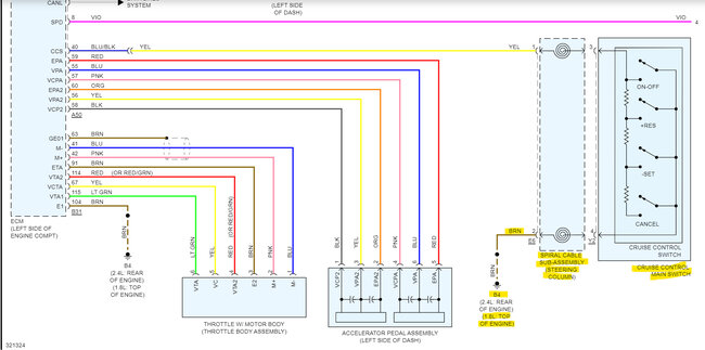

Hi, I'm having issues with my cruise control. I was able to find the most common reasons why it wouldn't work which are "module, sensor or switch issues, or throttle actuation problems." But how do I know which thing it is?

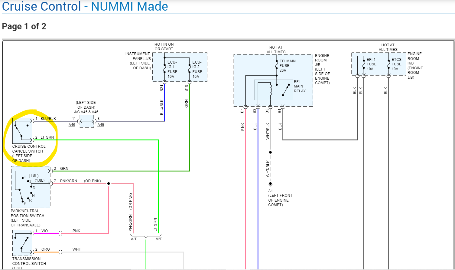

Hello, what size engine do you have and is it Auto or Manual transmission? And when you press the Cruise Control switch on button do you get any light on the Dash (Instrument Cluster) indicating the system turned on?
Also, there are some design differences for this year, going over service information it seems Toyota shifted over to a different company still under the Toyota brand, but there are some minor changes in the wiring diagrams I'm seeing.
So, there is a tag under the hood in the engine compartment and a tag on the driver's door frame. One of these tags may mention TMC made, or NUMMI made. If it is there including that information as well. Because it does include the cruise control and instrument cluster in the differences.

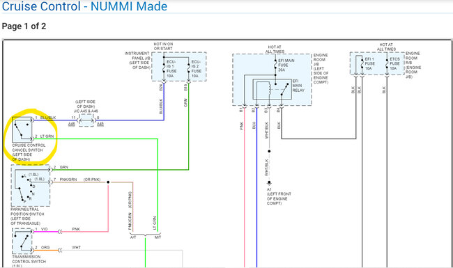

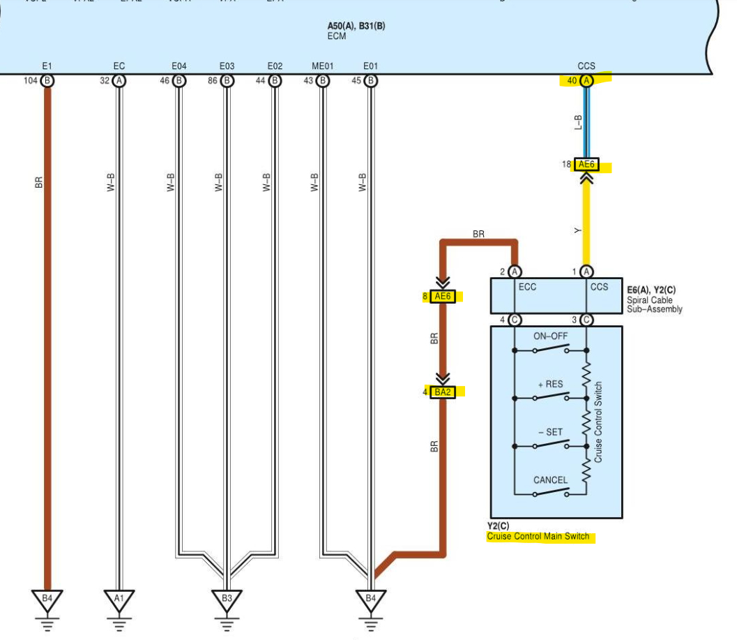

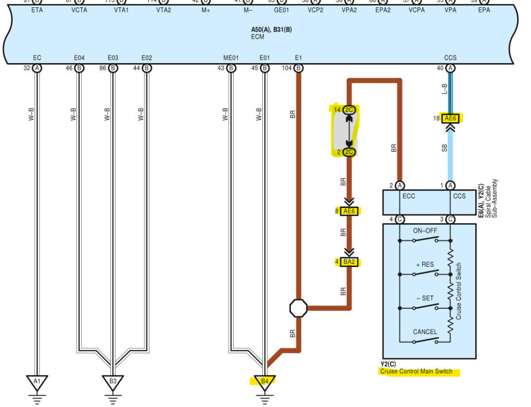

There is only 1 tag usually on the underside of the hood or near where the hood latch is on top of the radiator. It might not be listed. Another difference between the 2 designs is this additional Cruise Control Cancel Switch on the left side of the dash. The other design does not have this switch. It only has one Cruise control switch with an on button, Res, Set, and Cancel buttons.

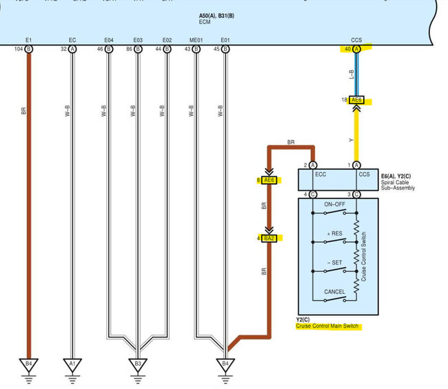

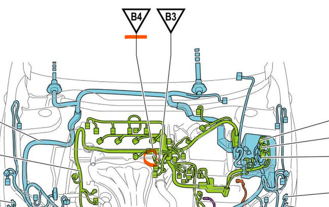

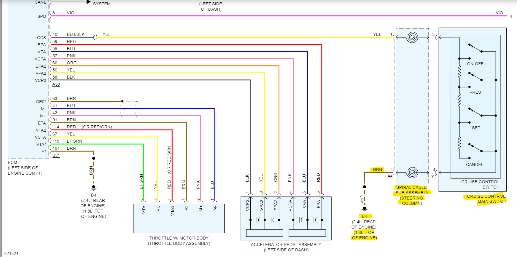

Do you have any warning lights on the Dash that are on, such as check engine light, brake light, traction control or ABS light? The most likely failure here is the clock spring inside the steering wheel. The wires for the cruise control run through there and they don't last usually past 100,000 miles.
You can check the Ground wire for the Cruise Control switch, which is in the 2nd diagram labelled B4, it's a brown wire that is bolted to the engine cylinder head. But the only real way to test this cruise control switch circuit is to measure the voltage at the engine computer to the B4 ground location while pressing the control buttons and see if there is a voltage change. There are a number of connectors the control wires run through so it can also be one of them, diagrams 3 and 4 are of each design and high lighted in yellow is each connector the wire runs through. Another concern though is that there is going to be an air bag in the front of the steering wheel, and if you are not familiar with working on these systems, the air bag can go off, even with testing with a multimeter.
