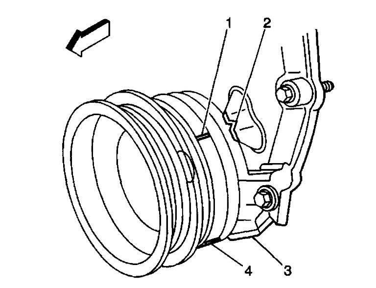

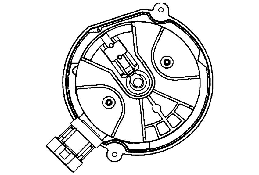

I just installed a new distributor in my vehicle but i can't seem to get the ignition timing right. I am at TDC on the compression stroke but still does not want to line up. Is there any diagrams i can look at so i know exactly where the marks are so i can complete this task? I'd really appreciate it. Thank you

Good afternoon,
The distributor is a cam sensor and needs to be aligned with the crank sensor.
What you install the distributor, you set it on the notch. Then you need a scan tool to read the cam retard. It should around 0 maybe a degree or 2 either way. If it is off more than that, you may need a timing chain or the gear on the end of the distributor.
What have you done so far?
NOTE: The Distributor is located in a fixed, non-adjustable position. No attempt should be made to adjust the engine base timing by rotating the distributor. Attempting to do so may result in engine cross-fire and mis-fire conditions. Timing is not adjustable.
IMPORTANT: The engine front cover has 2 alignment tabs and the crankshaft balancer has 2 alignment marks (spaced 90 degrees apart) which are used for positioning number 1 piston at top dead center (TDC). With the piston on the compression stroke and at top dead center, the crankshaft balancer alignment mark (1) must align with the engine front cover tab (2) and the crankshaft balancer alignment mark (4) must align with the engine front cover tab (3).
1. Rotate the crankshaft balancer clockwise until the alignment marks on the crankshaft balancer are aligned with the tabs on the engine front cover and the number 1 piston is at top dead center of the compression stroke.

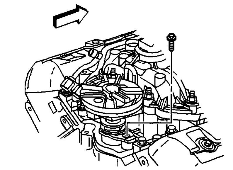

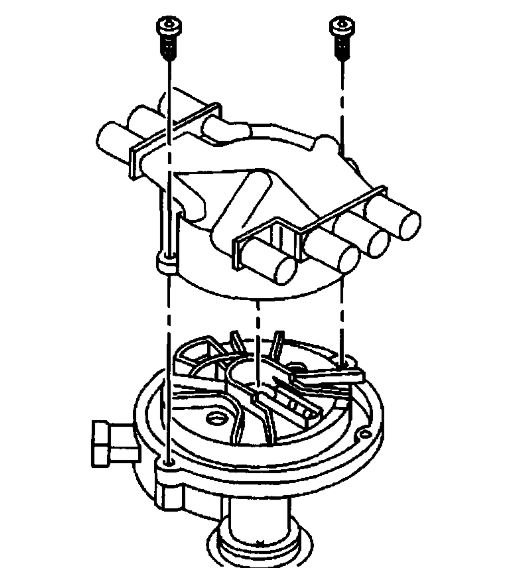

2. Remove the distributor cap bolts and discard.
3. Remove the distributor cap.
4. Install a NEW distributor gasket onto the distributor.

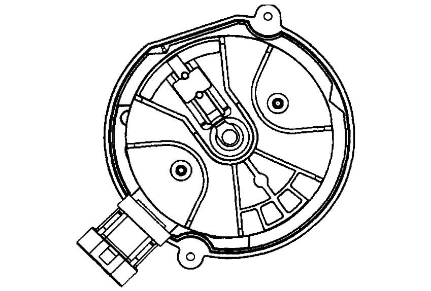

5. Align the indent hole on the driven gear with the paint mark on the distributor housing.
6. Ensure that the distributor rotor segment points to the cap hold area.

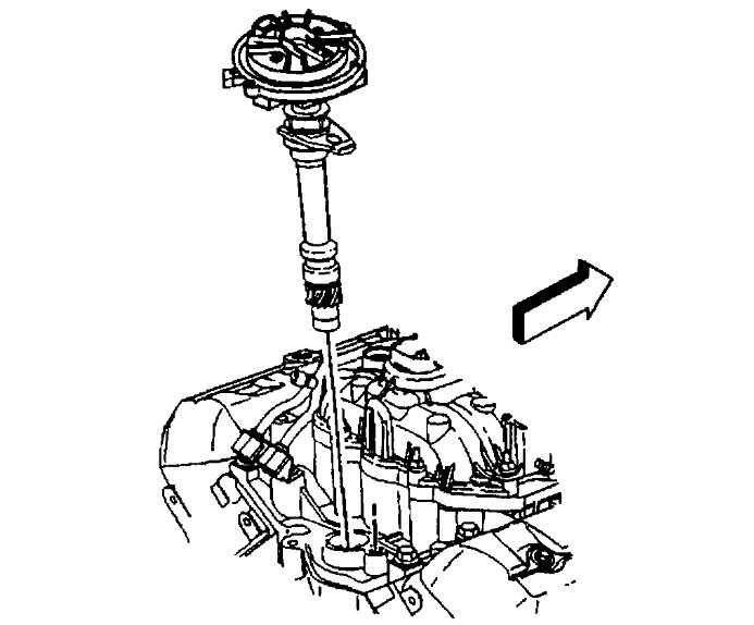

7. Align the slotted tang in the oil pump driveshaft with the distributor driveshaft.
Rotate the oil pump driveshaft with a screwdriver if necessary.
8. Install the distributor and distributor clamp.
The flat in the distributor housing must point toward the front of the engine.

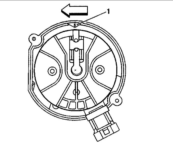

9. Once the distributor is fully seated, align the distributor rotor segment with the number 6 pointer (1) that is cast into the distributor base.
If the distributor rotor segment does not come within a few degrees of the number 6 pointer (1), the gear mesh between the distributor and camshaft may be off a tooth or more. Repeat the procedure again in order to achieve proper alignment.
10. Install the distributor clamp bolt.
Tighten the distributor clamp bolt to 25 Nm (18 ft. lbs.).
NOTICE: Refer to Fastener Notice in Service Precautions.
11. Install the distributor cap and NEW distributor cap bolts.
Tighten the distributor cap bolts to 2.4 Nm (21 inch lbs.).
12. Install the ignition coil wire harness.
