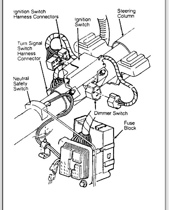

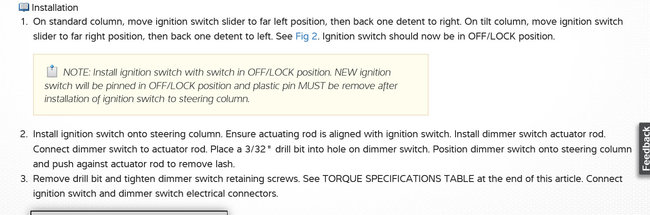

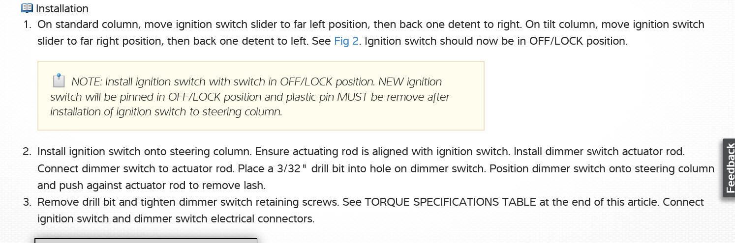

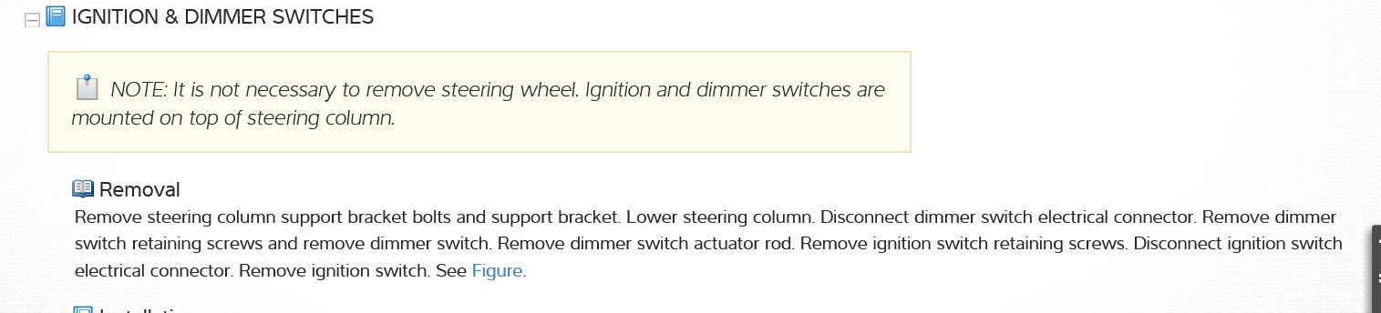

My van would not turn off I got it off and the part where the key goes in popped out some now I can not get it to turn over I was told to replace my ignition switch how would I acsess the ignition switch with tilt steering with a solid tube stearing Colum

Here is how you can change out the ignition switch. Check out the diagrams (Below). Please let us know if you need anything else to get the problem fixed...........................
