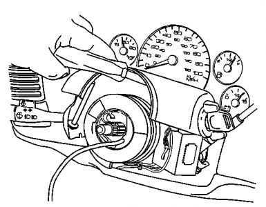

Key comes out and goes in but does not turn the cylinder, to be able to unlock cylinder. How does one get the cylinder out if not able to turn it?

Lift the steering column upper trim cover to gain access to the lock cylinder access hole.
https://www.2carpros.com/forum/automotive_pictures/12900_i1_5.jpg
Using a bent tip awl, insert the tip into the ignition lock cylinder access hole.

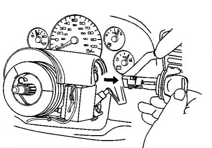

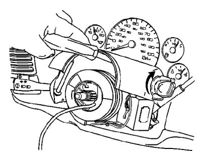

Turn the ignition lock cylinder to the START position. Using the bent tip awl, push down on the ignition lock cylinder retaining pin.
Release the ignition lock cylinder to the RUN position.
https://www.2carpros.com/forum/automotive_pictures/12900_i3_4.jpg
Remove the ignition lock cylinder from the lock module assembly by pulling the ignition lock cylinder away from the steering column.

Unfortunately, these locks are designed to be removed in the "on" position and when you cannot turn them on, you have another set of problems. It's going to require drilling out the lock pin and you have to be very careful doing that because the housing that surrounds it is softer metal than the pin and that cannot be damaged or you will have to change the whole column housing. You might want to let the pros do this one.
