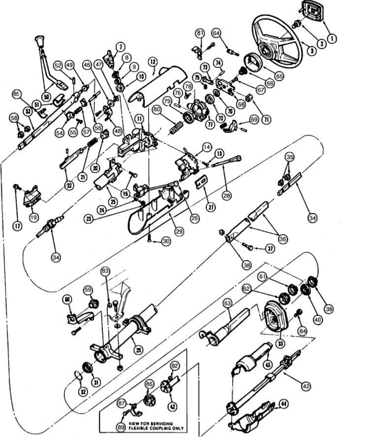

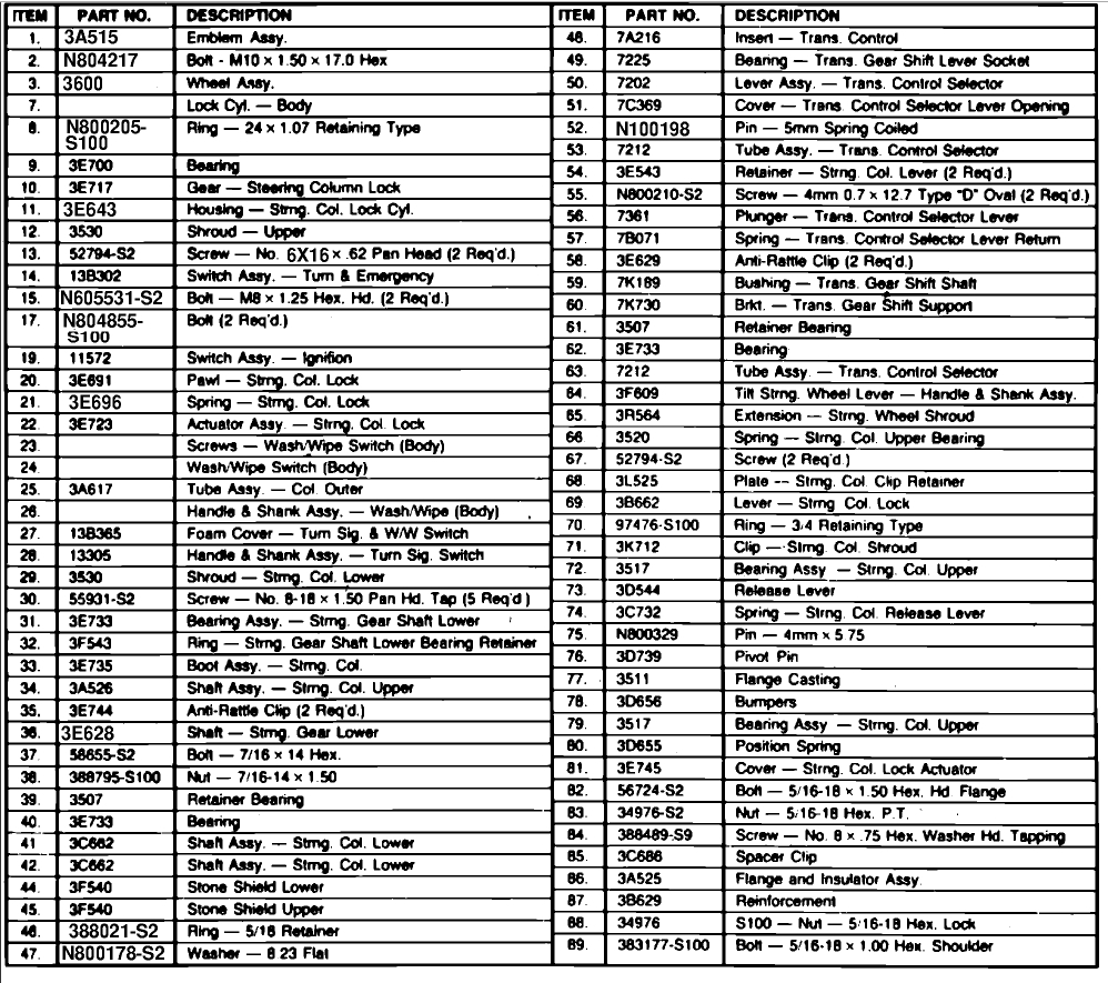

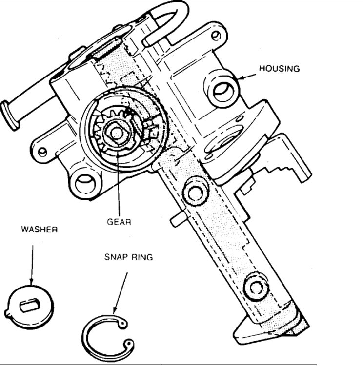

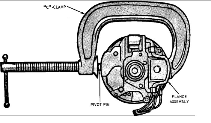

Need to replace Ignition module and lock cylinder.
Sep 11, 2017 at 11:03 AM
  • 55,649 POSTS
You will need to remove the steering wheel to start. Here is a guide to help with that:
https://www.2carpros.com/articles/steering-wheel-removal
Yours will need a puller.
Here are some diagrams on how to replace the ignition key and tumbler (below).
