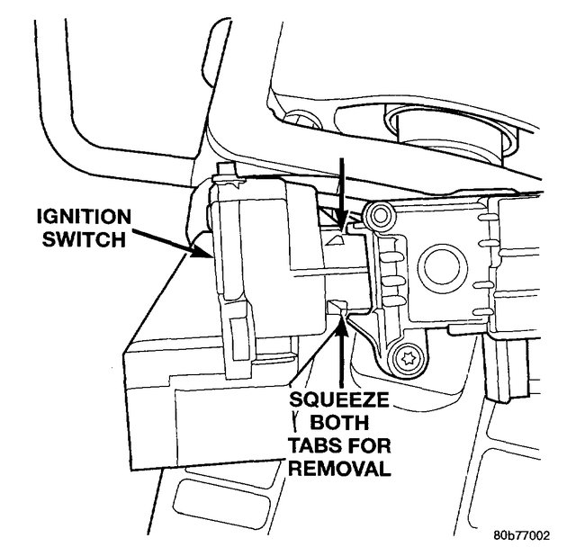

PROCEDURES
The ignition key must be in key lock cylinder for cylinder removal.
REMOVAL
If removing key lock cylinder only, refer to first 6 steps. If removing ignition switch only, refer to steps 1 and 2 and proceed to steps 7 through 13.
1. Disconnect negative cable from battery.
2. Place transmission shifter in PARK position.
3. Place tilt steering wheel in full up position.

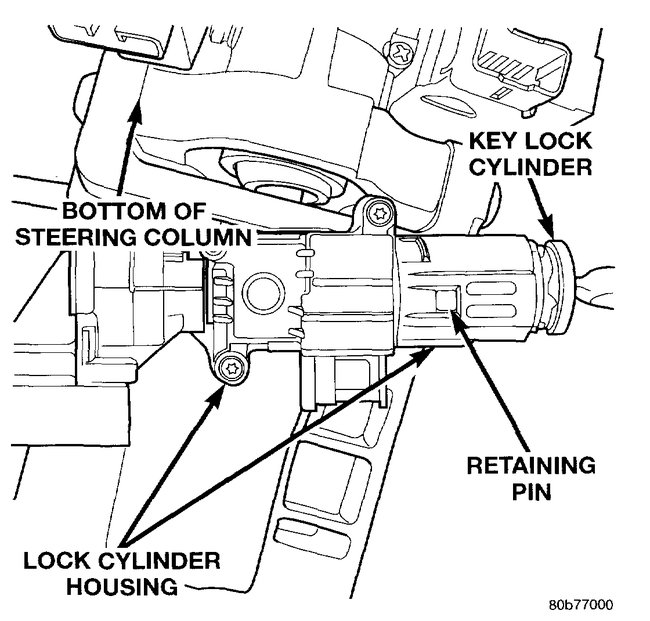

Retaining Pin
pic 1

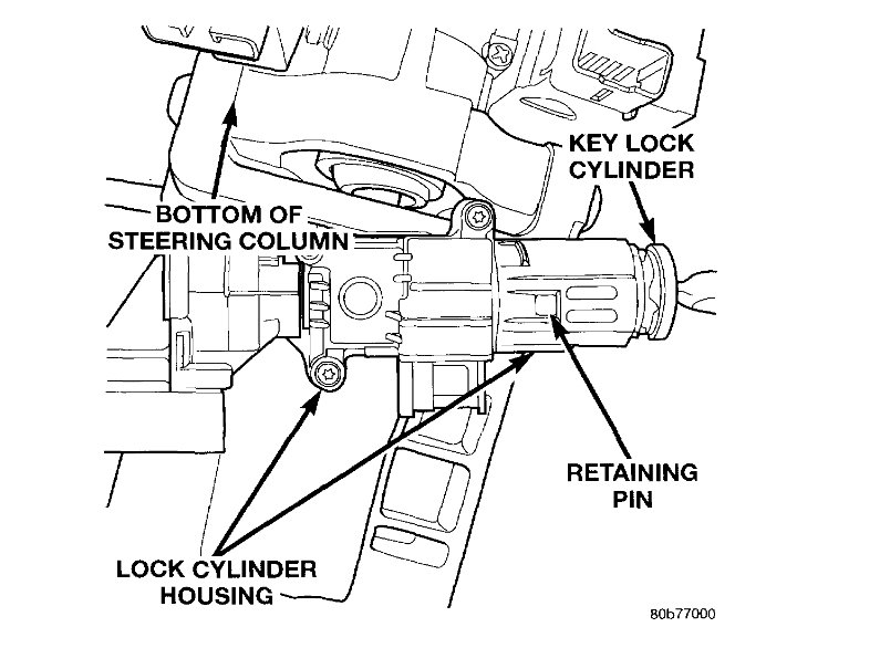

4. A retaining pin is located at bottom of key lock cylinder housing.
5. Rotate key to RUN position.
6. Press in on retaining pin while pulling key cylinder from housing. After removal, note position of alignment tang at end of cylinder. When installing lock cylinder, key must be rotated back to RUN position.

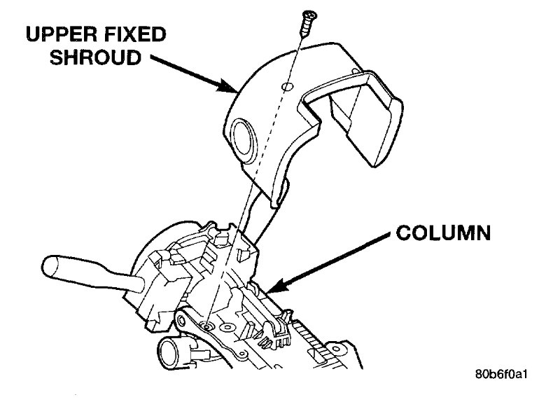

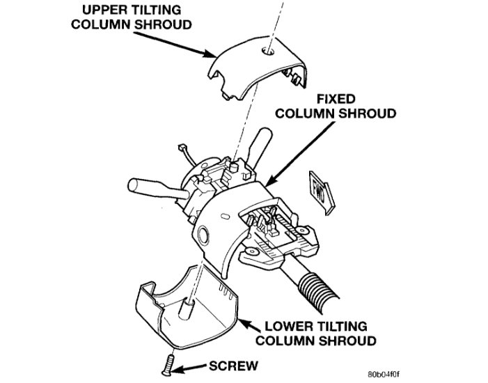

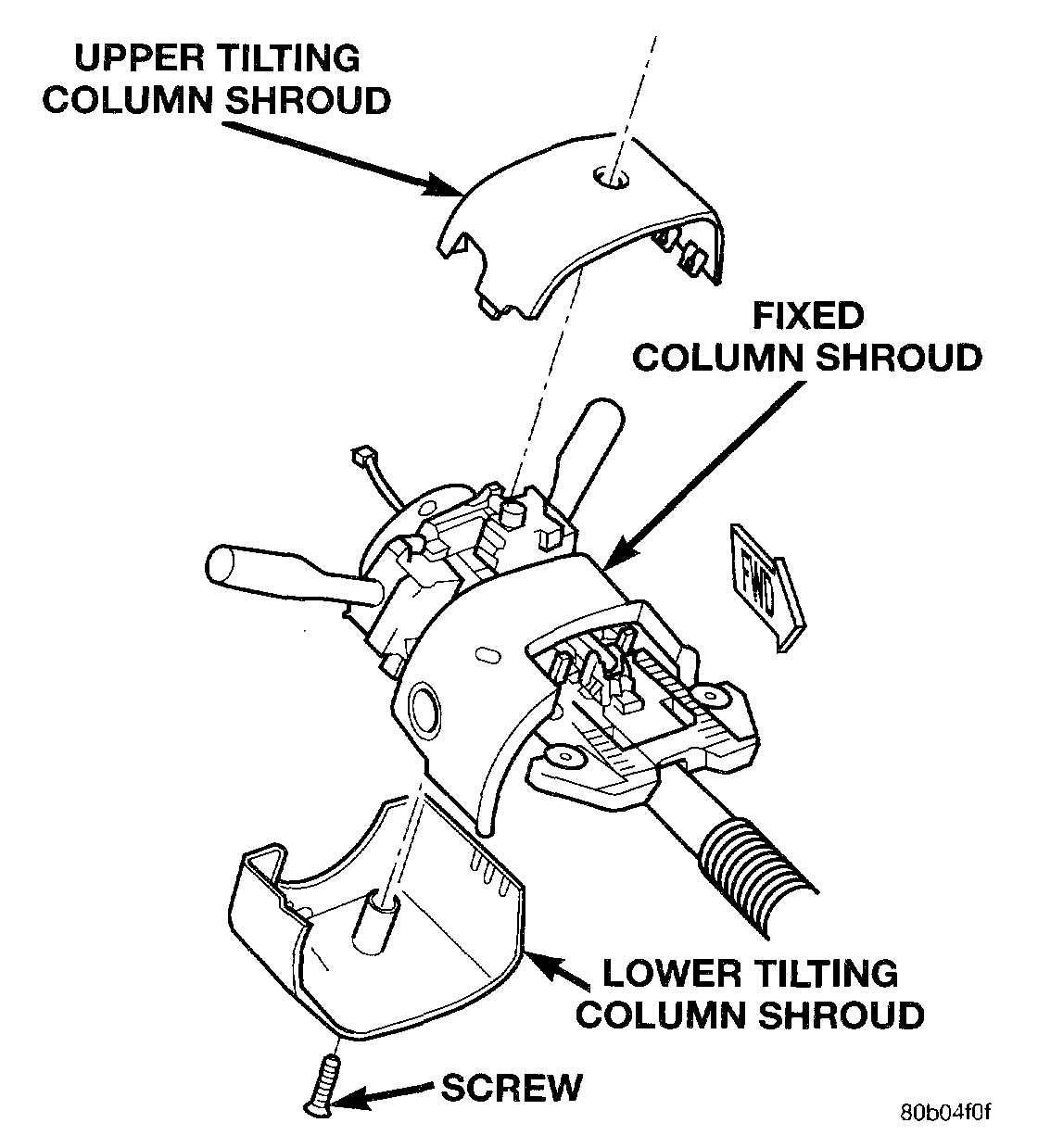

Shroud Removal/Installation
pic 2

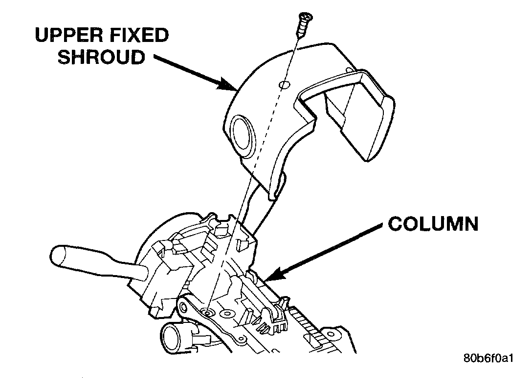

8. Remove upper and lower covers (shrouds) from steering column:
Fixed Column Shroud Removal/Installation
pic 3
9. Remove upper fixed column shroud (2 screws).

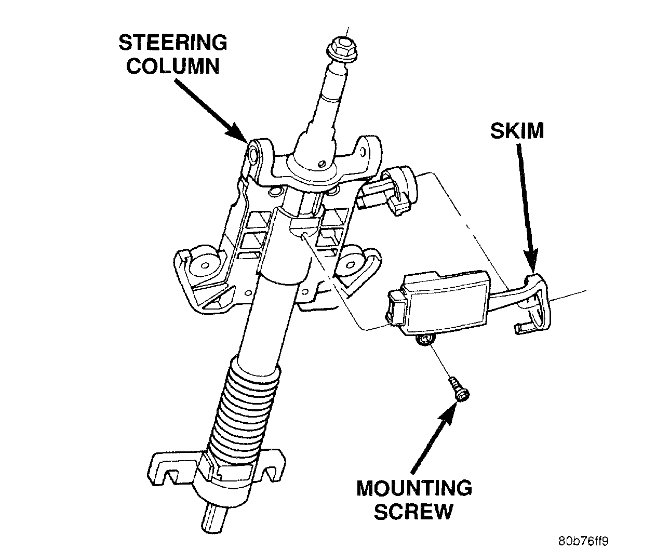

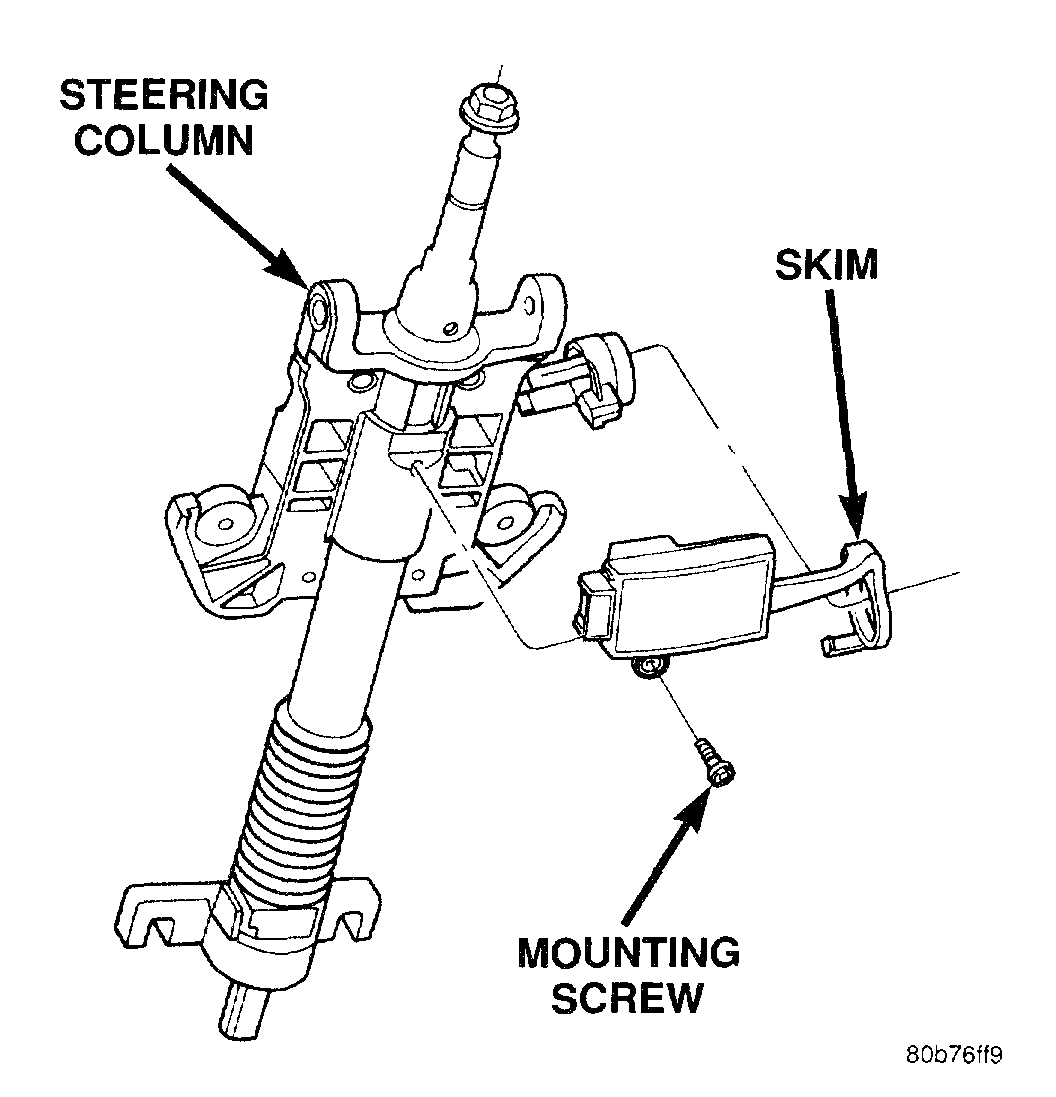

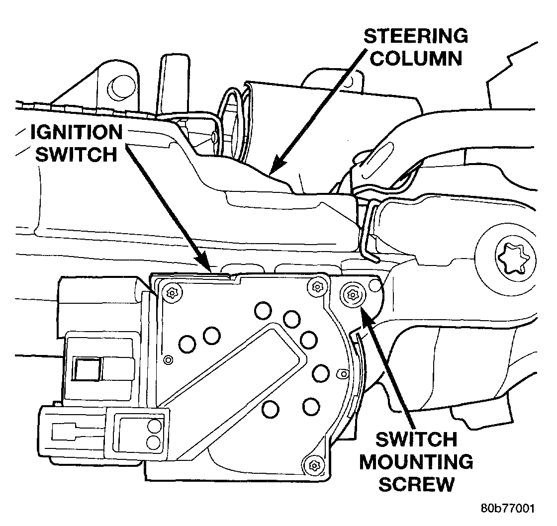

Smart Key Immobilizer Module And Mounting Screw
pic 4
10. Remove SKIM (Smart Key Immobilizer Module) (1 screw).
11. Disconnect electrical connectors at switch.

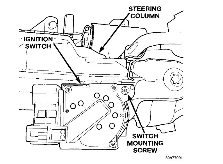

Ignition Switch Mounting Screw
pic 5
12. Remove ignition switch mounting screw. Use tamper proof torx bit (Snap-On TTXR10E or equivalent) to remove screw.

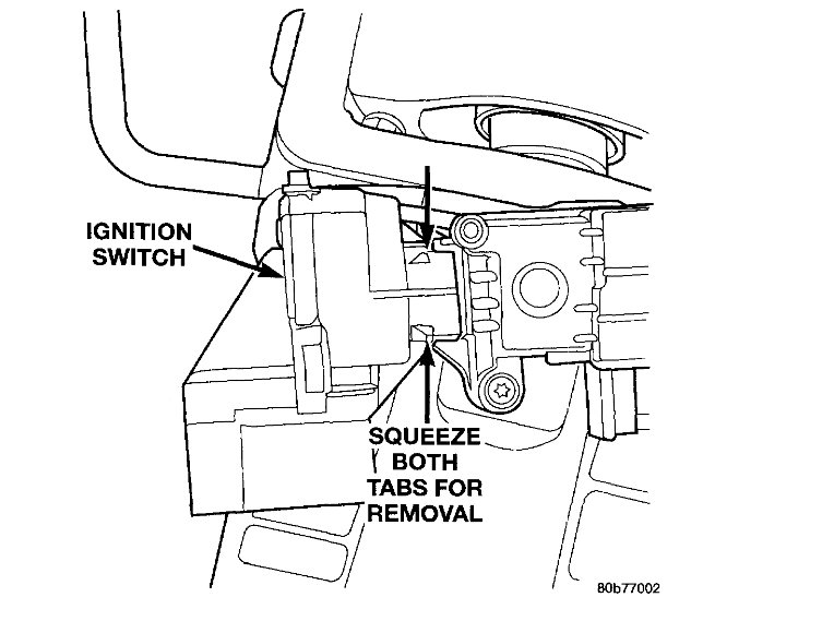

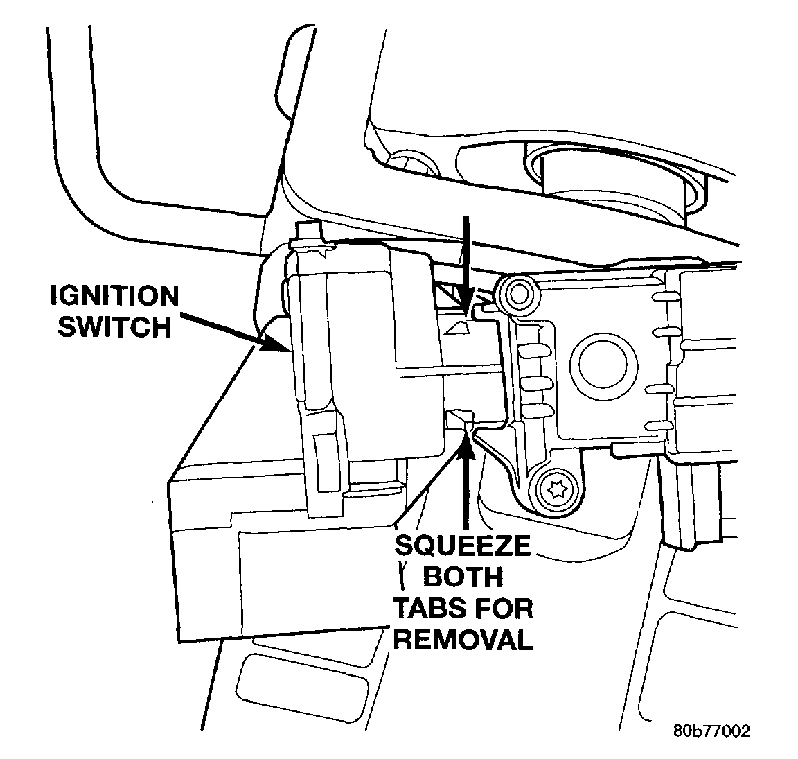

Ignition Switch Lock Tabs
pic 6
13. Using needle-nose pliers, squeeze both switch lock tabs and gently pull switch away from column. Do not rotate key lock cylinder when ignition switch is being removed or has been removed from steering column.

8. Install SKIM (Smart Key Immobilizer Module) (1 screw). Tighten screw to 3 Nm (30 in. lbs.) torque.

Retaining Pin
10. Remove SKIM (Sentry Key Immobilizer Module) (1 screw).

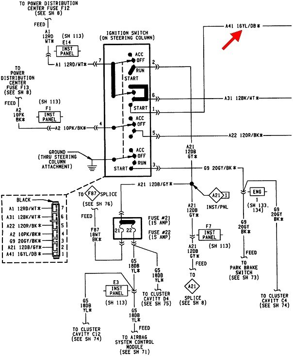

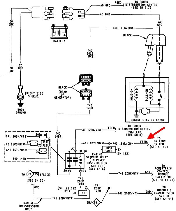

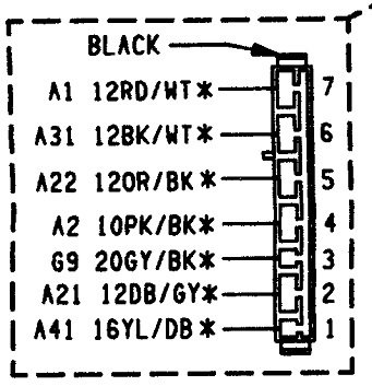

Dandy. This is going to involve the ignition switch. In the first diagram, the red arrow is pointing to the circuit where 12 volts is not showing up from the ignition switch. In the second diagram, the arrow is pointing to the terminal it comes from in that switch.
There's two things to look for. The first is you'll need to pop the lock cylinder out, then look at the end of it to see if it is broken. This applies to early '90s Caravans, including my '94 Grand Voyager daily driver, and some other models. There were actually three different designs of these lock cylinders, and Jeeps used the least common of the three, but since you replaced the ignition switch, the entire switch with its matching lock cylinder will bolt right onto all the other models. If you have the style that came originally in a minivan, look at the round disc on the end of the cylinder. It has a raised lip with a notch in it that matches a key inside the switch. The end of that lip cracks off resulting in the notch being too wide. When you rotate the cylinder with the key, it doesn't rotate the switch quite far enough to reach the "crank" position.
The second problem can be identified by looking at the terminals on the old switch. This shouldn't pertain to cranking, but it's not something we want to overlook. It is common to find two terminals that are black or discolored. If you see that, the mating terminals in the connector will also be discolored, and the connector body around them will be melted. The only proper repair for that is the switch must be replaced, and those two terminals must be cut out of the connector, then be replaced with a pair of universal crimp-type terminals. Four inches of wire must also be cut away because it will be hardened from the heat and solder won't adhere to it. Crimp the new terminals to the new pieces of wire, but solder them too for the best connection. Splice the wires to the original wires, then solder the joints and seal them with heat-shrink tubing. Never use electrical tape in a car as it will unravel into a gooey mess on a hot day.
Cut the connector body open to make enough room for the new terminals to fit in their holes. Plug the connector into the switch, then plug in each of the two new terminals individually.
You can also snip a connector off a vehicle in the salvage yard and remove two shiny terminals from it, along with the four inches if wire.
This ignition switch assembly has four separate switches built in. The terminal problem normally occurs on the terminals for the accessory circuit that includes the heater fan, power windows, and radio, especially when owners use the heater fan on the highest speed a lot, and when they're in the habit of turning the ignition switch on and off when leaving the heater fan set to a high speed. The arcing that takes place across those contacts in the ignition switch leads to the build-up of resistance which causes the heat to be generated. That heat migrates out to the terminals where it causes more resistance to develop that leads to additional heat build-up. When only the terminals or only the switch is replaced, the resistance in the other one is still there and will cause a repeat failure. Both the switch and the terminals must be replaced at the same time.
This wiring problem is less likely to occur to the starter circuit part of the switch because it is used very infrequently and for such a short period of time, however, once the ignition switch returns to the "run" position, the circuit that feeds this part now feeds other circuits that do continue drawing current. That's the A31 12BK/WT circuit that continues on the third diagram.
Check the connector terminals first, but my vote is for the disc on the end of the lock cylinder. If that is cracked, the Chrysler dealer's parts department has a repair kit for that. It involves cutting the disc off, sliding on the replacement, then you have to finish drilling a hole to accept the supplied roll pin. You could also just look for another lock cylinder in the salvage yard

Check for 12 volts on the red / white wire, (A1 12RD/WH), in the switch's connector. It should be there all the time. If it is missing, we'll have to work back to see where it is being lost. If you do have 12 volts there, but not on the yellow / dark blue in the "crank" position, there has to be a problem with the switch.

  • 13 POSTS
I turned the key on then jumped the two wires the car cranked and started. It was nice to hear it running. I tried to jiggle those wires around while holding the key in the crank position nothing happened. Going to get another switch.
Sep 2, 2020 at 5:17 AM (Merged)
CARADIODOC
  • 34,381 POSTS
This is not common, but it sure sounds like the switch is defective.
Once you get that replaced, the failure-to-run problem could very likely be due to idle speed is too low. This happens if the battery was disconnected for some other service. When that happens, it will run if you hold the accelerator pedal down 1/4".
The Engine Computer lost its memory and will relearn sensor personalities and fuel trim data as you drive, without you even noticing. "Minimum throttle", on the other hand, needs a very specific set of conditions for the computer to know your foot is off the accelerator pedal, then it takes a throttle position sensor reading and puts that in memory. From then on, any time it sees that voltage, it knows it has to be in control of idle speed.
To meet the conditions for minimum throttle to be relearned, drive at highway speed with the engine warmed up, then coast for at least seven seconds without touching the pedals.
PDEVOGEL5
  • 13 POSTS
The new switch worked but not the first time i cranked it the second time i turned the key a little harder now it starts every time.I really appreciate everything you did for me i would have never thought the new switch was bad and i learned some things for next time,hopefully that's not real soon. Thanks again
