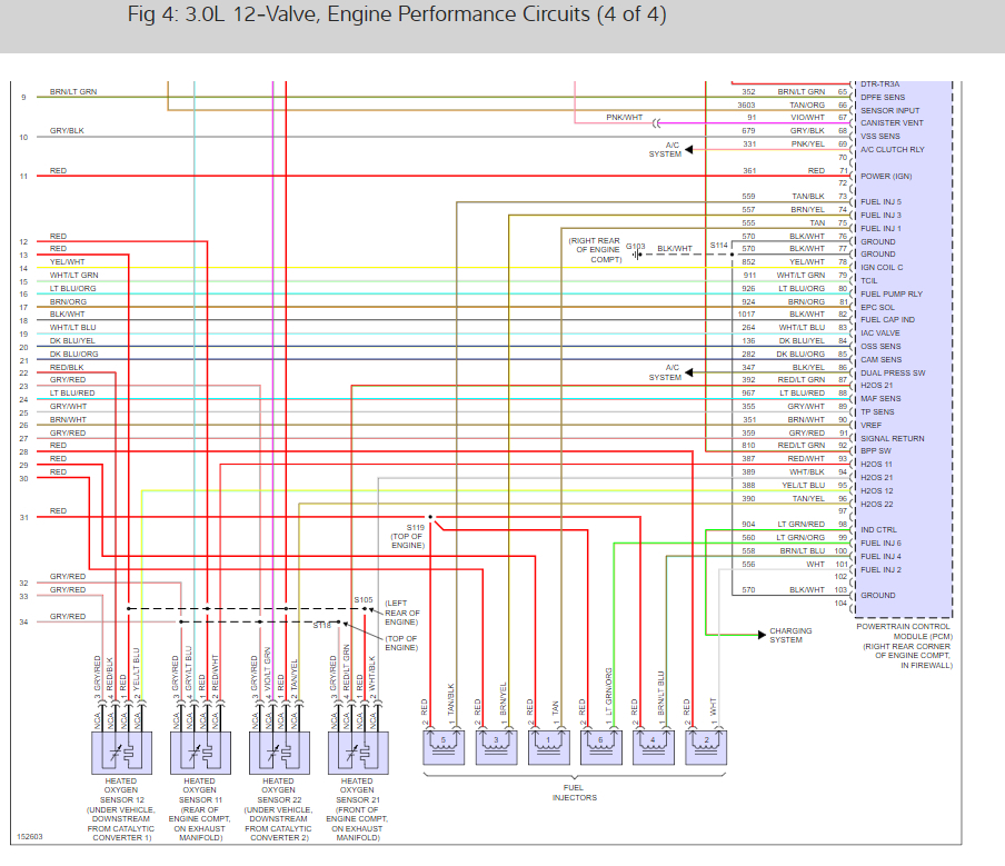

Car will not start. After replacing CKP, ignition coils, plugs, wires, new battery. I have also have no spark.

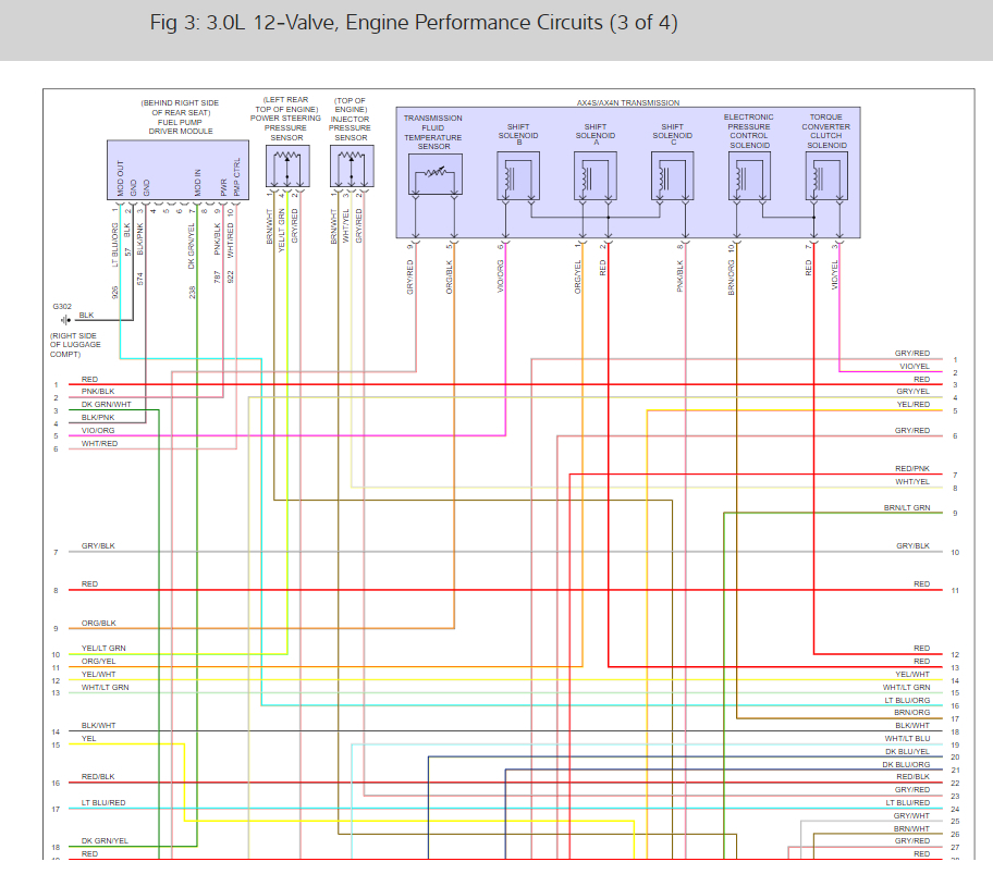

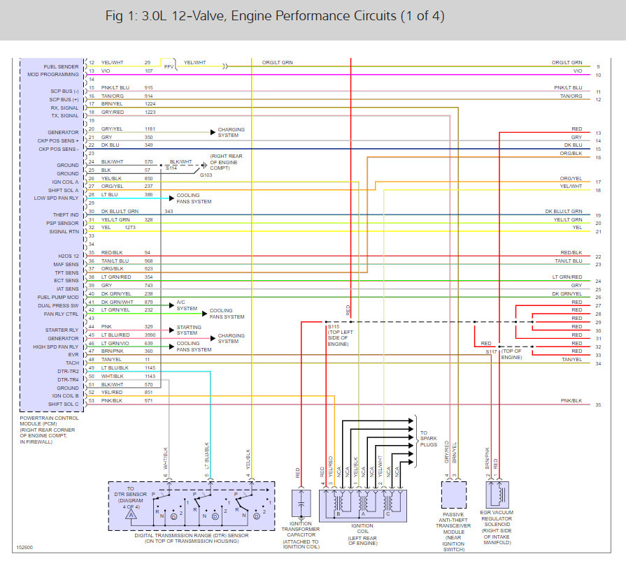

In 2002 this vehicle did not have a separate ignition control module. Instead, it was controlled by the power control module (PCM). The following information is direct from Alldata regarding the ignition system:
Integrated Electronic Ignition System
The Integrated Electronic Ignition (EI) system consists of a crankshaft position (CKP) sensor, coil pack(s), connecting wiring, and PCM. The Coil On Plug (COP) Integrated EI System uses a separate coil per spark plug and each coil is mounted directly onto the plug. The COP Integrated EI System eliminates the need for spark plug wires but does require input from the camshaft position (CMP) sensor. Operation of the components are as follows...
With that in mind, can you tell me if you have checked for trouble codes? Here is a link that shows how it is done. If there are codes saved, it may be very helpful in helping you narrow this problem down.

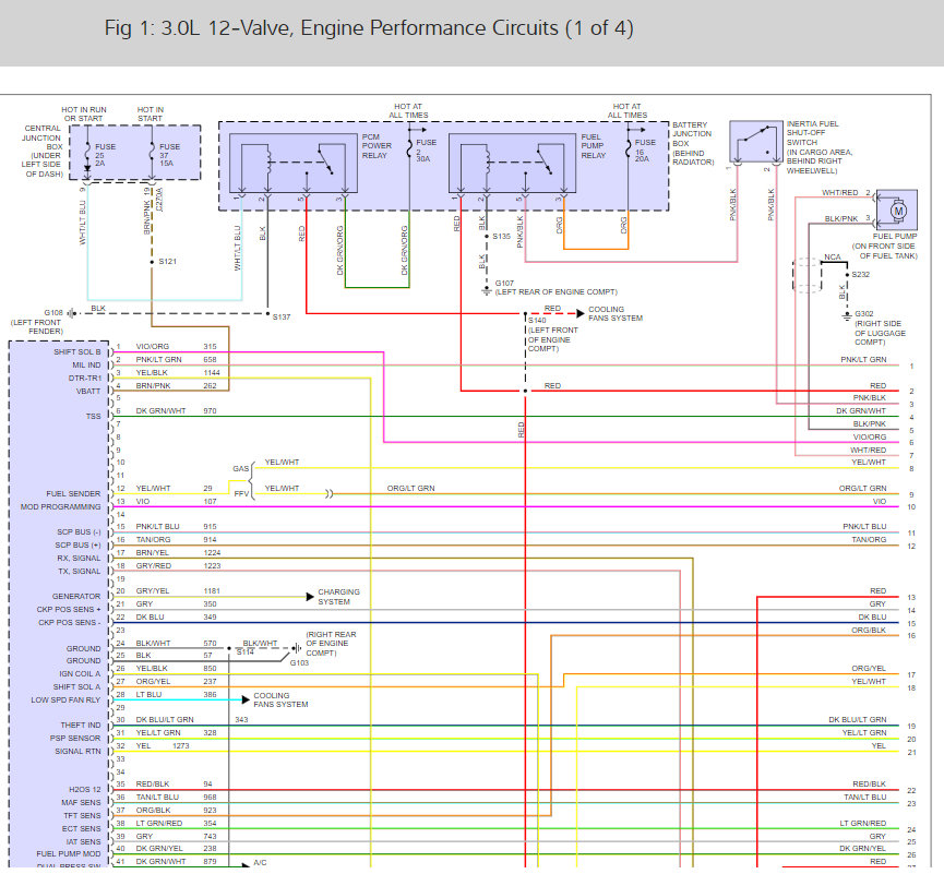

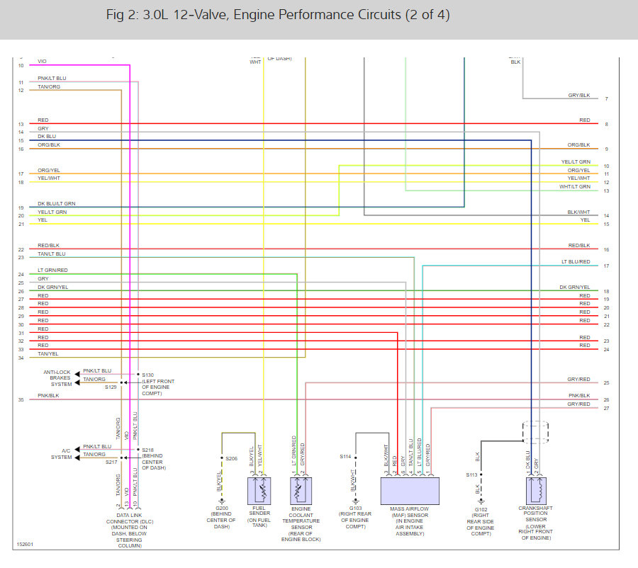

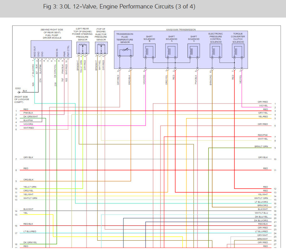

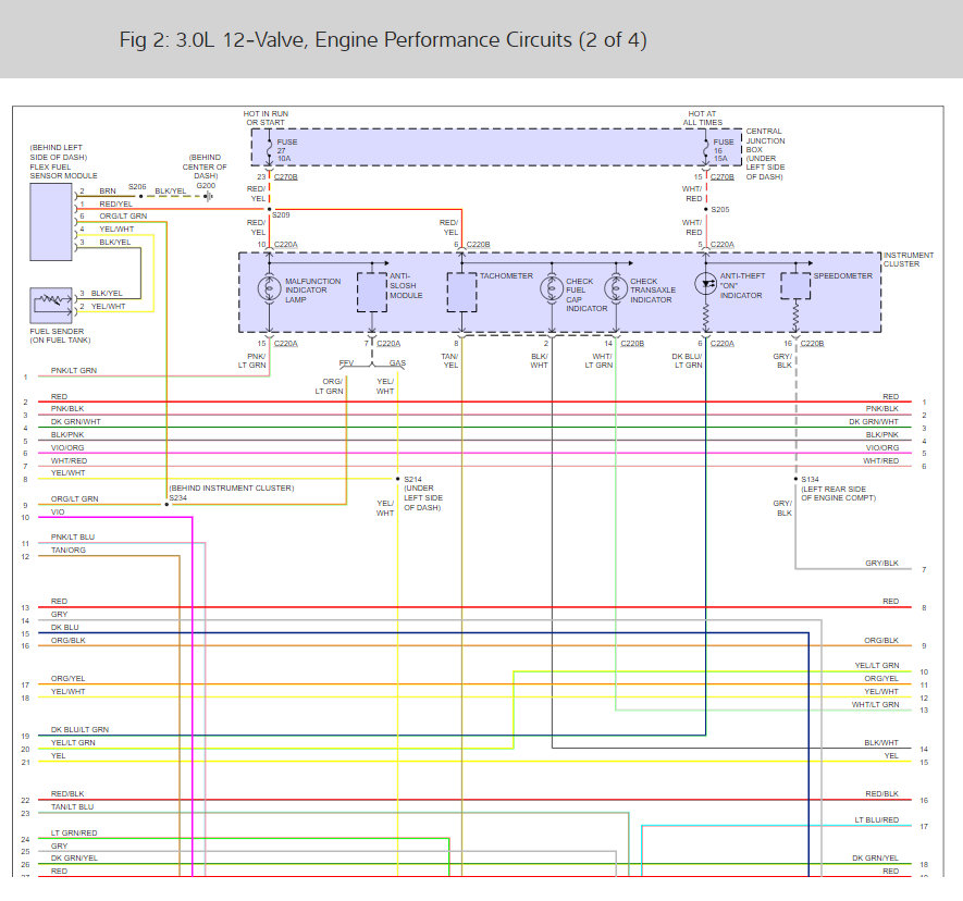

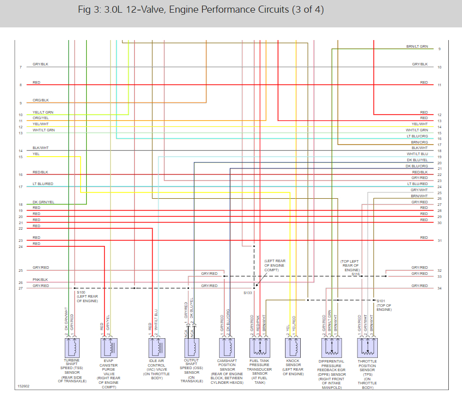

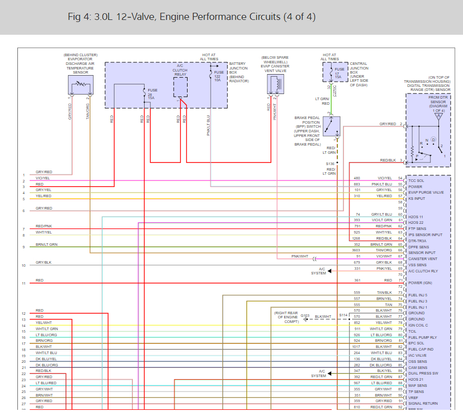

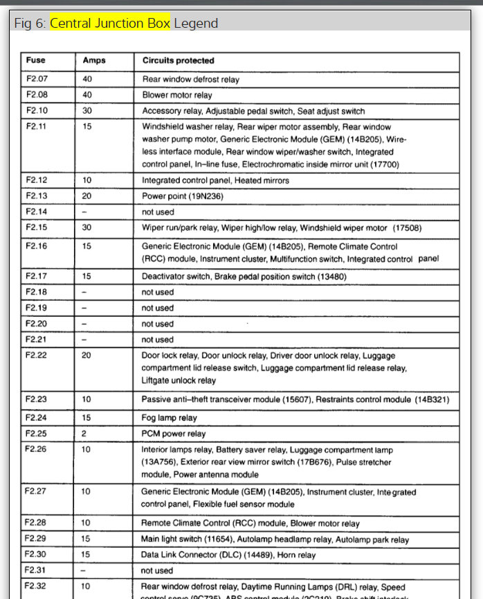

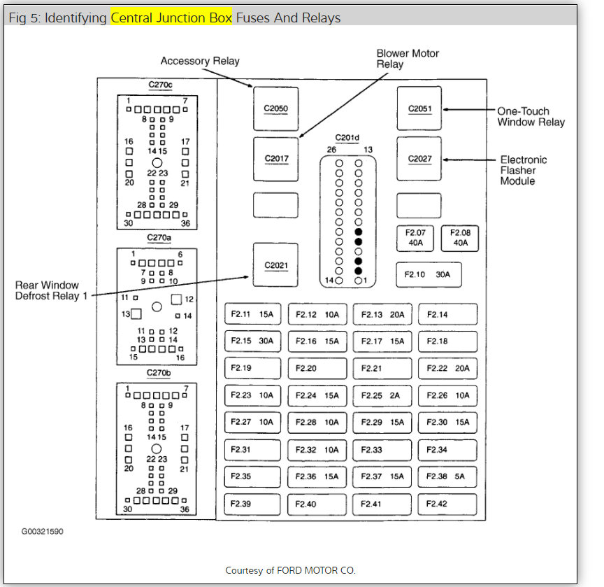

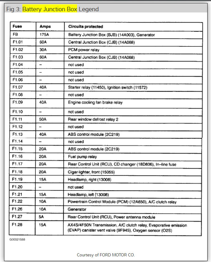

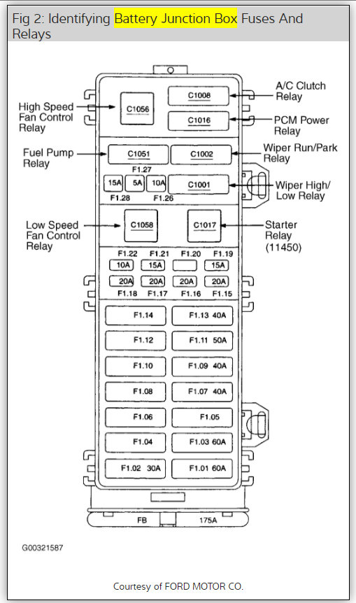

Your car does not have an ignition module it is interrogated into the PCM. Here are the engine wiring diagrams so you can see for yourself below. Have you checked the PCM relay?
Here is a guide and the location:
Aug 16, 2018 at 12:13 PM

You may want to check the relay for the ECM as that may be causing your problem.

Did you check the PCM power relay? It sounds like this can be the issue. Check out the posts above and report back please. Ken
