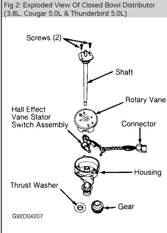

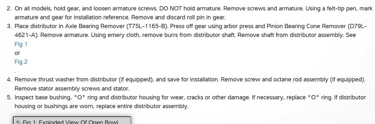

Need to know how to take off the metal plate which is just above the pickups on the distributor.

the distributor has to be removed from engine then gear removed to pull up shaft to remove it. see pictures.

Thank you so very much. I just needed the most simple form of an answer.
