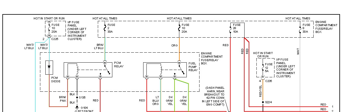

I just put in head gaskets in my merc and I dont have any spark now could the mega fuse cause this and if not what step should I take to find the problem. What would cause no spark I have everything where it suppose to go so I feel I need gods help but I am no saint so please help. I spent everything on this head gasket and tools and parts I am running out of money and my mind.
Tuesday, April 2nd, 2019 AT 11:20 AM (Merged)
HMAC300
  • 48,601 POSTS
If the mega fuse was bad the car wouldn't turnover. Recheck for disconnected sensors etc. Then check fuses and relays in pic
