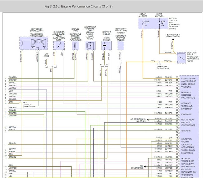

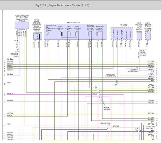

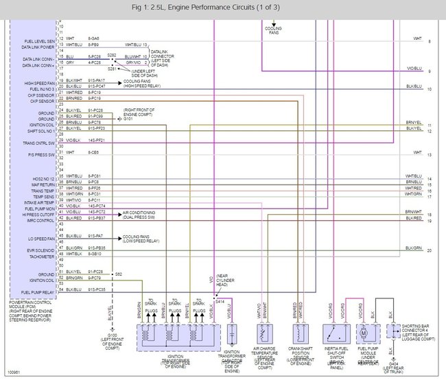

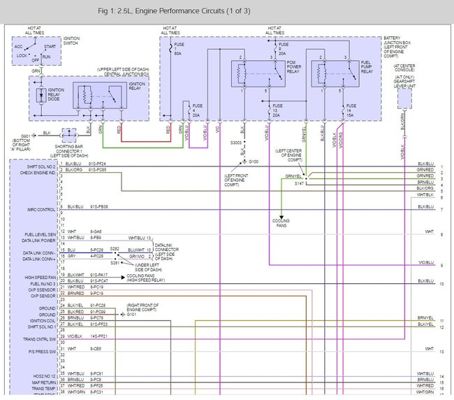

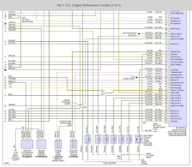

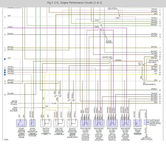

Where is the ignition control module located
May 2, 2016 at 11:03 AM
  • 55,433 POSTS
there is a ignition control relay and a crankshaft angle sensor but the amplification of the ignition signal is done by the ECM here are the ignition wiring diagrams as you can look for yourself.
Please let me know if you need anything else to get the problem fixed.
Best, Ken

no, the spark is controlled by the crank sensor, pcm and coil.

PCM
powertrain control module
behind power steering reservoir
ignition control module is a part of the PCM
pcm responsible for firing the coil
