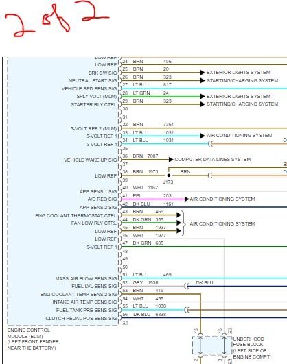

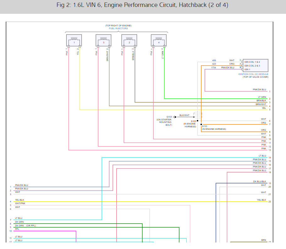

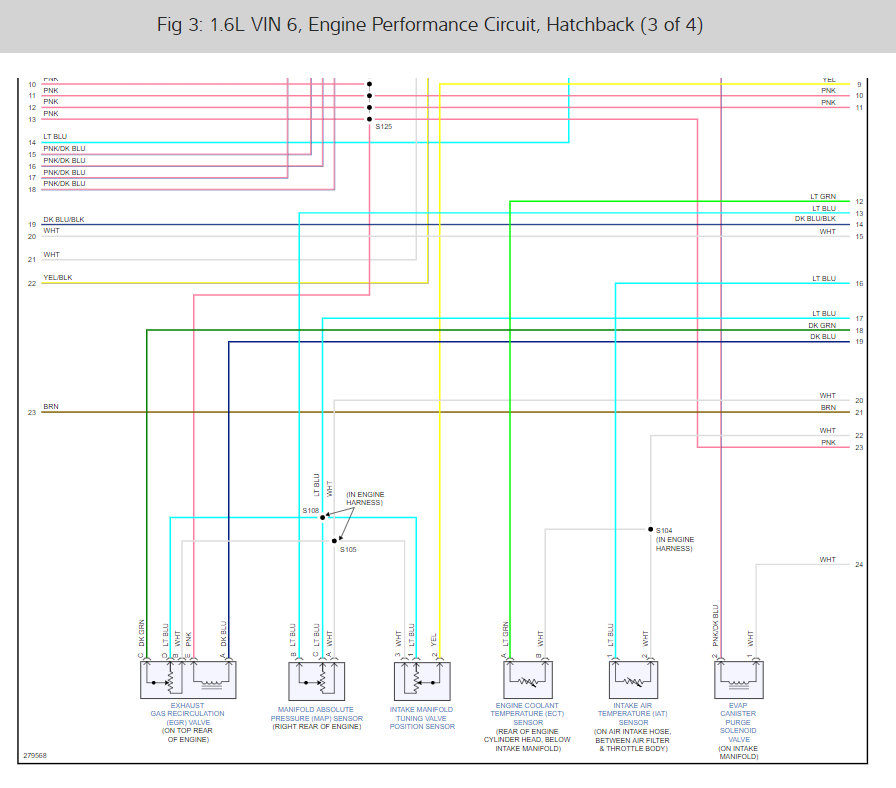

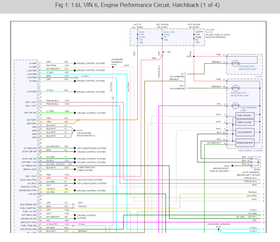

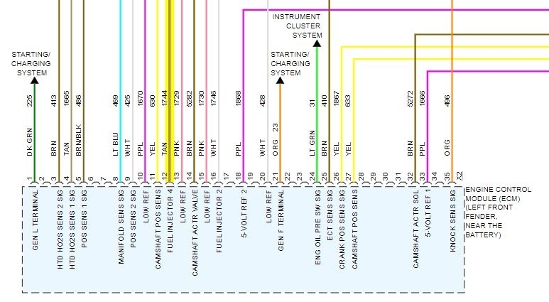

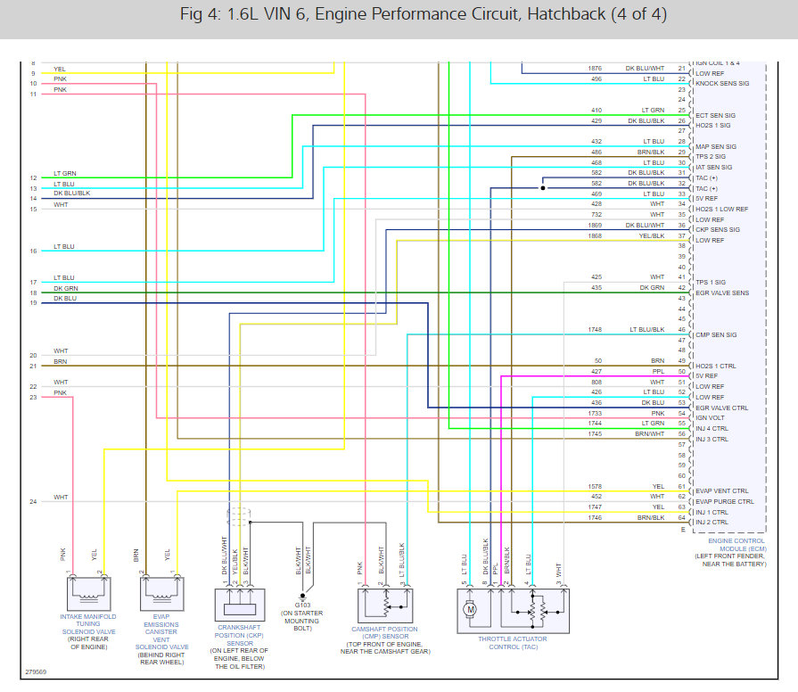

Hi! I am seeking a wiring diagram. An ECU pinout, or ecu wiring schematic for the 2008 Chevy Aveo LS sedan, Manual transmission. I have called dealers, who told me to call GM, who told me to call a dealer, who told me they can't give out wiring schematics. So, I've been getting the runaround. All I need is a pdf or jpeg of the ecu wiring. Can ya'll please help? I appreciate the time and any information.
Wednesday, October 14th, 2020 AT 2:47 PM (Merged)
SATURNTECH9
  • 30,869 POSTS
Here is the wiring diagrams for the engine ECU and a guide to help you check the connections.

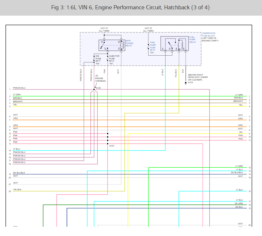

If there's a electrical wiring diagram for my car this would be greatly appreciated.
  • 109,700 POSTS
Welcome back:
Honestly, there are so many different variations based on specific components. There isn't one that covers the entire vehicle. I would be sending hundreds.

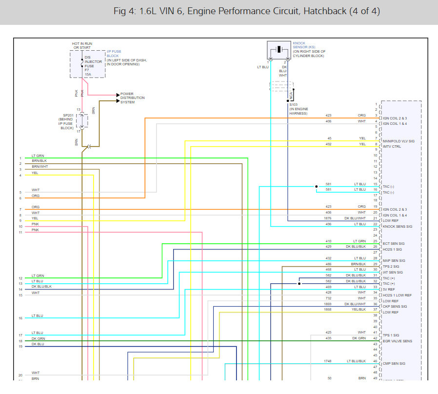

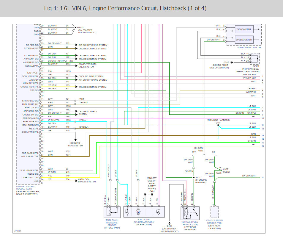

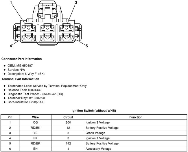

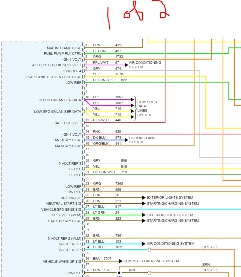

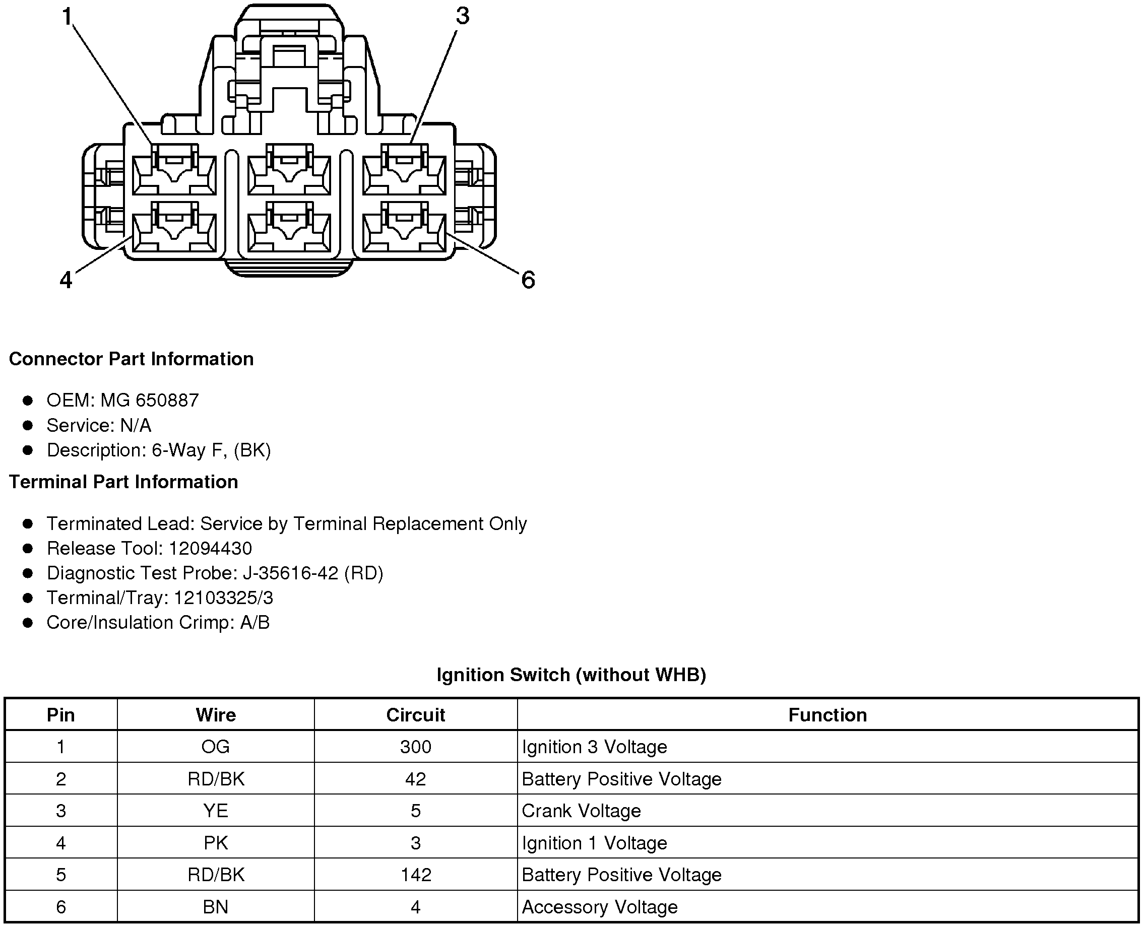

Ecm, and ignition switch wiring under dash board?
  • 109,700 POSTS
Let me know if this helps. There are multiple pics. The last 2 are the ignition pins. Note, one is for with and one without WHB. The last one is without (pic 6). Basically "with WHB" requires a CANdi interface module for the Tech 2 to communicate with. Nothing more than an industry protocol change in OBD2 interface which requires the module to work.
I hope this is helpful.
