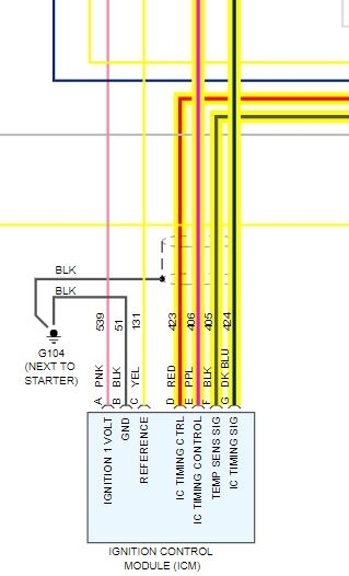

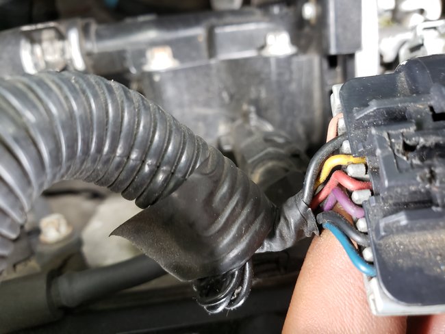

Sorry for misinformation. Here's a pick of what I'm trying to test whether that is voltage or ohm's. I believe the harness my have a short in it. I tested a few terminals on the harness with ohms only, 1. Ignition turned to on position a couple terminals read black wire read 0.44, purple wire read 0.45.
Oct 14, 2020 at 2:47 PM
  • 110,194 POSTS
Welcome back:

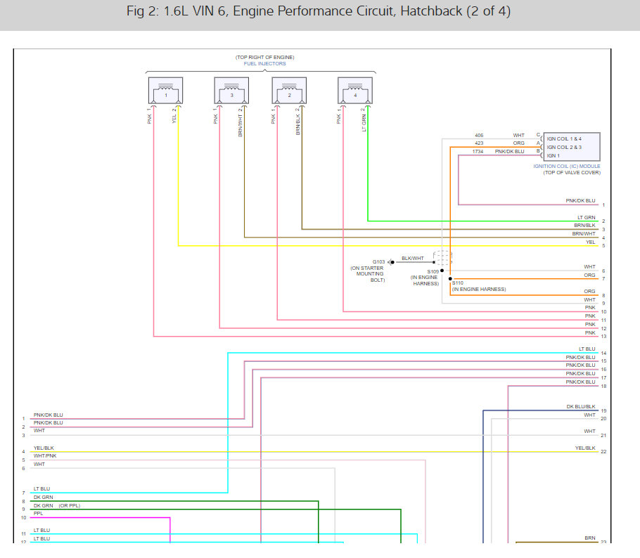

First, I attached a picture of where all the wires go from that connector. Next, are any of these codes active?

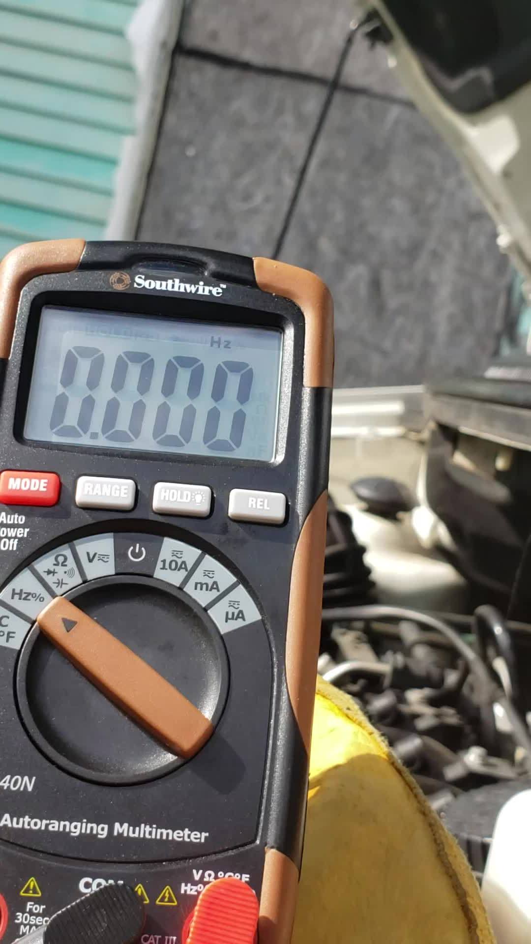

Here are the directions for testing at the plug:
Note: Set the DMM to the DC Hertz scale for this test. DMM = Digital Multi Meter
5. Connect a DMM between the appropriate ignition control circuit listed below and ground.
* Ignition coil 1 control terminal D
* Ignition coil 2 control terminal E
* Ignition coil 3 control terminal F
* Ignition coil 4 control terminal G
6. Engine cranking, test for greater than 1.5 hertz between the appropriate ignition control circuit and ground.
If less than the specified range, test the ignition control circuit for a short to voltage, short to ground, or an open/high resistance. If the circuit tests normal, replace the ECM.
7. If all circuits test normal, test or replace the ignition coil.

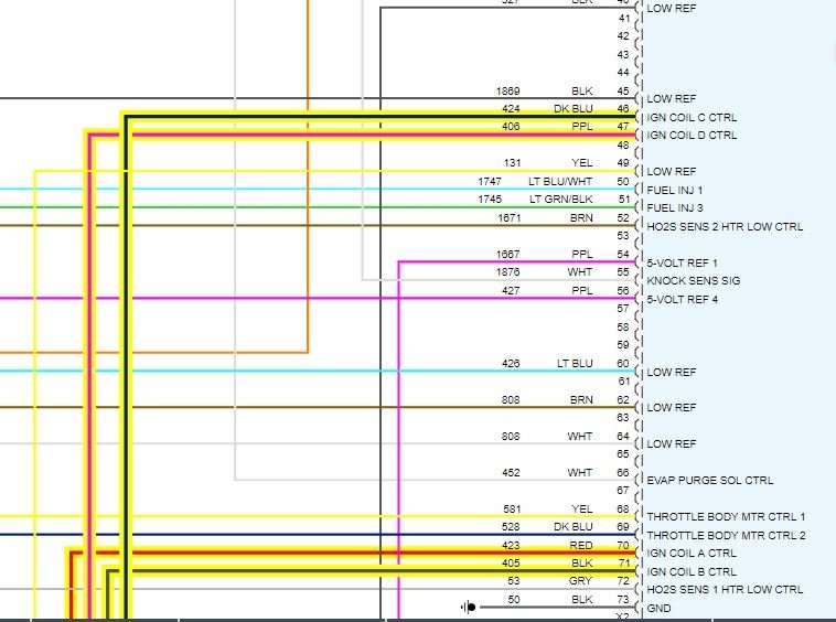

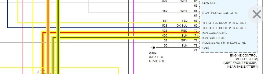

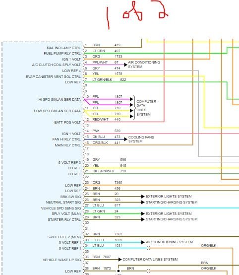

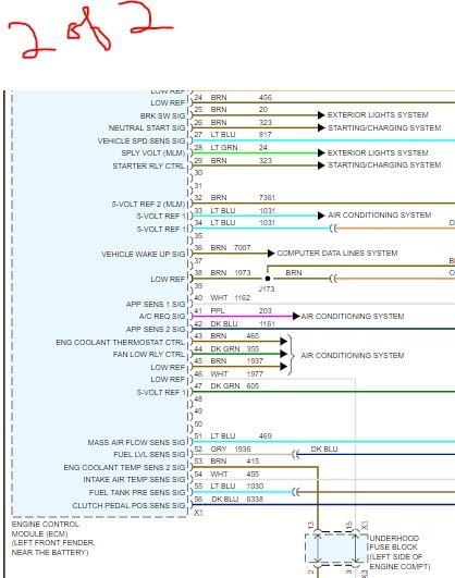

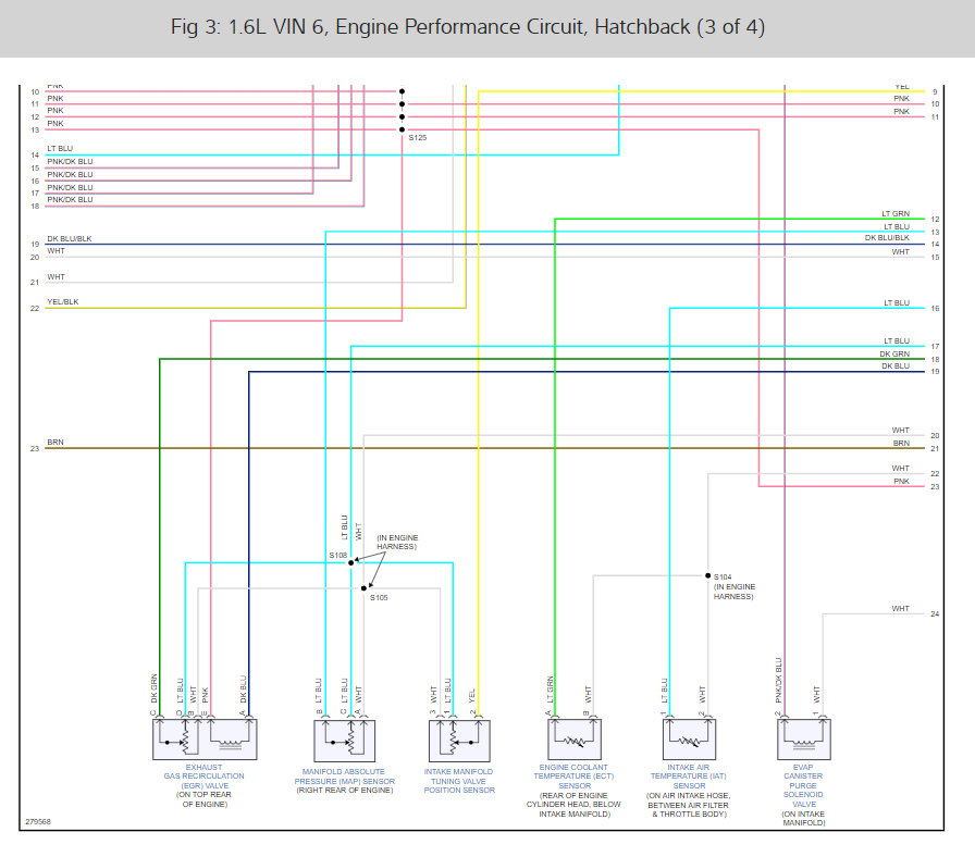

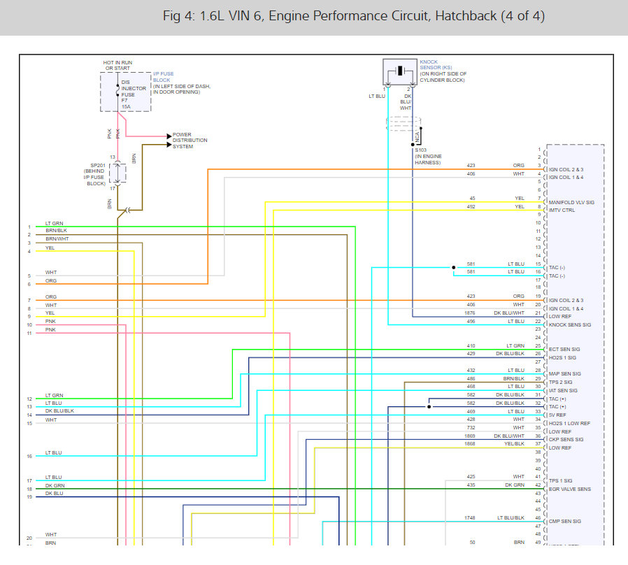

What specifically is going on with the vehicle? Also, I have no idea why the pics didn't attach. I'm going to try again. Let me know if you get them. I highlighted the wires between the ignition control module and the engine control module.

Thank you. it's a misfire fire. I have new spark plugs and coil pack, compression, good new fuel pump as well. I'm checking for short to coil pack as well as coil pack for defect.
  • 110,194 POSTS
Happy to help. Make sure to check the rubber boot that goes over the plug for arcing. Also, if there is any oil laying around the plug, see if removing it gets rid of the issue.

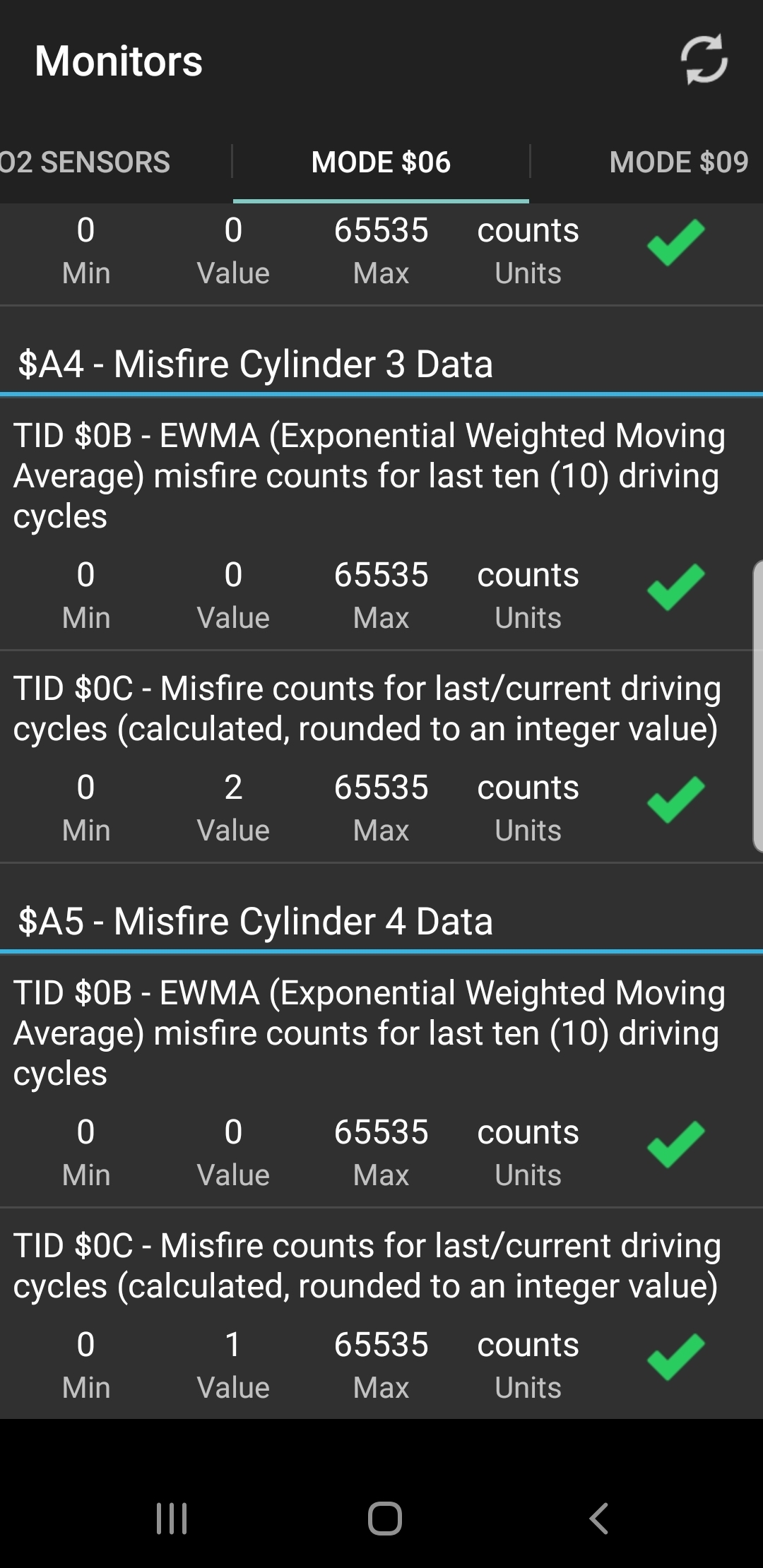

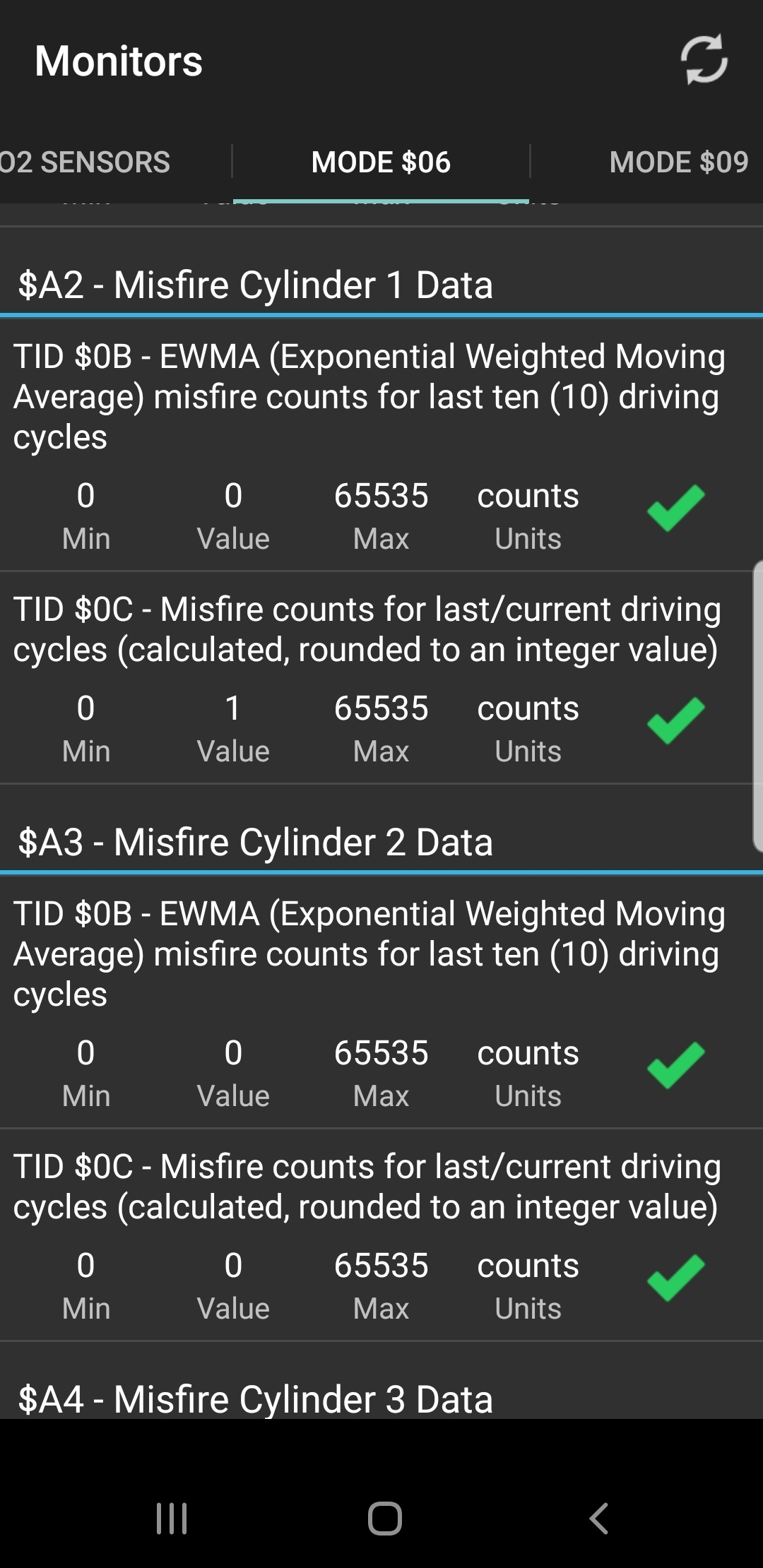

Joe the first test cracking was for Terminal G. Second crank test was for terminal F. Third crank test was for terminal E. Fourth crank test was for terminal D. All test was done with a probe on ground B and a probe on each terminal mention above. Also I attached a few pics of misfires with the crank test in mind, not a lot of misfires is present due to disconnecting ignition coil harness. Lastly air to fuel ratio reads 1.7.1 I'm not running rich no black Sut from tale pipe. If you conclude my readings are not normal. I will have a conclusion to misfire and air to fuel
ratio.

Misfire pictures.
  • 110,194 POSTS
The readings look okay. What is the knocking?
BOBBYPUE DOPEHI
  • 40 POSTS
This is because I disconnected the harness from the coil pack, so There's no spark going to coil pack, it does not knock when harness is connected to coil pack.
BOBBYPUE DOPEHI
  • 40 POSTS
Car has no leaks all gaskets replaced, valve cover gaskets and manifold. it's a very quite car at idle even when not in idle but misfires is felt and seen on obd.

Test was not preformed with positive probe on each ignition coil terminals and negative probe on ground wire on harness. Test was preformed on harness only.

Joe was this test preformed correctly. I put the DMM probe negative on the black ground wire attached to harness. Then I put the DMM positive probe, on dark blue wire on the harness. Then the car was cranked and the same steps preformed for the, black, purple, and red wire on harness?
  • 110,194 POSTS
Yes, that is correct. You want to use the ground provided. Interesting... is the check engine light even coming on?

The codes are related to the IP and air bag. There are multiple wires from the ECM and Ignition. Also, I can upload schematics, but there are a ton of them, so I need to narrow it down. Also, there are different schematics based on US and Mexico, so let me know what I can do to help.

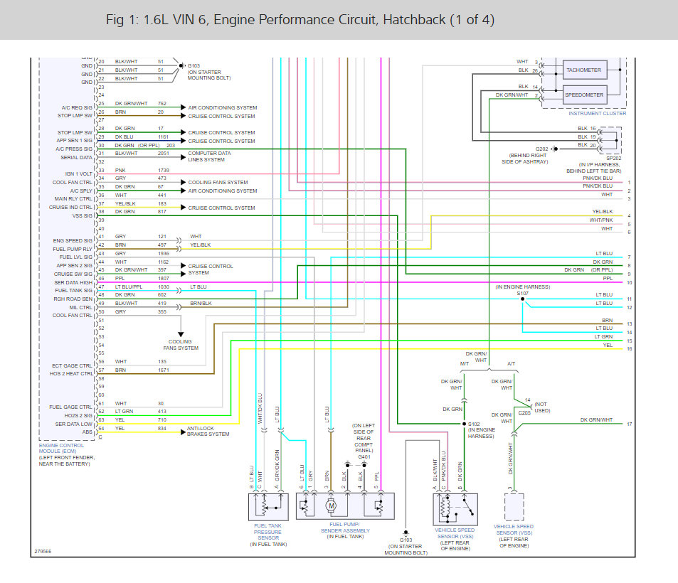

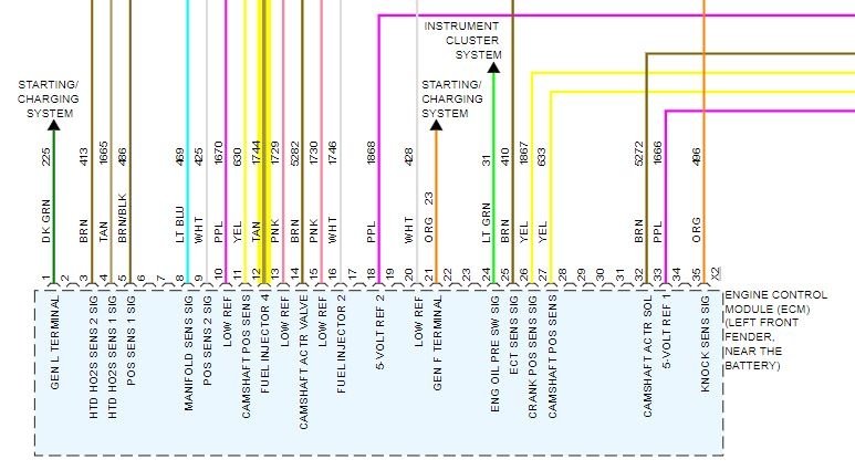

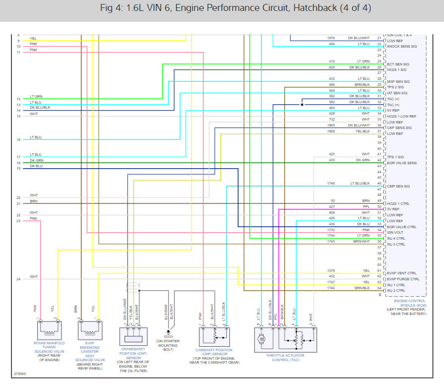

Hi! I am seeking a wiring diagram... an ECU pinout, or ecu wiring schematic for the 2008 Chevy Aveo LS sedan, Manual transmission. I have called dealers, who told me to call GM, who told me to call a dealer, who told me they can't give out wiring schematics. So, I've been getting the runaround... all I need is a pdf or jpeg of the ecu wiring. Can ya'll please help? I appreciate the time and any information.
Oct 14, 2020 at 2:47 PM (Merged)
SATURNTECH9
  • 30,869 POSTS
Here is the wiring diagrams for the engine ECU and a guide to help you check the connections.

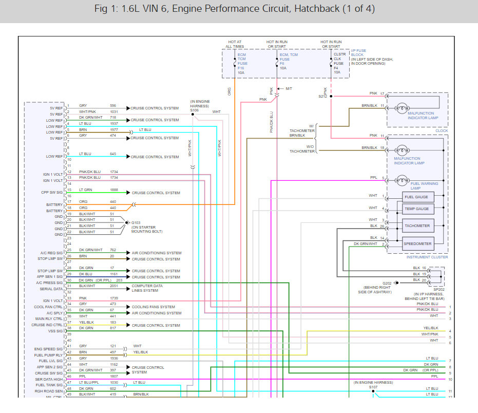

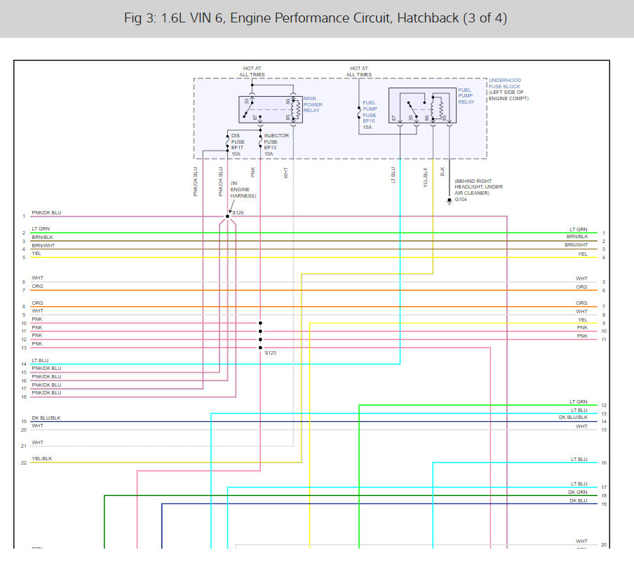

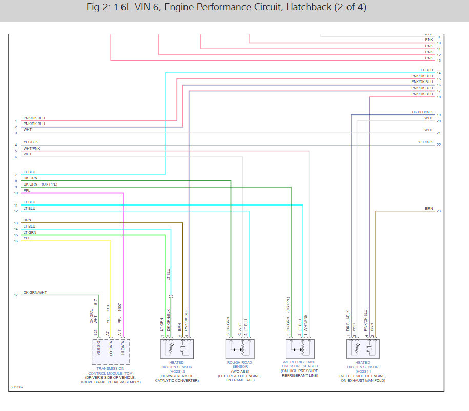

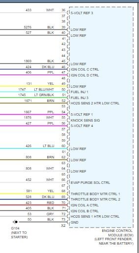

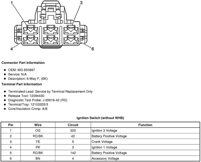

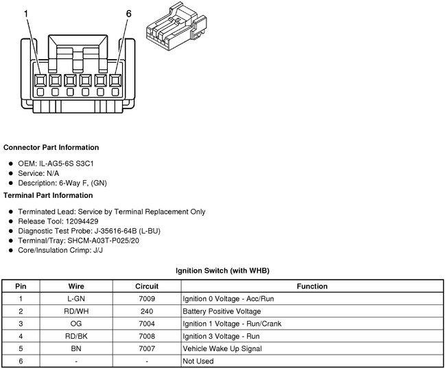

Ecm, and ignition switch wiring under dash board?
  • 110,194 POSTS
Let me know if this helps. There are multiple pics. The last 2 are the ignition pins. Note, one is for with and one without WHB. the last one is without (pic 6). Basically "with WHB" requires a CANdi interface module for the Tech 2 to communicate with. Nothing more than an industry protocol change in OBD2 interface which requires the module to work.
I hope this is helpful.
