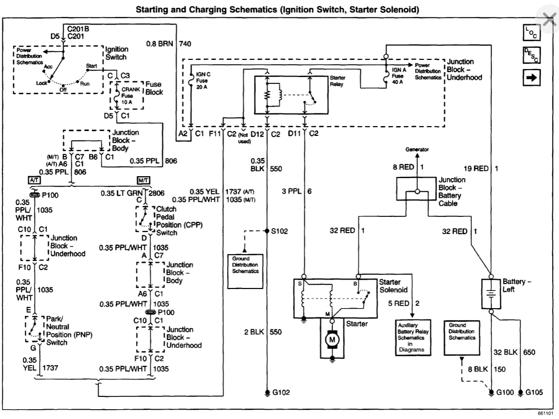

Start will not disengage
2001 CHEVROLET SILVERADO
250,000 MILES • 4.8L • V8 • 2WD • MANUAL
JENNDIXON
The starter is staying engaged.
Jan 3, 2022 at 2:48 AM
SQM
  • 6,383 POSTS
The starter can stay engaged due to a faulty ignition switch or a bad solenoid. It can also happen due to bad wiring or a short that is providing continuous power to the starter.
Keep in mind that if the starter is not aligned properly, it can also stay engaged and just spin without tuning the engine.
Check the ignition switch. Make sure that the power does not stay on after the ignition key is released. If there is power, it will keep the starter to stay engaged.
To make sure it is not the solenoid, check the power on the posts on the solenoid by testing the wire coming from the ignition switch. Use a voltmeter, it should indicate zero. If there is power, then it could be due to a bad switch, or the cable may have a short.
I have attached the starting system wiring schematics below.
Jan 3, 2022 at 4:52 AM
