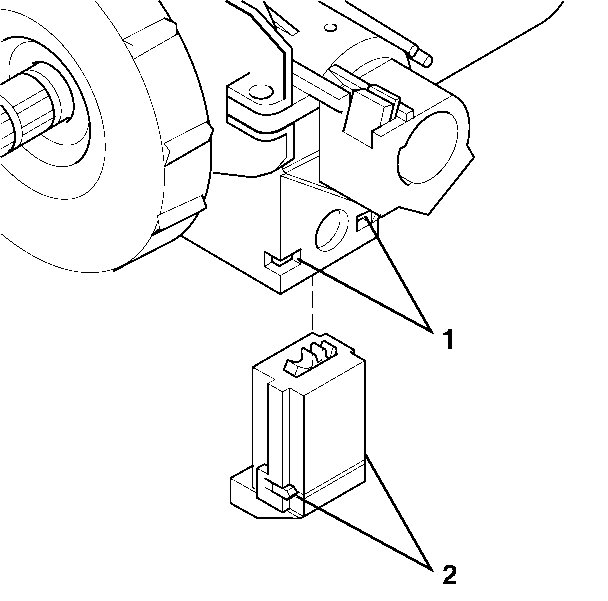

I have no problem putting the key in or taking it out but it turns just like it is stripped. It does not go through auxiliary, run or start. It does not start the vehicle and when I turn the key back as if to shut it off, the radio still runs and the battery light is on. I think that it is right where the key goes in but am not sure. Any ideas?

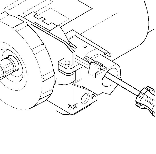

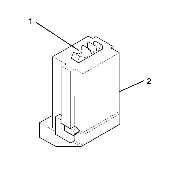

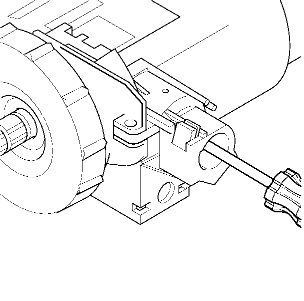

It sounds like either the ignition switch or the lock cylinder is bad. You will need to take the components apart to inspect for damage. I have attached directions for both switch replacement and lock cylinder replacement. The first directions start with the switch. The first eight pictures correlate with these directions.

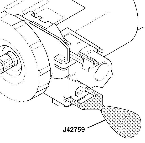

- J 42759 Ignition Switch Connector Release Tool

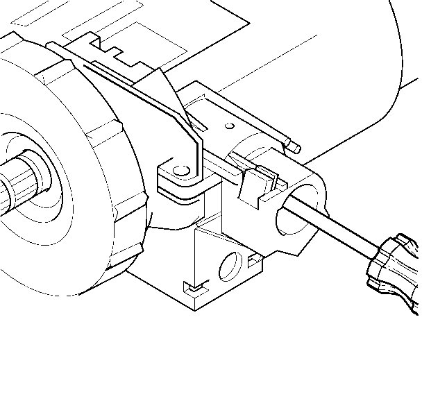

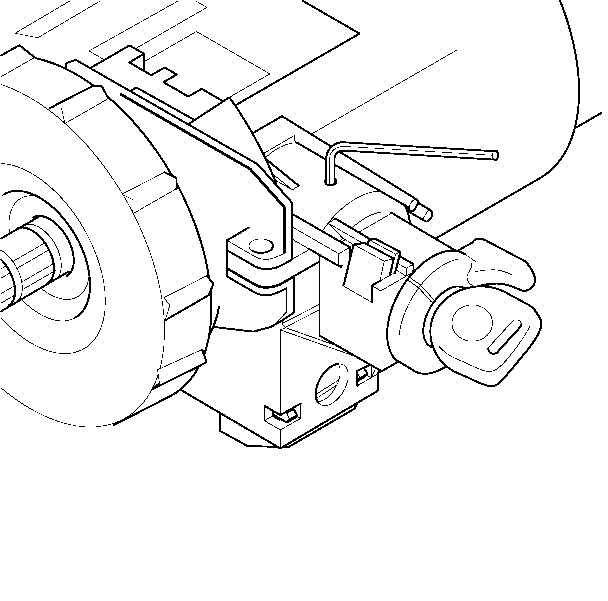

5. With the key installed, turn the key to the RUN position.
6. Install an allen wrench into the hole on top of the lock cylinder housing.
7. Push down on the allen wrench to release the tab on the lock cylinder inside the lock cylinder housing.

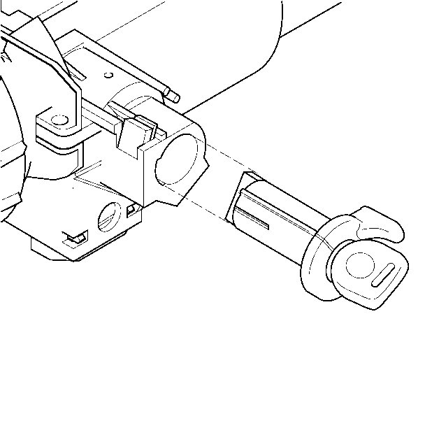

8. Slide the lock cylinder out of the lock cylinder housing.
9. Disconnect the passlock and key buzzer from the lock cylinder housing.
10. Insert J 42759 into the lock cylinder housing to release the tabs on the ignition switch.
11. Pull the ignition switch out of the lock cylinder housing.
12. Disconnect the connector from the ignition switch.

1. Important: The gears between the ignition switch and the lock cylinder housing must be in the correct position. Failure to do so will cause a misalignment of the gears in the ignition switch and the lock cylinder housing, which may result in a NO START or BATTERY DRAIN.
Verify the alignment of the gear (1) in the ignition switch (2). If gear (1) is not in position shown, turn gear in ignition switch (2) until you reach the correct position.
2. Use a screwdriver to rotate the lock cylinder housing gear counterclockwise until it hits a stop.
3. Connect the connector to the ignition switch.
4. Insert the ignition switch into the lock cylinder housing. The tabs (2) on the ignition switch MUST be seated inside the lock cylinder housing (1) for proper installation.
5. Use a screwdriver to rotate the lock cylinder housing gear clockwise to the START position, allowing it to spring return into the RUN position.

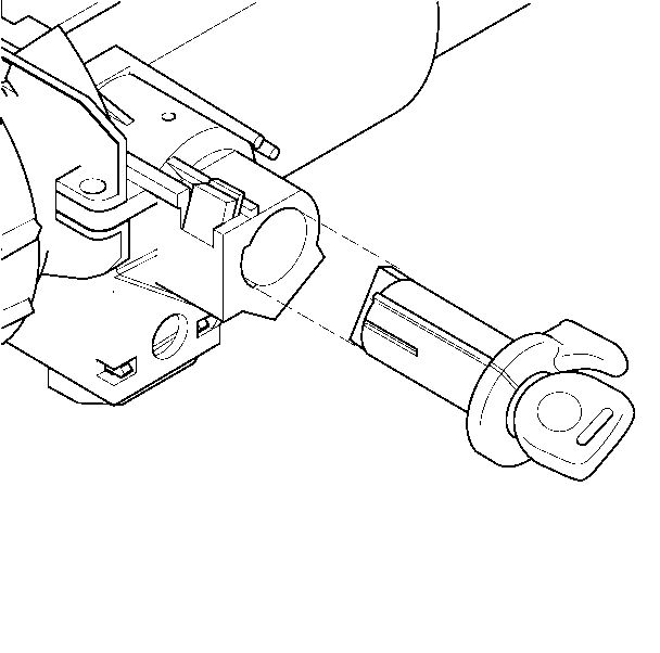

6. Align the lock cylinder and install the lock cylinder into the lock cylinder housing.
7. Connect the passlock and key buzzer into the lock housing.

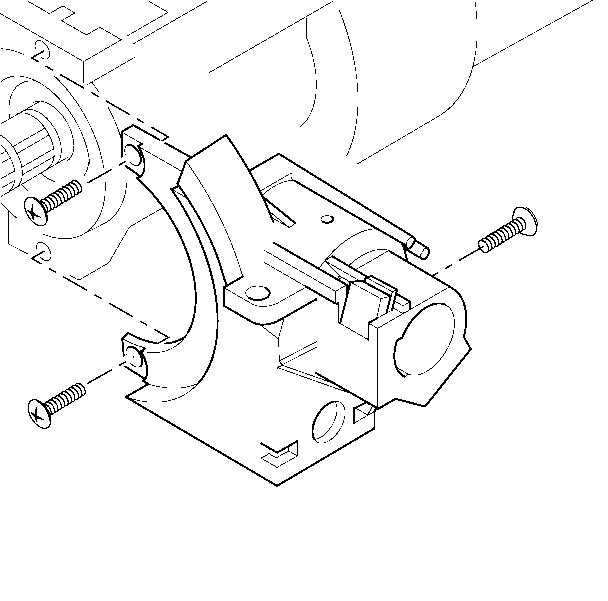

4. Remove the park lock cable from the lock cylinder housing.
5. Remove 3 TORX screws.
6. Remove the lock cylinder housing from the steering column.
