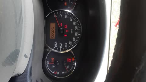

Greetings. key without a chip and it cannot start the car (orange immobilizer symbol on dashboard ).
Will replacing second hands) Ecu+ignition cylinder+keys solve the problem ?
Thanks in advance.

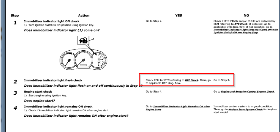

We need to check for codes because most likely you have a code in the BCM that will tell us what the issue could be.
Take a look at this diag chart for this warning light and it basically tells us what the issue could be. Thanks
Nov 11, 2020 at 11:46 AM

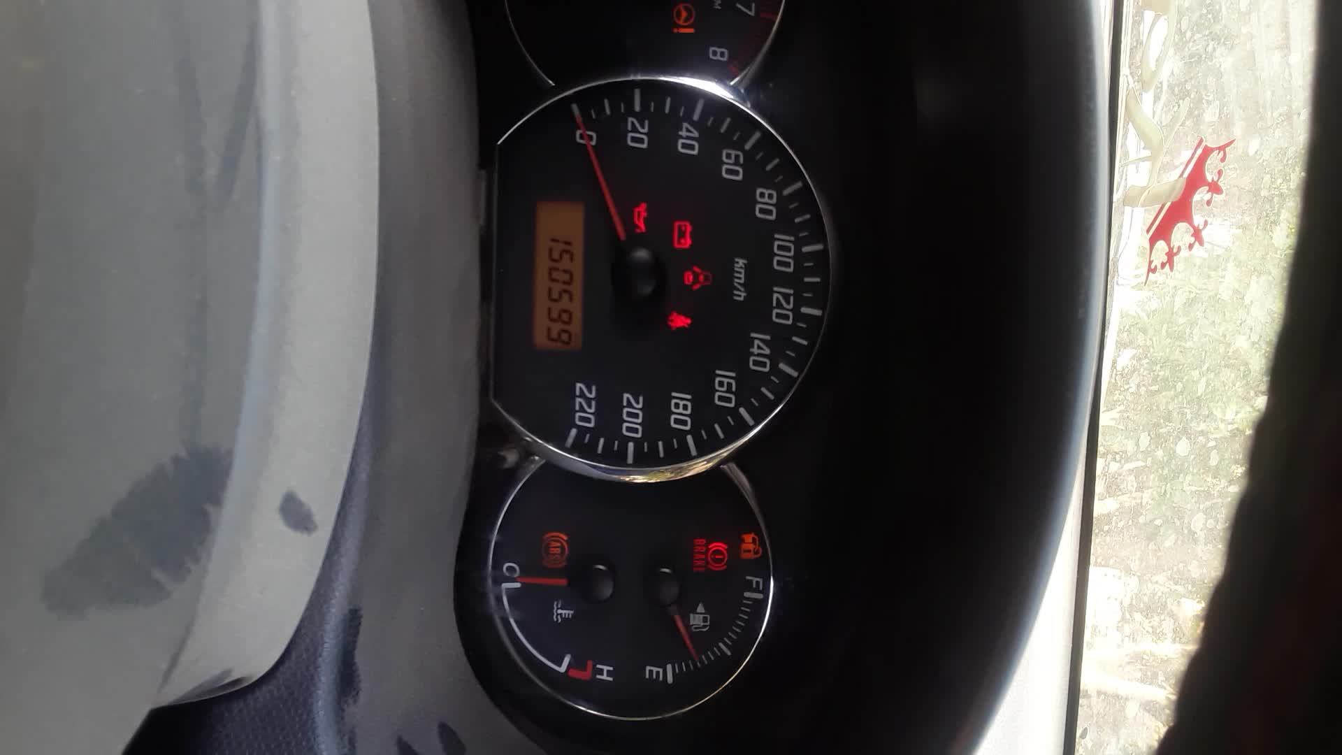

Here is the short video i took. The immobilizer is flashing.
Nov 11, 2020 at 12:20 PM
Just to be clear, you are trying to start the vehicle with a key that doesn't have the chip in it? Or your vehicle does not have a key with a chip in it?
I think your vehicle has the chip key which means it will not start unless you have a key with a programmed chip in it. So if that is the case, we need to get a key programmed or this will not start.
Let me know if this is the case. Thanks
Nov 11, 2020 at 1:58 PM
BILLY THERON
  • 7 POSTS
Yeah, you're right. The key break and the chip got lost.
Nov 12, 2020 at 8:23 PM
Okay. Unfortunately that is the issue. You are going to have to get a key with the chip and have it programmed in order to get this started again.
