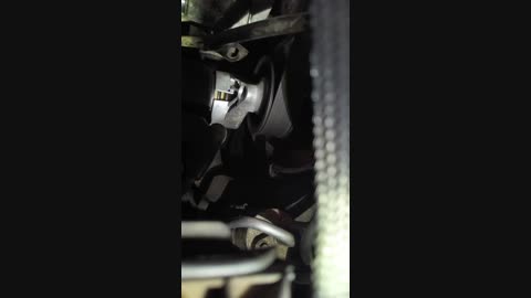

About a week ago it randomly started to bog down while I was driving, has a rough idle, and the hole car is shaking pretty much all of the time. In the last month I've replaced the PCM, alternator, spark plugs and the tubes/wires that plug into them, distributor cap, ignition coil, O2 sensor, MAP sensor, idle air control valve, oil change, blower motor, and serpentine belt (it does look like the belt tensioner is a little loose, and the belt is squeaking).

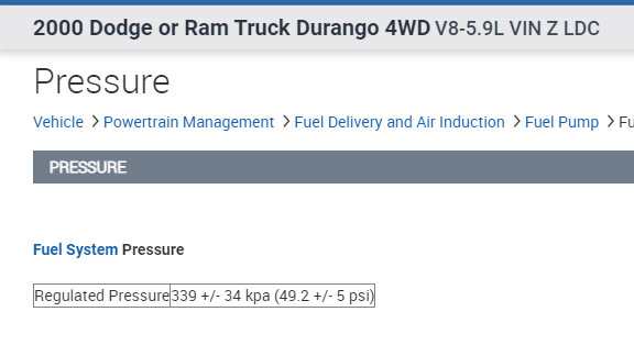

I attached the manufacturer's fuel pressure specifications below for you.
Let me know what you find.

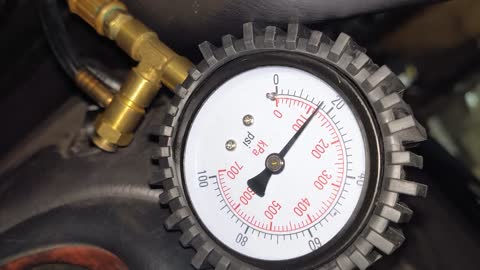

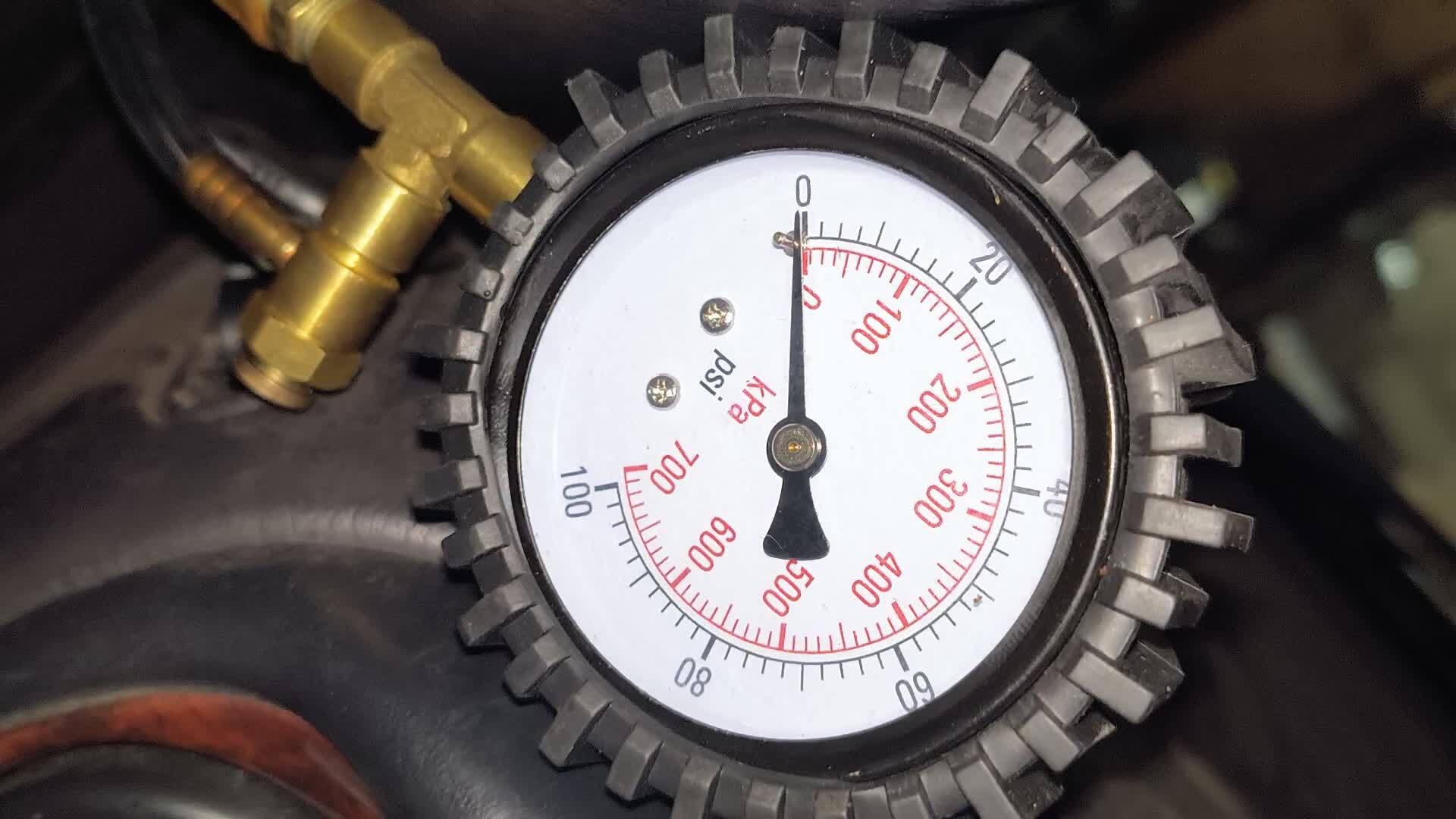

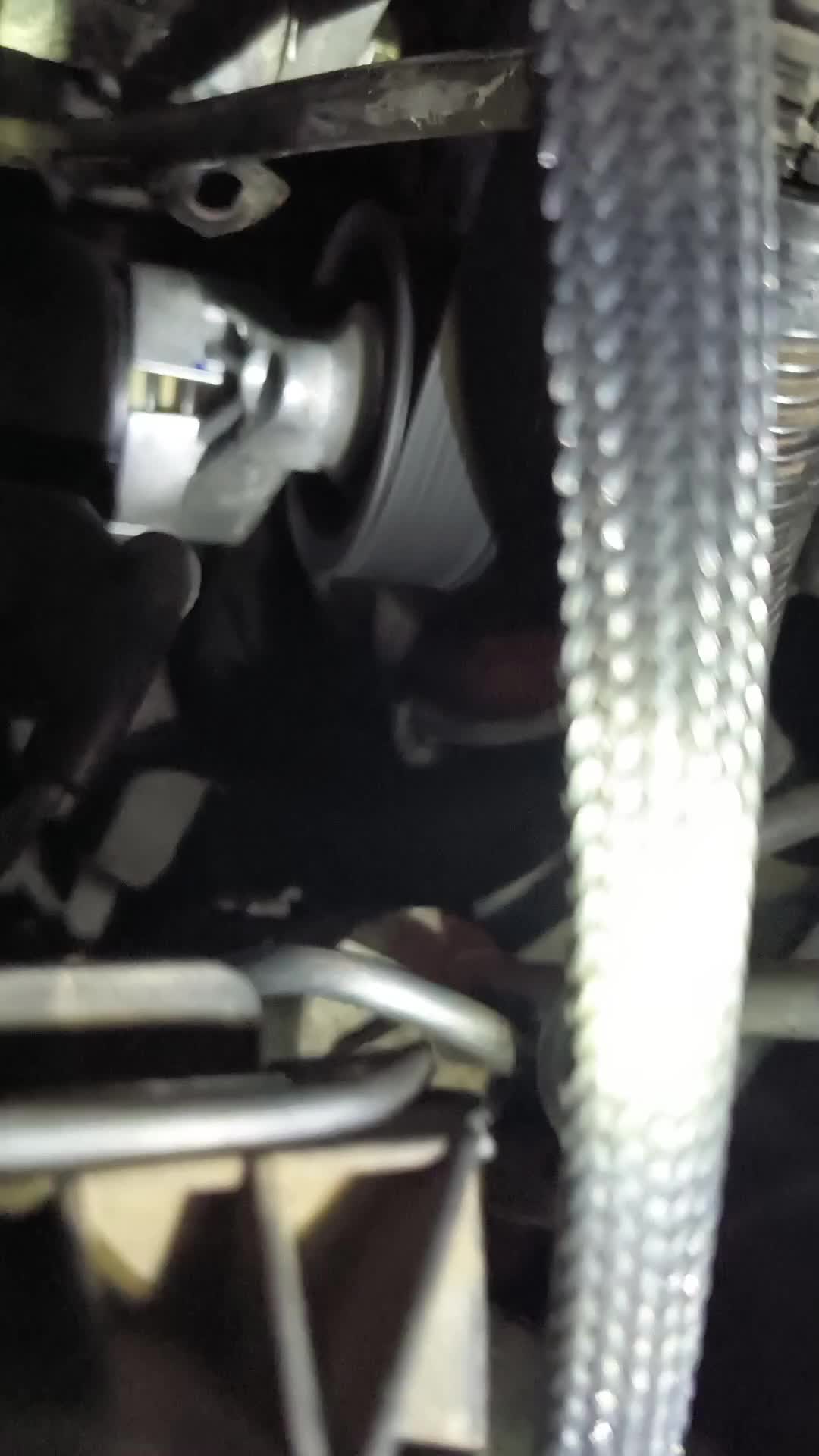

Hey Joe, sorry for the late response, it took me a bit to get a fuel pressure tester. So, when I turn the key to on, the gauge goes up to about 20 and it's pulling some fuel into the line (not sure if that's normal or not), with the car running it hovers around 50. I replaced the bad belt tensioner pulley and idler pulley, but the tensioner is still jumping back and forth when the car is running.

The fuel pressure doesn't sound right. It should be higher when the engine is off. Also, what line is drawing fuel? Is it a vacuum line at the regulator?
As far as the belt is concerned, let's get it running properly first and see what happens. If we can smooth the engine down, the tensioner may follow suit.

After letting the car run for a couple min, when checking the fuel pressure, it would initially jump to 40ish, and then every subsequent test would be lower and lower. I attached another video. You can hear how bad it sounds after I give it gas.

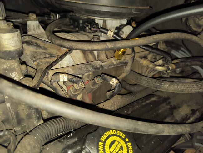

I'm not really sure but I'll post a picture.
*The gold cap is where I have the tester connected.

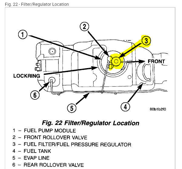

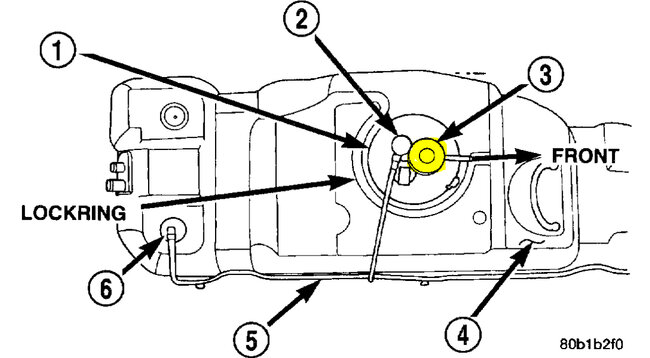

The pressure when the key is first turned on should be much higher than 20 psi. Interestingly, when you have it running, it jumps to the normal range. However, I noticed when you hit the throttle, the gauge didn't jump.

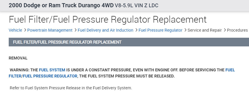

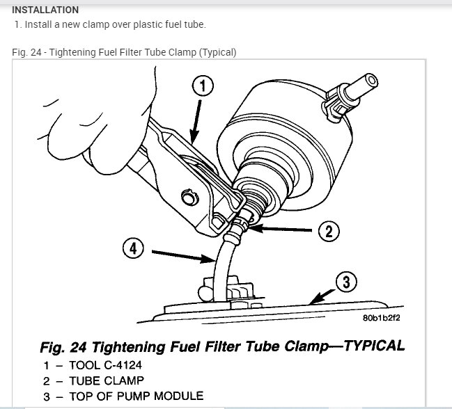

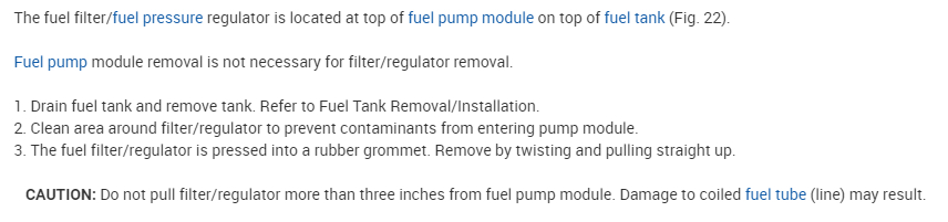

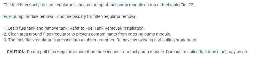

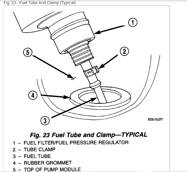

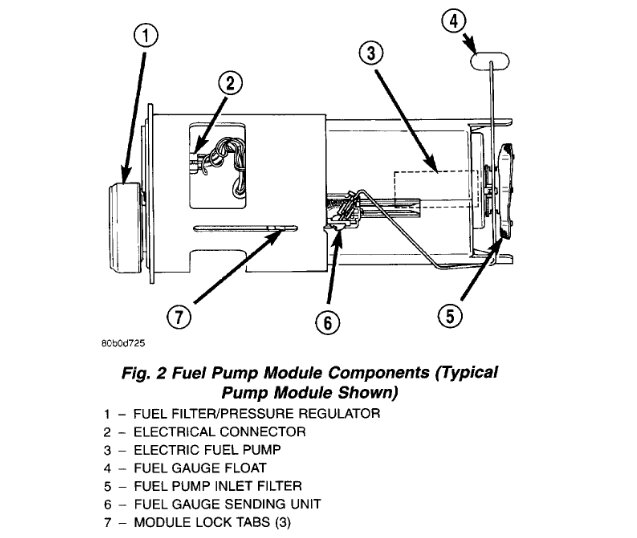

I suspect it is the fuel filter/regulator issue. This component is located at the top of the fuel tank and fuel module. See pics below. See number 1 in pic 1 and number 3 in pic 2.

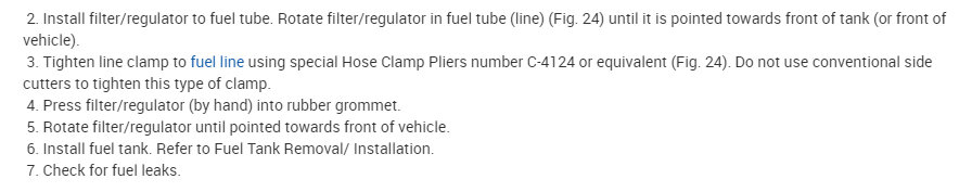

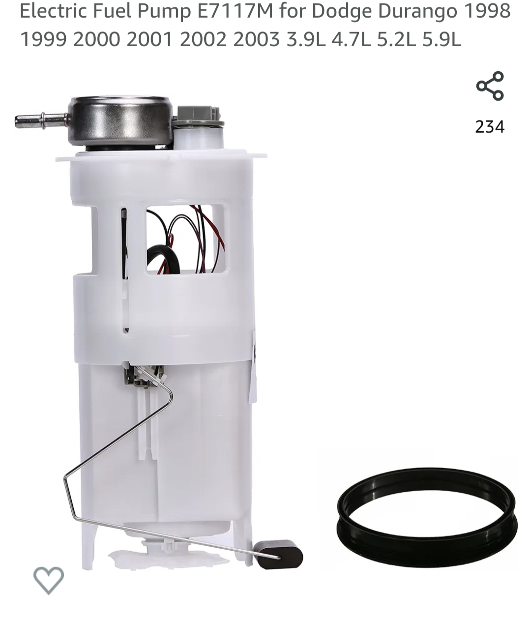

That is my first suspect. It requires the removal of the fuel tank to be replaced. Starting with pic 3, I attached the directions for the replacement of the component. Take a look through them and let me know if you have questions or are comfortable performing them.
If this was my vehicle, I would likely remove and replace the fuel pump assembly at the same time. You wouldn't want to remove the tank again. It's just a thought.

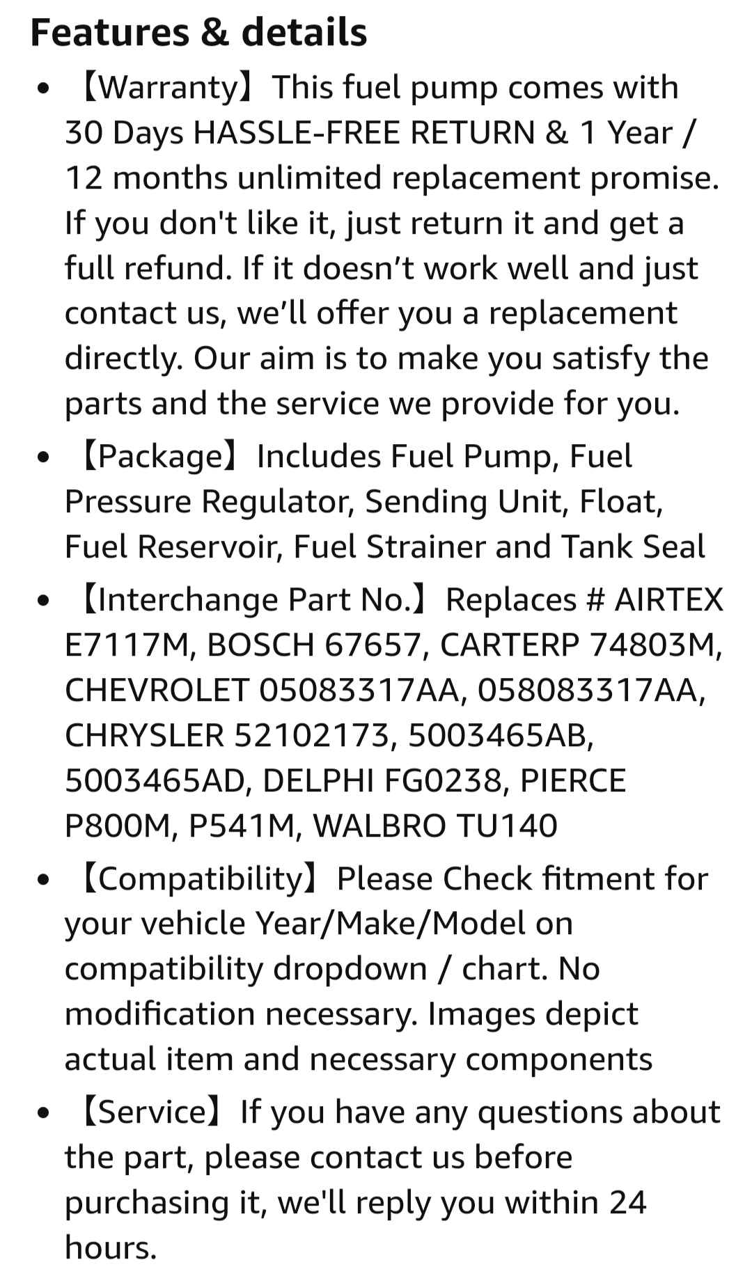

I ordered one off Amazon, is this everything I'm going to need?
Sep 26, 2023 at 3:15 AM
  • 110,244 POSTS
Yes, that appears to be everything. I see the regulator/filter on the top.
