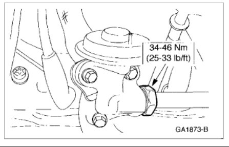

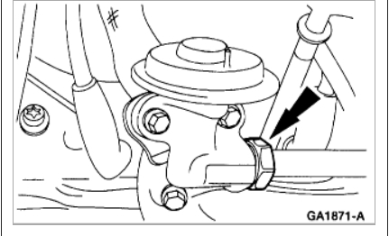

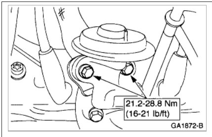

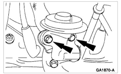

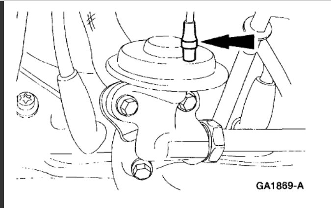

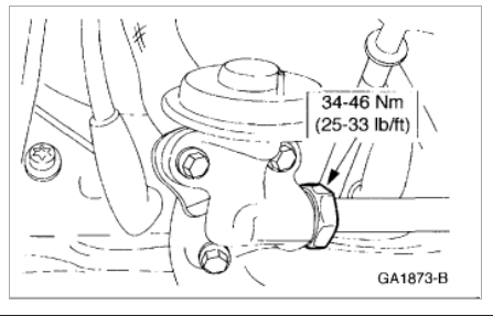

It sounds like you could have a EGR valve stuck open or the vacuum supply is not cutting off. Here is a guide so you can see what the valve is and a video on how to test it.
https://youtu.be/DqUCbbKdWf4
and
https://www.2carpros.com/articles/engine-idles-too-high
(Here are the diagrams Below)
