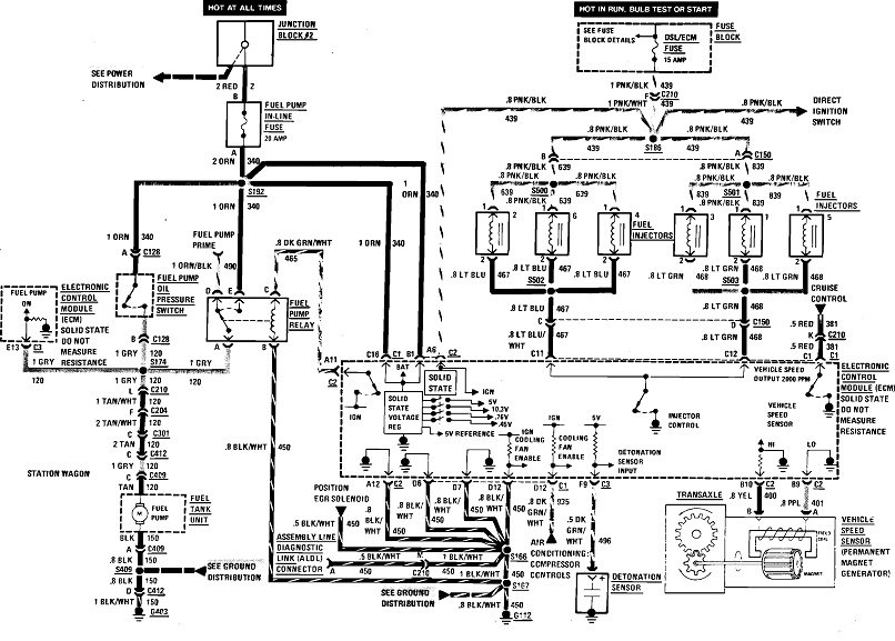

I was gifted the vehicle listed above Wagon that sat for 5 years. I changed out the fuel pump and sending unit, as well as the fuel lines and filter. I also did a full tune up with spark plugs, wires, and PCV valve.
It wouldn't stay running due to losing fuel pressure. Troubleshooting showed it was a leaking injector, so I replaced all 6 of them and now it runs. But the idle is up and down and check engine light comes on and off. It will rev up fine when you press the accelerator, just the idle is up and down.
I plugged a code scanner into it and its throwing four codes: 22, 34, 35, and 45. I swapped out the Idle Air Control Valve and the Mass AIrflow Sensor, but still idling up and down and throwing the same four codes.
Any idea what could cause those four codes together?

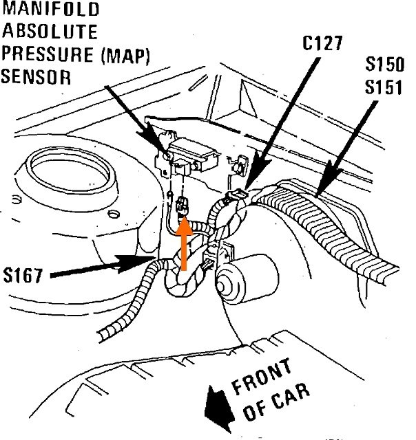

22 - TPS sensor signal voltage low
34 - Map sensor signal out of range, low
35 - Idle air control sensor circuit fault
45 - Oxygen sensor rich exhaust

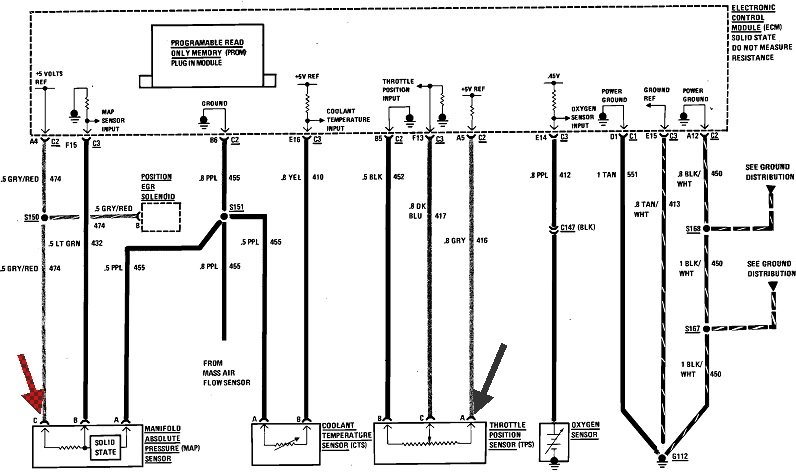

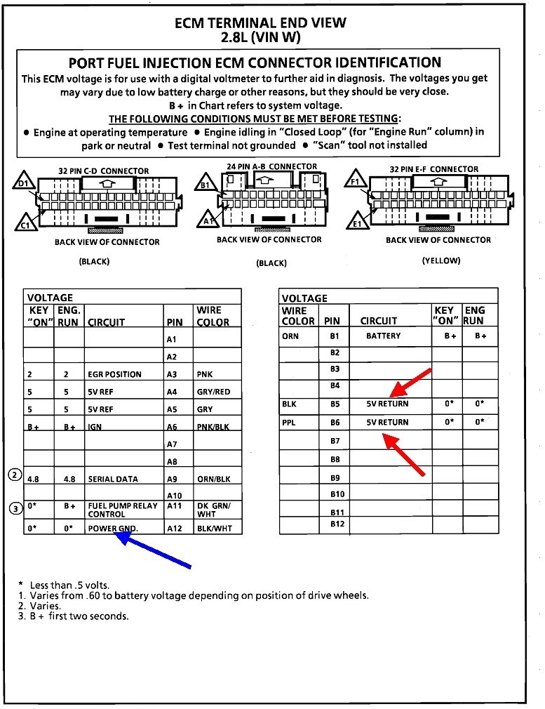

Most sensors, the first two in this list in this case, are fed with ground and 5.0 volts from the Engine Computer, then they develop a signal voltage between those two voltages. There's mechanical stops inside the throttle position sensor that limit the range of its signal voltage to roughly 0.5 to 4.5 volts. Only a circuit defect can let the signal voltage go outside that range. Doing so is what the computer sees to detect that problem, and set the appropriate diagnostic fault code. I would concentrate on the first two fault codes as they're pretty easy to diagnose.

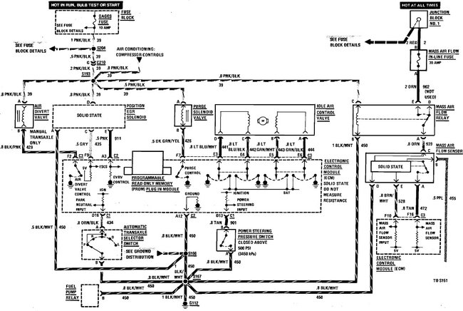

Code 35 is misleading. That part is the "idle air control motor", not sensor. You may have inadvertently set that code if the ignition switch was turned on while that motor was disconnected.
To set code 45 requires a properly-working oxygen sensor. The Engine Computer likely reverted to a back-up strategy once the first two codes were set. They can't let the system run lean in that back-up mode as that would lead to stumbling and hesitations. When running too rich, engine performance will still feel acceptable.

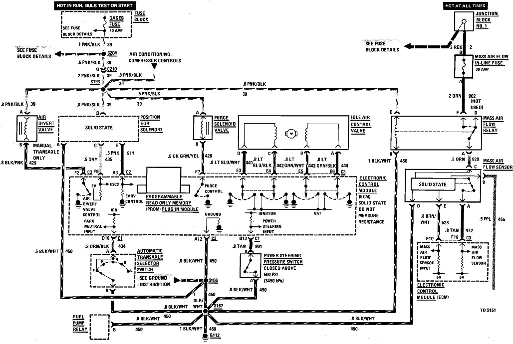

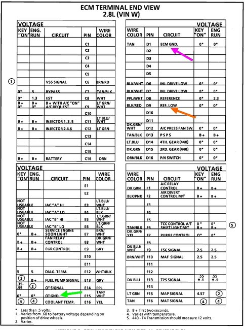

These three diagrams cover most of your engine controls. If you have trouble seeing them, I can cut them into pieces that I can enlarge for you. In particular, look at the two arrows I added in the second diagram. The red arrow is pointing to the 5.0-volt supply to the MAP sensor, and the gray arrow is pointing to the 5.0-volt supply to the TPS. Normally they use just one wire to supply multiple sensors, so when you're getting multiple "low voltage" fault codes, it's related to that one wire. Here they're using a separate wire for each sensor, but they still all originate from a single regulator circuit inside the computer. My suspicion is you're going to find one of these wires is shorted to ground, or both of them are open, meaning they have a break in them.

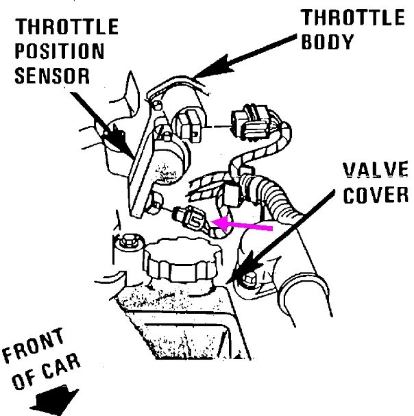

The TPS is the easiest to get to. It's on the side of the throttle body. To be valid and accurate, these readings have to be taken with the sensors plugged in. You can stick the meter's probe through the rubber seal around the wires.
If you need help with using a digital voltmeter, start with this article:
They're using one here with an "auto-ranging" feature. You can find a perfectly fine meter at Harbor Freight Tools for around $7.00, or at Walmart or any hardware store. I can help you with setting it up, if necessary.
Let me know what you find on these two wires.

So for the first two I should be looking for wiring problems on those two sensors?
Could the last one could be related to the fact that the catalytic converter has been removed from this car (I see a straight pipe installed in its place)?
Jan 2, 2021 at 7:33 AM
CARADIODOC
  • 34,380 POSTS
Nope. Catalytic converters were first monitored for their efficiency with a second oxygen sensor after it on all '96 models. Those are referred to as having the "OBD2, (on-board diagnostics version 2) emissions system.
The front oxygen sensor switches between too rich and too lean about two times per second. Staying in one state too long is how the computer tries to make adjustments, and/or sets a fault code. In addition, on OBD2 vehicles, if the catalytic converter is working properly, the rear O2 sensor will switch between rich and lean perhaps once every minute or two. As the converter looses its efficiency, less change in the composition of the exhaust gas takes place inside it, so what comes out starts to look like what went in. The rear O2 sensor will start to switch faster and faster until eventually it matches that of the front sensor. By that time the computer has seen the increased switching rate and set the fault code for "converter efficiency", and turned on the Check Engine light.
Reread my first reply if you haven't already. I added to it, possibly after you read it the first time.

If the Engine Computer is able to adjust idle speed, especially right after start-up, the system is working at that time. Then the best suspect would be an intermittent failure, typically due to loose or corroded terminals in the connector. If there was a solid, or permanent failure, such as a cut wire, the computer would never be able to adjust idle speed. That type of defect would be detected the instant the ignition switch is turned on, and the Check Engine light would turn on right away.
If you erase the fault codes, then they don't come back right away, it's an intermittent problem. That's where you look for something that is able to "fix itself" and work at times.

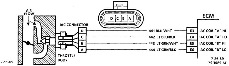

Probably the last suspect would be the idle speed motor itself. They have four electromagnetic coils of wire inside, and those wires are pretty substantial and not prone to breaking.
The system can be tested with a scanner, under the "IAC Test" or "idle speed test". That allows you to command the computer to raise engine speed to as much as 2,000 rpm in 100-rpm increments. If engine speed responds accordingly, the system is working.

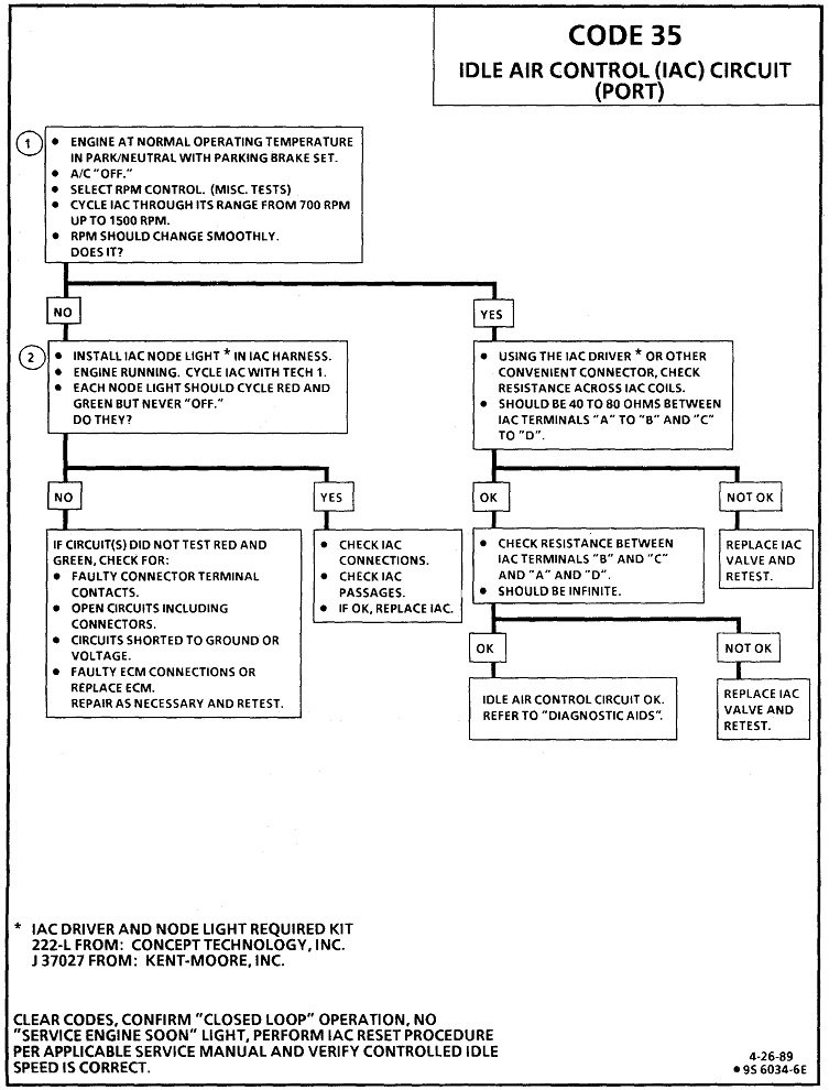

Here's GM's diagnostic steps for code 35:
CIRCUIT DESCRIPTION
Code 35 will set when the closed throttle engine speed is 300 rpm above or below the desired (commanded) idle speed for 50 seconds. Review the "Description and Operation" of the Idle Air Control (IAC) Valve operation in "Idle Speed / Throttle Control - Electronic"
TEST DESCRIPTION
Numbers below refer to circled numbers on the diagnostic chart.
1. The Tech 1 rpm control mode is used to extend and retract the IAC valve. The valve should move smoothly within the specified range. If the idle speed is commanded (IAC extended) too low (below 700 rpm), the engine may stall. This may be normal and would not indicate a problem. Retracting the IAC beyond its controlled range (above 1500 rpm) will cause a delay before the rpm's start dropping. This too is normal.
2. This test uses the Tech 1 to command the IAC controlled idle speed. The Electronic Control Solenoid (ECM) issues commands to obtain commended idle speed. The node lights each should flash red and green to indicate a good circuit as the ECM issues commands. While the sequence of color is not important if either light is "OFF" or does not flash red and green, check the circuits for faults, beginning with poor terminal contacts.
DIAGNOSTIC AIDS
A slow, unstable, or fast idle may be caused by a non-IAC system problem that cannot be overcome by the IAC valve. Out of control range IAC "Scan" tool counts will be above 60 if idle is too low, and zero counts if idle is too high. If idle speed is above 600-700 rpm in drive with an A/T, locate and correct vacuum leak. If rpm is below specifications, check for foreign material around throttle plates. Refer to Fuel Delivery and Air Induction / Throttle Body.
The following checks should be made to repair a non-IAC system problem:
Vacuum Leak (High Idle)
If idle is too high, Stop the engine. Fully extend (low) IAC with tester. Start engine. If idle speed is above 800 rpm, locate and correct vacuum leak including PCV system. Also check for binding of throttle blade or linkage.
System Too Lean (High Air/Fuel Ratio)
The idle speed may be too high or too low. Engine speed may vary up and down and disconnecting the IAC valve does not help. Code 44 may be set. "Scan" Oxygen (O2) voltage will be less than 300 mV (0.3 volt). Check for low regulated fuel pressure, water in the fuel or a restricted injector.
System Too Rich (Low Air/Fuel Ratio)
The idle speed will be too low. "Scan" tool IAC counts will usually be above 80. System is obviously rich and may exhibit black smoke in exhaust. "Scan" tool O2 voltage will be fixed above 800 mV (.8 volt). Check for high fuel pressure, leaking or sticking, injector. Silicone contaminated O2 sensors "Scan" voltage will be slow to respond.
Throttle Body
Remove IAC valve and inspect bore for foreign material.
IAC Valve Electrical Connections
IAC valve connections should be carefully checked for proper contact.
PCV Valve
An incorrect or faulty Positive Crankcase Ventilation (PCV) valve may result in an incorrect idle speed.
A/C compressor or relay failure
See C-Charts Component Testing / Chart C-10A if the A/C control relay drive circuit is shorted to ground or if the relay is faulty, an idle problem may exist. See: A L L Diagnostic Trouble Codes ( DTC ) > Related Tests, Information and Procedures > Chart C-10A A/C Clutch Control
If intermittent poor driveability or idle symptoms are resolved by disconnecting the IAC, carefully recheck connections, valve terminal resistance, or replace IAC.
Refer to Diagnosis by Symptom / Rough Idle or Stalling. See: Computers and Control Systems > Symptom Related Diagnostic Procedures > Rough, Unstable, or Incorrect Idle, Stalling

Here's the diagrams for the plugs for your Engine Computer. I found five ground wires here, but they aren't necessarily two for each circuit. For example, they use a separate wire for the oxygen sensor, (green arrow in the second diagram), probably for the same reason as a slight voltage interference from other circuits would adversely affect the O2 sensor's readings. "Reference" or "reference low" are designations for ground wires.
Do not waste your time trying to use an ohm meter to check these wires. All it takes is one tiny strand still intact to get a good reading that way. Instead, the voltage on these wires must be measured while the engine is running. That's when current flows through them and is when any excessive or undesirable resistance shows up as a "voltage drop". Put the voltmeter on its lowest range. Sometimes the voltage readings will jump around a few hundredths of a volt due to stray magnetic interference, but typically those readings will be obviously too high when there's a problem in one of the wires.

The only other thing I can suggest is to remove the idle speed motor, or get a good used one from a salvage yard, and plug it in while it's laying out where you can watch it. Don't run the engine with the valve out as this will create a huge vacuum leak, but when a helper turns the ignition switch on, you should see that pintle valve retract. It should extend fully when the ignition switch is turned off.
There is nothing in the system to tell the computer where the idle speed motor is set, or adjusted to, other than it knows engine speed. Referring back to Chrysler's numbering system that I'm familiar with, lets say the computer sets the motor at step 50 in preparation for the next engine start. Once that is done, if you come along and tug on that valve fairly hard, you will be able to pull it out or squeeze it back in. The physical step position will have changed, but as far as the computer is concerned, it still assumes it is at step 50. Besides you moving the valve manually, the armature could be sluggish, or it might have even vibrated to some other step. Regardless of how it happened, it is out of sync with the computer. To prevent that, on every one of these I've played with, the computer runs that valve all the way out to step "0", then pulses it some more in case it didn't have time to get there. At that point it knows that valve has to be at step "0". From there it retracts it to, in my story, step "50", then sits there and waits until you want to start the engine. What you should see when you turn the ignition switch off is that valve will extend a lot, then retract part way. You can usually hear that if you have your head under the hood when your helper stops the engine. The computer knows now the valve is at step "0", and it knows it has opened it up enough to provide the idle flare-up. If you don't see that happen, that would explain the no flare-up you observed, but we'll have to figure out why.
