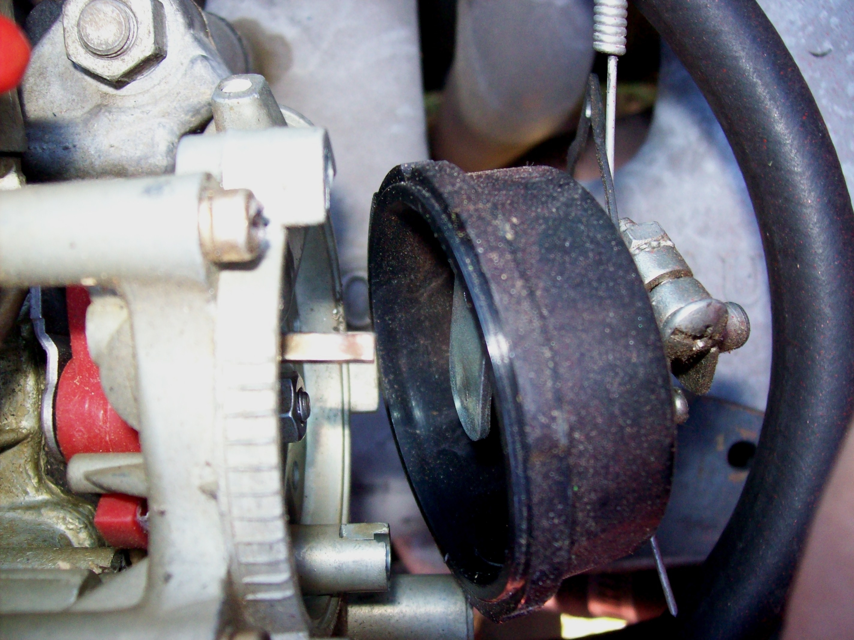

What do I do with the choke heater port on the carb? Do I need to run a line to it from somewhere or can I leave it with nothing attached?

I added a piece of fuel line to the carb choke heater fitting and plugged it. Any concern here?

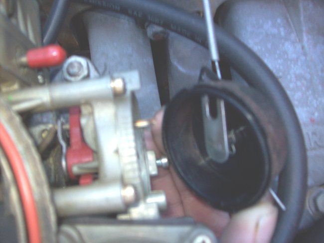

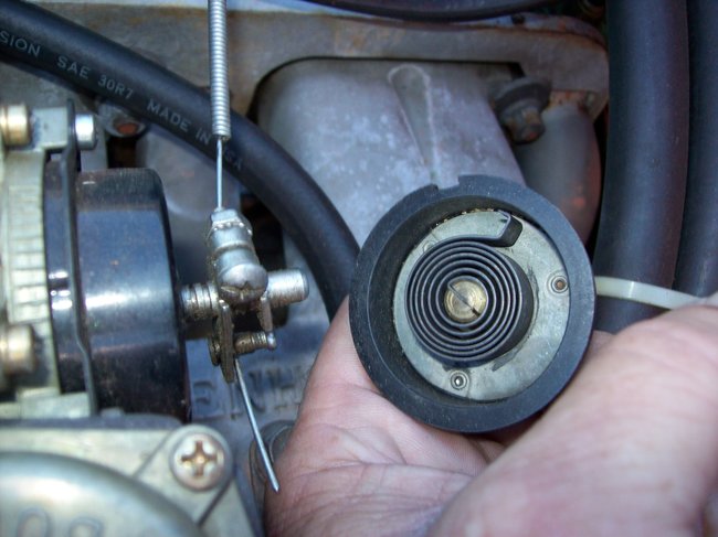

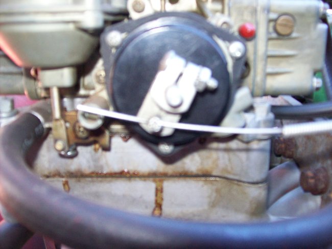

Heater thingee on choke!
Normally there is something like a steel brake/ steel fuel Line connected
to it. The other end bends over to the exhaust manifold and runs
down beside it. Hugging/ touching the manifold as much as possible----
this transfers heat into the tube. The inside the choke cover
(in the aluminum) it has a teeny -tiny hole (a little bitty vacuum leak)
constantly sucking air......in a perfect set up---the heated air inside
the steel line. This would warm up the bi-metal spring inside and
aid in the choke to stop choking!
'Round here, the dirt daubers might fill the end of the pipe with their mud,
something to be aware of!

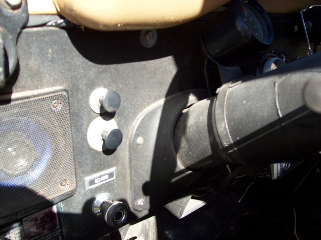

Or you can just leave it open----Or like me install a manual choke.
As a newcomer to manual choke----the worst thing about it is FORGETTING to push it
in FULLY once you are warmed up......usually you figure it out when the JEEP
starts sorta flooding and lacking power!
